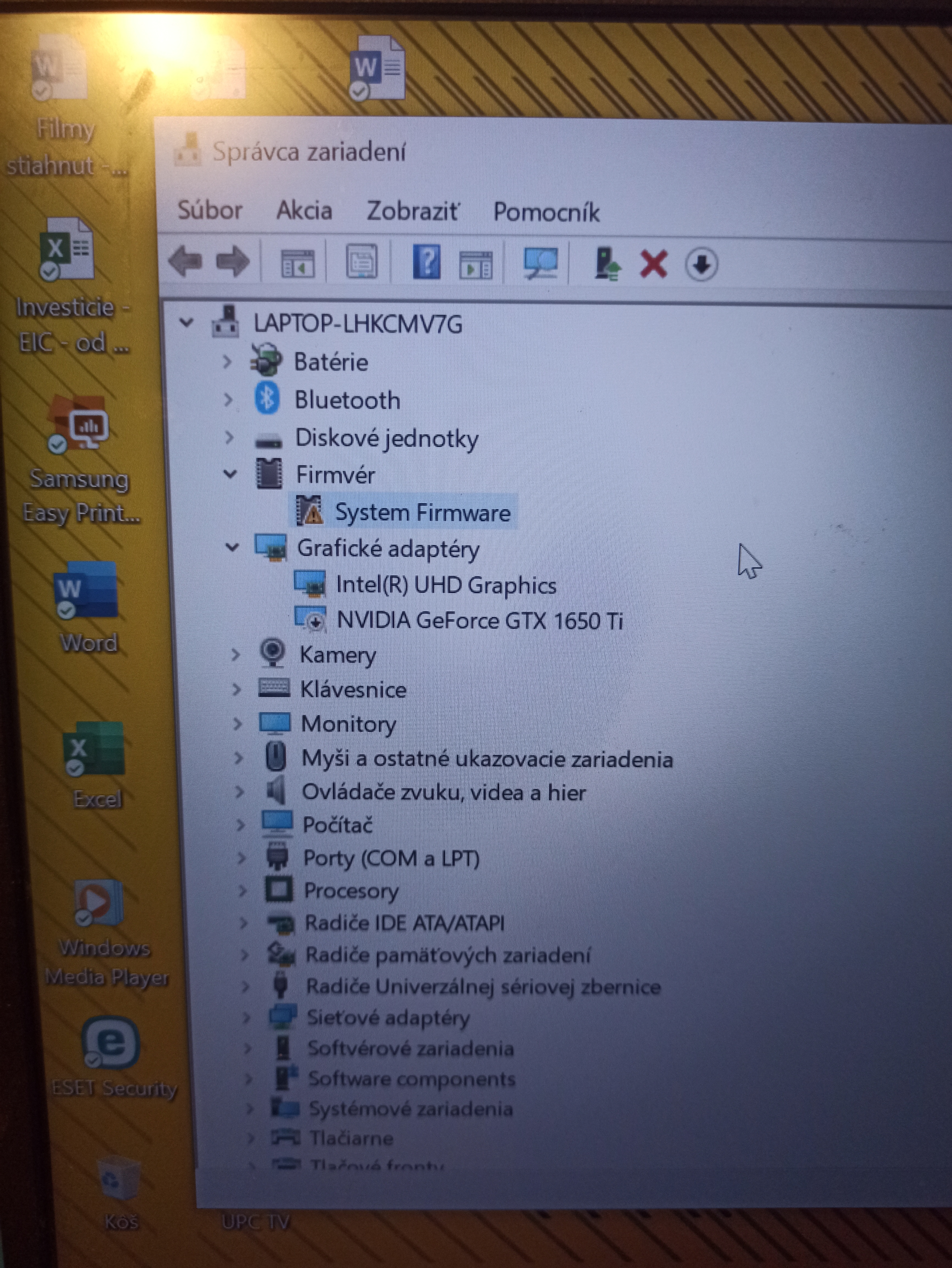

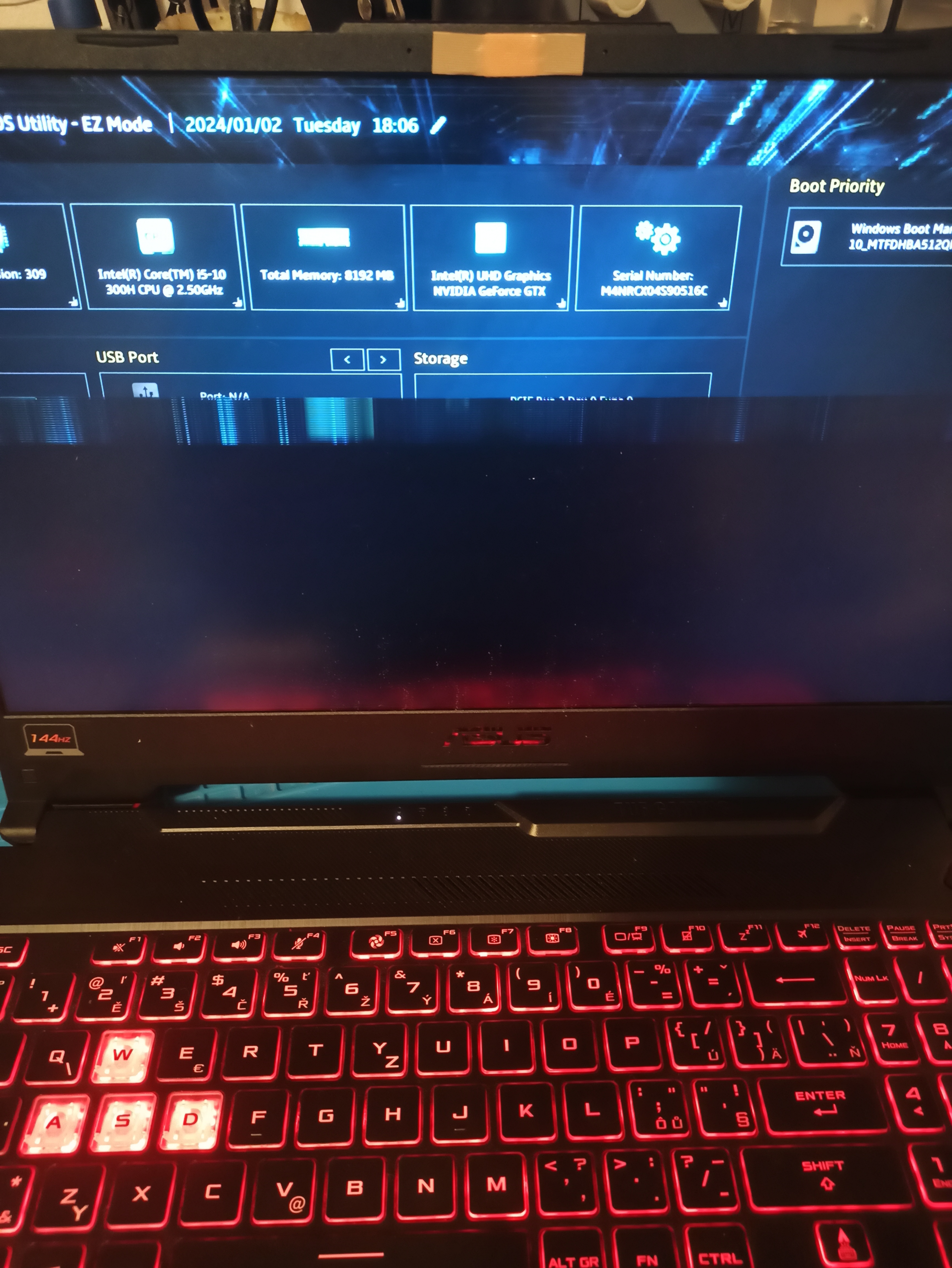

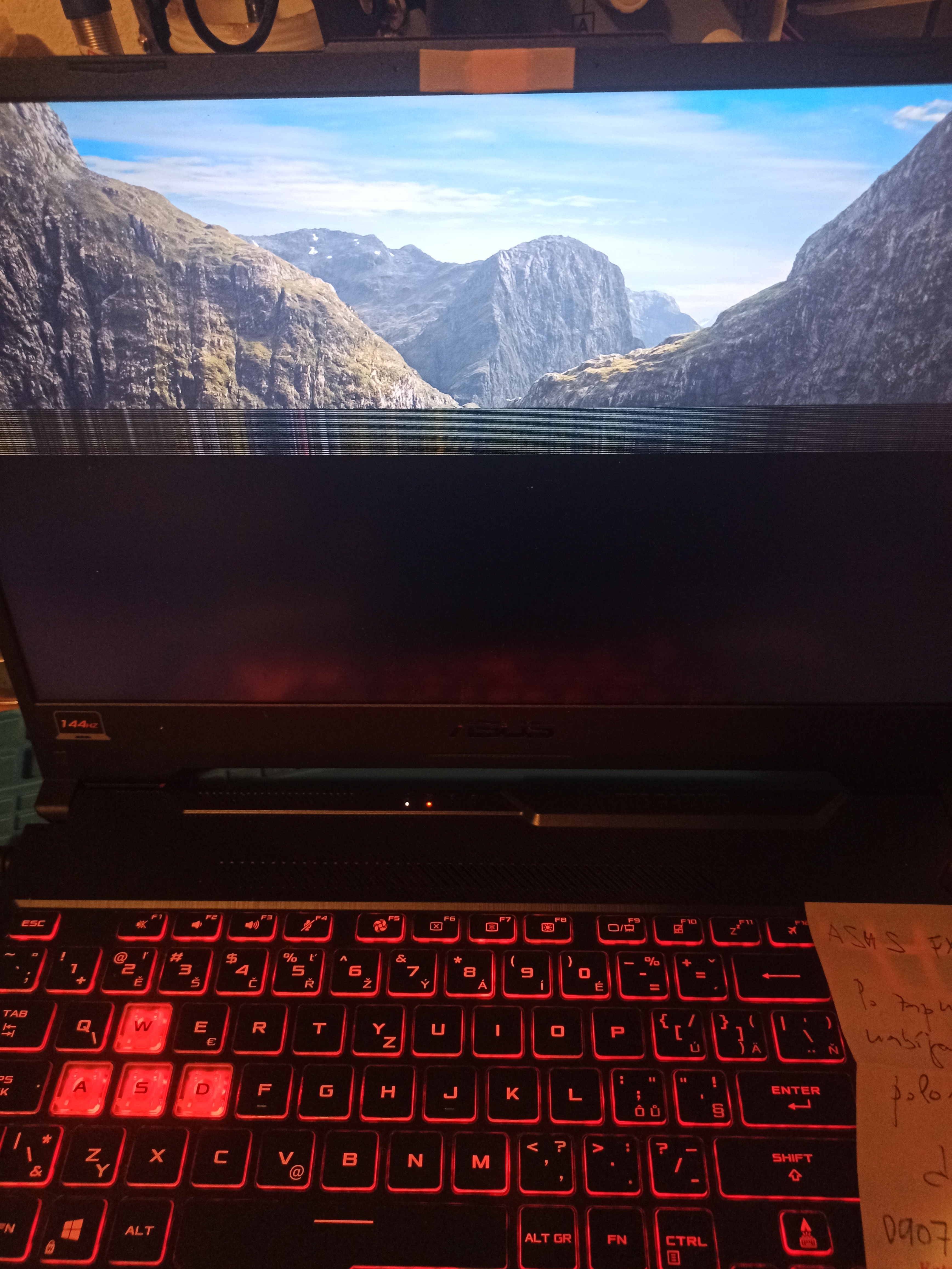

    Have this weird problem with asus FX506LI thats display goes half black when charger is attached and from start untill u pout charger in and pull it out. then display like switch to other mode and works ok.
    I try to shut sown nvidia gpu but it is still the same. there is no bios menu to power down nvidia card. it taped display so i want my options before i pull it out

    I once had a Mackbook air with a similar problem, but it was the screen and bus
    When you turned it on, the screen looked bad, when you connected the charger it "fixed" but what happened is that when you moved the computer to connect the charger the screen "accommodated" and began to work well, until you wanted to adjust it and the image was lost again. On that occasion it was the screen and the video bus.
    Doesn't it work if you try to move or adjust the screen? isn't there a point where it looks better?
    (Unless the charger is putting voltage to a point that is not powered?)​

      yes it was mainboard of lcd. after change, no problem
