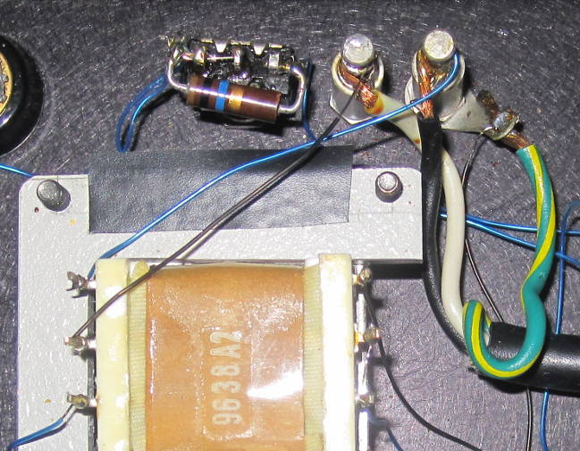

Using Kynar 30AWG for 120VAC
  • eccerr0r
    Solder Sloth
    • Nov 2012
    • 8678
    I saw this and
    Granted this looks like a homebrew and at least 30AWG wire should fuse on its own if it shorts out...

    Re: Using Kynar 30AWG for 120VAC
    that's fine,
    the conductor is rated for 300v, the insulation breaks down at 2000v
      Most kynar 30AWG wire has "no spec" by UL for voltage, granted, kynar is fairly tough, hard to scrape the insulation. But it's much thinner than any other UL listed wire.
      UL does spec 105°C for max temperature which is probably good enough.
      Military spec kynar wire is good for 300V at least however. Not sure what the difference is other than 135°C.
      Now the question is whether it's good enough for 220VAC... now that is pushing it.
          Yeah, "no voltage rating" is the key words that I see on many spec sheets - it's not rated for voltage like other wire. The conductor itself will handle 300V but who knows how close the other potential is... Usually these wires are used for less than 50V typically so nobody cares too much.
          I did not know typical wire wrapping Kynar wire were silver plated, thought it was tin. Nice, supposedly these should be pretty good for its diameter for RF.
              It would be OK as long as there is a suitable fuse to prevent a fire hazard from over-current glow or melting.
              #30 AWG can carry around 1A max. before the insulation heats up too much, 105C, and 10A for 30 seconds before melting like a fuse.
              It's dangerous here because a hot wire would melt the electrical tape, transformer bobbin, and using #30AWG for protective earth-ground is forbidden in electrical codes.
                Fortunately (???) the black wire isn't being used for chassis ground but rather as a common point tie. Whether one is allowed to share the main ground tie (green wire) with the thin black wire is acceptable, but it's probably okay.
                I think the maximum "normal" current flow is around 20mA or so estimated, so nowhere near the current limit fortunately. So unless something bad happens, the gauge is fine. Unfortunately no fuse or power switch on the primary -- it's a homebrew.
                Might have to add a fuse, but seems like one would need a fuse of 200mA or less or so, else the wire may fuse before the fuse. And those milliamp fuses are expensive...

                  Originally posted by redwire
                  Iusing #30AWG for protective earth-ground is forbidden in electrical codes.
                                  Yeah pretty sure it's a homebrew versus a low quantity(and quality?) build, the solder job is indeed crappy, and if you only have blue and black 30AWG Kynar®, blue and black 30AWG Kynar gets used.
