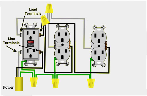

          AC still confuses me then. Let's look at two 120VAC's, 120 degrees apart. When one is +120VAC, the other is -120VAC, with a potential difference of 240VAC, right?
          But doesn't the AC flow forwards and then backwards? Forwards, backwards, forwards, backwards? When I was trying to understand AC not too long ago (even three-phase stuff), I thought that's how it was explained to me...just happens so fast, we don't see or feel it.
          Where is the return path there? They say you don't need a neutral or ground to get the 240VAC. I know I don't use any neutral or ground when I'm testing my 240VAC outlets, but I do read 240VAC.....
          So, touching the hot, so long as I'm not grounded (ie, wearing insulated shoes, not touching anything else) shouldn't hurt me? Even at the mains? Or is that enough current where it'll jump through the rubber soles on my shoes? I have 200-amp right now. I'm not going to do that, I'm just curious.
          Finally, I wanted GFCI breakers, the actual electrical engineer we hired to do the work gave us some whole home lightning protector and whole home surge protector and I want to say he was claiming they were equivalent to the GFCIs, but I won't swear on that.
          Are GFCI breakers better than the tamper resistant receptacles, where you need to push equal pressure on both sides at once to not hit plastic? Or should we replace the receptacles she has access to and the breakers as well? She's now interested in receptacles and those little plastic plugs aren't worth a damn anymore. Thanks!

            "Finally, I wanted GFCI breakers, the actual electrical engineer we hired to do the work gave us some whole home lightning protector and whole home surge protector and I want to say he was claiming they were equivalent to the GFCIs, but I won't swear on that."
            Maybe he was a train engineer. whole house surge protectors are NOT GFCI's. Whole house surge protectors are equivalent to mov's across the line. they protect from large electrical spikes coming into your home on the power line, and may protect your electronics and appliances, but it won't protect you.
            You don't need a ground or neutral to have 240vac, but you should always have a ground. and some appliances require a neutral, ie electric clothes dryer, Uses 240 for the element but the motor etc. usually runs on 120.
            GFCI's are better than tamper proof plugs, if a cord is pluged in but the wire in the cord itself is damaged/exposed, the tamper proof receptical won't protect against that but the gfci will.

                One thing to remember is that GFCI's can usually protect other standar outlets that are connected to its load output. so installing it as the first outlet after the breaker will protect any others that are connected after it.

                  Following on from my answer above a GFCI is a device that monitors the current going out on a phase, making sure it comes back over the neutral.
                  If it does not it means it is leaking out somewhere else, for example into a child poking his fingers into an electrical outlet.
                  The GFCI then trips.
                  A GFCI is simply a coil with the hot and neutral wires passing through it.
                  For example the hot wire carries 10AH, it then follows that the neutral must carry 10AH back.
                  This nullifies any magnetiuc field in the coil, so it reads "0"
                  If any current goes back any other way than via the neutral then the coil will get energized tripping the breaker.
                  This works just as well in a two phase system without a neutral, because all the current must still come back to the source (transformer or generator) alternating via the other wire in any given point in time.
                  Normally in Europe a whole house GFCI breaker is installed in the panel, cutting the incoming mains in case of detected fault.

                              No, as R_J pointed out up above, they are usually daisy chained.
                              You can get panel GFCI breakers, though I don't know how frequently they are used. I suspect it's convenience that GFCI outlets are used - if they get nuisance tripped, it's right there (unless it's daisy chained).
