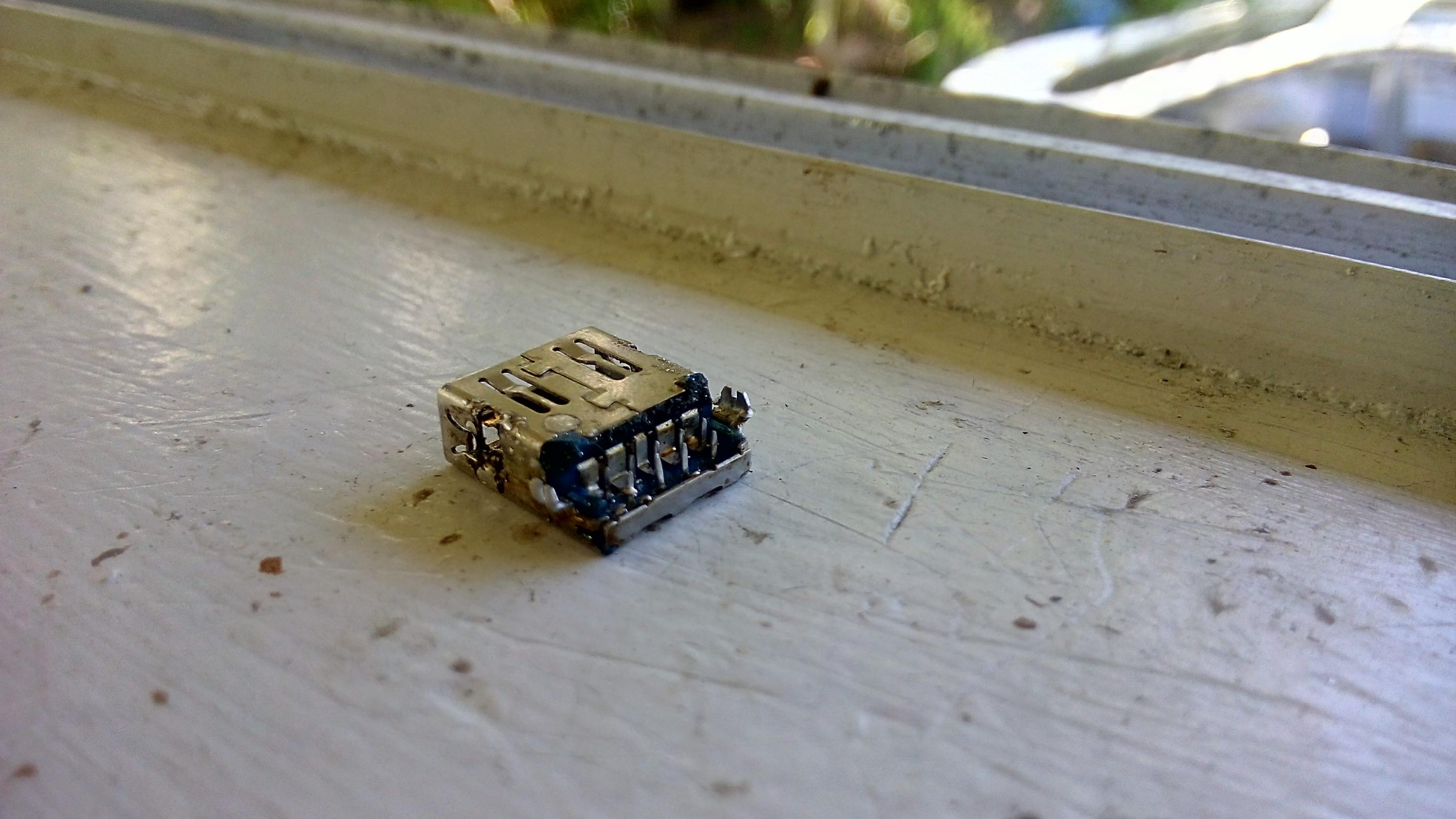

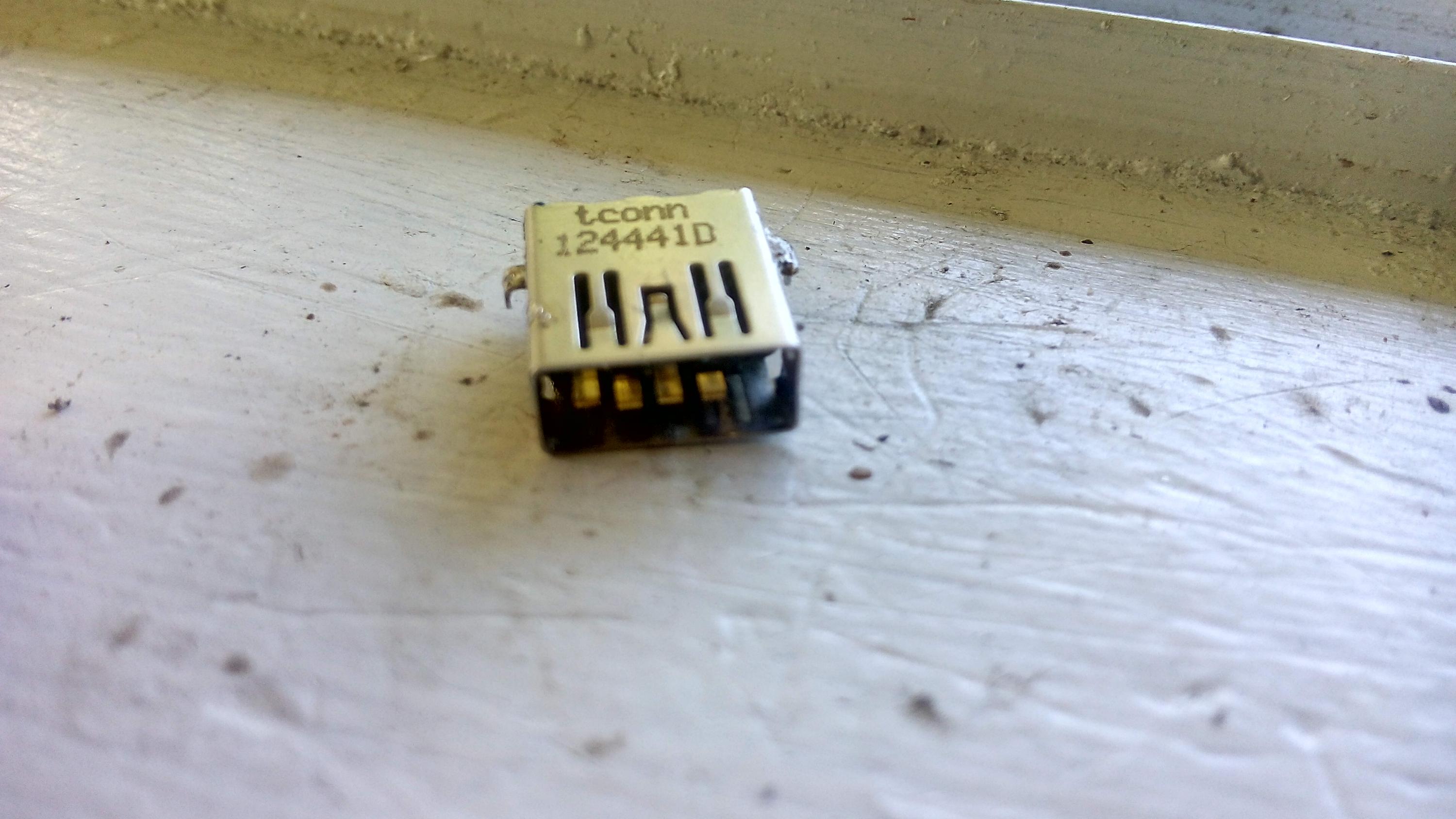

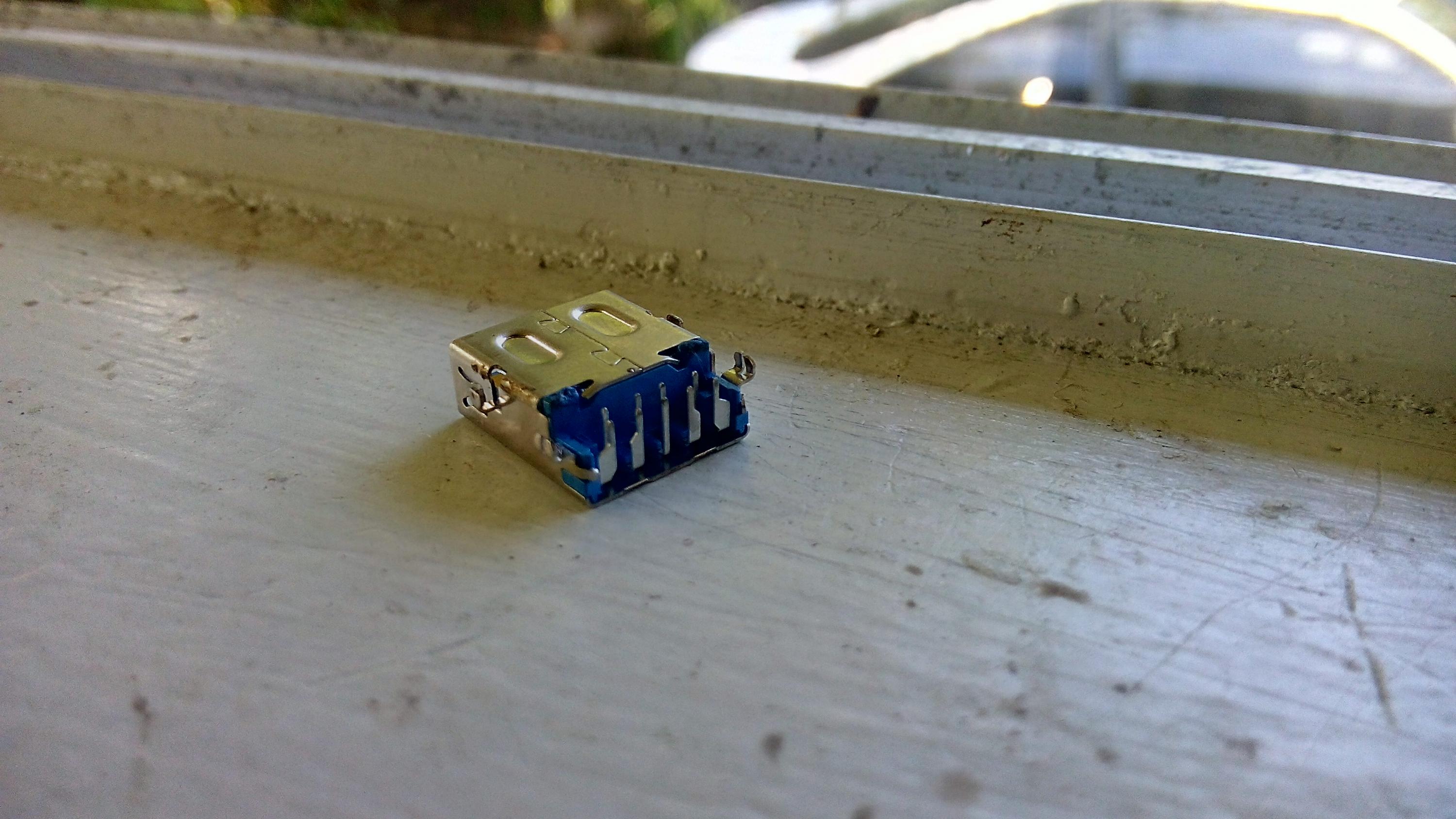

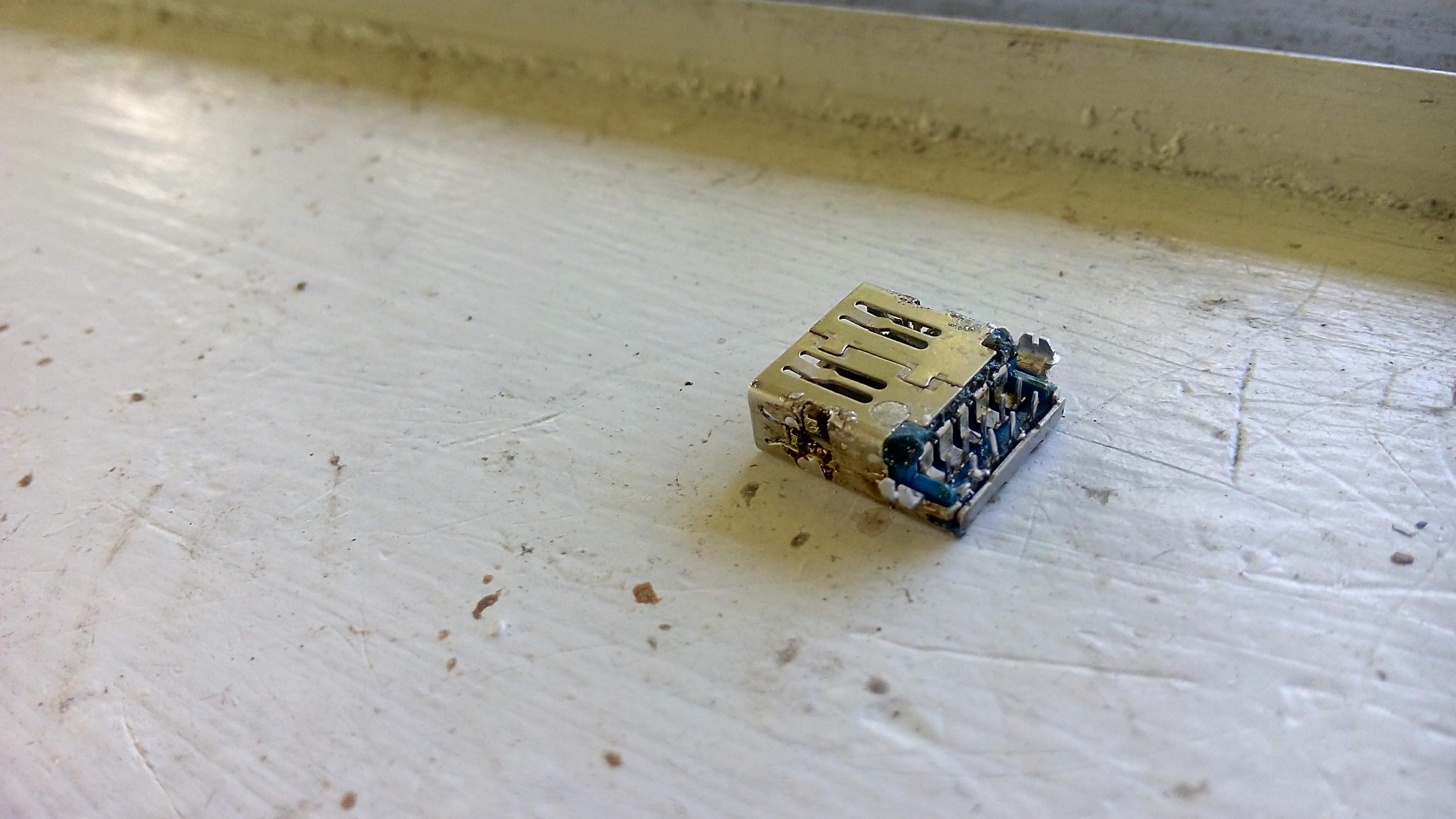

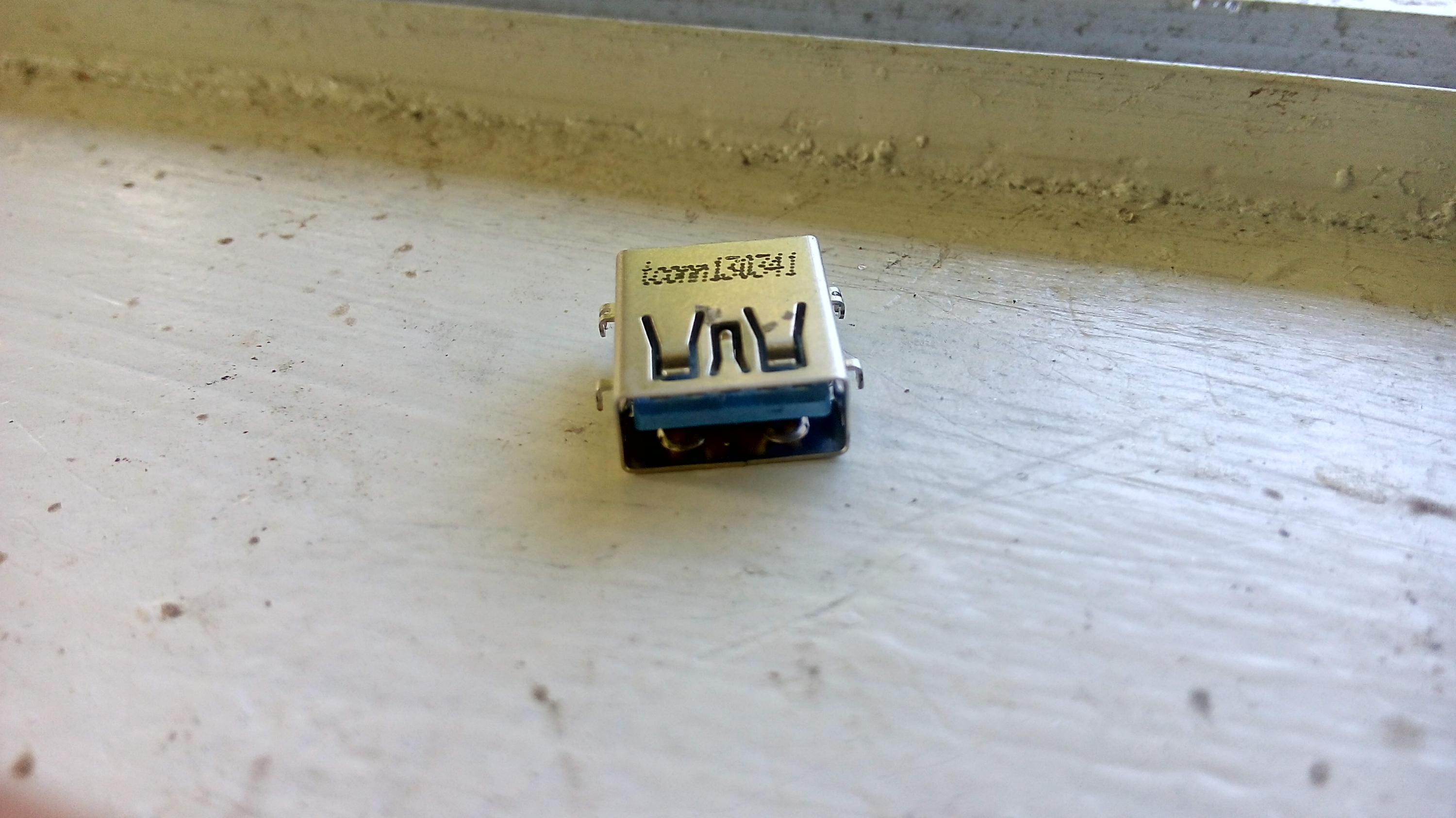

    i took this job because it seemed simple enough and i have the soldering and desoldering gear to accomplish it.
    the client gave me his motherboard and a replacement usb jack he had purchased already on ebay. it was supposed to be a simple swap of the usb 3.0 receptacle.
    well i got the old one off, and went to put the new one in, when i noticed it wouldnt fit.
    the old usb receptacle has 4 pins in the top row and 5 pins in the bottom row.
    the new usb receptacle is opposite: 5 pins in the top, and 4 pins in the bottom.
    so apparently he ordered the wrong usb port, or they false advertised the wrong usb port.
    now im trying to look for the correct port and i cant find it anywhere. even the listing he bought from has disappeared.
    can anyone help me find the correct port to buy?
    thank you

    I think only singatron that had USB datasheet, but LOTES, FOXCONN, ALLTOP, T-CONN and other brands not available.
    http://singatron.com/category/?c=USB_JACK&pp=
    http://www.t-conn.com/cn/usbproducts...es=usb&types=3
    I suggest you try to seeking from acer's donor board as well
