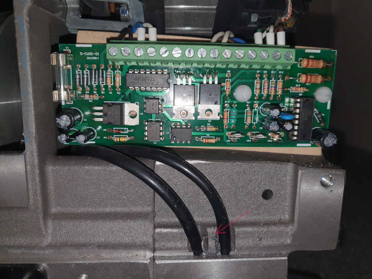

    I have an overlocker for stitching carpets and once I turn it on and leave it on the slowest setting, the speed will slowly increase by itself. When this happens, the voltage between the speed increase potentiometer, increases by 0.001V. I've stripped the thing down and the circuit board looks fine. Could this be a faulty potentiometer? Or something else? There is some soot inside the housing near the transformer and drive belts
    Pictures here: https://imgur.com/a/sUjRJrU

    Go for the simple things first. Check the current it is drawing from the socket. Maybe it needs to be taken apart, cleaned and lubed?
    You can check the pot with your DMM and verify for smooth operation.

        Someone else has been in here doing repairs. The main speed control IC Atmel U2010 is in a socket and many connections resoldered etc.
        The IC socket looks like it's cracked or pins did not go in straight? The triacs need a heatsink so I can't see them taking much abuse.
        The speed control potentiometer resistance should not jump around unless it is dirty or burnt inside. I would disconnect any two of its wires and check with an ohmmeter.
        The motor's commutator has a lot of carbon on it, I take fine sandpaper and scrub that off. Most of this looks new.
        If you add a pic of the board's backside, I could figure out the calibration trimpots VR2, VR3 what they do.
        There's a loose metal washer in the picture, shake it out.
          Ah yes I didn't spot that.
          I've just had it running with a thermal camera and only one of the triacs got hot and a few of the other parts, only ~50C so nothing crazy. The 2 resistors above the IC went to 300C after a few minutes though!
          I stripped down the potentiometer, it looks alright inside but gave it a good clean. It did seem to run a little better but the speed wasn't solid, at least we can cancel that one out.
          I'll get the motor commutator cleaned up and get you a picture of the boards rear next.

              Ok so here are a few pictures https://imgur.com/a/9mlfzEb
              I have traced what the 2 resistors are attached to, they're attached to 3 pins but only 2 of them are connected. 1 goes to the motor the other into the yellow relay which then is connected to the front panel which houses the on/off switches, the counter and the control with on/off trigger and speed control. Not sure what part it is connected to though. I get no continuity when flipping the switches, increasing the speed etc.
              Here's a couple of pictures of the front panel https://imgur.com/a/7gxIe8B you can see the blue and brown wires entering it at the bottom

                                I'm not sure what resistance readings you now get from the speed control potentiometer. I wondered if its wiper was open-circuit and the speed control board floating with no speed command coming in? Do the switches work OK or is it stuck running?
                                The two 24k resistors R16, R17 will run quite hot, they each dissipate around 2.2W each which is a lot. But not 300°C, I'd guess around 100°C is a max.
                                As for what's wrong with this thing, it's either the speed pot or the IC or the calibration or (less likely) the electrolytic capacitors. You'd have to take voltage measurements while the board is powered up, which is no fun. The IC needs around 14VDC power.
                                It's hard with no wiring diagrams although the same speed controller scheme is used on many power tools. This overlocker one just has a soft-start (many seconds to ramp up motor speed) and variable speed. There is no load compensation or tachometer circuit.
                                I would pen-mark the trimpots VR2, VR3 location and give them a turn to see what they do. I can't follow their PC board traces running to which IC pins to figure them out. Note this board is hazardous live so use an insulated screwdriver...
                                At this point I'd likely put in a new IC and make sure the triac is OK.
                                You could short the speed pot forcing it to minimum speed (resistance) or maximum speed to see if the IC is responding at all.
