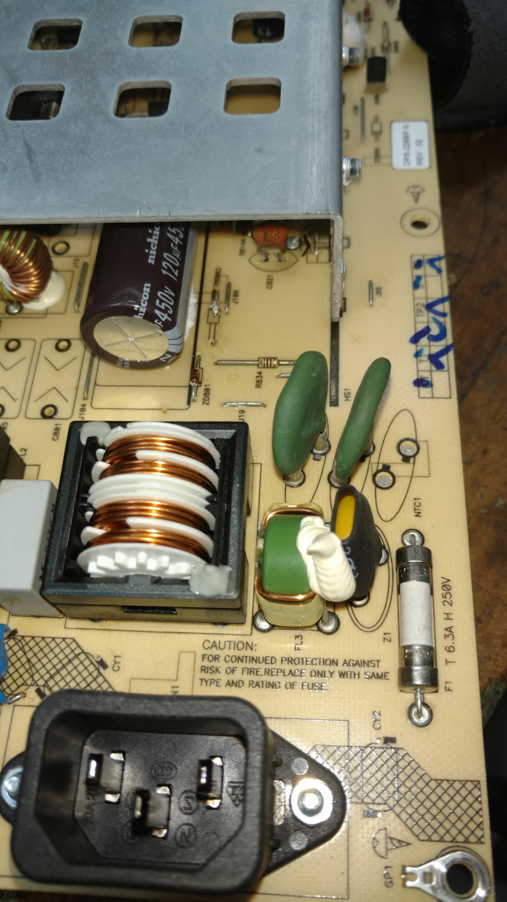

    Id this resistor please

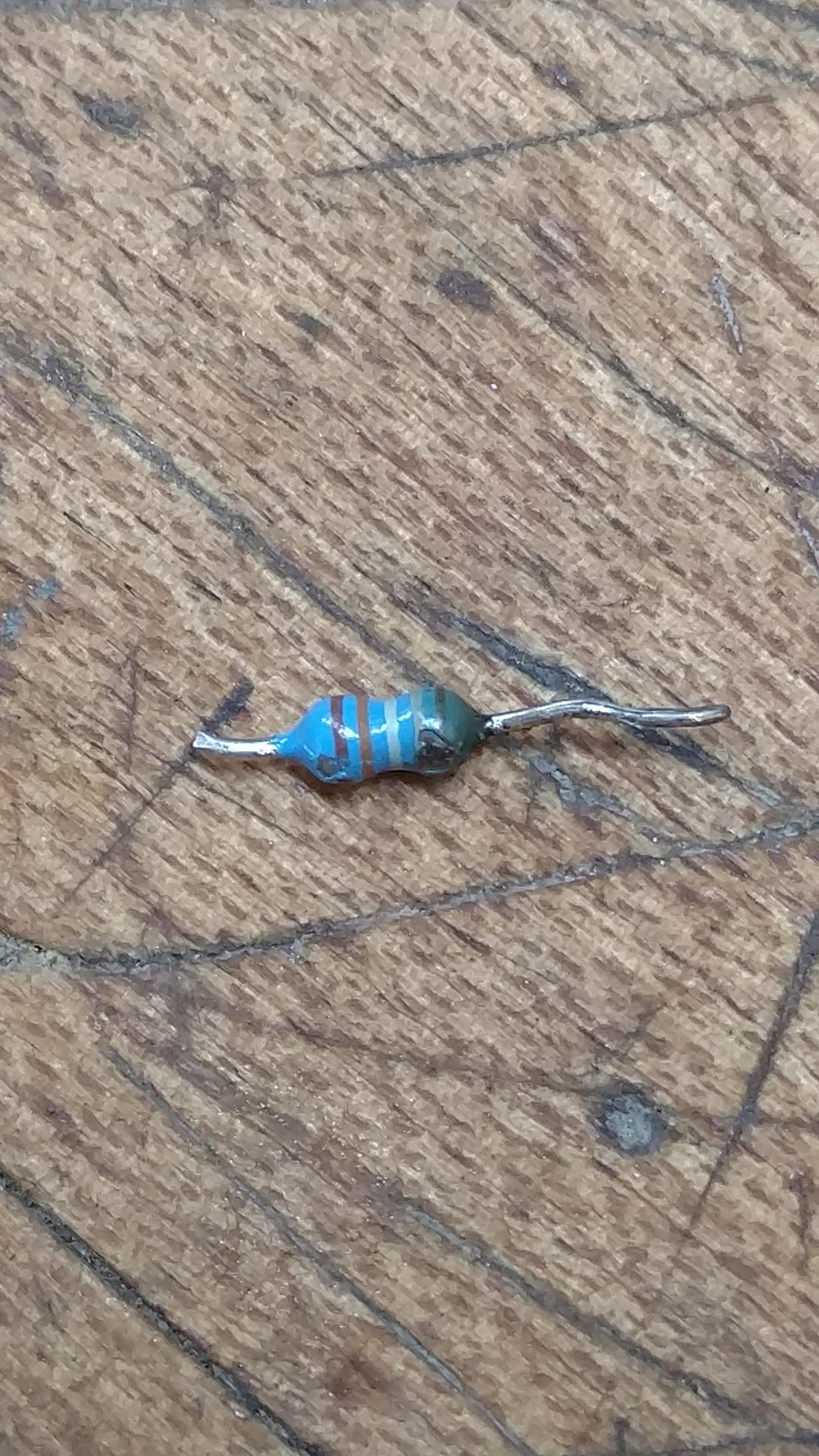

    Trying to ID this resistor not having much luck any help would be appreciated. Thanks

    Re: Id this resistor please
    * Inductor
    Follow the white rabbit.
    • eccerr0r
      Solder Sloth
      • Nov 2012
      • 8695
      Picture of board would be interesting.
      Color code is weird possibly indicating inductor, but usually inductors are green...

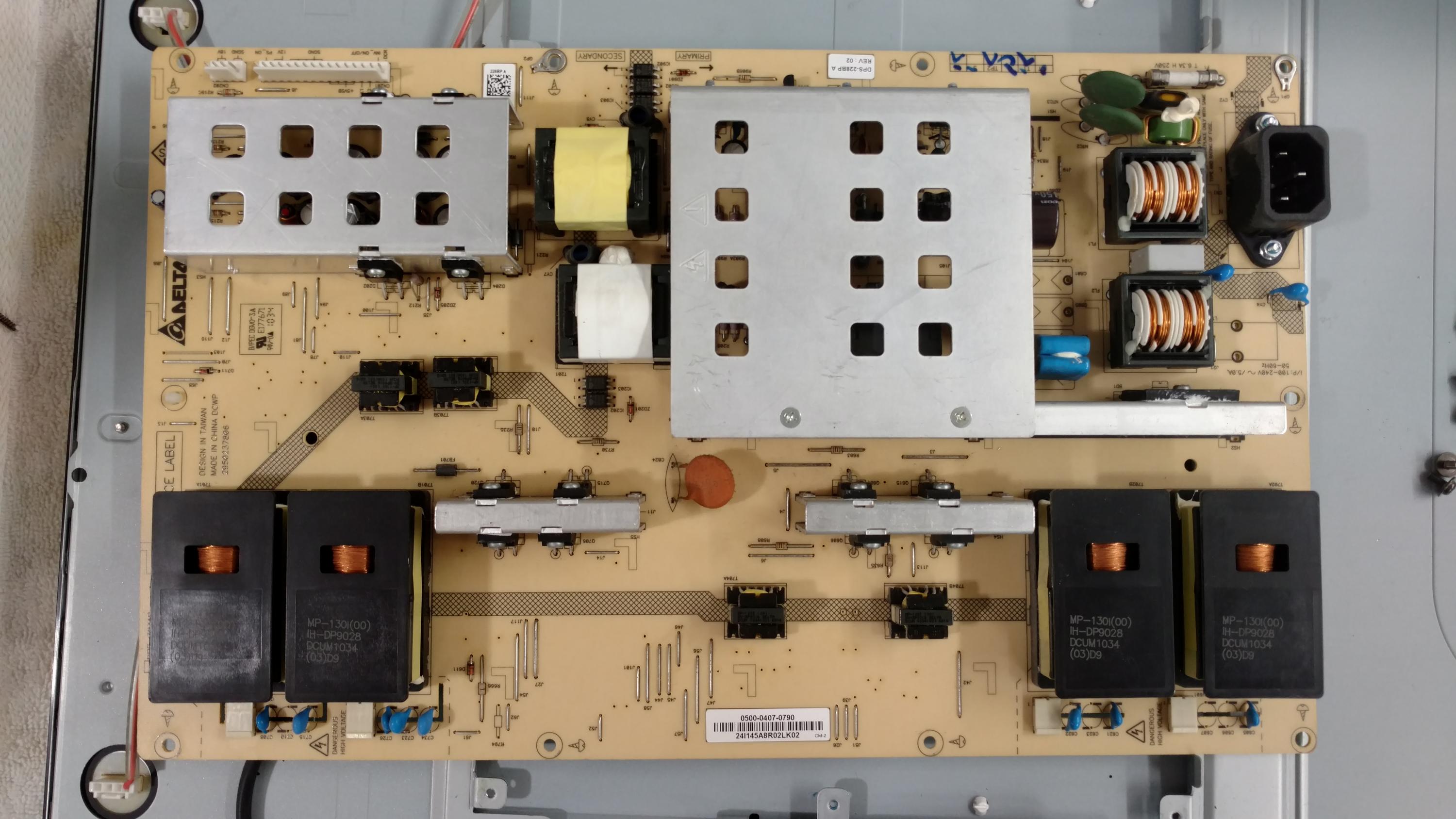

            I will get some pics of the board today. Its from a Vizio 42". I can tell you it is marked R808D on the board.

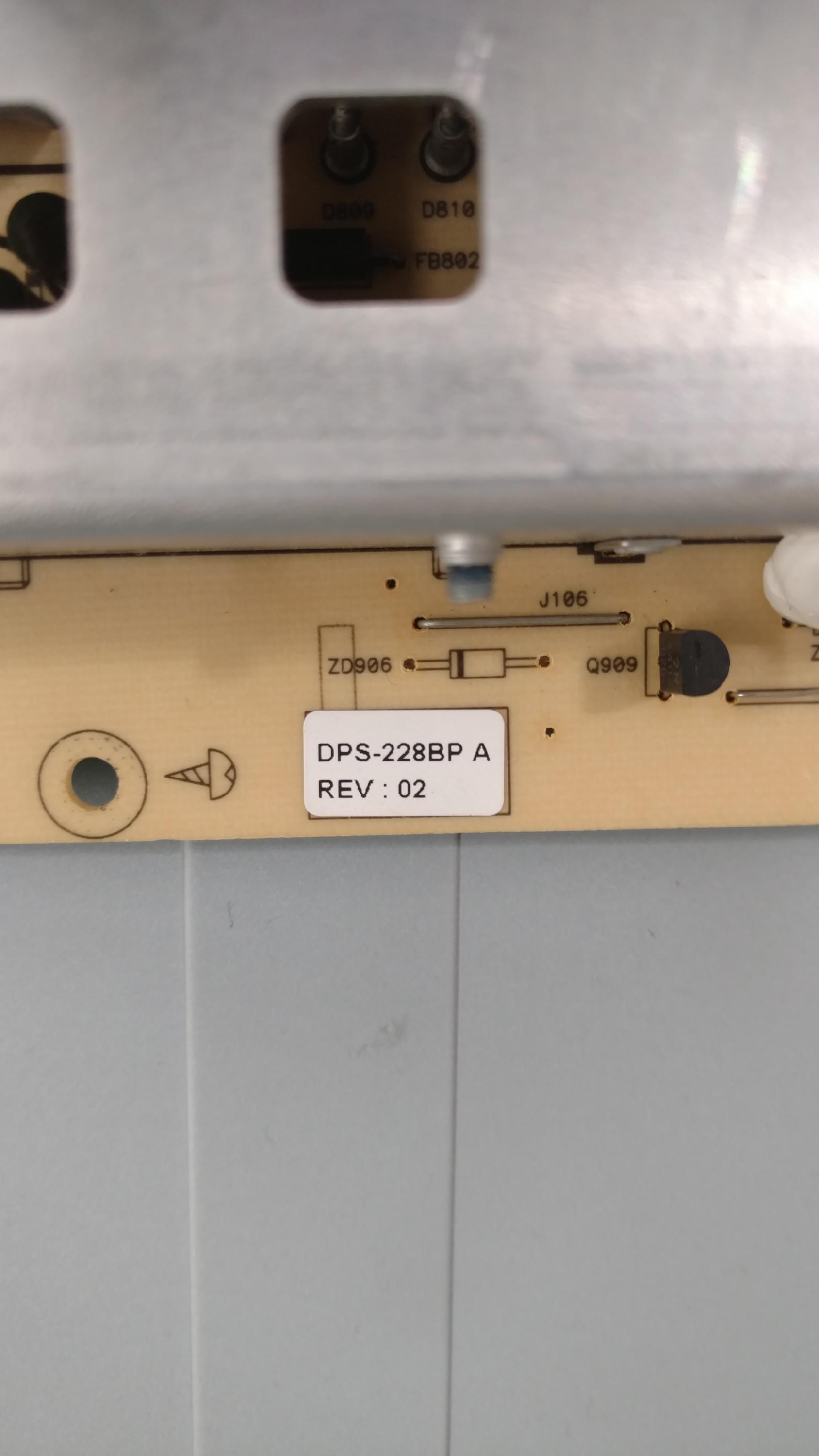

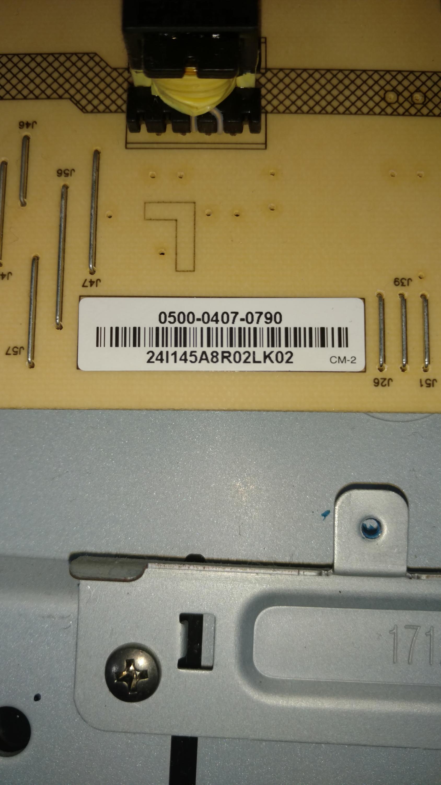

              So it is resistor, cannot tel what its function is until I get to see the good clear picture of the board.
              VIZIO model ??????
              Board P/N???????

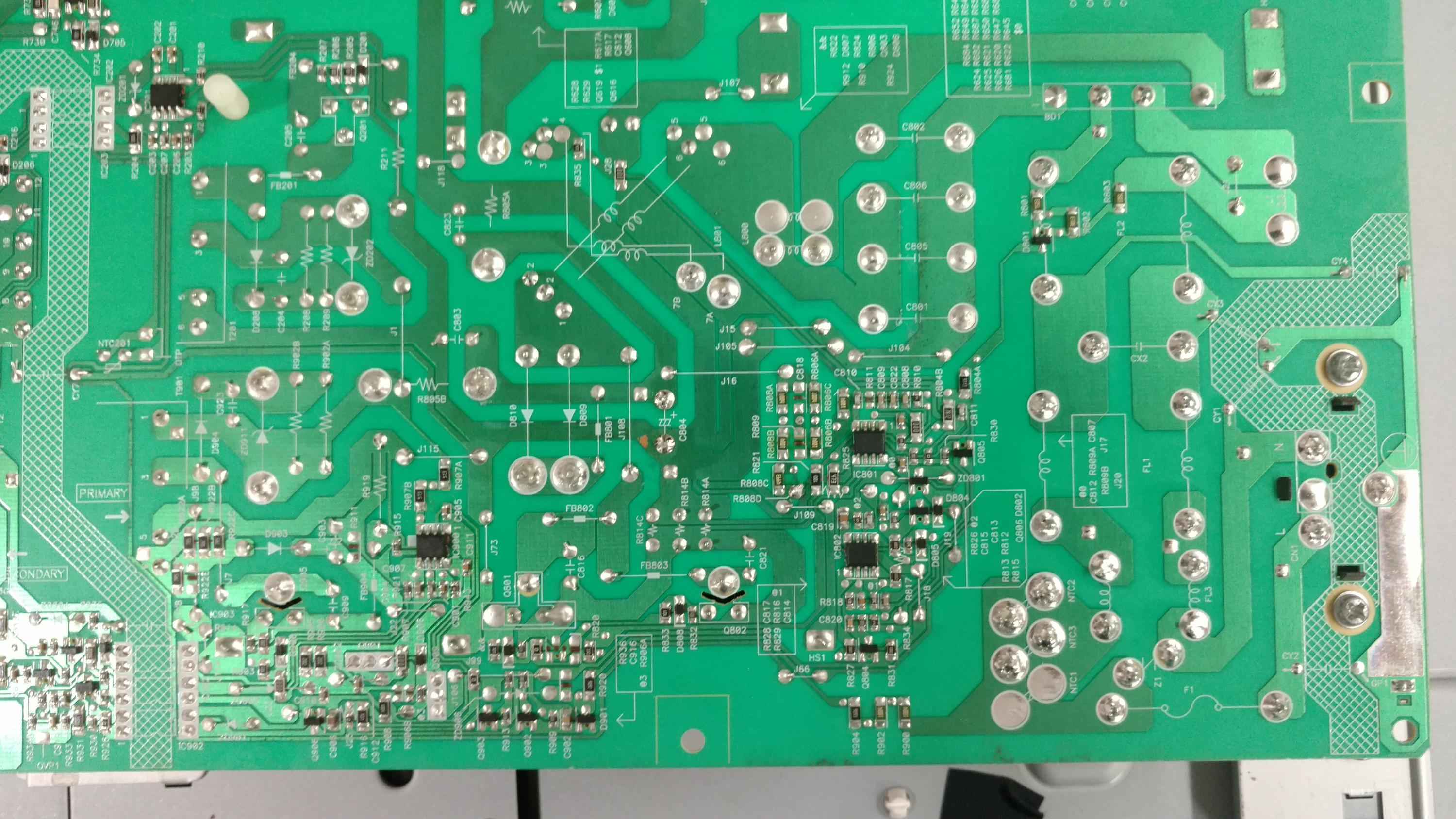

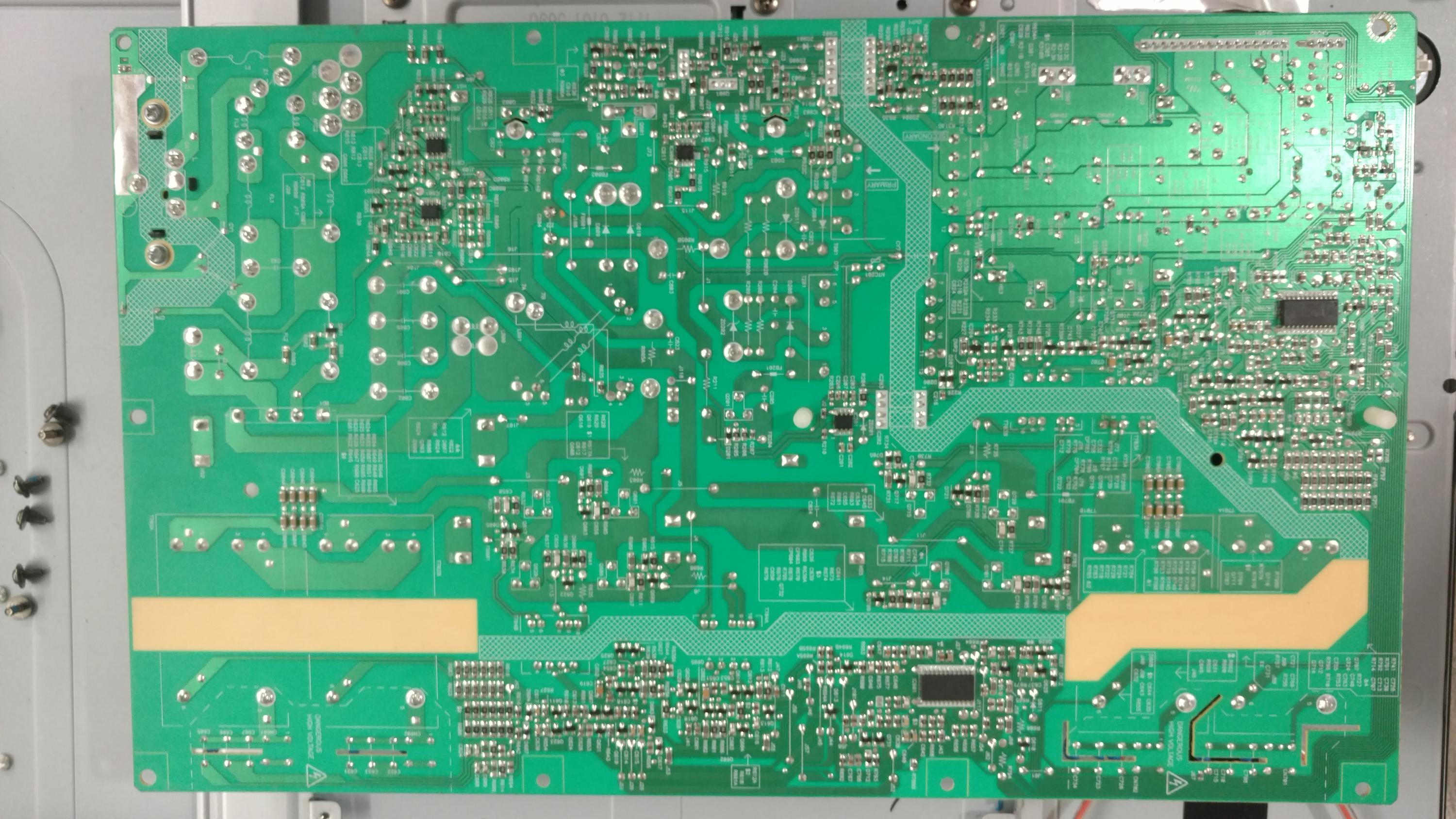

                Here you go...just a little background. while replacing the cap next to this resistor I damaged the resistor now requiring to replace it as well.
                • R_J
                  • Jun 2012
                  • 9535
                  The resistor does look a bit damaged but the value might still be ok, try and measure it.
                  The damage was not caused by circuit failure and seems to be in series with R808A, B, & C from the main cap to the ic802
                  Also knowing what the number is on ic802 might also help
                  • eccerr0r
                    Solder Sloth
                    • Nov 2012
                    • 8695
                    These are all GUESSES:
                    Guessed value is: 499KΞ© β…›W (yellow white white orange red?)
                    Guessed purpose for resistor: startup resistor for off-line SMPS
                    Guessed criticality of resistor value: fairly low
                    And agreed, that resistor may still be good, measure its resistance. As it's mechanical failure, it should fail open...
                      I would agree 499K, there are 2 other resistors in series, R808A=1meg, R808B=1meg & R808C=499K.
                      I suspect R808C and R808D combined would = 1meg but instead of another surface mount 1meg and a jumper wire, they used 499k a regular 499k resistor to jump across the other traces
                        I must be colorblind lol. I see Blk,Silver,Gray,Brown,Violet.
                        • landyboy
                          • Apr 2013
                          • 443
                          I tested the resistor and I am reading 503 on the 2000K setting.
                          • eccerr0r
                            Solder Sloth
                            • Nov 2012
                            • 8695
                            Nah, the colors have faded due to some heating it seems. We weren't really using color, but judgement from seeing many similar designs.
                            Anyway, 503KΞ© is within 1% of 499KΞ©, so I think just reinstall that resistor.
                            At the worst the power supply is dead and you know which resistor is bad...
                              Before I removed the small resistor I tried that. First replacing the large cap right beside it. The set would come on and work a while then shut off and the old cap was bulged badly. But as I said I thought I damaged that resistor but did leave it in place at first and the set would not even power up. So I made an assumption that it was bad. Ugg
                                  It'd be a strange inductor since it has an R808D component designator...
                                  As R_J suggested, get us the part number of the IC (IC802) that it's connected to... then might be able to reverse engineer the value...
                                  ... or if someone somehow finds the schematic...
                                    When you were replacing that cap, and damaged the resistor, Did you remove the 2 screws from the heatsink and bend it back to access the cap, by chance... If you did check the legs on the fet's to make sure they are not broken
                                    Have you ever measured the voltage on the cap ? to see if you at least have 160v or 400v if the pfc is working

                                        RJ I did not, I worked it without moving the heatsink. I did get a replacement 499k Res and replaced it. Same thing will not turn on. I must have done something. Like I said it would turn on before I did anything but then shut of and that cap was badly bulged.
