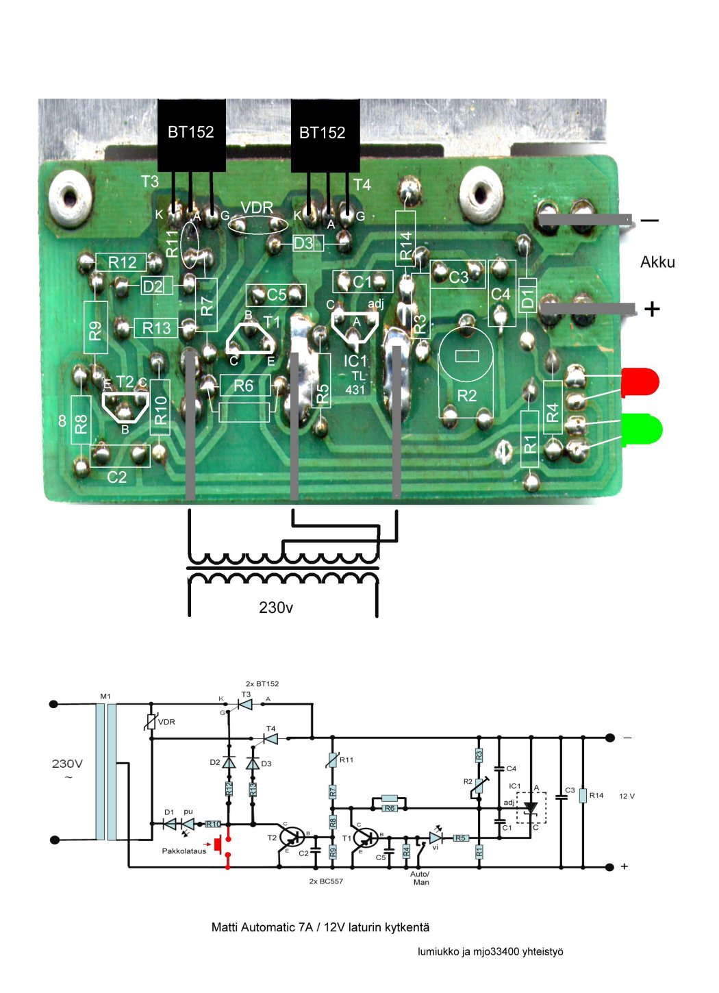

    Having problem with a Matti automatic car battery charger. (Matti automatic 12V, 7A)
    The charger is not working. Here is the PCB and schematic view for the device.
    Already checked the BT152, BC557 and TL431 and they are fine. D1,2,3 are fine too. The first VDR checked ok. As for the R11 which according to schematics is also a varistor/ thermistor (why its named R11 is a bit confusing) I'm getting very low resistance, around 57 ohms.

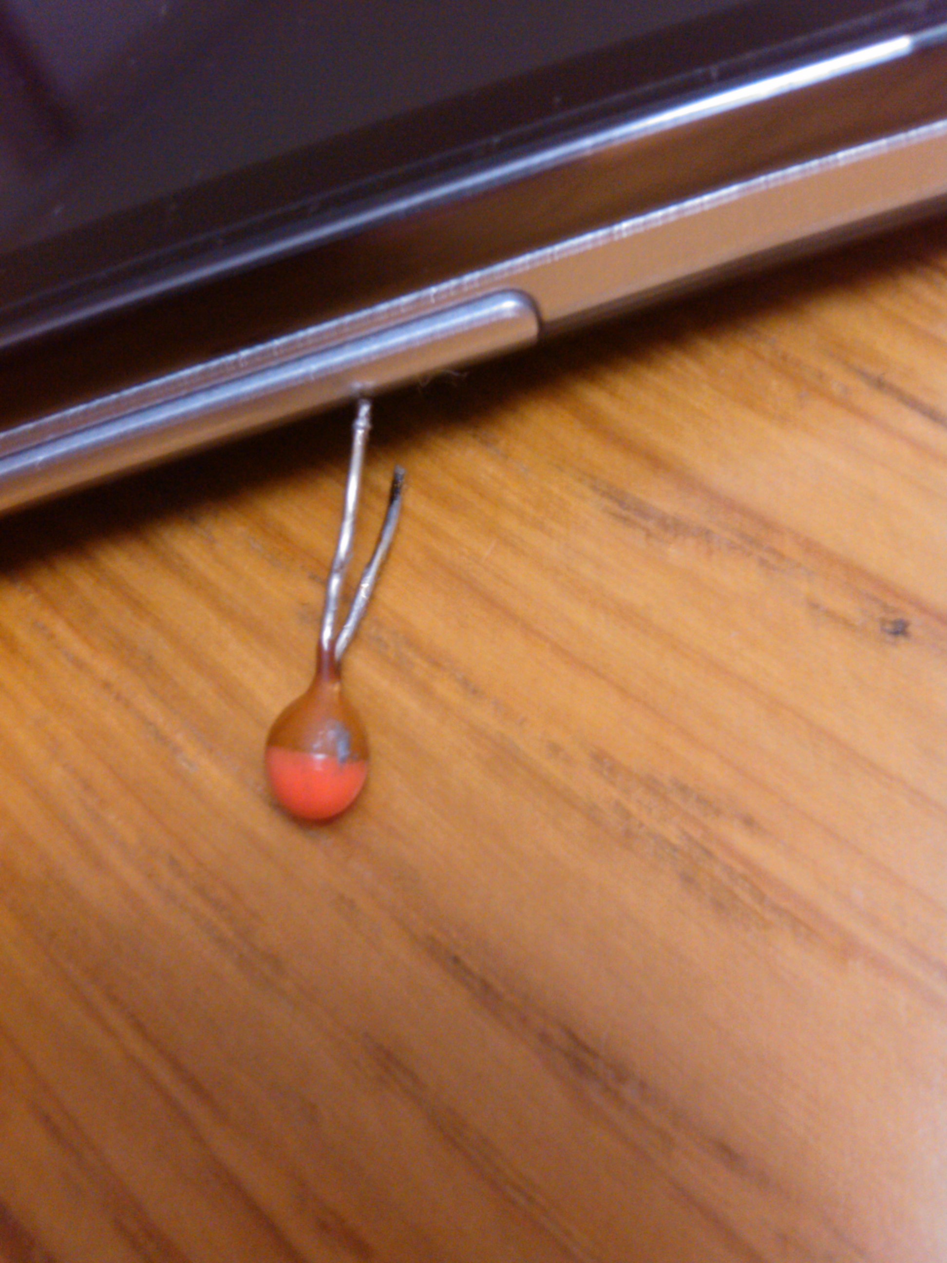

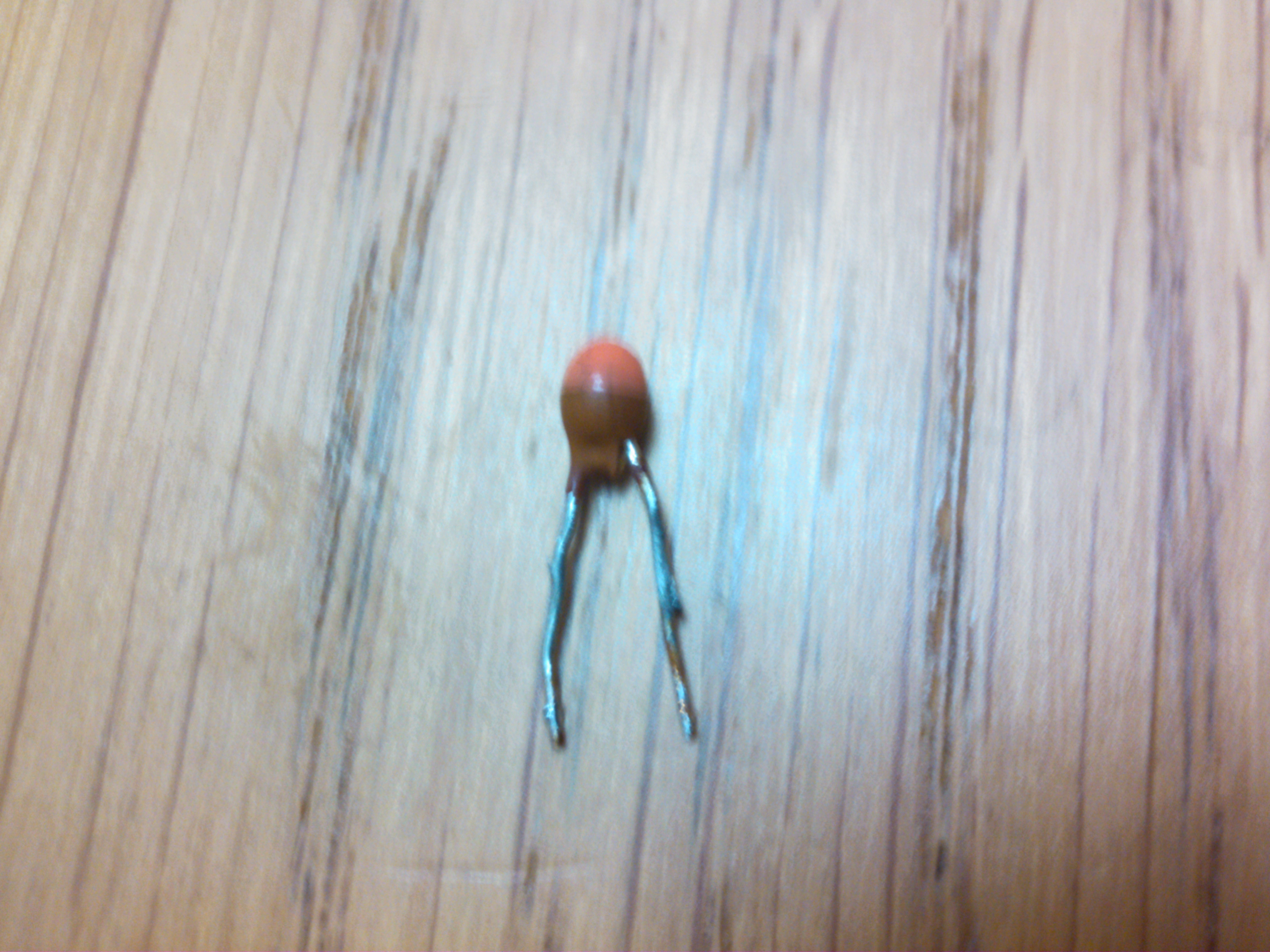

    I attached two pic for R11 and need help identifying its properties, values and whether is really a varistor or a resistor. As you see it has two colors, brown at bottom and orange at top. There is also a small ( grayish / green ) dot as of the sec pic.
    Thanks a head for help and any further ideas of further troubleshooting would be appreciated.

    With some further testing R11 seems to be a NTC thermistor. But is the value of 66ohms right????.
    I can see its responding to temp change but drop of resistance as temp rise (getting closer to bench light bulb).
    Ant help appreciated.

      what exactly is wrong?
      from that diagram, if you push the button in, you should get 12v at the output.
      if you dont, i'd start by testing your transformer.

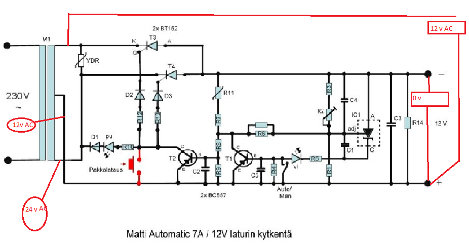

        Well the only button is for the manual/ automatic, the on/off button here is not present.
        I'm getting no reaction when bat attached for charging, no led lit. Usually the red lit first until its fully charged then green led lit.
        As for the transformer, it's providing 12 and 24 v at secondaries according to attached pic. I also get 12VAC at terminal according to pic but 0v at terminal tested against each other.
        What's wrong?

          if the red button is missing, add one - then see if pressing it in make the output turn on.
          if not, your scr's are suspect.
          if it does then you need to look at the transistors.

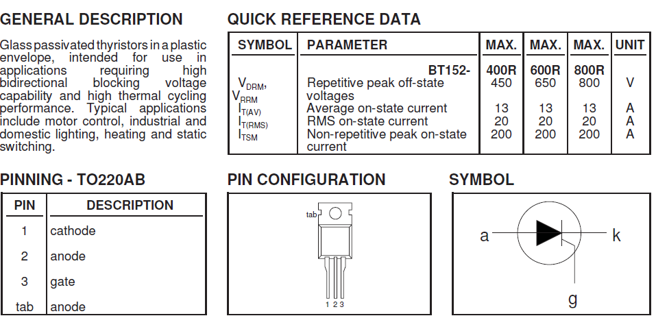

            Transistor BC557c (PNP) both checked ok.
            Thyristor BT152 600r , how do you test it?

              fastest way to test the scr's is to just short the colector and emiter on t2 to turn them on.

                as for the BT152,
                I shorted the gate with anode which turned on connection between Anode and Cathode, Is it so you mean. Here's a bit of the datasheet.

                  This charger will not put out any Voltage unless it hooked up to the a working that still have enough Voltage to start the circuit, it is made so that if the battery Voltage is too low (bad batteries) the charger will not try to charge the batteries.
                  It is also pulse charging circuit, not clean DC output.
                  The Voltage from the good battery is used for running the circuit (T, T2, IC, etc.) to to turn on the SCR.

                      It's impossible to say if the resistance is correct without checking against another, known working unit or seeing the datasheet. But it's more likely for a thermistor to fail open circuit than drift in value.
                      The fact that it changes at all suggests it's probably OK, and you don't know what the characteristics of it are anyway, so even if it was faulty it's not like you could do anything about it...
                            Thanks everyone.
                            As simple as stated above the charger seems working with a bat that at least supply 11v. Turns out the battery I tested upon was almost dead.
                            The device working fine, no part was changed (p.s nothing was defective).
                            Thanks again for all help.
