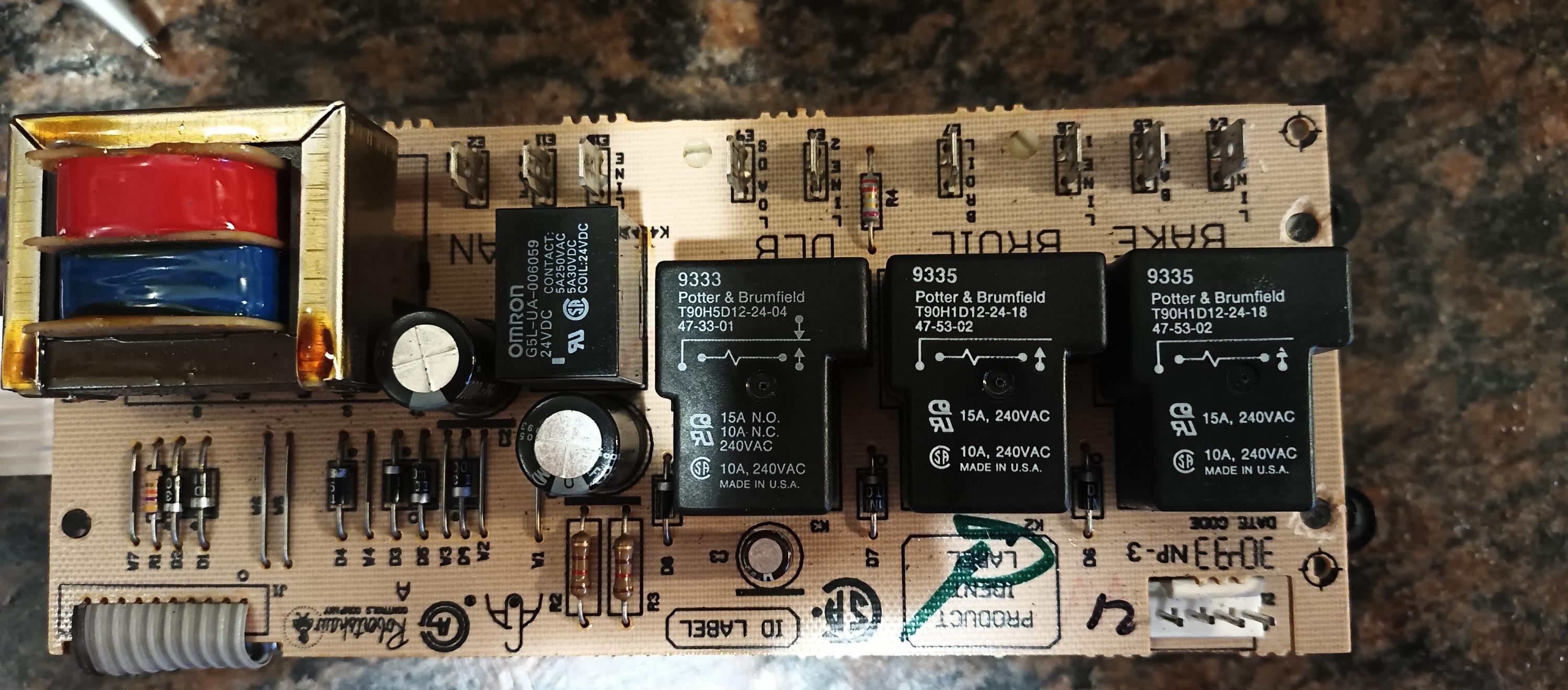

    I am having an issue with my wall oven temperature control is ~180f out of spec. The thermistor is measuring correctly but I noticed the ref voltage appears to be off. With the thermistor wires attached it's reading ~3.4vdc with the thermistor disconnected it's around I9.8vdc. my understanding is the temp is read off the resistance from the thermistor which leads me to believe the issue is with the ref voltage.
    Another observation is the temp setting and readout at lower temps is way off meaning the oven thinks room temp is 300f and bake relay doesn't engage unless temp setting is much higher..
    Anyone have any thoughts on what's going on? I plan on rreplacing the caps this thing is 30yo.
    I've also I'd a fan resistor that's not registering any ohms ATM the fan runs all the time so not sure if that's also causing the issue.

    Are there any components on the other side of this board if so could you post the picture of the back of the board

        Re: Magic chef oven - thermistor ref voltage issue
        Model C9875VRV
        Control Board part number 7601P225-60
        The top board has 3 separate single layer boards this top board does not have any other components just traces.
        Middle Section is where the IC is
        Bottom Section is for the controls and display
        The thermistor is reading correctly at room temp and when hot.
        The R4 resistor is a bit of an oddity I read it as Violet, Yellow, Yellow, Red, Red which is a odd ohm 744k (there is no resistance across this) Can I just replace with a 750k 1% resistor here?

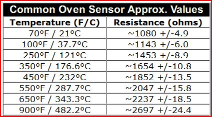

            Oven temperature sensor WPW10181986 commonly used in Whirlpool, Maytag, KitchenAid, Jenn-Air, Amana, Magic Chef, Admiral, Norge, Roper, Sears/Kenmore and others.
            It's an RTD (not a thermistor) aka Pt1000 so resistance goes UP with temperature. Resistance table is like this pic.
            Check the sensor resistance with a multimeter, as well check isolation resistance to the sheath/chassis to see if it has a ground fault. Check the connector is not corroded/melted as well because only a few ohms change causes large swings.
            You can also jumper in a resistor in place of the sensor, to see what the control board displays.
            1,000Ω should read around 32°F/0°C if the oven is OK with such a low temp.
            2,200Ω should read around 613°F/323°C.

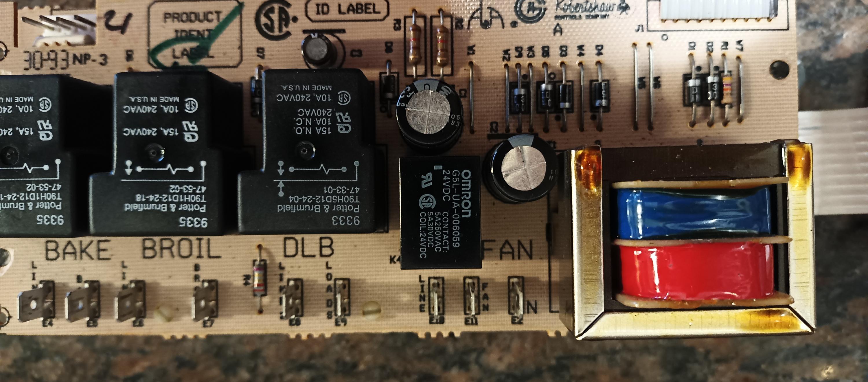

              The resistor is between the relay and fan pin. I did some more research it looks like a fuse resistor does that seem right?
                Yes it could be a fuse resistor, What resistance value does it measure?

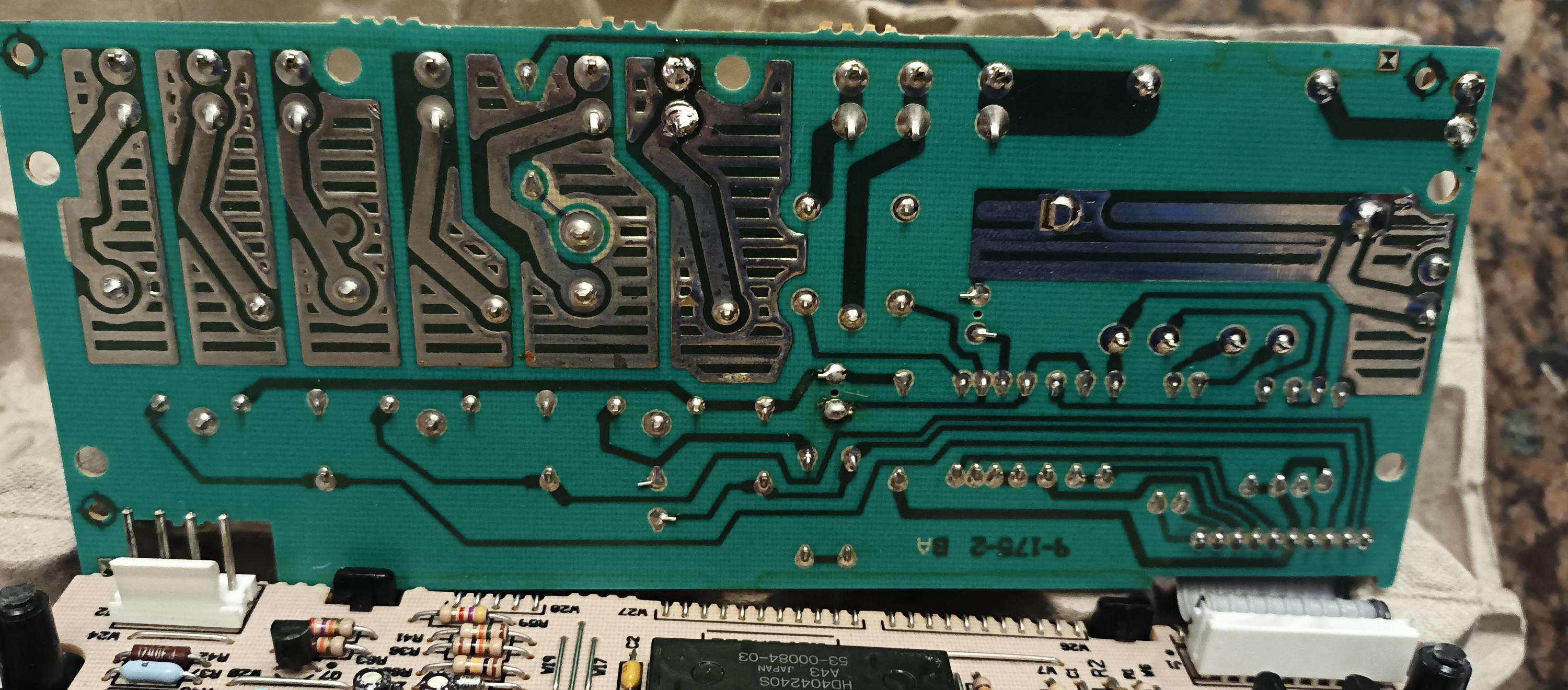

                Also post a clear picture of the back of that board so we can see what it connects to.
                  R4 is open no resistance
                  Back of board traces
                  Second board pic
                  Also transformer between
                  pin 1-4 142ohm
                  pin 8-5 175k ohm
                  Diode 4 and 5 both registered .526 but when tested other way around went up to 2.0 then 0 not sure if that's from the transformer??
                      R4 fusible resistor is for the DLB safety relay K3, I'd say it blows if there ever is a DLB problem. Who notices? Must be a repair indicator.
                      Has the oven ever had a failed heating element (ground fault)? That can take out the temp sensor and circuitry.
                      K3 has a fractured soldering joint on the spade BTW. Other touch ups look like not enough heat/time for soldering technique on the big through hole parts. Jack up the iron temp at least 700°F/370°C and hold for a second or two longer.
                      Given the age 30 years and rarity of this board, I'd replace the electrolytic capacitors certainly on the PSU/Relay board, and only 3 on the MCU board.

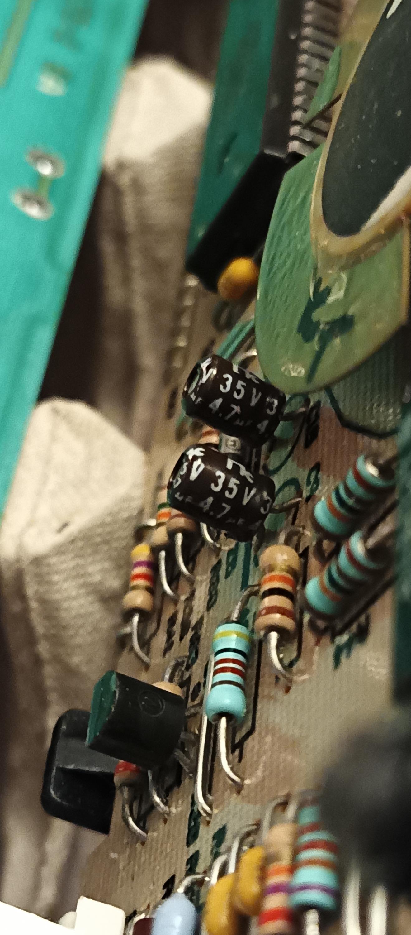

                        Looks like we may have found the issue..these caps in macro look buldged out. Digikey didn't have this form factor they are height of 6mm 4.7uf 35v
                          Such small caps don't bulge, what you are seeing is just the heatshrink sleeving.
                          That said they do dry out and after 30 years they are probably bad if they ran at all hot, so good idea to swap them out.
                              With the longer replacement caps, you can just lean them sideways on the board. That should allow you to fit standard 5x11 mm caps. As a bonus, since they are bigger, they should probably last longer too.

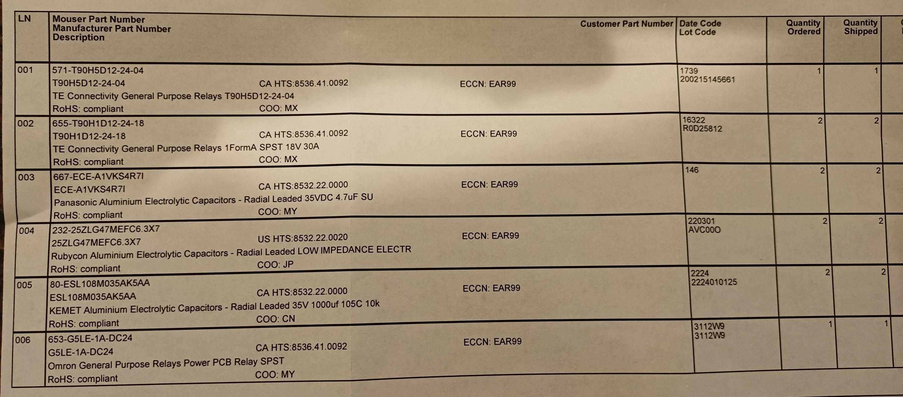

                                    Can you post the cap size and values you replaced, to help others doing this repair.
                                      Power board 2x 1000uf 35v
                                      Power board 1 47uf 25v
                                      Ic board 1 47uf 25v
                                      Ic board 2 4.7uf 35v
                                      Attached component bought from mouser. I bought the 4 relays but didn't install them. These become unobtainium so figured best get spares.
