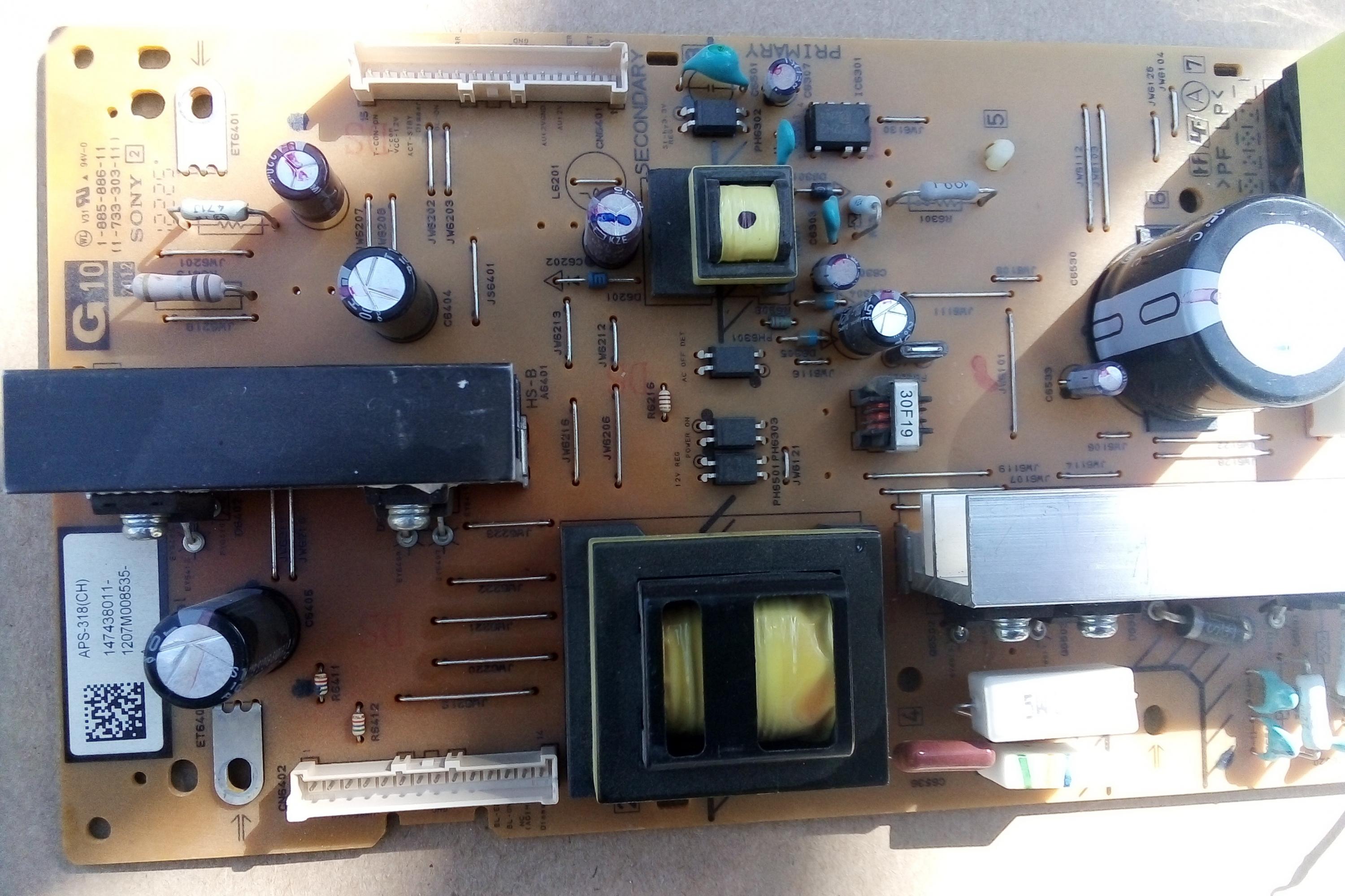

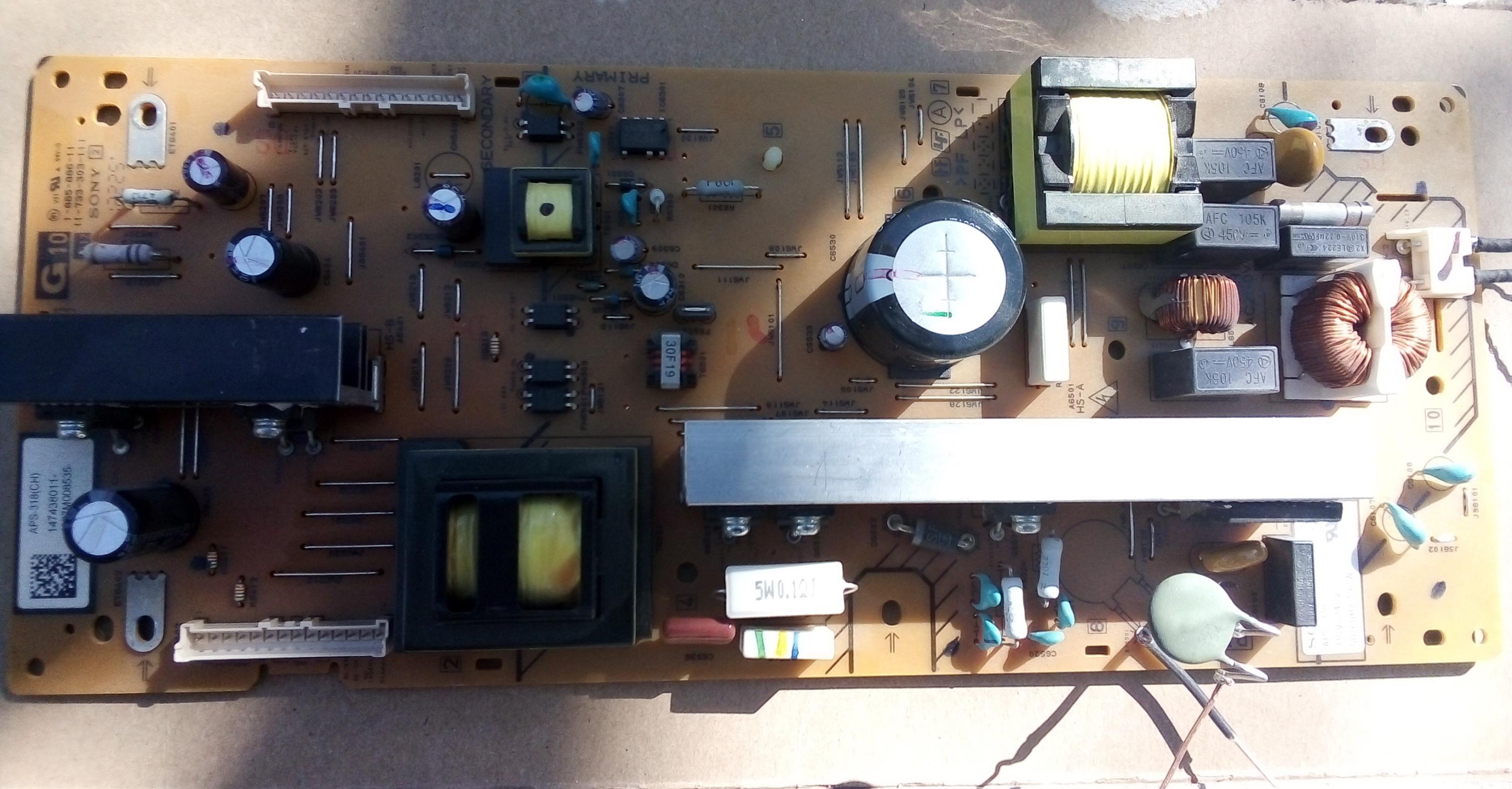

    Hello every one,
    This TV came to me with the problem that it was totally dead.
    The problem was the two MOSFETs and a fuse resistor in the power supply.
    The original MOSFETs were KF7N50F and I repalced them with SLF65R700S2.

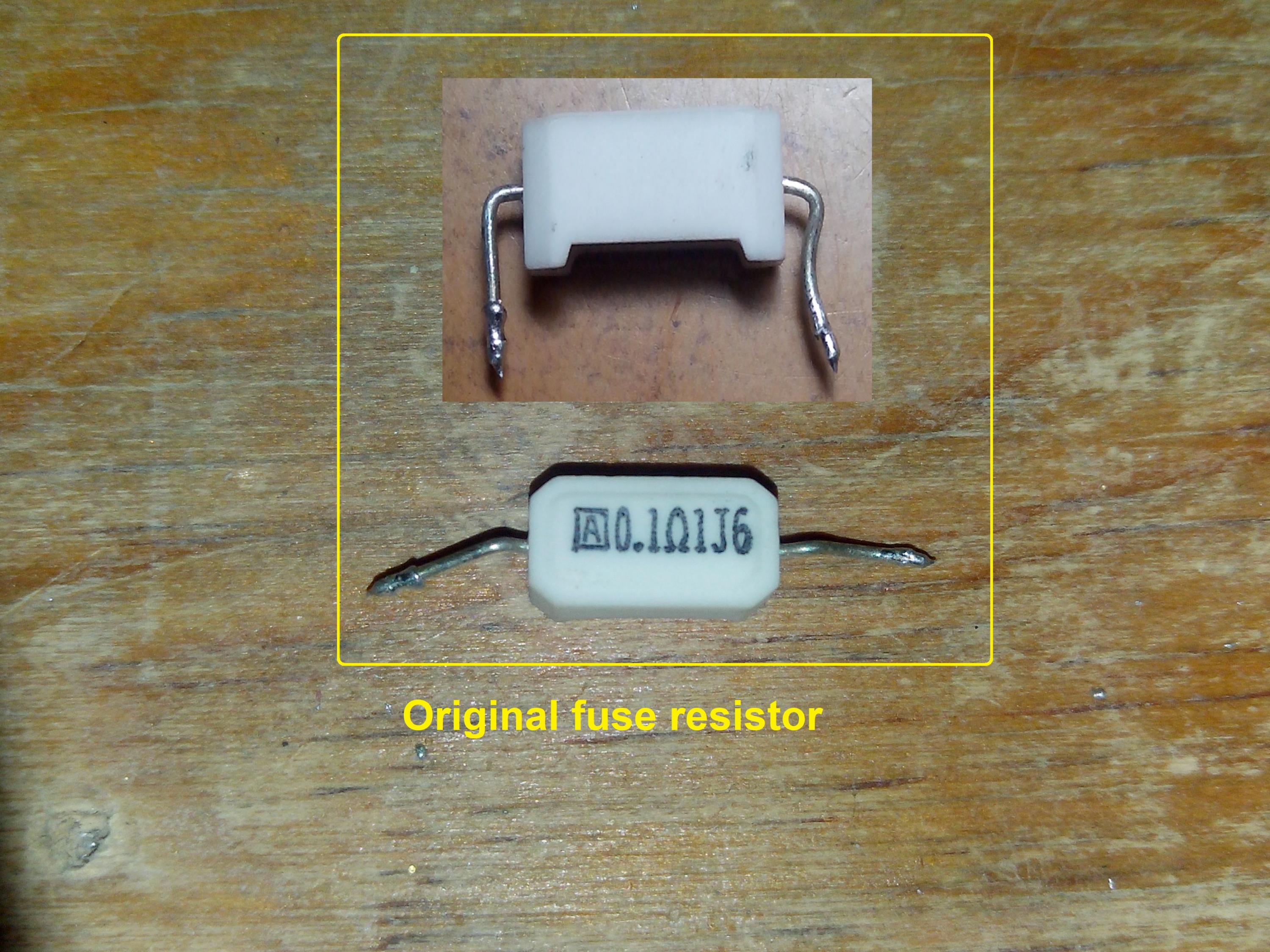

    The original fuse resistor was 0.1 Ohm 1/2W. I didn't find a similar fuse resistor and I replaced it with 0.1 Ohm 5W ceramic resistor.
    When I plug the TV the ST-BY LED turns on, when I press the power button on the TV, the ST-BY LED turns off and the TV doesn't turn on until the second time I press the power button is when the TV turns on, but for a span of about 10 seconds the thermistor gets too hot. It is unbearable to the touch. Burn the finger.
    I turn the TV off before somthing bad happens, but the ST-BY LED doesn't light, when I press the power button again, the TV turns on but the thermistor reheats again.
    If I unplug the TV and plug it again the ST-BY LED lights up.
    So I ask you guys
    What causes the thermistor to get too hot?
    Why doesn't the TV turn on the first time I press the power button?
    I have 389V on the main filter.
    I have the 12.3V and 25V.
    When I bridge between ST-BY and POWERON the SMPS works fine and the thermistor doesn't get hot. I assume it's because the SMPS has no load.
    I attached a similar diagram because I couldn't find the diagram for this SMPS.
    Similar schematic diagram is on page 28.
    I you need more info just let me know.
    I hope you understandme. I'm still improving my English. Sorry
    Best regards.

    A good picture of your board would help. Your thermistor is probably bad.

      installing a 5 watt resistor for a .5 watt is like replacing a 1 amp fuse with a 30 amp fuse. If there is a fault the fuse resistor will not open like it is designed to do.
      The thermistor will get hot, as its temperature goes up its resistance will go down. It could be there is still a fault causing the circuit to draw too much current and over heating the thermistor, normally if there was a fault the fuse resistor would open but not when it is a 5watt ceramic resistor.

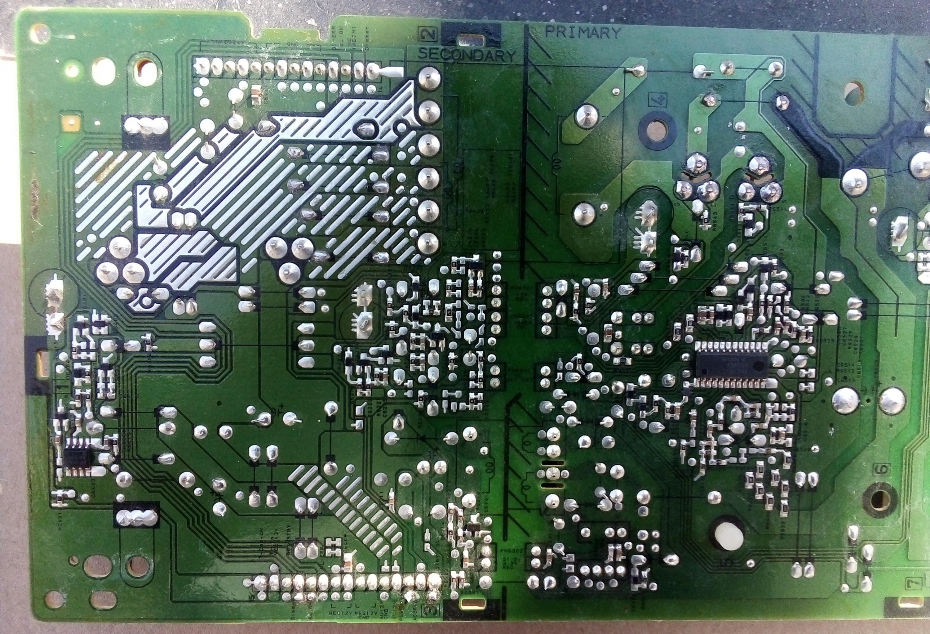

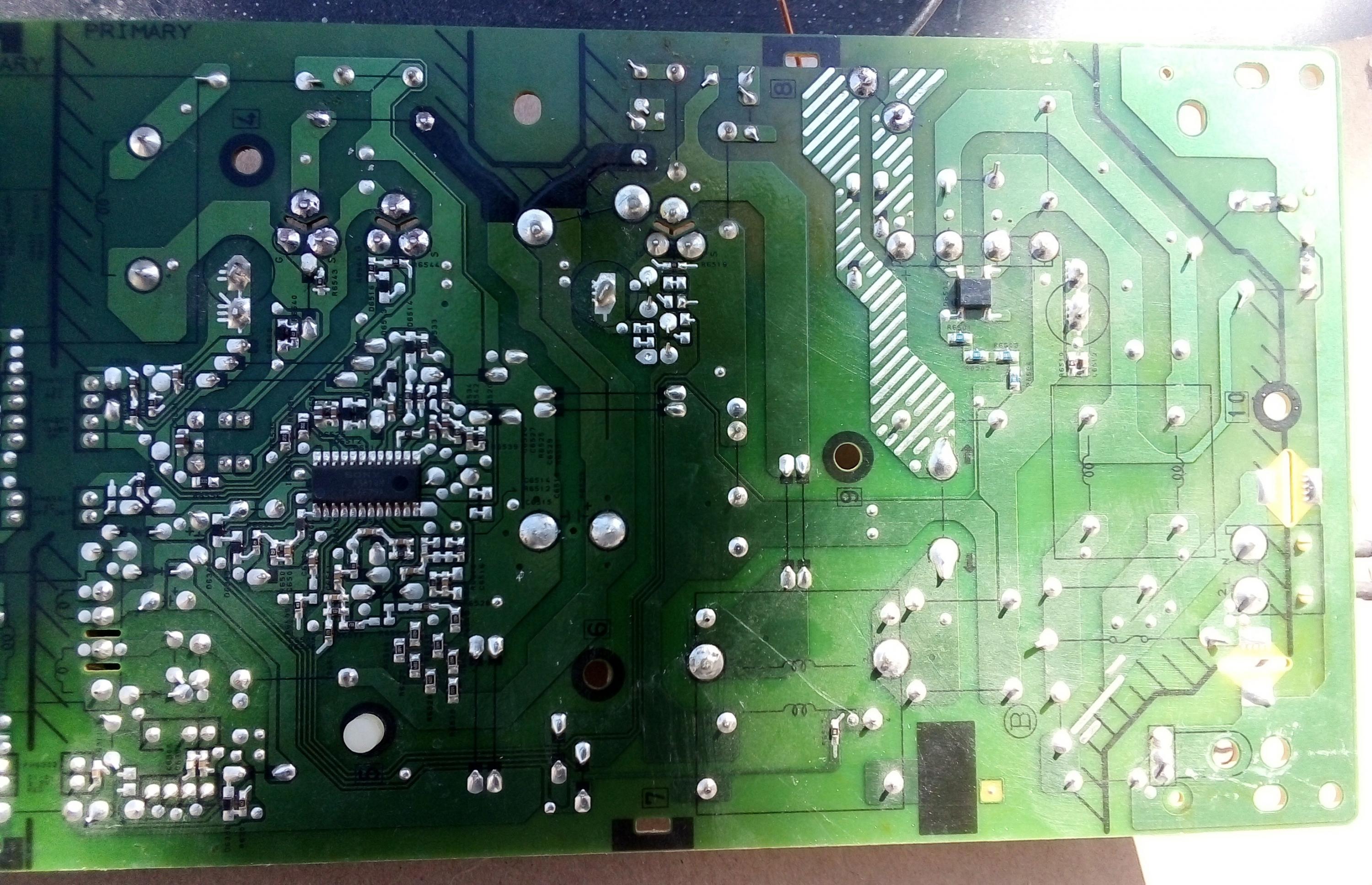

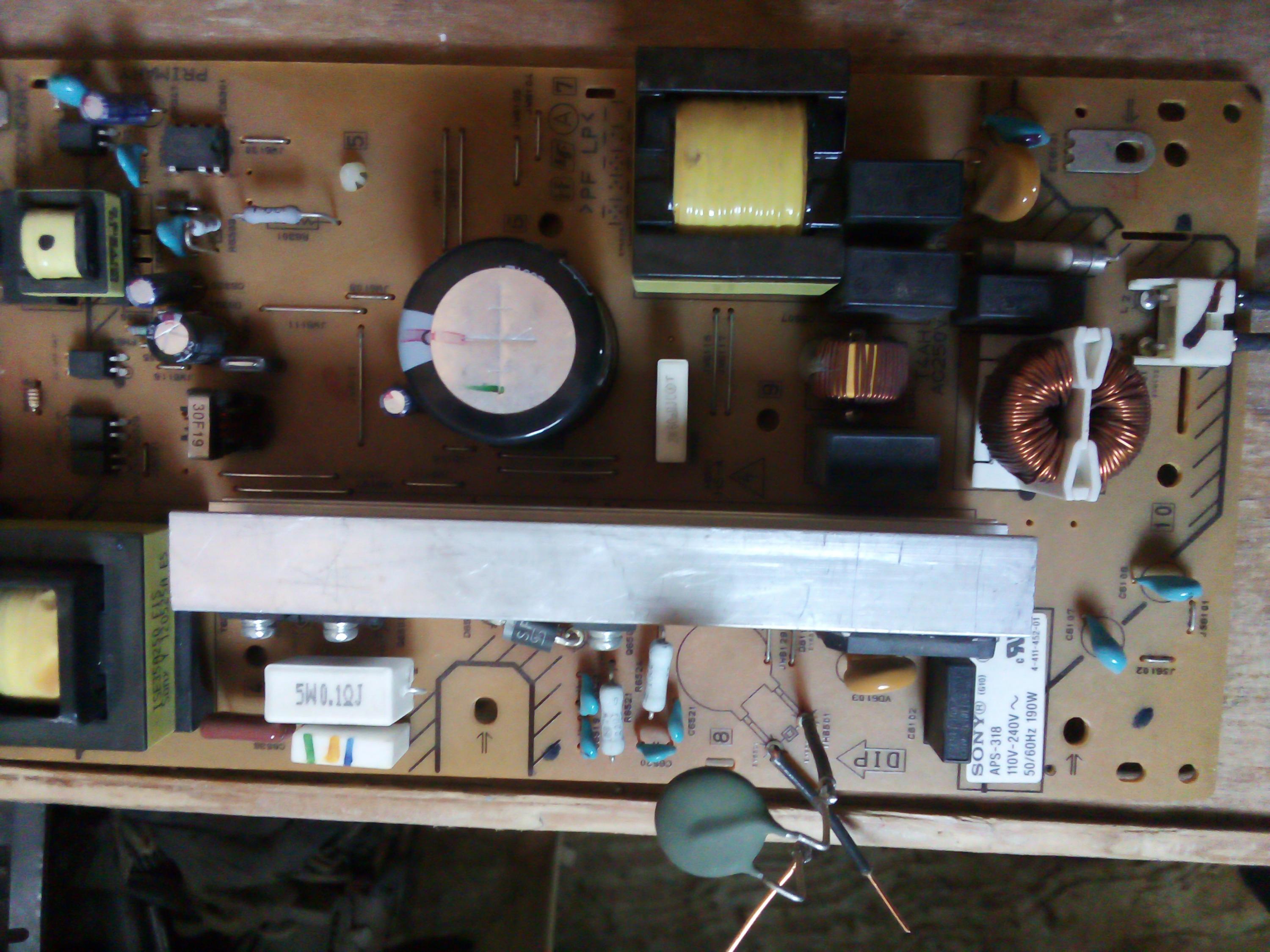

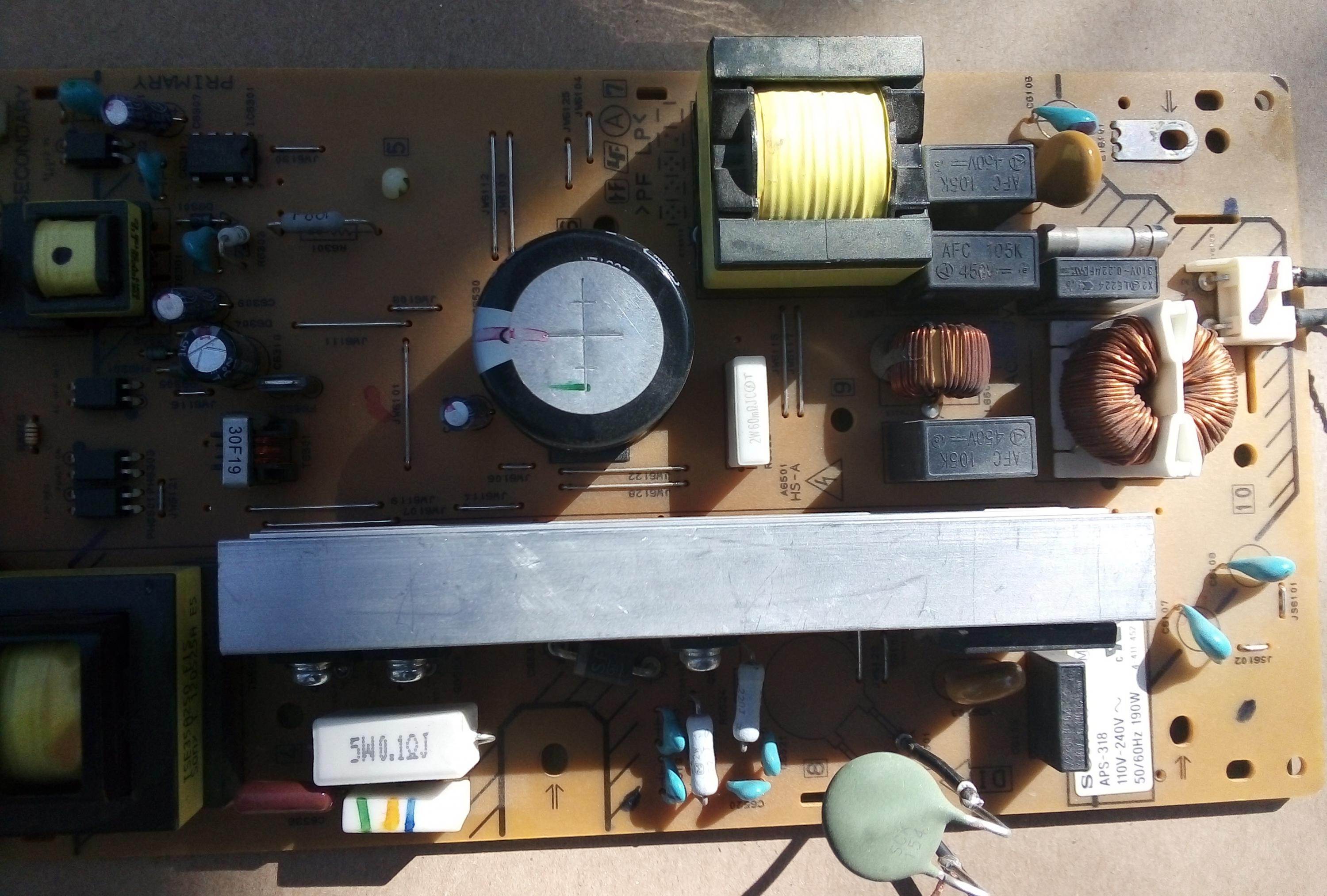

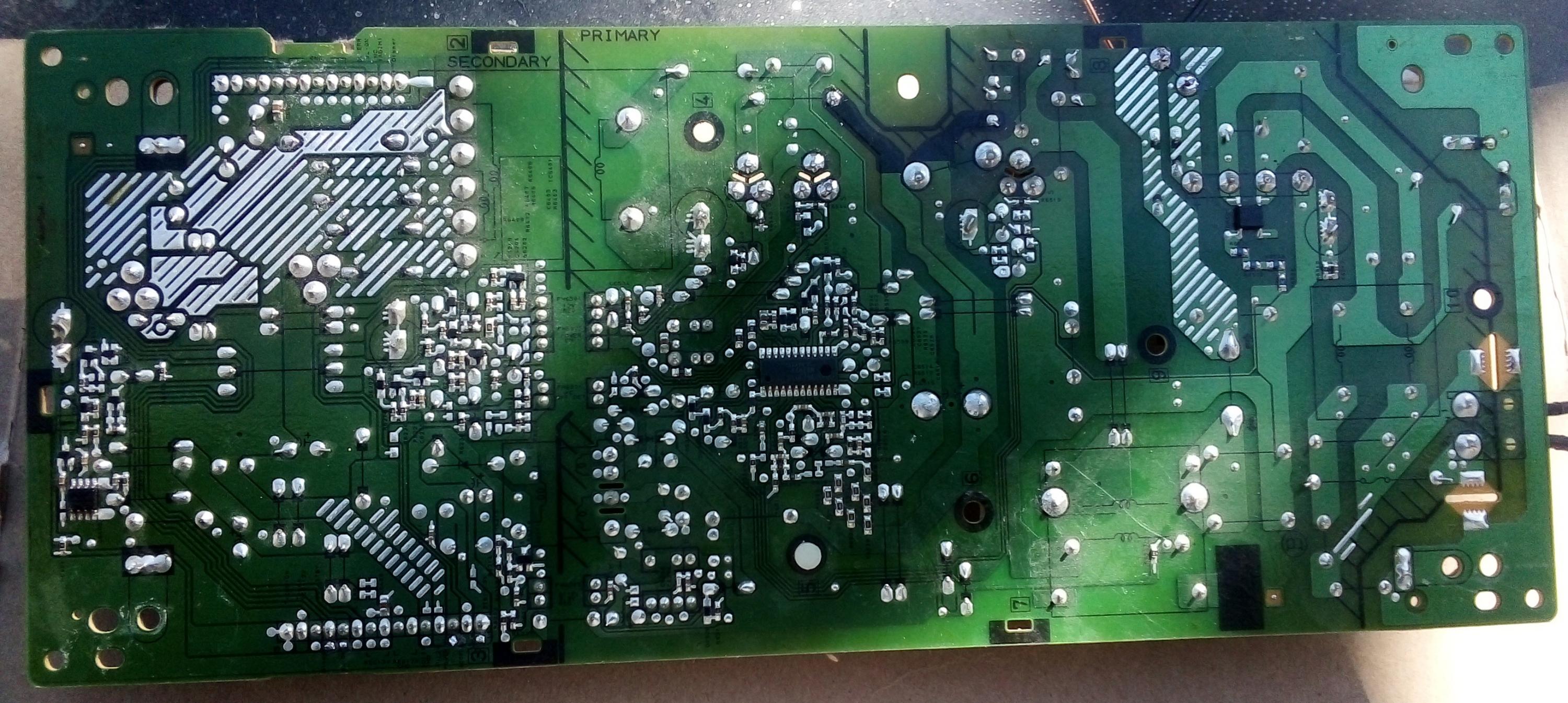

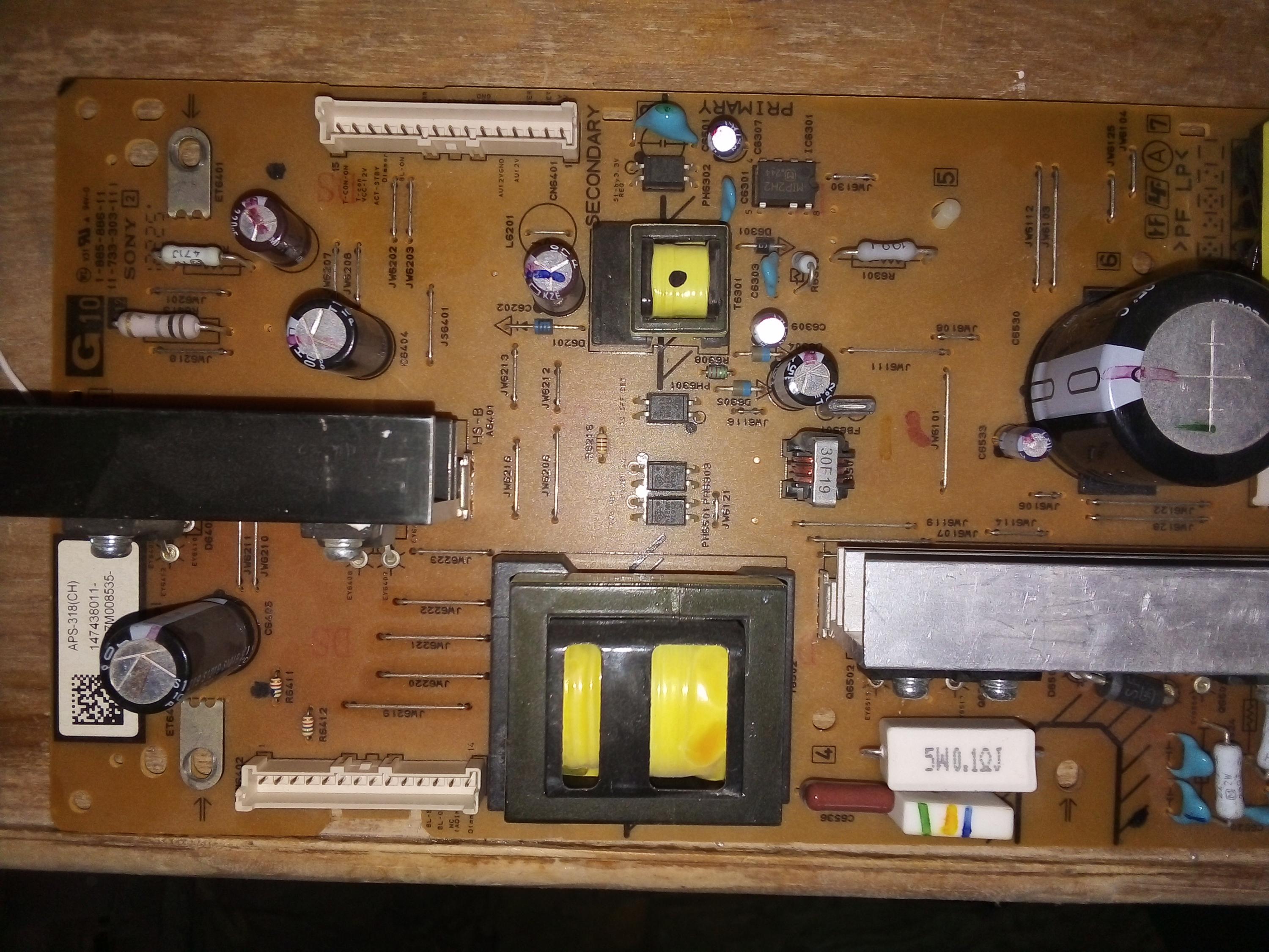

        I couldn't find any similar thermistor to prove whit a new one. I removed the thermistor from the power supply, heated it with my hot air gun and its resistance goes down to 0 Ohm and as it cools its resistance goes up. I did this three times and I hade the same results.
        I turned on the tv and measured the current with my multimeter in series with the thermistor and got 600, 680, 700mA.
        I expected to get a higher consumption.
        I hope the pic are goods and you can continue helping me.
        If you need better pics let me know.
        Regards.

          I checked the gate resistors and diodes again and the diodes are OK, the resistors are within their value with their respective tolerance.

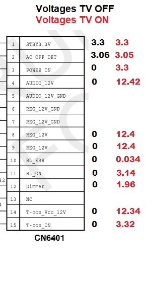

                      What are the voltages when tv is on?

                          I made a mistake measuring the PFC voltage, sorry. I was taking measurements of the heat sink which is not a good ground.
                          I have 388.5V on the main filter when the TV is on and 158 when the TV is off.
                          Attached images of the voltages obtained in the connectors.

                              Are voltages the same when the tv doesn't come on?

                                Do you mean the first time I press the power button?
                                • Quantum IC
                                  • Sep 2021
                                  • 20
                                  Re: Sony KDL-40BX450 LCD. Thermistor gets too hot 10 seconds after turning on the TV
                                  When I press the power button for the first time after plugging in the TV, the voltages are present for about 1-2 seconds and then drop to 0V, except for the STBY 3.3V and AC OFF DET 3V voltages, which are always present.
                                  Then when I press the power button again the TV turns on and all the voltages are present.

                                    I wouldn't think all voltages are the same if tv shuts back down. Tv sensing some problem the first time.
