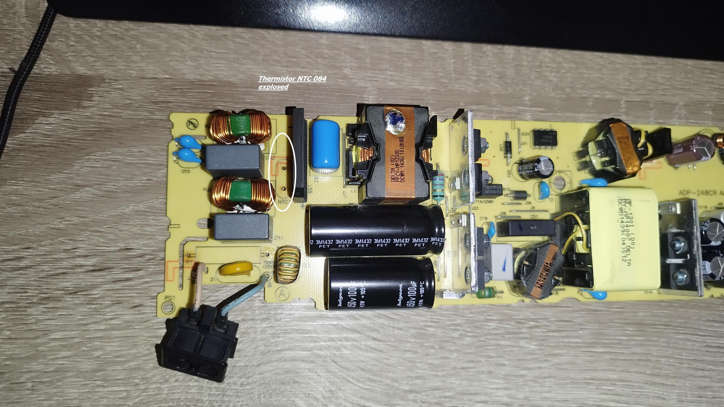

    Hi there,
    I have a fat PS4 with the fuse (5a) of the power supply which blows with each power on and there was a loud snap in the power supply and again the same problem after replacing the fuse.
    I did not find a short circuit
    The component that broke in two is an SCK 084 thermistor (See photo)
    and measured at 11 ohm
    So far I haven't received a thermistor.
    Do you think that if I replace the thermistor and the fuse it should go away, because I have the impression that there is a strong current demand as soon as you press power on the console.
    What else should I check?
    Thank you very much =D

      Re: Thermistor exploded in two when turning on ps4 fat
      it's an NTC, it limits inrush current
      it's supposed to read very low and if it exploded you have a short in the primary side of the psu
      check smoothing caps, rectifiers, fets etc.

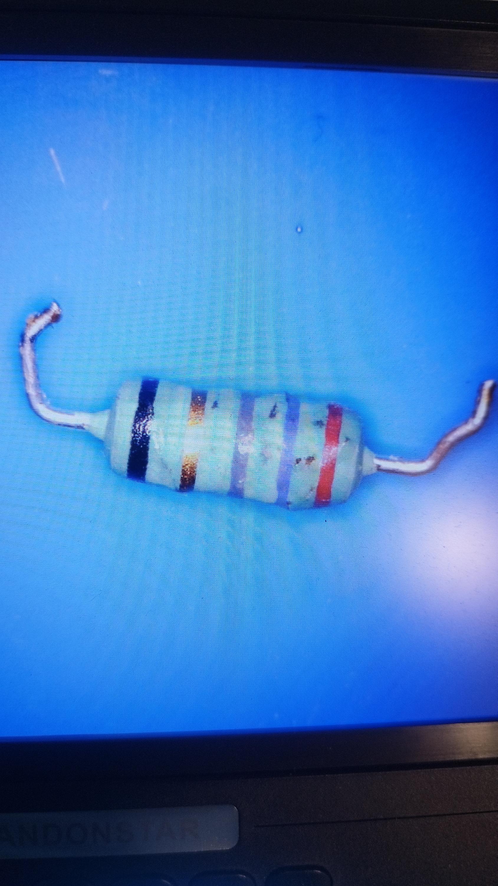

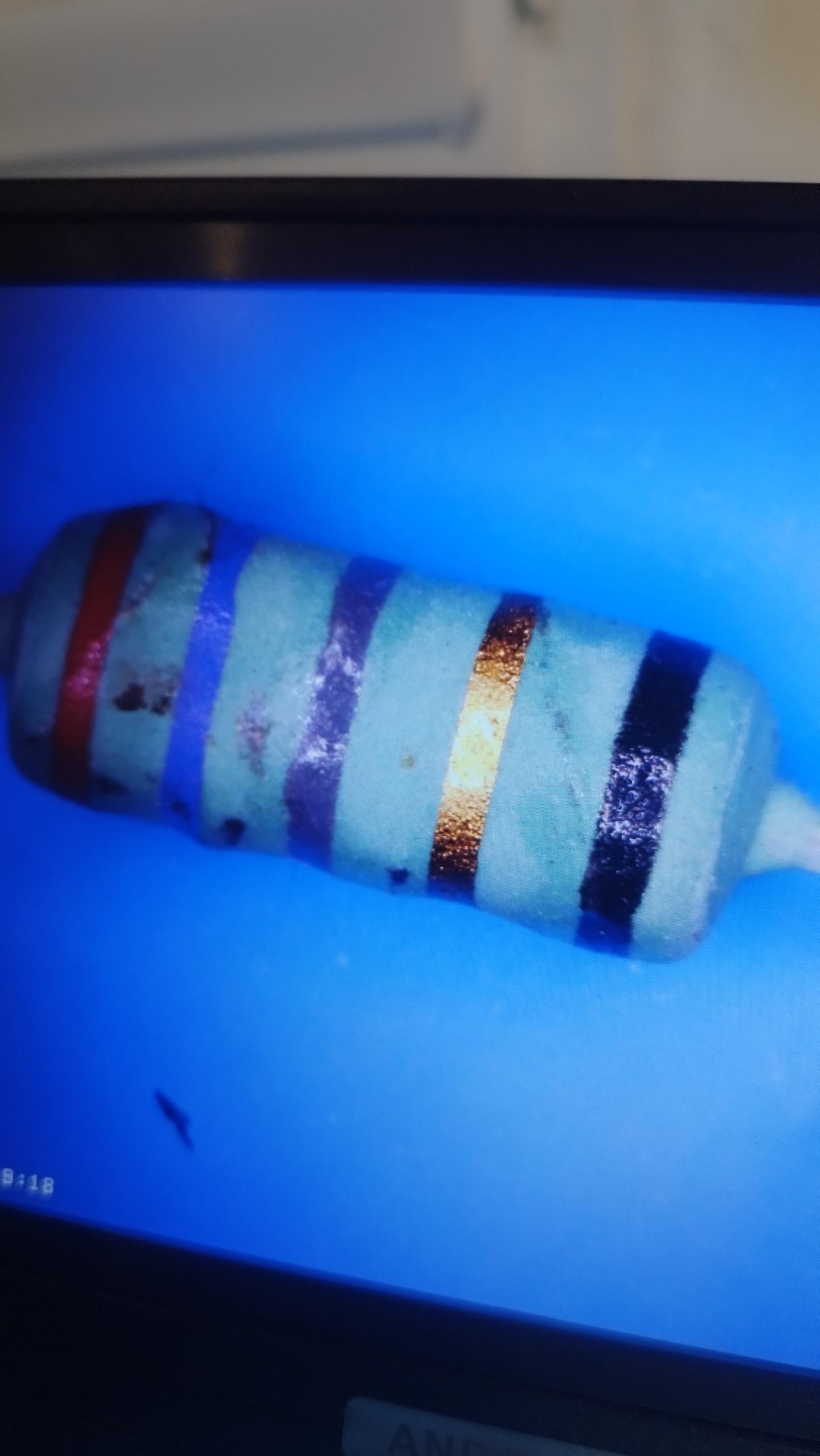

        What bothers me a little the resistance R11 must indicate 27.5 ohm according to the colors or I am mistaken. Measured value 0,1Ohm
        I show you a picture to see if I forgot something

          R11 (27.8Ω) is the source resistor for Q5, I would recheck the resistor as it is likely ok. Check if there is a relay (RL1) across NTC1, if there is then the relay contacts are likely bad. The ADP-240AR has a relay so check if the relay contacts are across the ntc on this power supply. The schematic may be wrong with regards to the relay?

              First of all a big thank you for guiding me in my mess which is for the moment 'we solved. Lack of delay in delivery of components.
              Then I was able to measure the output resistance of the circuit, it indicates a short circuit instead of 27.8 ohm as on the diagram. I am attaching a photo (I think it exploded internally, no?). Concerning the FL1 relay, the test of the coils internally is ok uncut and connects the NTC well.
              I'm waiting receipt of the NTC component and also of a 27.8 ohm resistor and I will keep you informed of events within a few weeks. I am interested in other information to know what to test others =}

                The purpose of the relay is to short out the ntc when the power supply goes to full operation. If the relay contacts do not short the ntc, the ntc will be damaged.
                Resistors almost never go down in value, they go open or high resistance.
