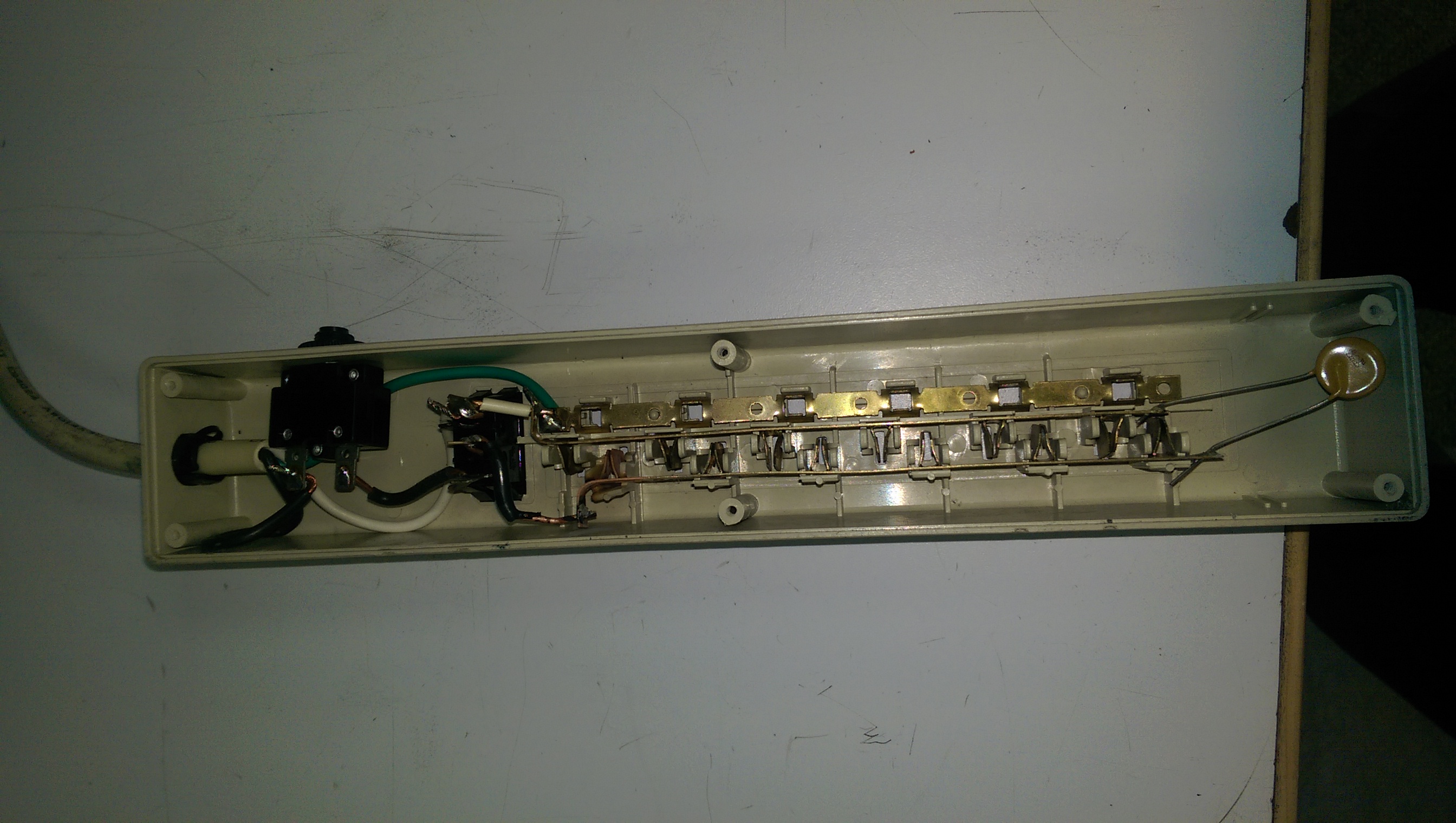

    Failed Power Strip

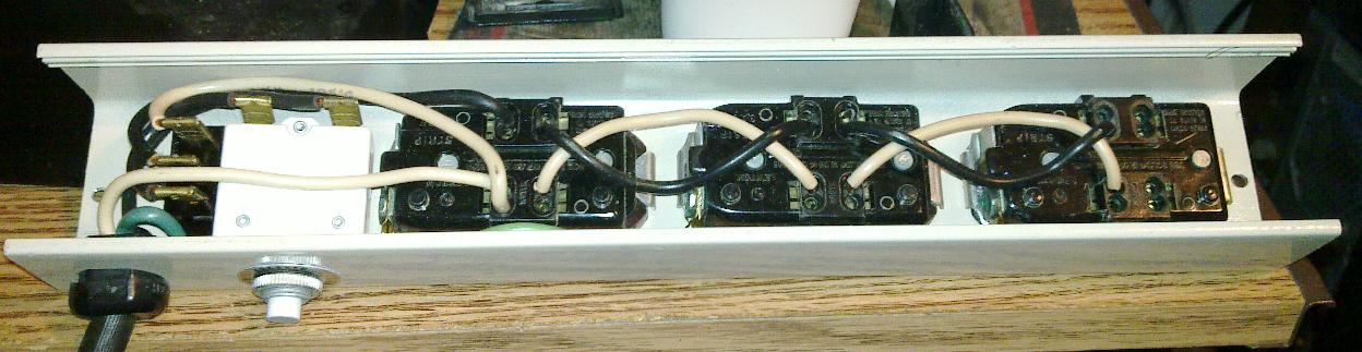

    At work this thing was functioning, but anytime it got bumped, even slightly, it would short out and cut power. Looks like a fire waiting to happen! I think this was because 2kW was pumped through this thing for short amounts of time, even against my recommendation. I guess that's what happens! It's over 20 years old.

    Re: Failed Power Strip
    I guess that circuit breaker was pretty useless.
      An old skool ROC-made power strip. Cool.
        Is it really "old skool"... I think they still make them like that :o
        I opened up a recent ROC power strip and it looks just like that inside...
        Is that a MOV on the far end? Now that's really asking for it...
          What would a breaker do?
          With poor connections and loose jaws, nothing!
          (Ok, ok. Once the plastic housing catches fire, the thermal-only breaker will trip.)
          Time for a nice Wiremold plugstrip- $$$! Or, make one out of a square box, raised cover plate, and two duplex receps...

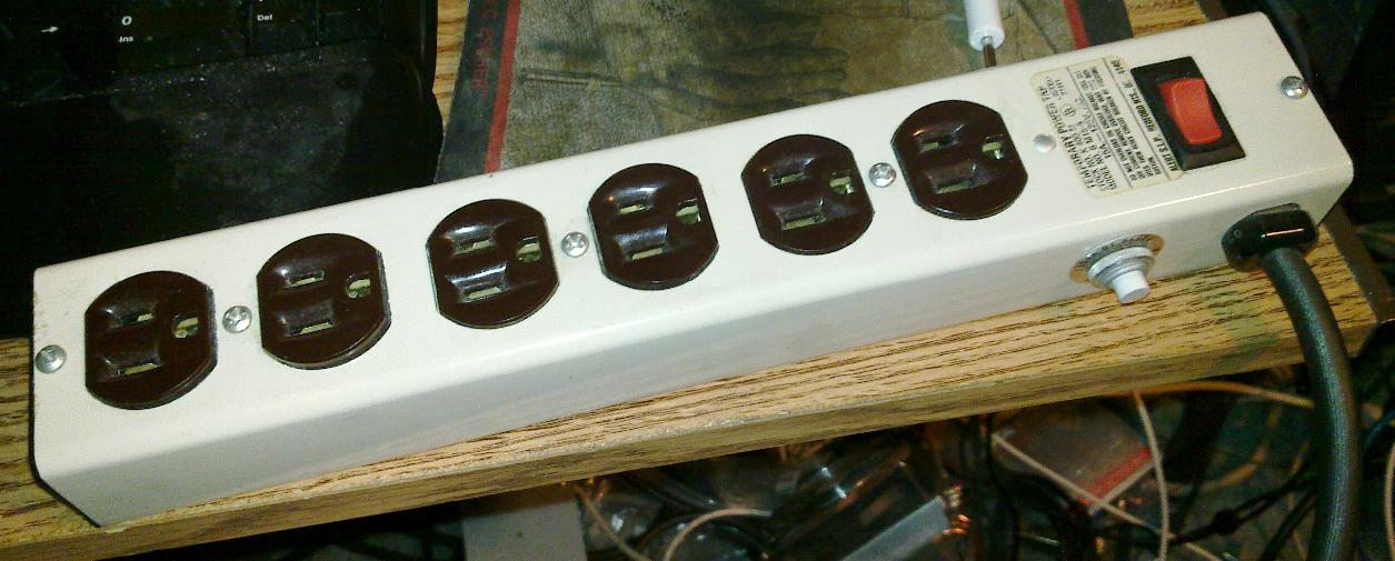

            Yeah it's unfortunate for the race to the bottom. I still have a few power strips that actually have duplex receptacles in it - three to be exact. These are old old...
            Unfortunately one of them I have an issue with. Though it's rated for 15 amps, I plugged in a 1500W heater into it once and the power strip actually started heating up! Not a good sign. I will need to figure out what inside is heating, wonder if it's a bad outlet, wires too small, or something else...

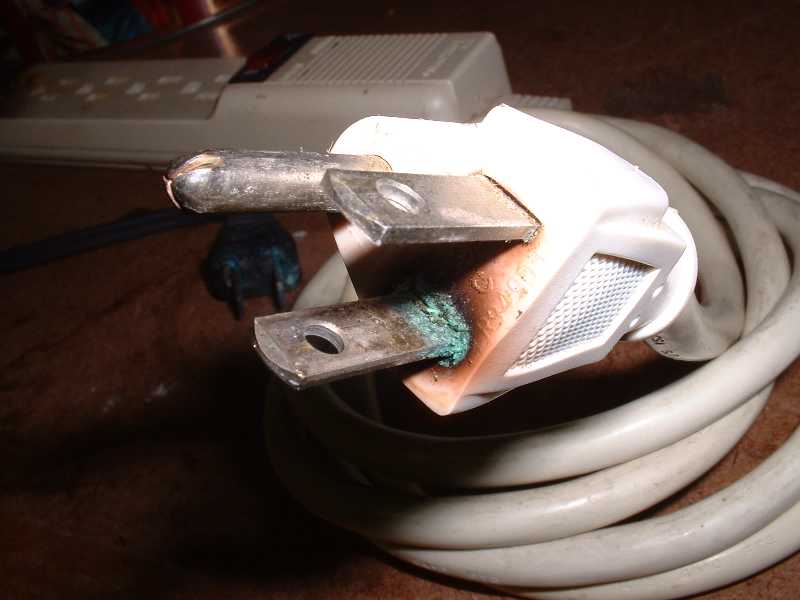

                If it's that old, it could even be oxidation on the contacts/jaws, in addition to loose contacts. IOW, they could heat up under load even if they "appear" to be tight. But after 25 years, unless it was a really good one, I'd think they'd be rather loose...
                When my grandmother was still living in the 1950's Nutley house and we'd stay over, my parents would sleep up in the finished attic.
                My grandfather finished, wired, etc, that bedroom and attic. I don't remember when that was.
                The old recepticals still were tight enough (back in 2008-09), but the plugs of space heaters and hair dryers would often heat up. Those same loads never had their plugs heat when plugged into much newer receps. I looked inside at the jaws of those old ones, and observed the typical brass/copper surface oxidation.
                As those receps were only used when there was "company" upstairs, perhaps the lack of use allowed oxidation to build up, since they weren't having things plugged/unplugged very often.

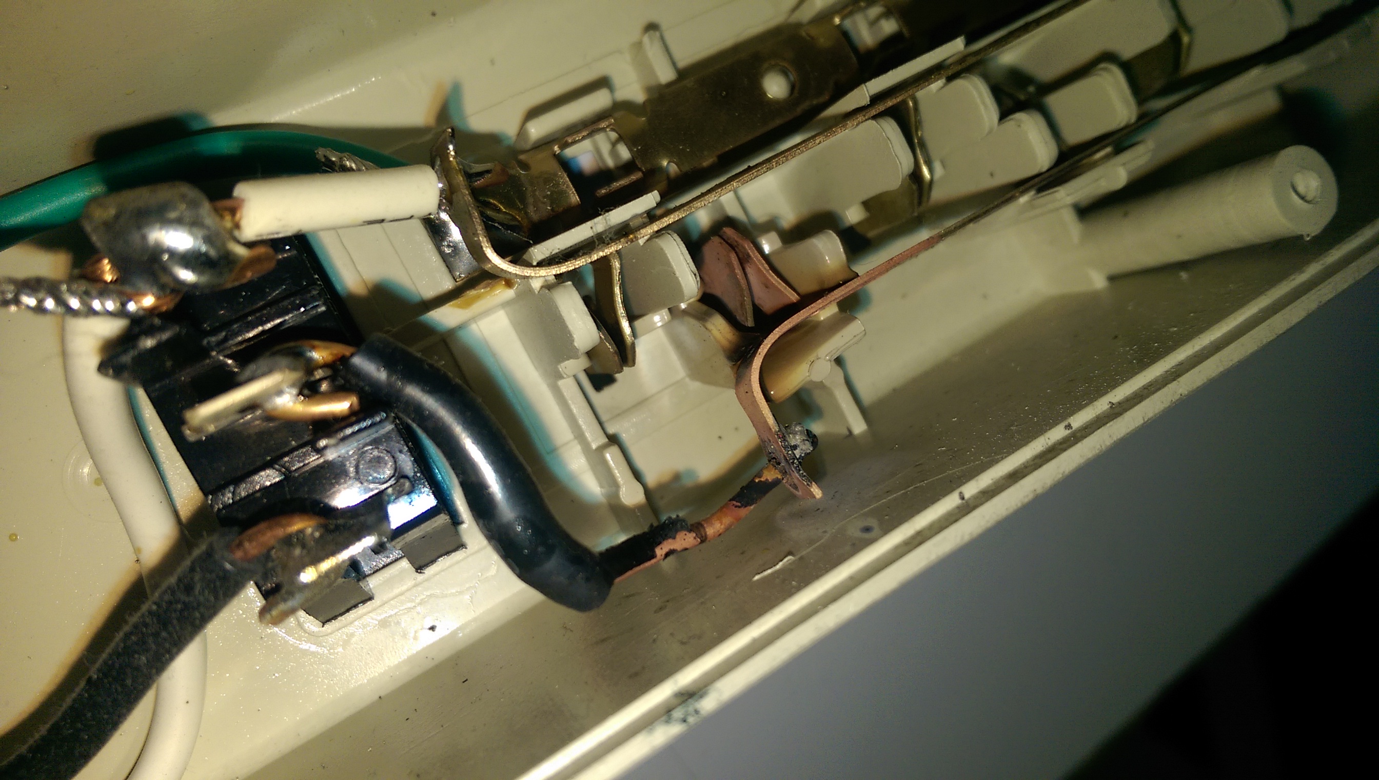

                  That Black line solid should have been wrapped and then soldered, it looks like poor connection of the wire to the buss.
                    Fortunately it's real easy and cheap to replace the outlets unlike the "race to the bottom" power strips. I just need to go to the local Home Depot or Lowes and grab new ones...
                    Then again these "race to the bottom" power strips are lighter and smaller than the triple duplex power strips I have... metal chassis and all... I'm sure some people will prefer these MiT/MiC power strips.
                    (Where's the MiI power strips? Aren't they coming soon?)

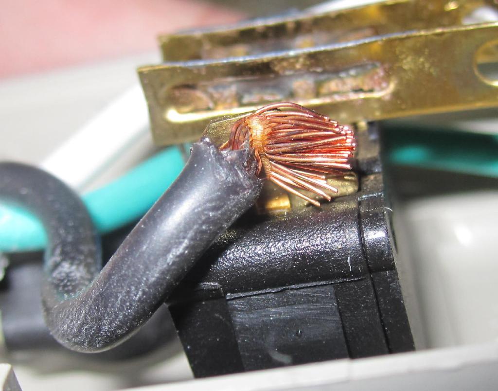

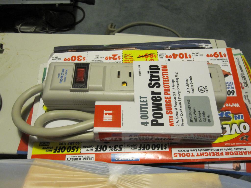

                      Incidentally that recent "MiC" power strip that I took apart, they didn't even solder the black hot wire to the bus...
                      They SPOT WELDED it...
                      I don't know if this is a sign of quality or cost reduction, but it looks like a good weld that will hold up...

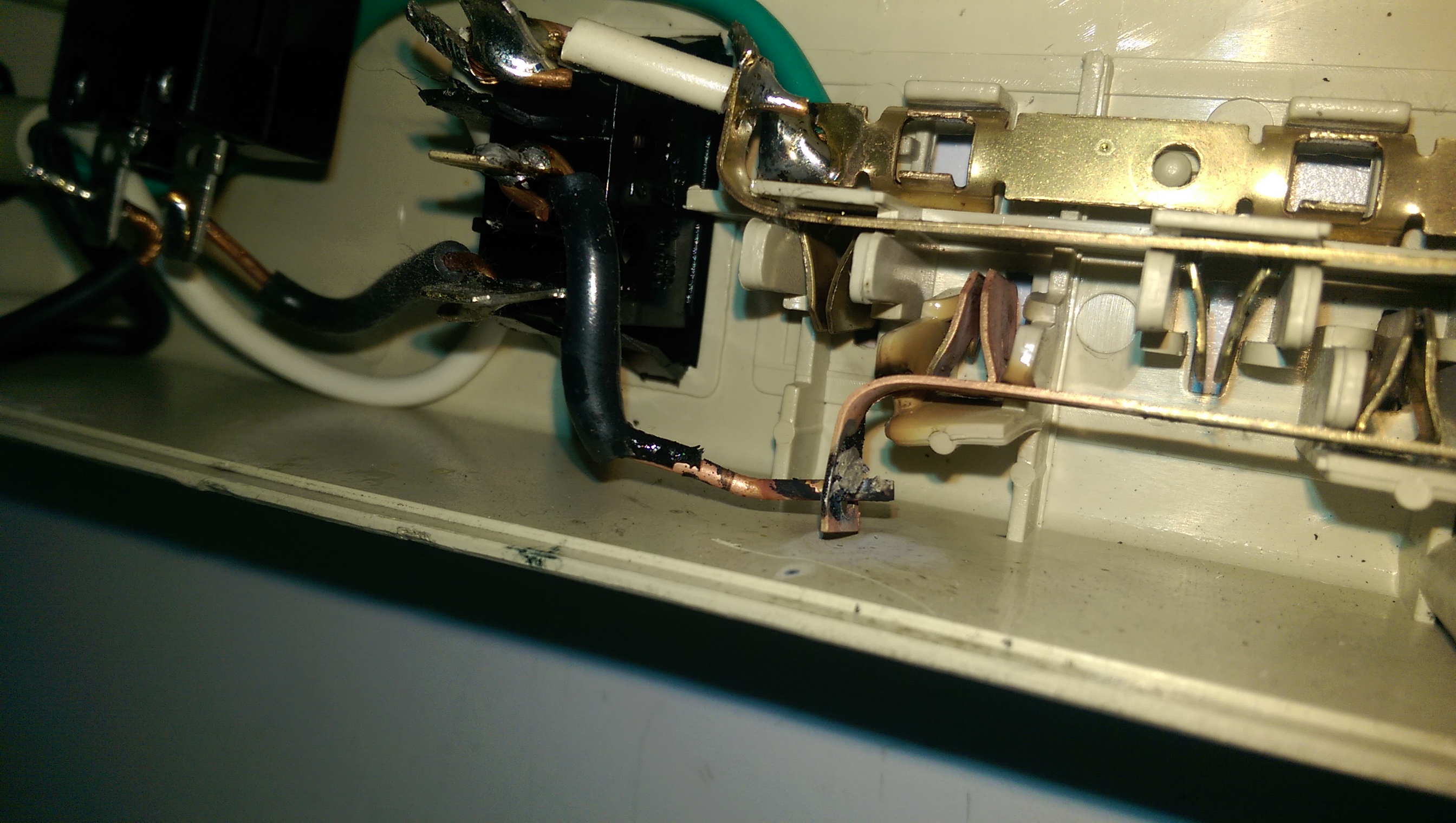

                        The black wire solder joint on the buss appears to me to be where the heat started and travelled up the wire buring off the insulation, probably due to a bad connection at the buss as you noted and possibly a bad solder joint to boot. None of those solder joints look very good to me.

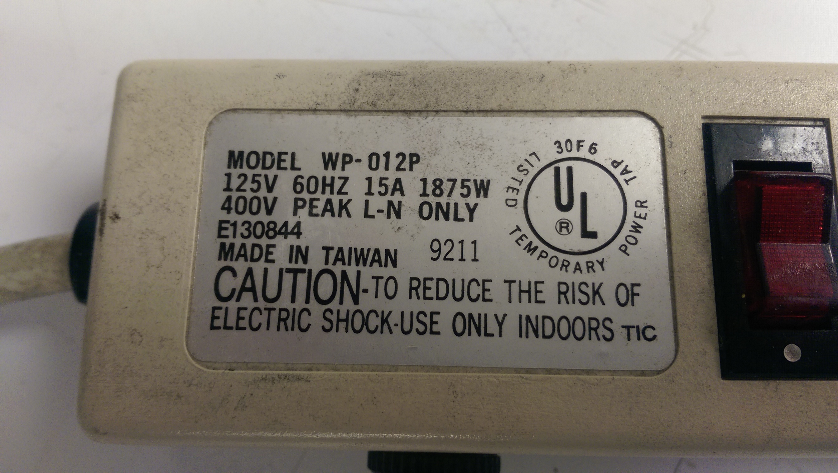

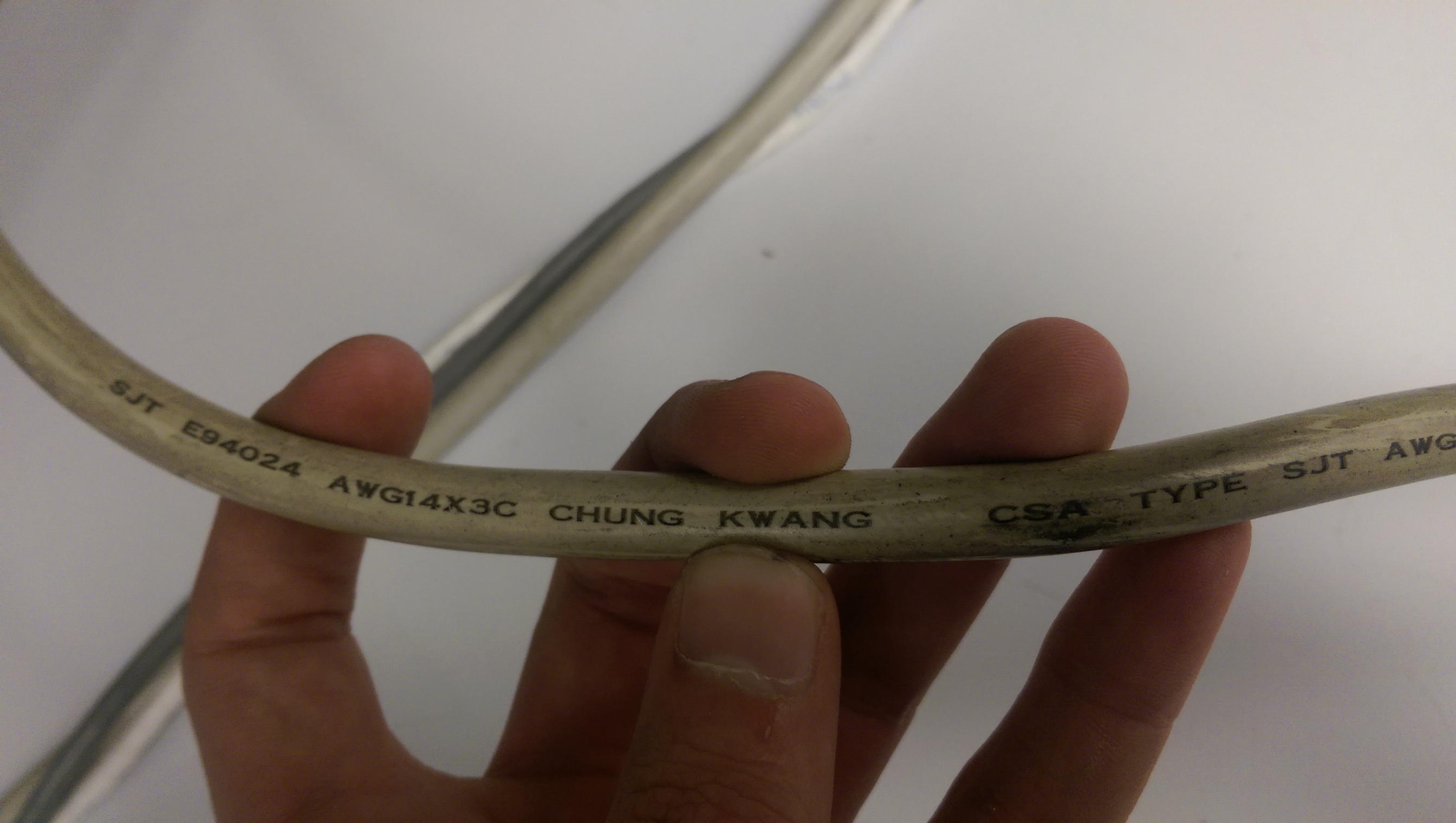

                              Made in China in all its glory?
                              This was made within the last two years I think. Is it Hazard Fraught?
                              It doesn't look way too bad except for GND IMHO...
                                  Wow, that's terrible! Well....at least they used copper?

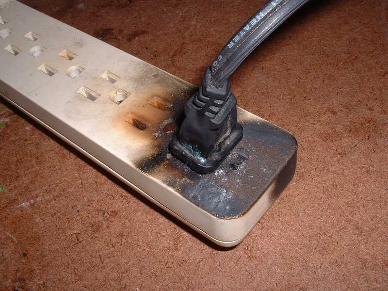

                                    The average persons' power supply knowledge "logic" applies to surge protectors as well: "I can buy this one for $5, why on earth would I pay $20 for that one? They do the same thing!"

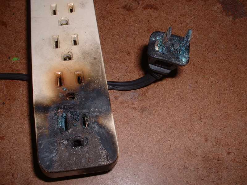

                                    ... Which can be summarized by the following ....
                                    Laser printer, two laptop supplies, some phone and "accessory" supplies, and a space heater. Water was thrown on the arcing (flaming?) heater plug when it was "discovered." Talk about an elephant in the room.
                                    Breaker wouldn't have tripped on the poor connection.
                                    Loose jaws/connections in the strip & plug as well as the recep it was plugged in to. Both jaws of recep bad, but "noodle" (ok, grounded as it's single-phase) was worse.
                                    [sarcasm]"I wasn't warning you for several months- I was being overly enthusiastic and talking for the hell of it."[/sarcasm]
                                    FWIW, they don't do the same thing- junkers catch fire while the goods ones do not.

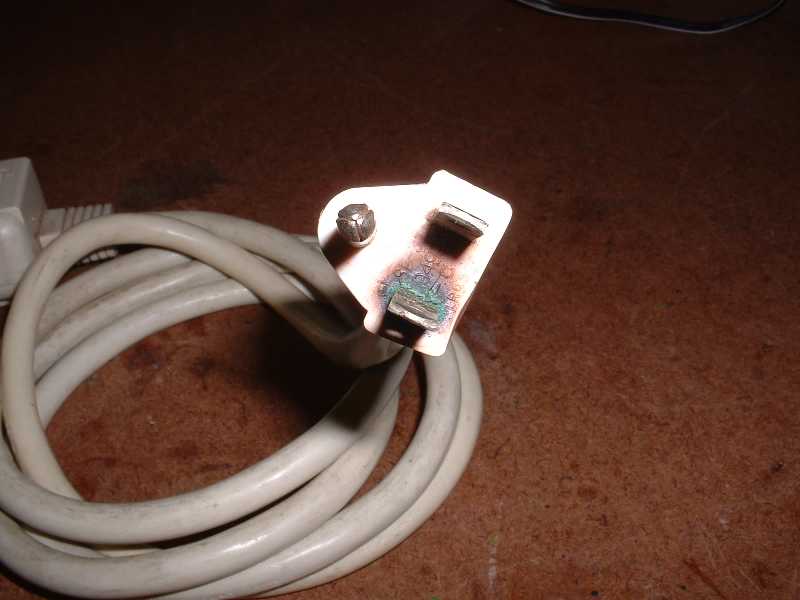

                                        i should go dig up the pictures that skystormfucks put up...
                                        goddam, what did he take these with a shoe?
