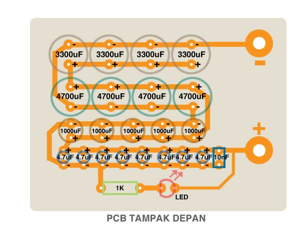

    Hi everyone, anyone on this forum ever makes a capacitor bank for vehicle battery?
    I have read some site that said about this and they are mention about this could makes our vehicle battery last long and didn't hard to start.
    I have a problem to start my vehicle use starter button recently, not a crank by leg. (maybe different with others country vehicle that automatic mode vehicle)
    I have try to fill it with chemical battery water and charges it using UPS, but it is still hard to get start.. maybe it was defective already, and after buy the new one, I think to makes this if really could makes my battery last longer.
    So the question is this capacitor bank really applicable or just a hoax?

        Thank you for response, so I know this is applicable to makes this as a battery, but the price is so
        I have read some site discuss it and mention about common radial lead electrolyte caps too.
        How about add on common capacitor bank parallel with battery? not a supercapacitor.
        I means that we are not changes battery with supercapacitor, but add an extra common electrolyte capacitor bank paralled with battery. Is that makes an effect to longer battery life?
        I don't have an experience on supercapacitor and I have an idea to make one of them using common radial lead electrolyte caps as add on for battery (if true makes last longer) because the expensive price for supercapacitor.

                did you ever experience to connect parallel caps on this battery? If this help to makes battery life last long, I would make it on my bike and car.

                  i guess you are talking about connecting a series of caps so they are 14V++ in parallel to the battery?

                    Yes, like this
                    How do you think? it said that could makes ripple on a smooth level but didn't have talking about prolong battery life, but I have ever seen other site mention it could prolong battery life.

                      so you want to smooth the ripple to protect electronic components in the vehicle?
                      I thought caps were here to make starting current a little higher to compensate for weak battery.
                      Desulphator is a device to try revive weak lead acid batteries.
                      What is the reason for using small and big capacitors?

                        From the site I read, it said that the purpose for different values capacitor is to smooth all different ripple that battery has.
                        I have main intention to make a starting current a little higher as you say to compensate for weak battery. I don't think too much about electronic components on my vehicle since there is not very expensive components on vehicle, but this could be a plus advantage if this is true.
                        "I thought caps were here to make starting current a little higher to compensate for weak battery". From this sentences I assume this is true could makes my battery have longer life and I could start my vehicle even when condition of battery is weak?
