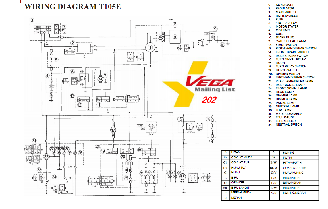

      Ok. I just try to search any specifications on internet and find this, hope this give some idea for help me domas
      I can't see any pdf file to upload so please forgive me if you have to takes a time to open and read the site. the bottom site is my country site so it needed to translate. thank you very much for your attention.
      http://spinningblueorb.blogspot.com/...tails-and.html
      http://motorspec.blogspot.com/2009/0...isc-brake.html
