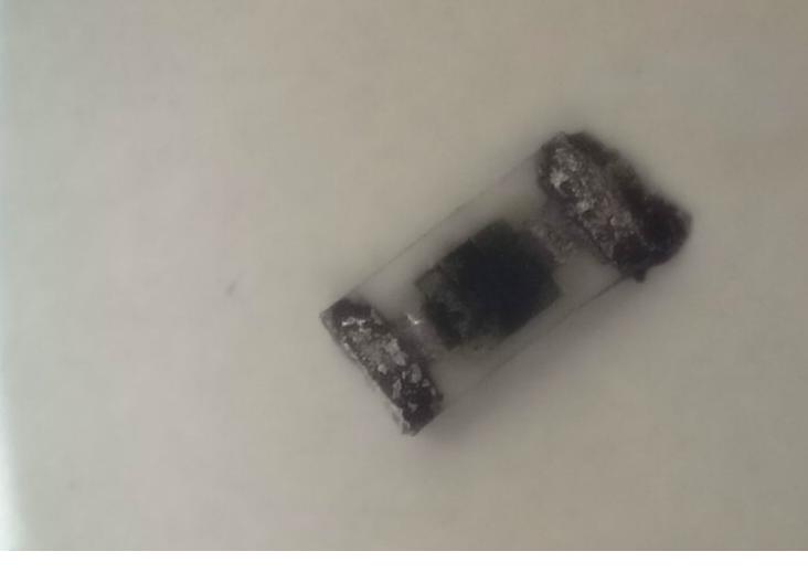

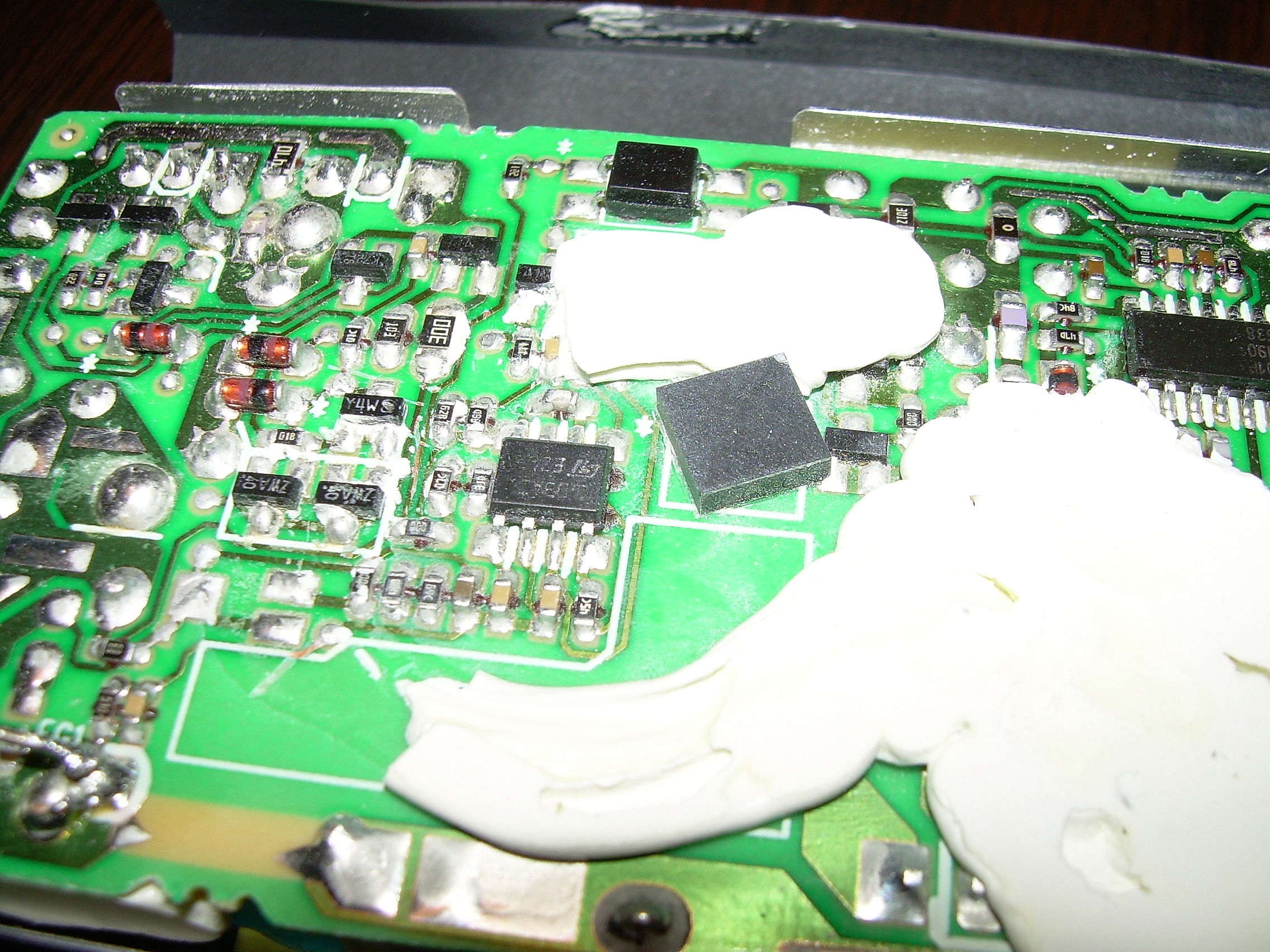

    HI!
    My HP 90w laptop charger stop working normaly and i opened it thinking of a bad cap but no for the beggining. I saw imeddiately an SMD component that is burned and burned the surrounding area, includes some tracks and now i need to know if someone can help me how to identify the burned smd component and the right tracks to connect again.
    You can see photos here:
    White SMD burned component. Measuring with multimeter it have 15K resistance

    Re: HP Laptop charger burned component
    Photos too small.
      Photos too small.
      _WAY_ too small.
        HI!
        Sorry,
        Here they are!
        http://www.4shared.com/photo/455mZW6...11_001149.html
        http://www.4shared.com/photo/yvg0jmu...recortada.html
        http://www.4shared.com/photo/SgYr0cm...11_001219.html
        http://www.4shared.com/photo/jOlt69R...11_015222.html
        Regards!
            The pictures are not really clear enough for troubleshooting - need more light
            but not flash. You did well with the magnified one - I have resized but see nothing to help with identification.
              Does this unit have LED? That clear body looks like LED. Pictures are out off focus to read any thing on the board.
                  I got the 'same' psu but mine has a different layout - if you get better pictures of yours we can compare them,it might work out.
                                  that could even be a type of fuse.
                                  we need good pics of the part and the area it came from to start.
                                      If you REALLY want to fix it, you will have to find lots of times to sit down, get the P/N of the ICs, MOSFET's, ETC. and look up the spec sheets. Most manufacturers will have app notes on how the IC should be hooked up for it to function. Then you will need good eyes to trace out those traces on the board and draw up the diagram so you will have some idea how the components are connected together and how it works.
                                      I have traced out many boards from the GOOD PICTURES (you have no ideas on how many times I keep requesting GOOD CLEAR pictures, we do not have the board in front of us to look at) that I print out both sides of the board, scale them so they are the same size, tape the print out together as if it is a real board is in front of me, then spend many hours to draw up the diagram for people here to use for troubleshooting. Some of people that ask for help and then abandon the project after many hours I put into the projects, I have at least 5 of those in the past.
                                      So how serious are you about fixing this power supply down to components level? You should also read up on how Switching power supply work and get some idea the basic building blocks that it needs to function. Basic understanding is always a good base to start up with.
                                        HI!
                                        Yes i really want to fix it just for learning and have better skills next times!
                                        I've opened a good charger and wil take photos with good quality to the bad one and to the good charger so we can compare.
                                        Friend Kiriakos GR i think you haven't understood yet. I don't want that help. If i want someone to repair it for me, i know what to do. I dont need a "hero" like you to solve this.
                                        Thanks budm! I will post the photos ASAP!
