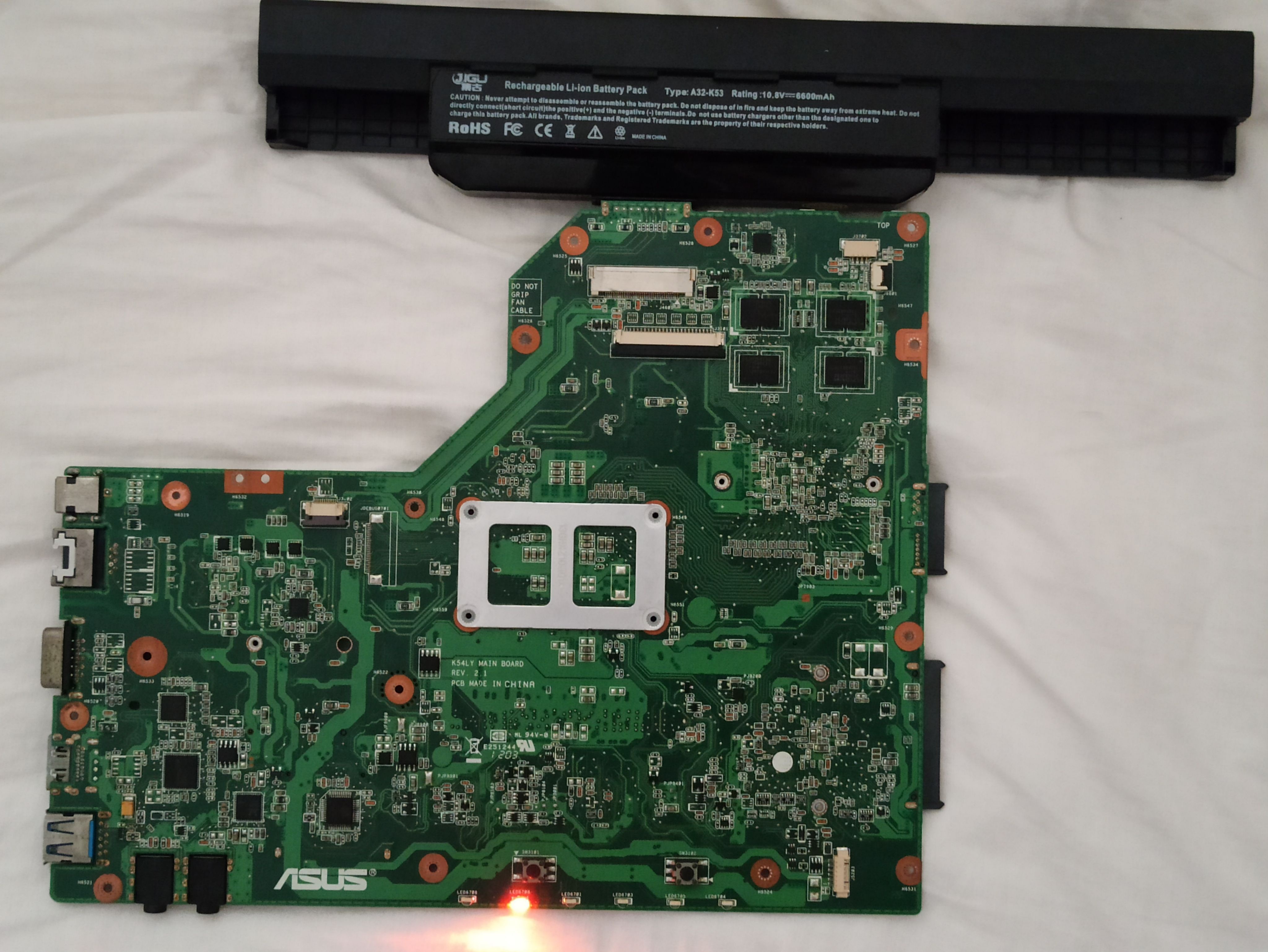

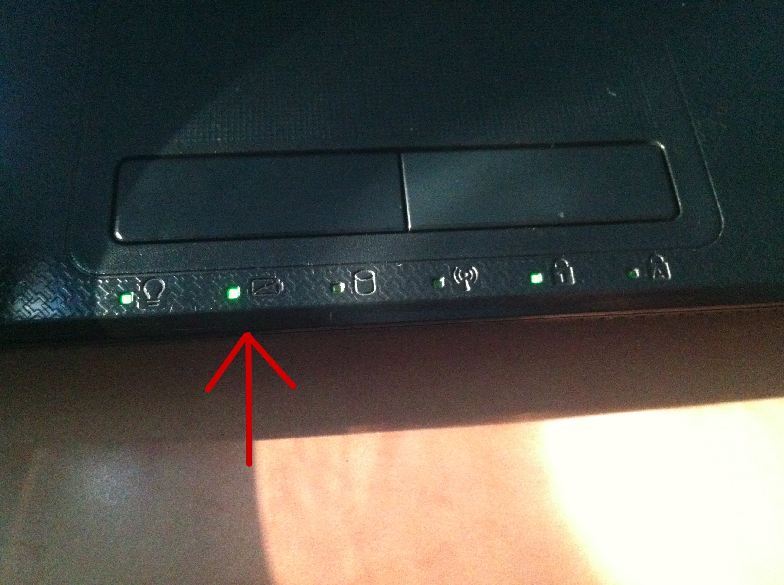

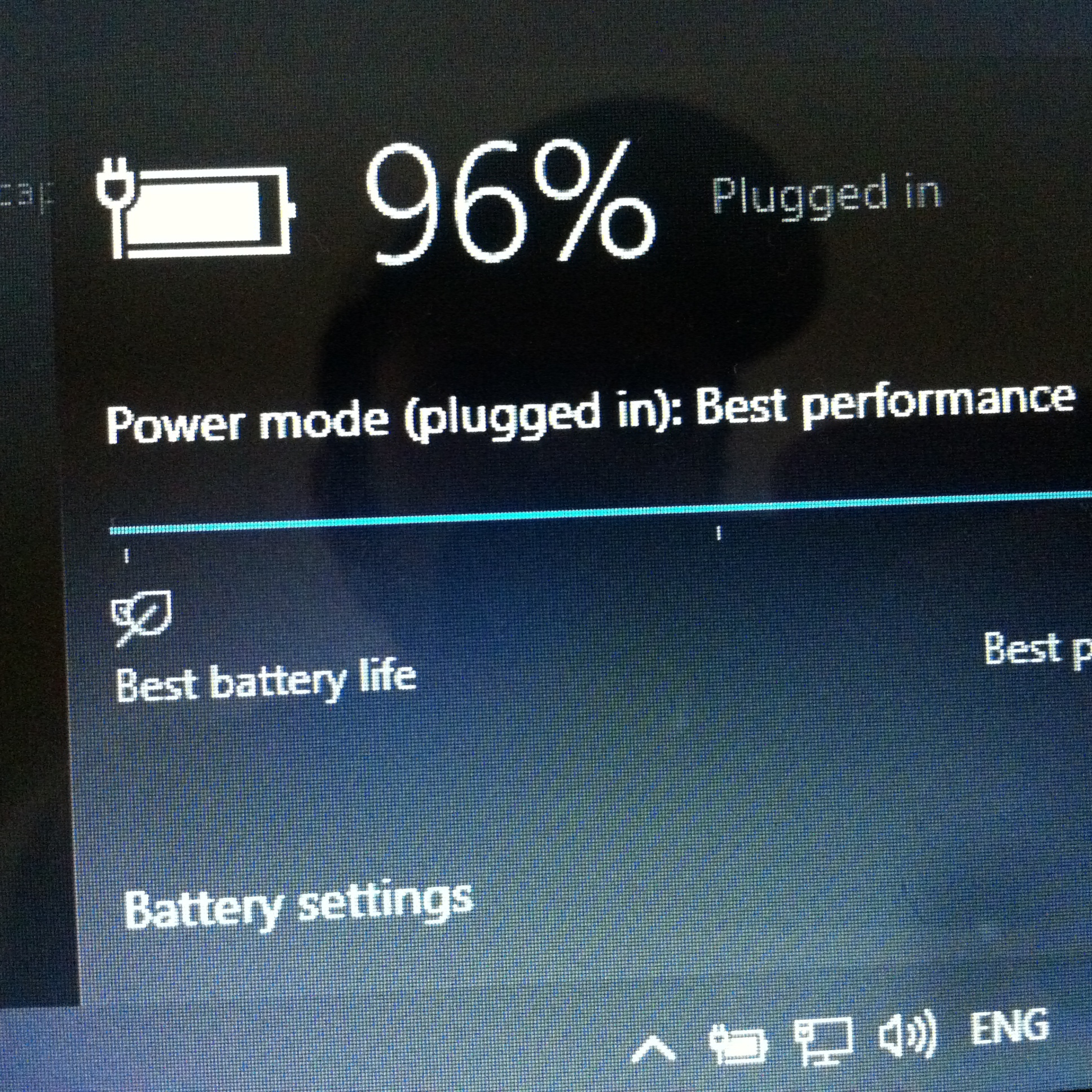

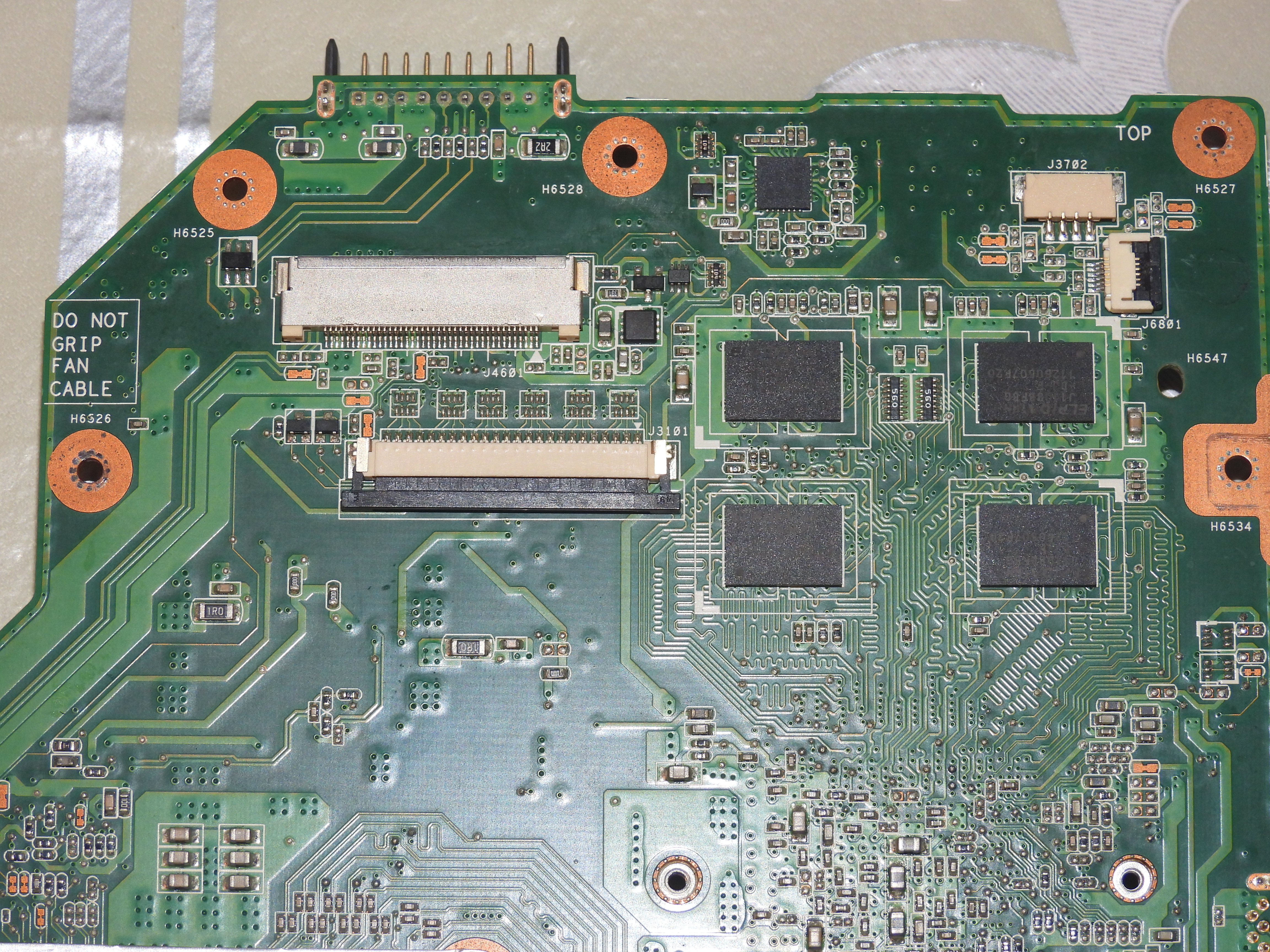

    The charging indicator light on my ASUS X54H laptop is always on even when the charger is disconnected.
    Click image for larger version  Name:	charge light on with charger unplugged-.JPG.png Views:	0 Size:	6.46 MB ID:	3666753
    Windows also shows ''Plugged in'' when charger is not connected.
    Click image for larger version  Name:	Windows shows Plugged in with charger unplugged.jpg Views:	0 Size:	1.74 MB ID:	3666754
    This problem started year ago gradually, when unplugging the charger the charging light took several seconds to disappear, then minutes, and now almost always on even when unplugged for an entire day.
    Strangely, before sometimes immediately when plugging in the charger the charging light went away, and later came back with it connected.
    If I let battery run out and say it has 3% Windows will warn me to plug in the charger, and even if I do, the computer shuts down as if the charger isn't connected, even though the charge light is on!
    Sometimes the charging light flashes green and red alternatively which I think means some fault, but replugging the battery fixes it.
    As you see very weird behavior.
    The problem is the same whether the computer is turned on or off the charging light stays on.
    Some things I tried:
    In Device Manager uninstalling Microsoft ACPI-Compliant Control Method Battery and restarting.
    I measured RTC battery and it was a bit low 2.96V so I replaced it and it didn't help.
    I have two laptop batteries and the problem is the same on both.
    I think the problem is on the motherboard.
    How to troubleshoot it?

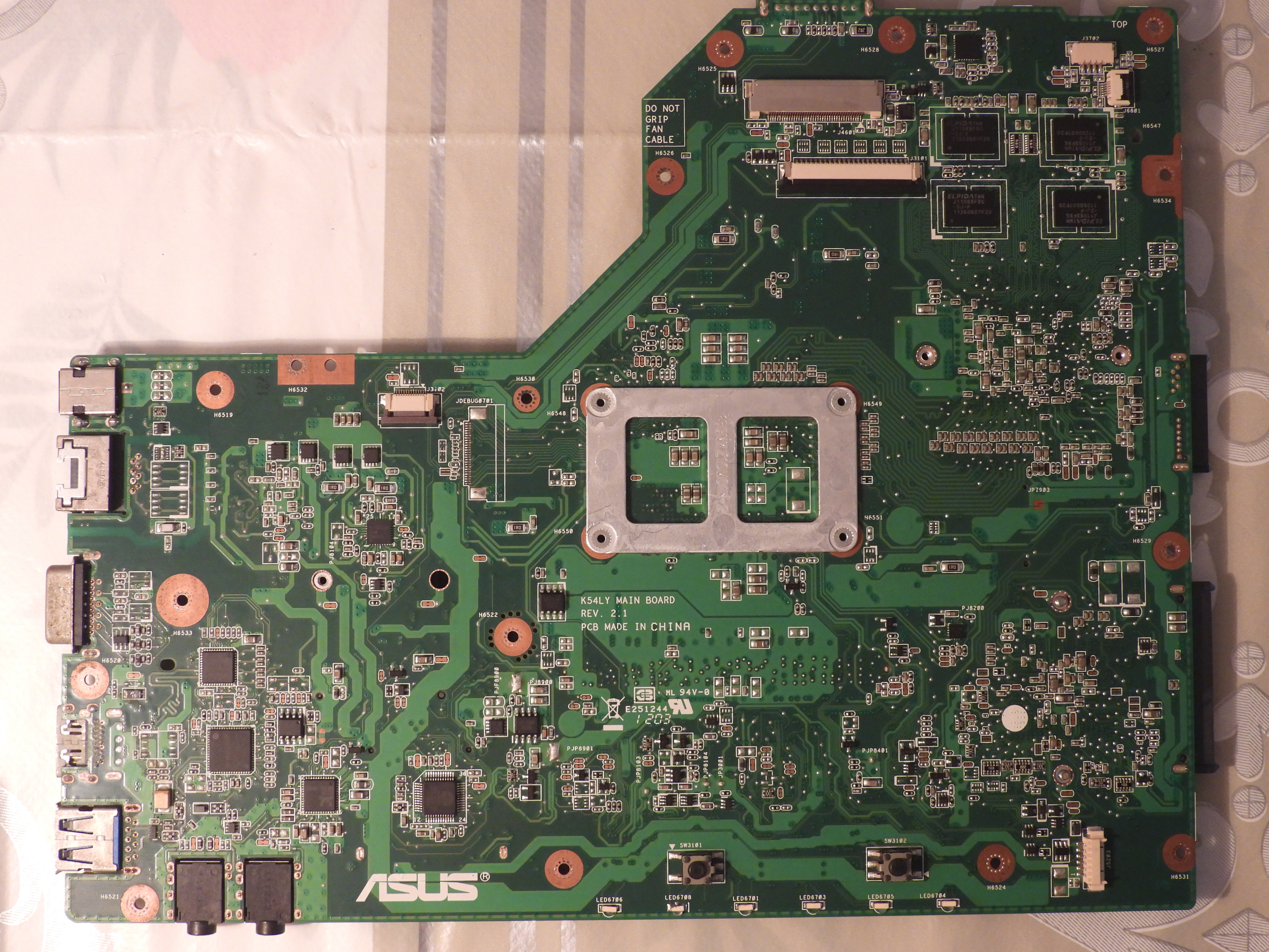

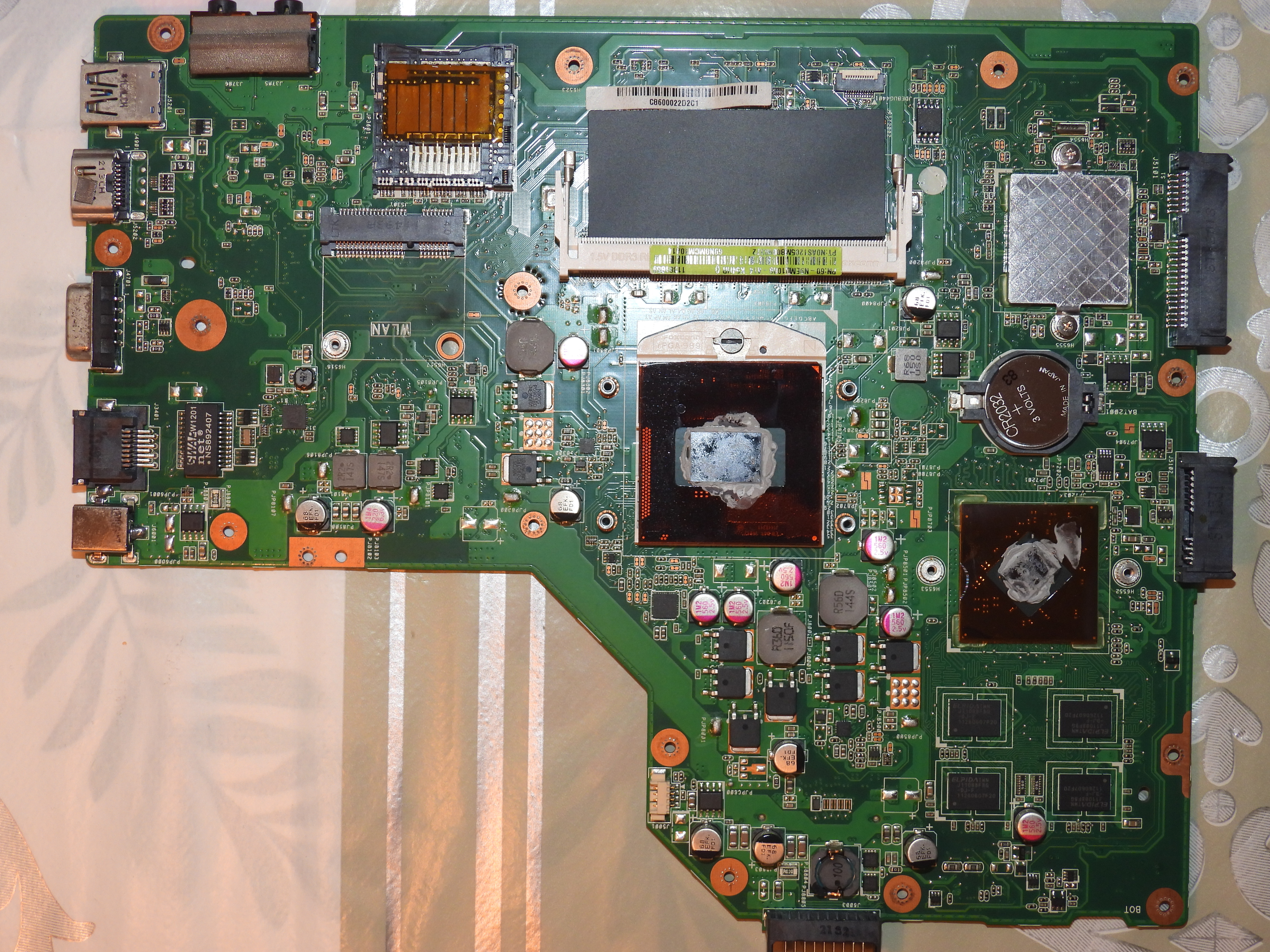

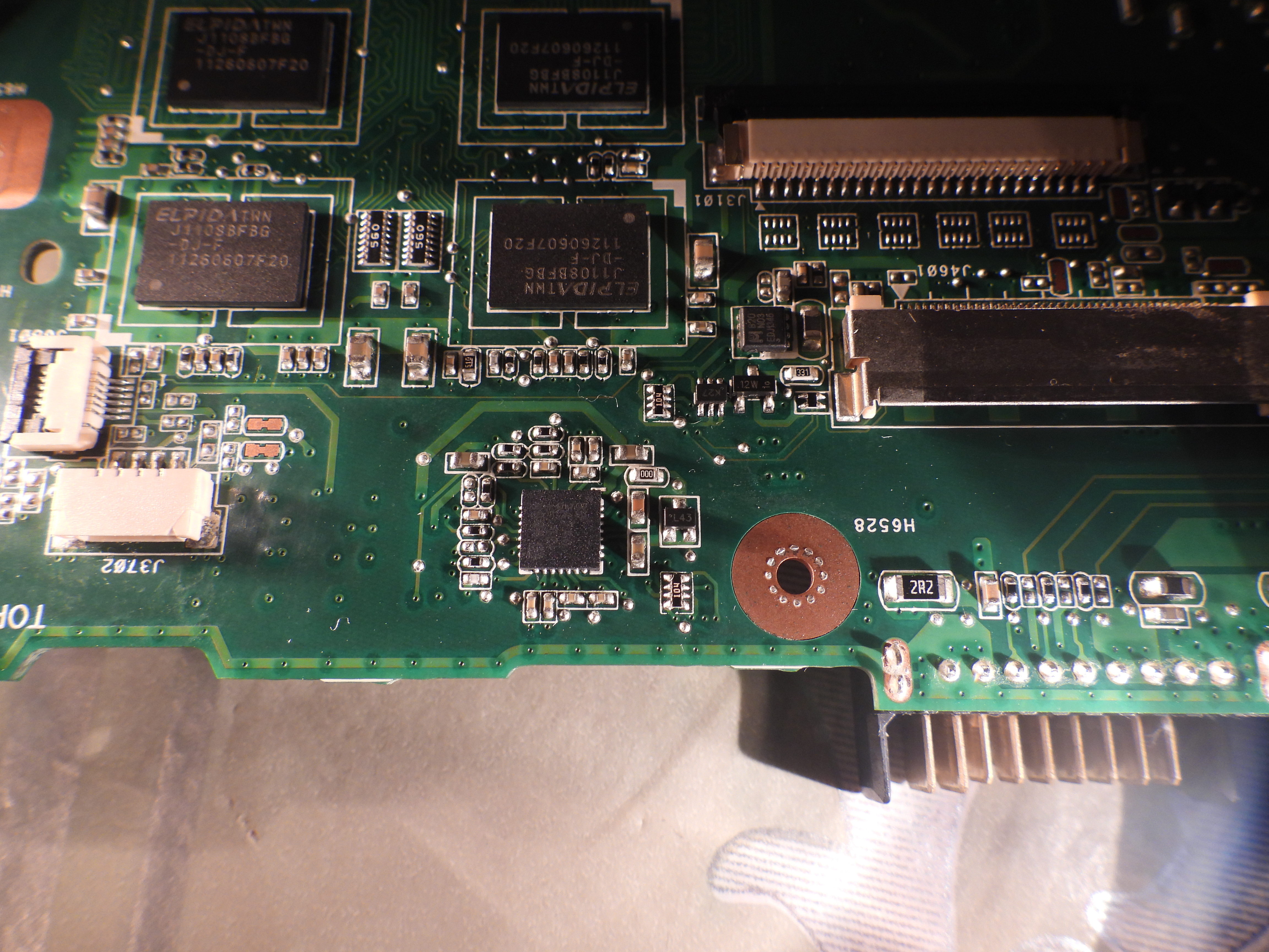

    Label on laptop bottom says
    MODEL: X54H
    MB Ver. X54HR
    but printed on motherboard K54LY REV 2.1

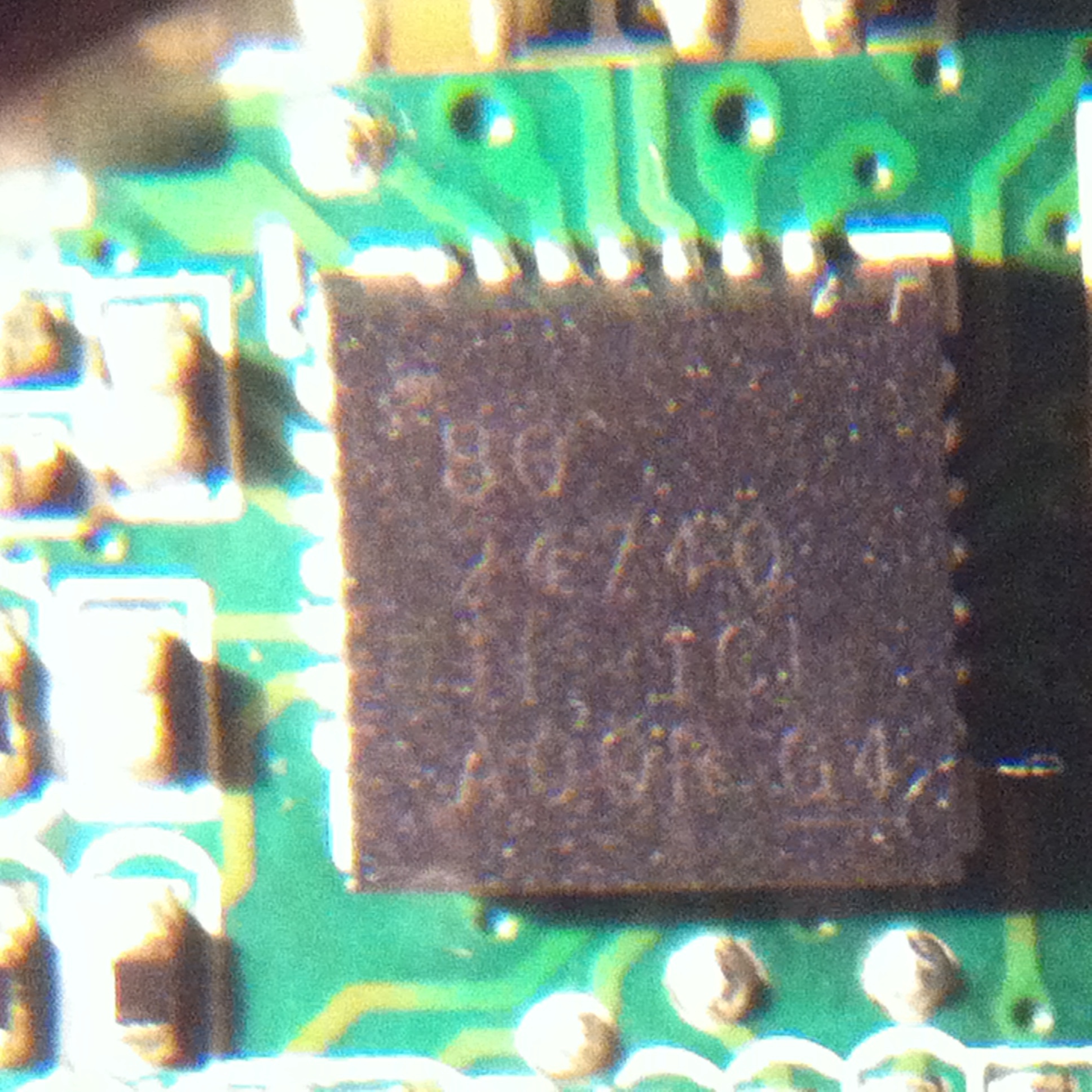

    Boardview here
    https://www.badcaps.net/forum/troubl...-2-1-boardview

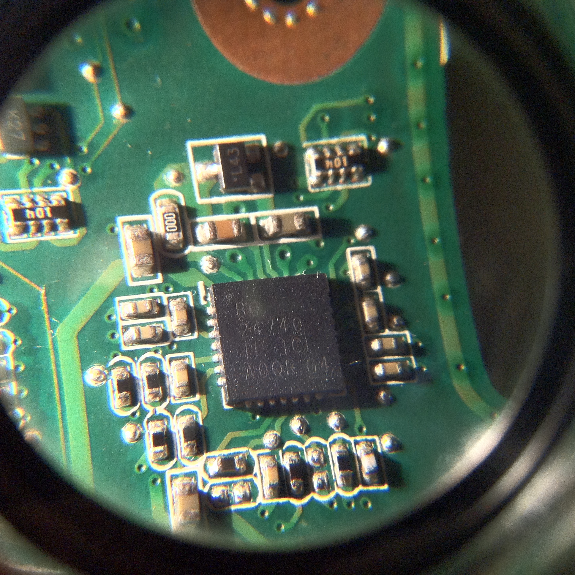

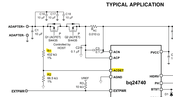

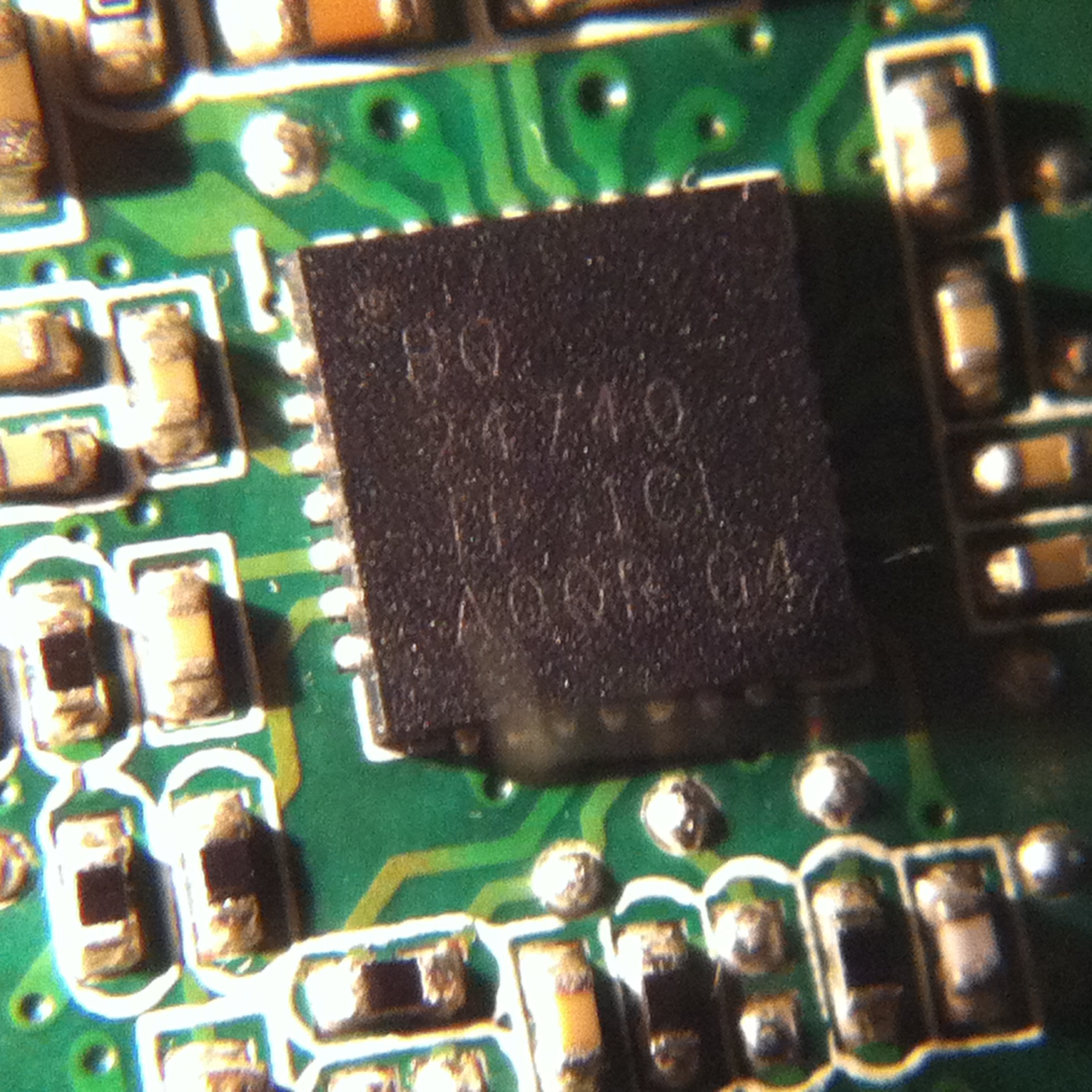

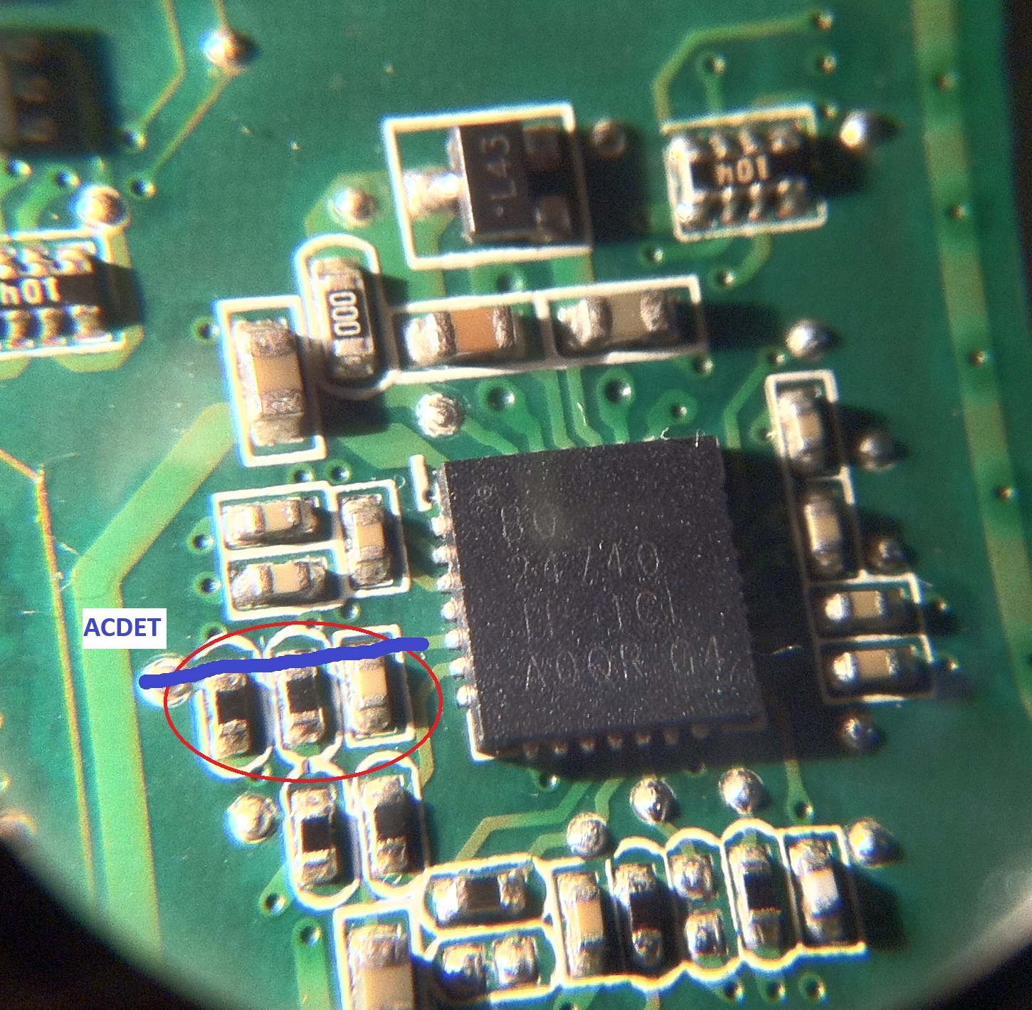

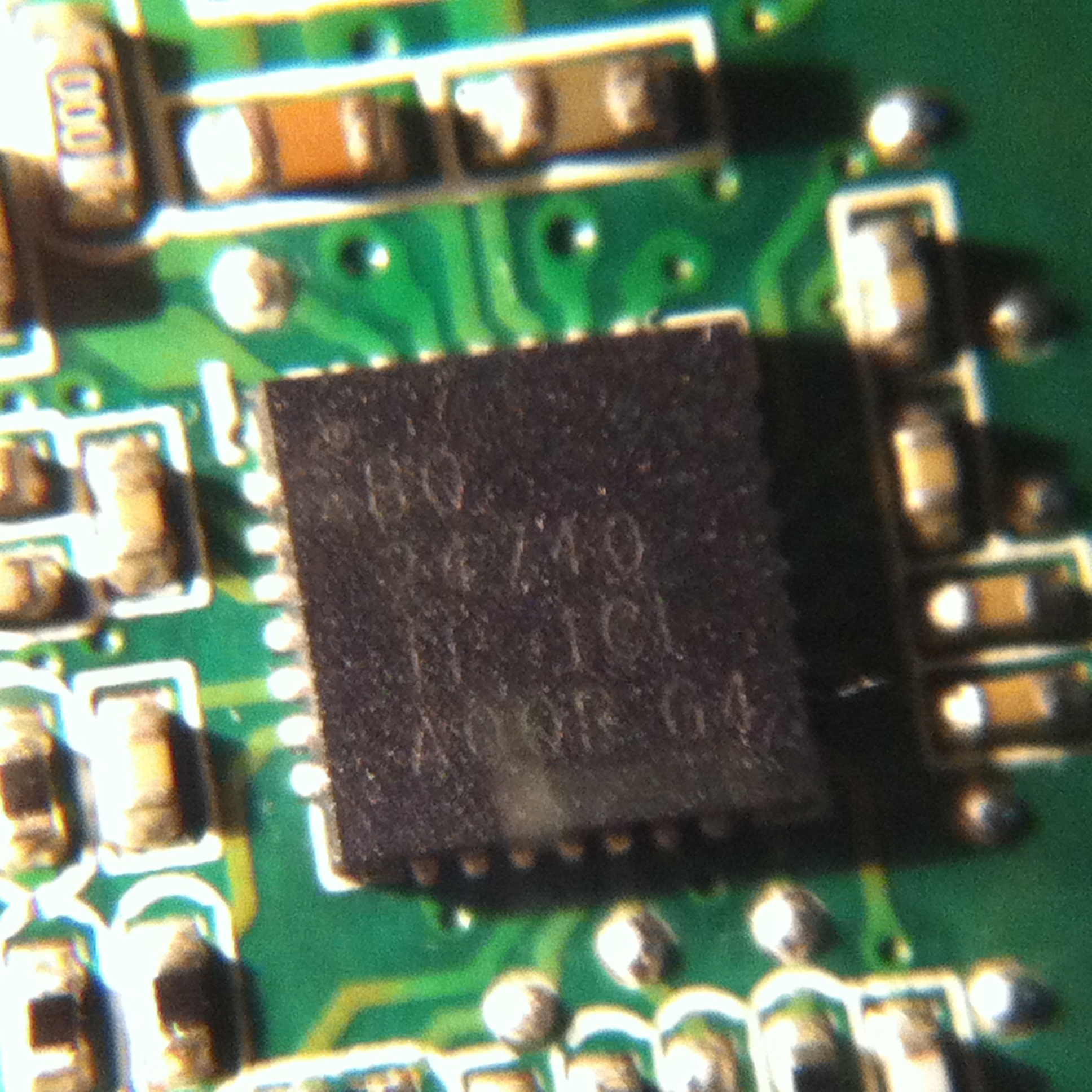

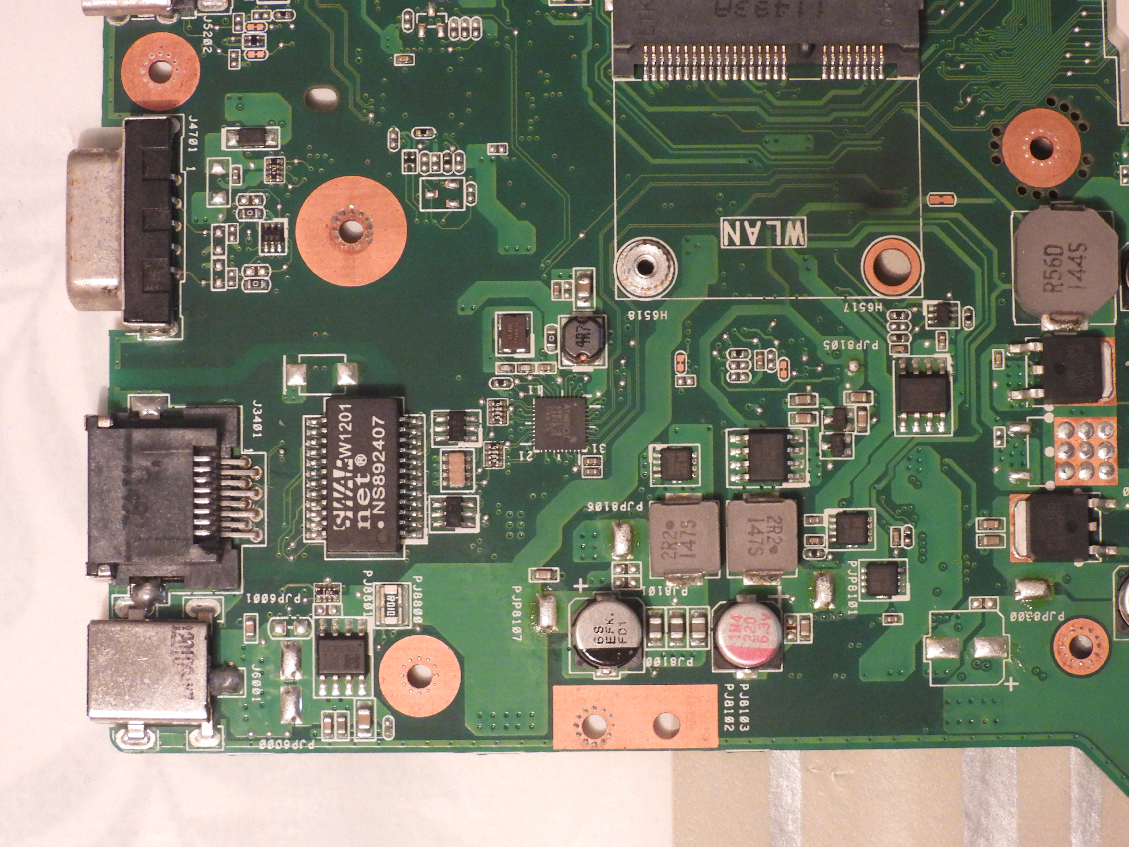

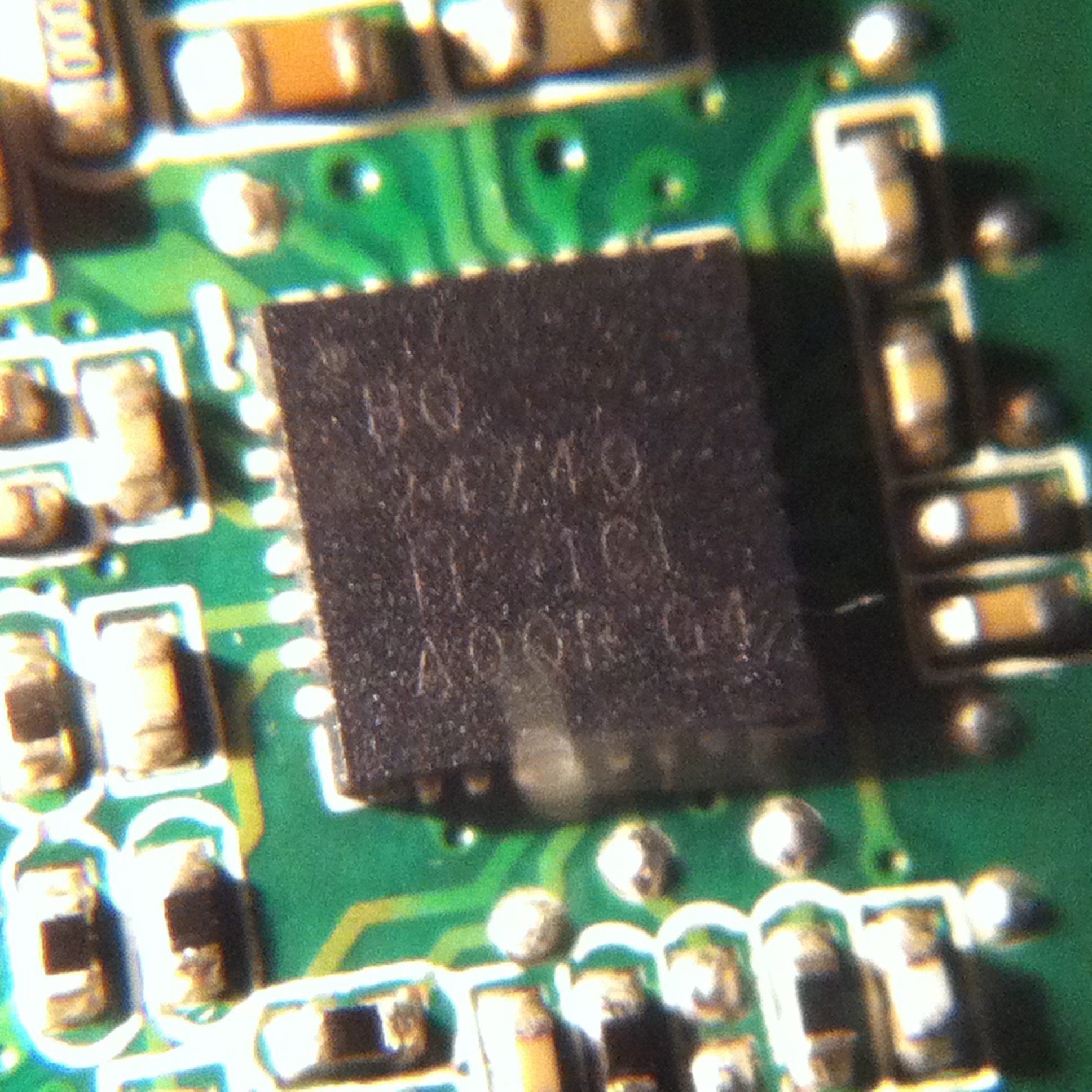

    From the datasheet of BQ24740 there's a voltage divider connected to pin 5, the output of it should be around 2.6V with charger plugged in
    ACDET Adapter detected voltage set input. Program the adapter detect threshold by connecting a resistor divider from
    adapter input to ACDET pin to AGND pin. Adapter voltage is detected if ACDET-pin voltage is greater than 2.4 V
    Measure both resistors circled in red (with power removed), the one in parallel with the cap goes to GND, the leftmost one the other end goes to the charger input, maybe one of them is out of spec
    Measure voltage at ACDET, marked with a blue line on the picture:
    1. Only battery connected
    2. Charger connected
    Unfortunately there's no schematic available and the "repair guide" is useless for this, you have to calculate the voltage divider with Voltage=19V and the measured resistor values
    The values from the typical application circuit of the BQ24740 may not match what ASUS used
    Keep one of the resistors, then calculate the bottom one with Out=2.6v, then match it to the closest 1% standard value
    EDIT: Actually the boardview has the values:
    PR8803: 330K
    PR8802 (parallel to the cap): 53.6K

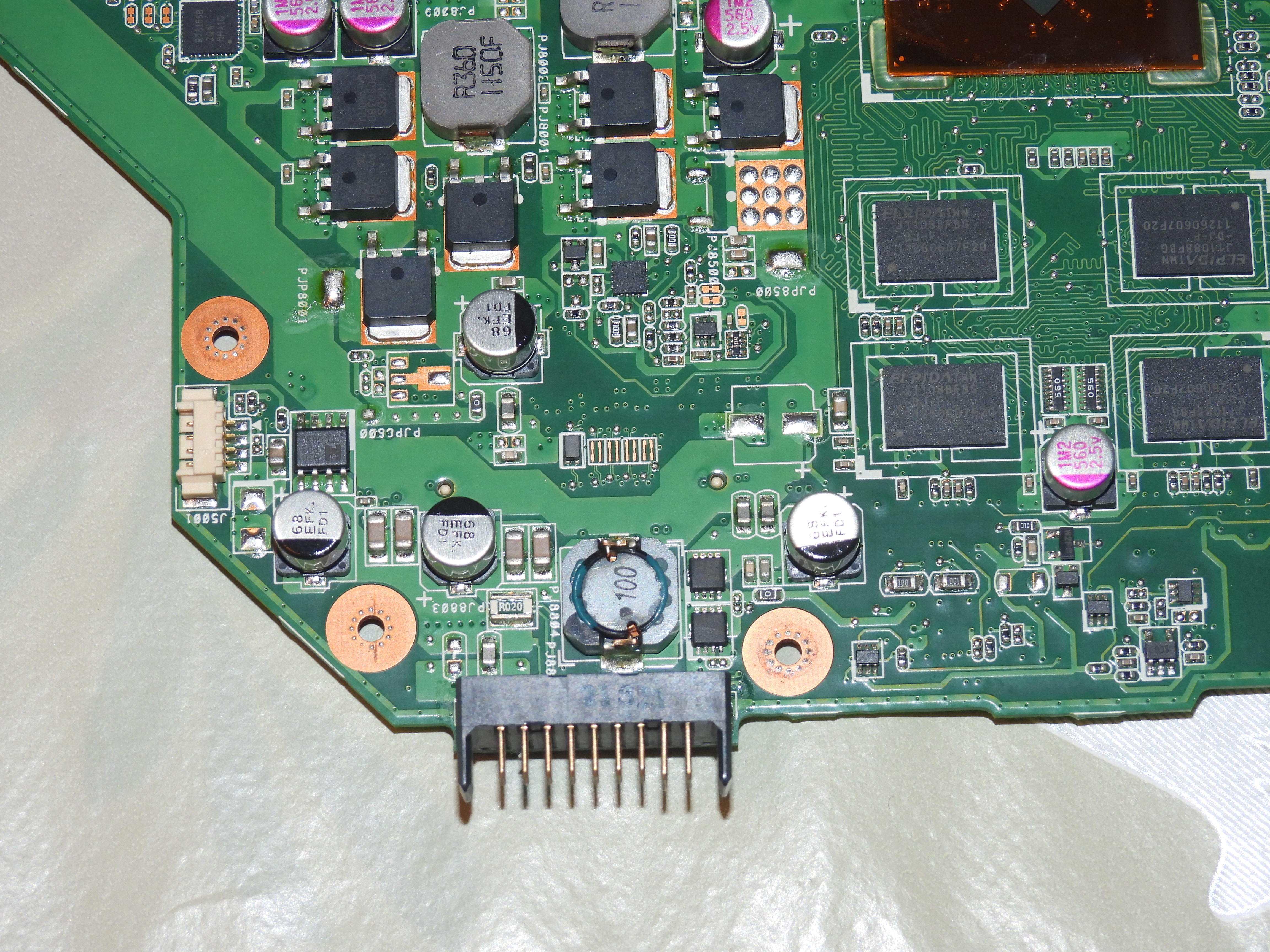

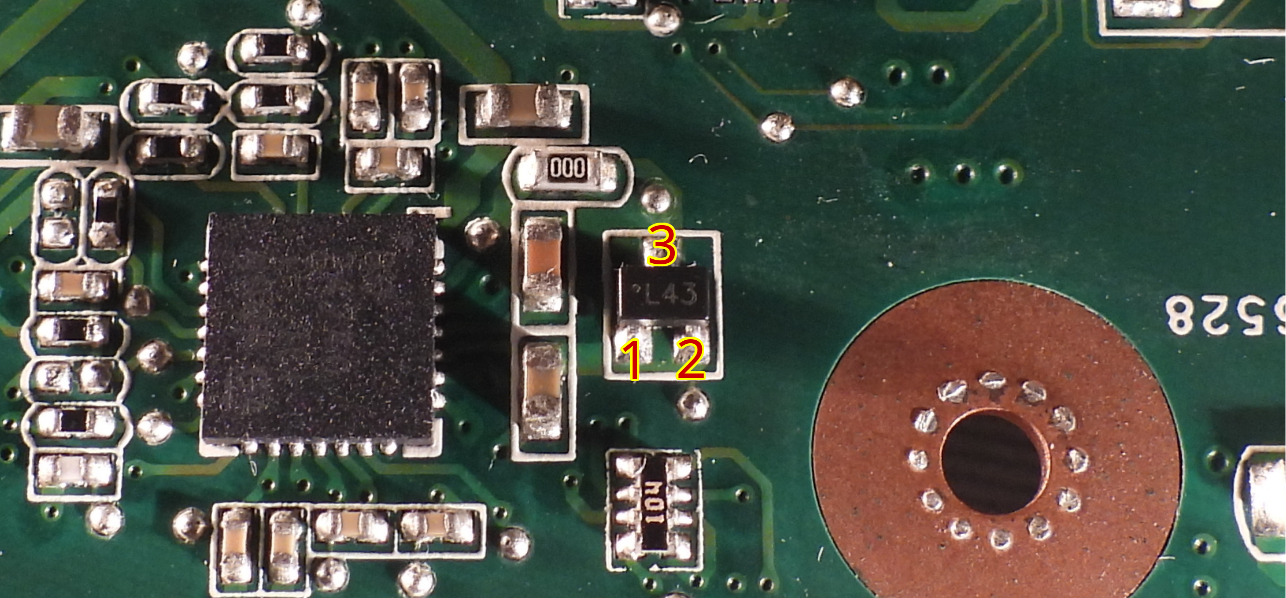

      Review the dual common cathode diode that is likely feeding the VCC of the BQ charger IC. Remove all power. Meter in diode mode. Confirm that the dual diodes are working properly.
      Red meter lead on anode of one diode; black meter lead to Vcc pin. Meter should conduct. Reverse the leads. Meter should block.
      Repeat with the next anode of this dual diode and the VCC pin. Have seen where this part is leaking / defective and raises the same issue.

        Thanks guys.
        I measured the two resistors you circled in red with power removed
        PR8802 the one parallel beside the cap 46.16 kohm
        PR8803 the one on left which connects to charger input 57.55 kohm
        measured voltage on ACDET
        only battery connected 0V
        battery and charger connected 2.685V
        I tested the diode in diode mode with all power off
        Click image for larger version  Name:	diode test.png Views:	0 Size:	3.60 MB ID:	3667280
        red probe on pin 1 black on pin 3 gives 0.259V, reversed OL
        red probe on pin 2 black on pin 3 gives 0.258V, reversed OL
        one probe on pin 1 and other on 2, both ways 0V, expected as anodes are on same pad.

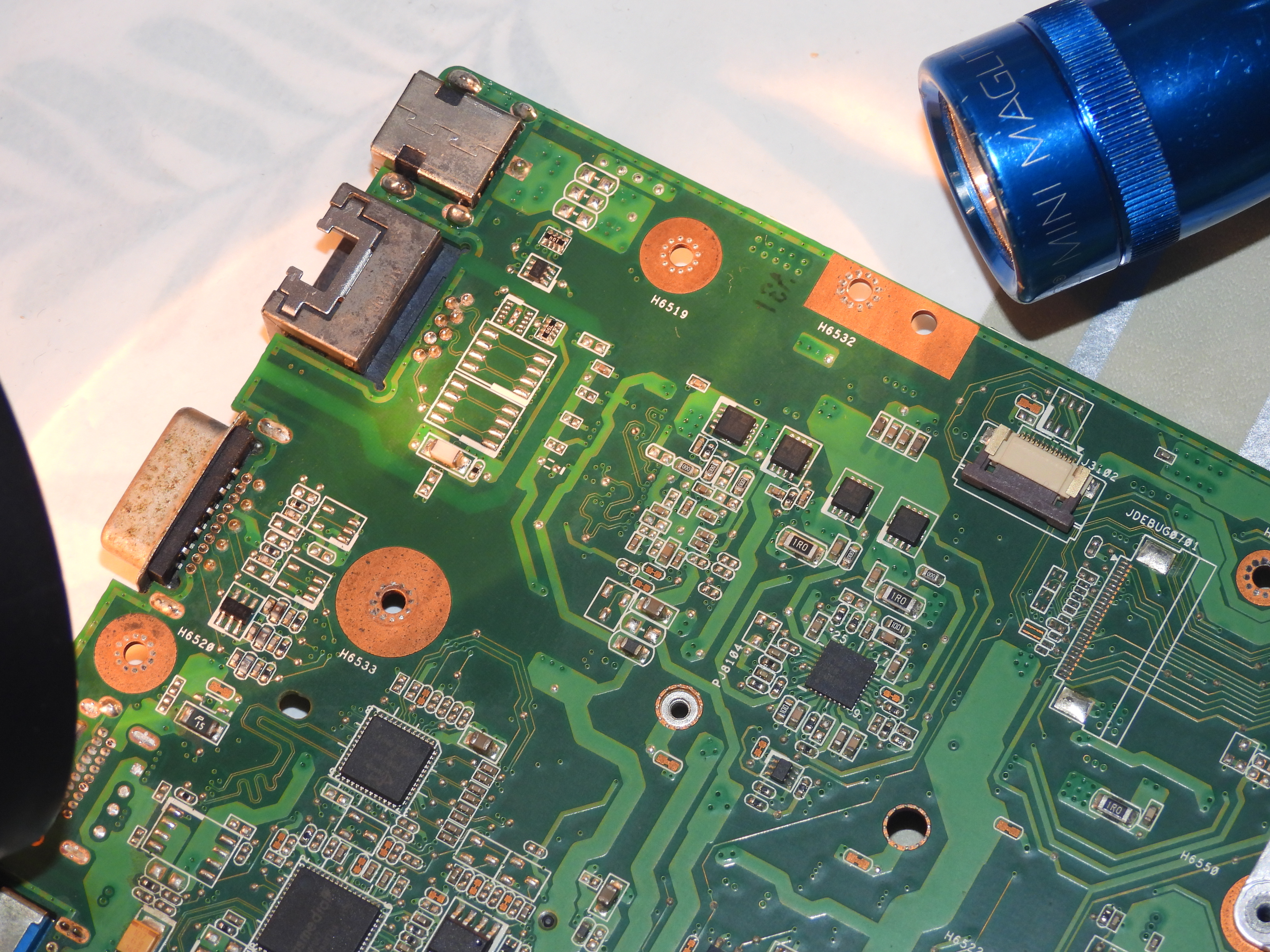

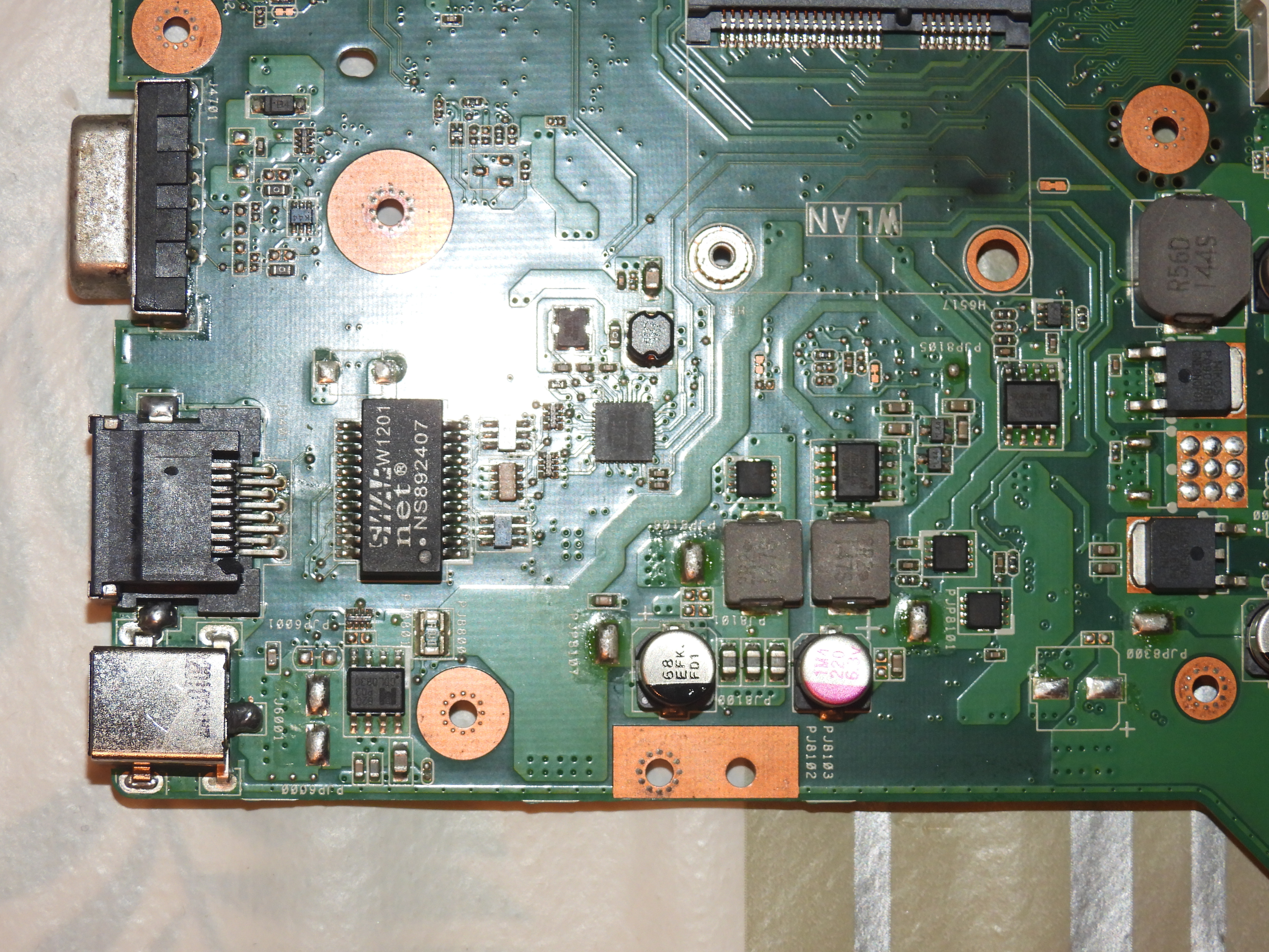

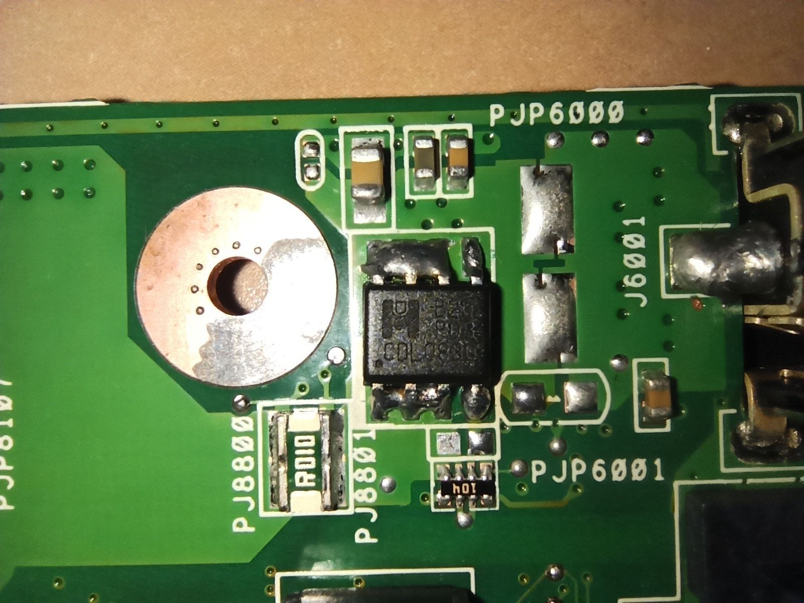

          Remove all power. Meter in resistance mode. Measure the resistance across each dcin mosfet.
          source & drain
          source & gate
          gate & drain
          post each measurement. Test both dcin mosfets.
          • flat-earther
            • Dec 2022
            • 127
            • palestine
            source & drain
            source & gate
            gate & drain

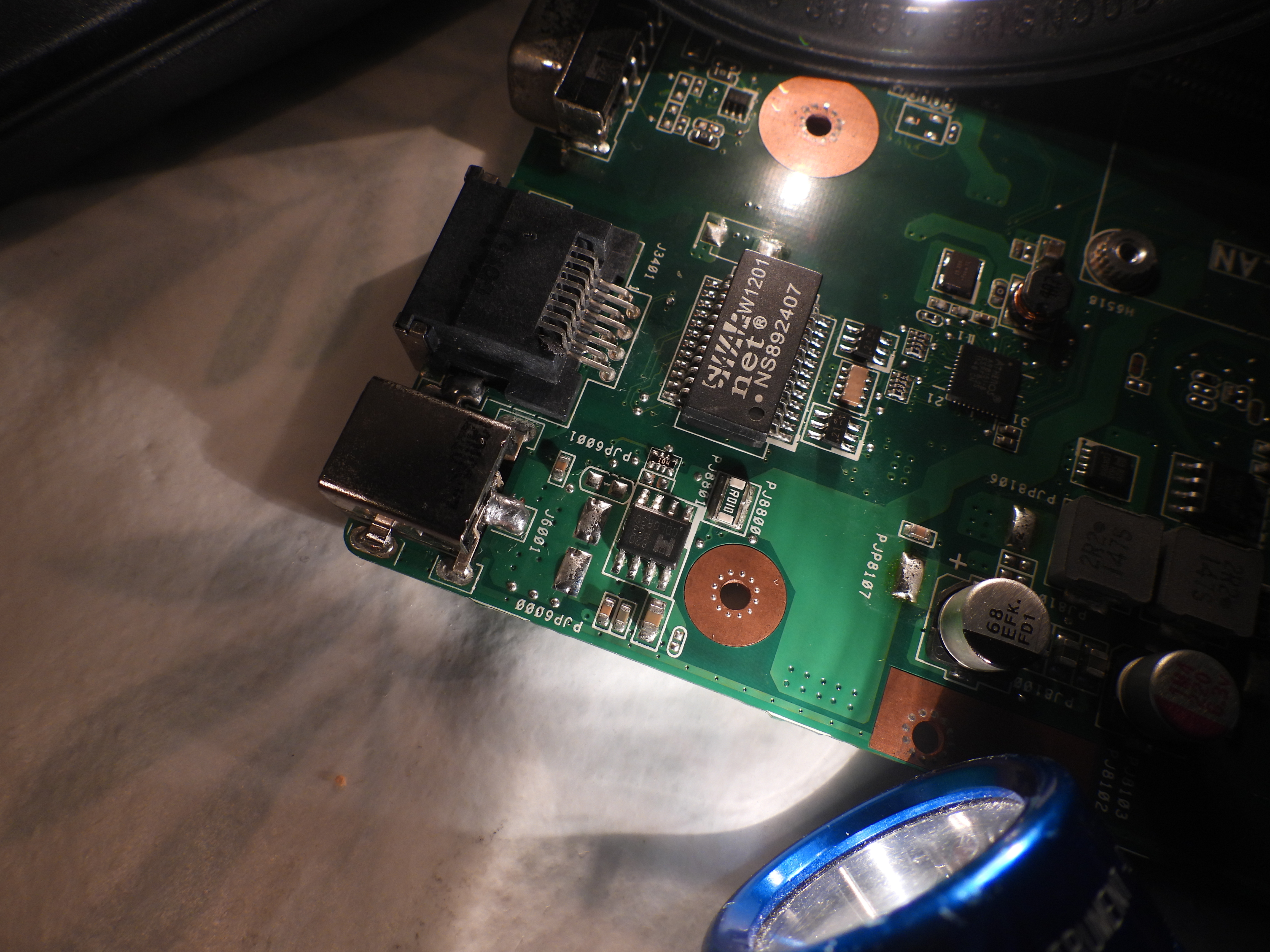

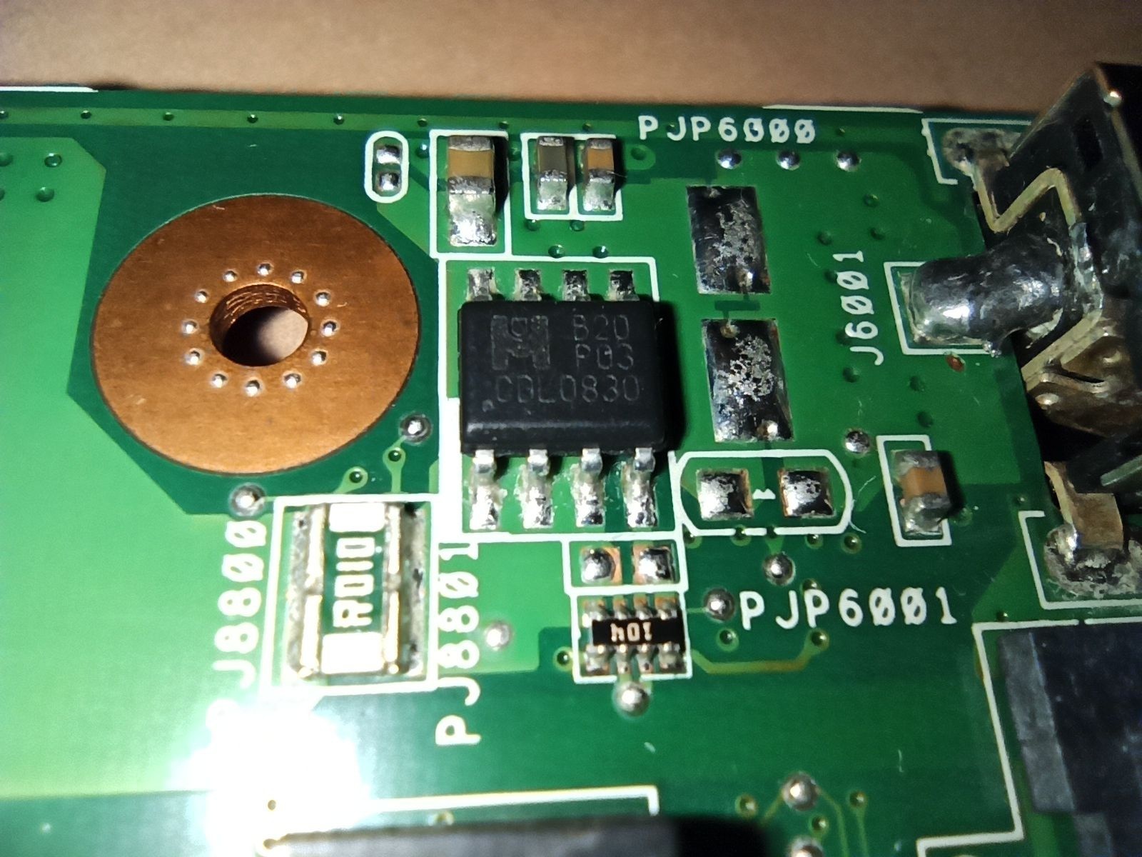

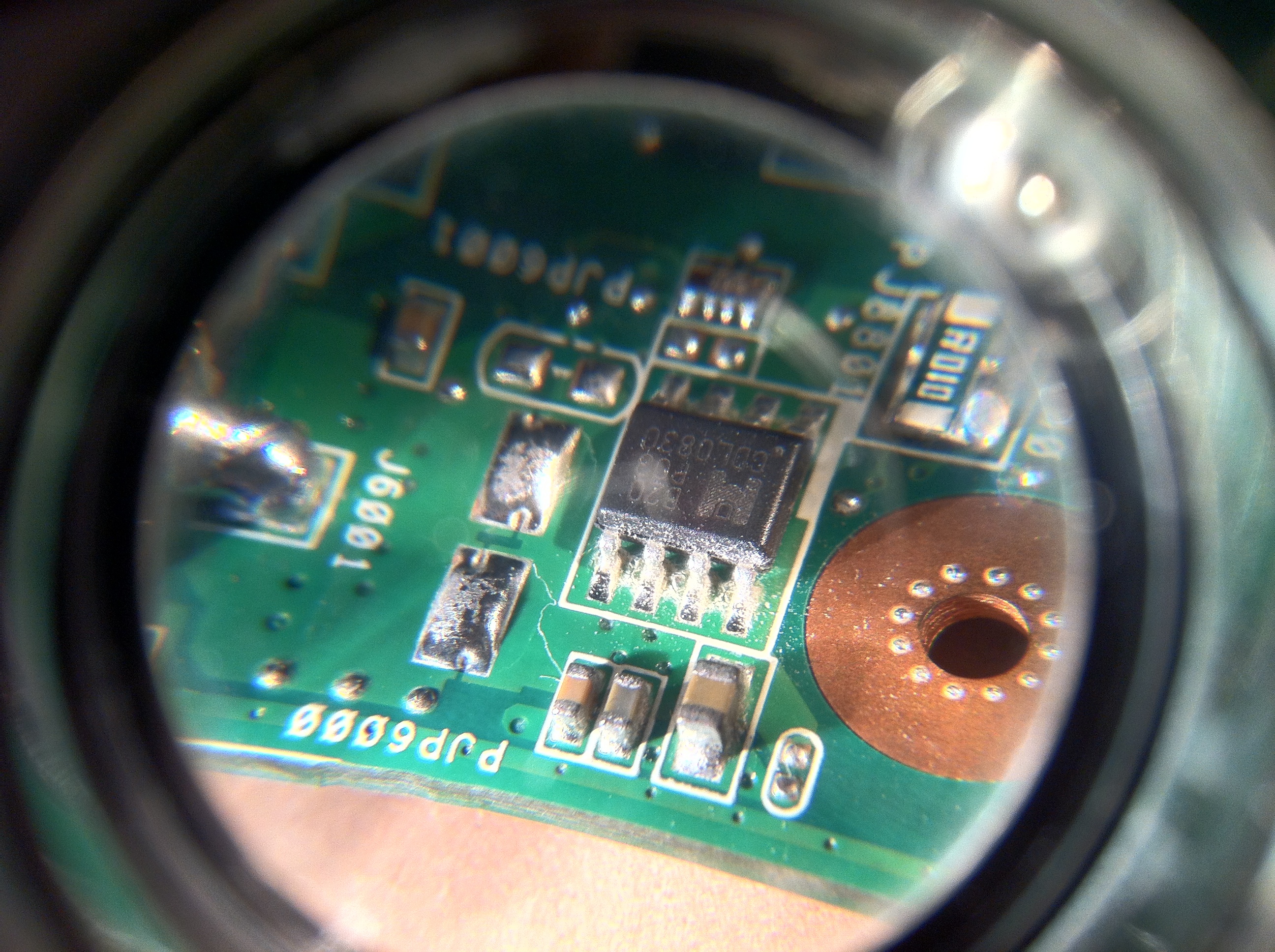

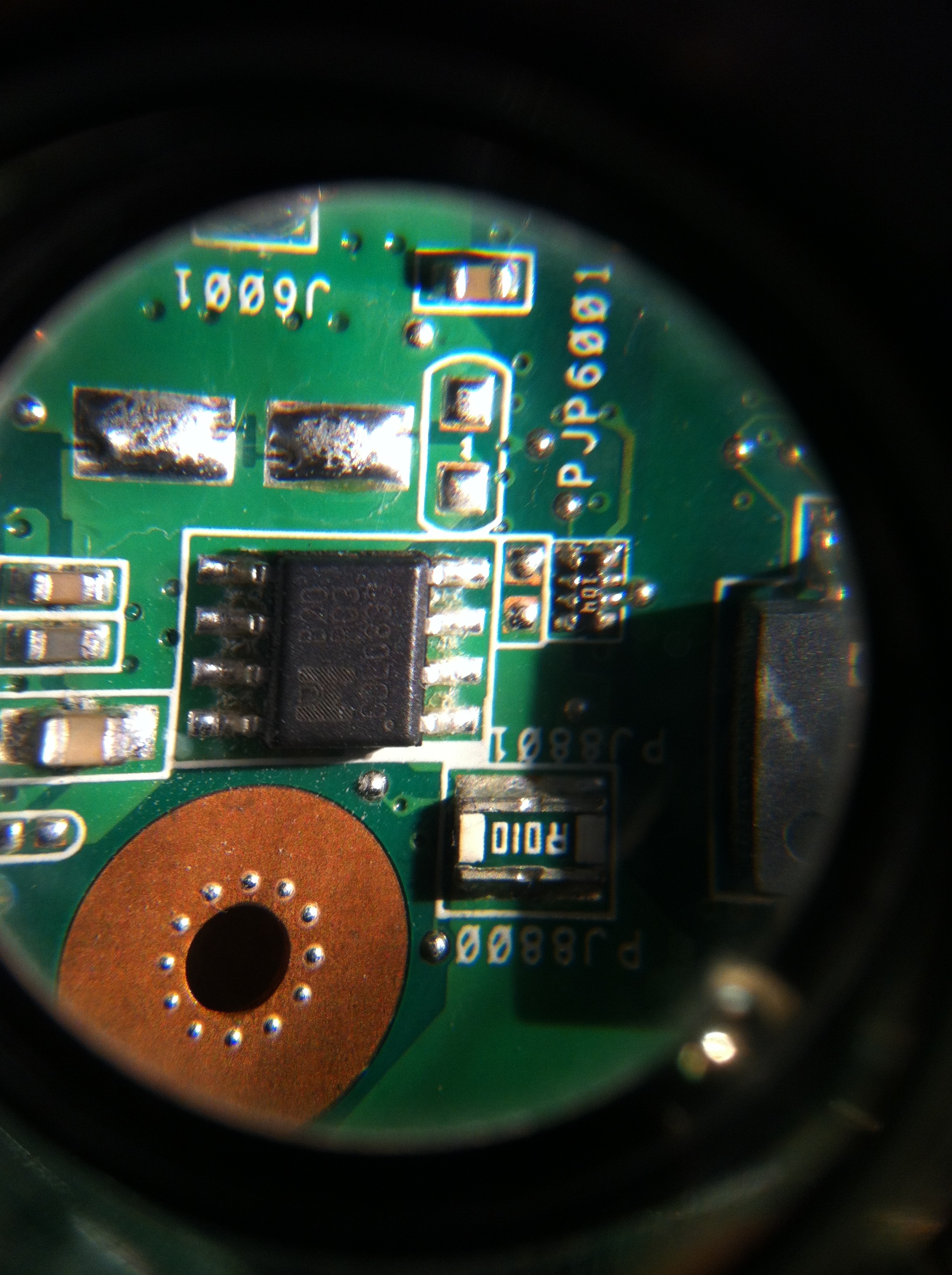

            Near the DC in jack I only see one mosfet PQ8802. Is there another I need to test?
Name:	PQ8802 DCIN mosfet1.jpg
ID:	3667474 Click image for larger version
Name:	PQ8802 DCIN mosfet2.jpg
            I tested PQ8802
            red probe on source black on drain 60kohm and rising, reversed OL
            red on source black on gate 140kohm, reversed 197kohm
            red on gate black on drain 230kohm and rising, reversed OL
            • mon2
              • Dec 2019
              • 14694
              This is a low measurement to me. Flux and carefully remove this part. Then test the resistance again of this part while it is on your workbench after it has cooled. Are the measurements similar? Each measurement must be hundreds of k ohms on a mosfet else may be defective.

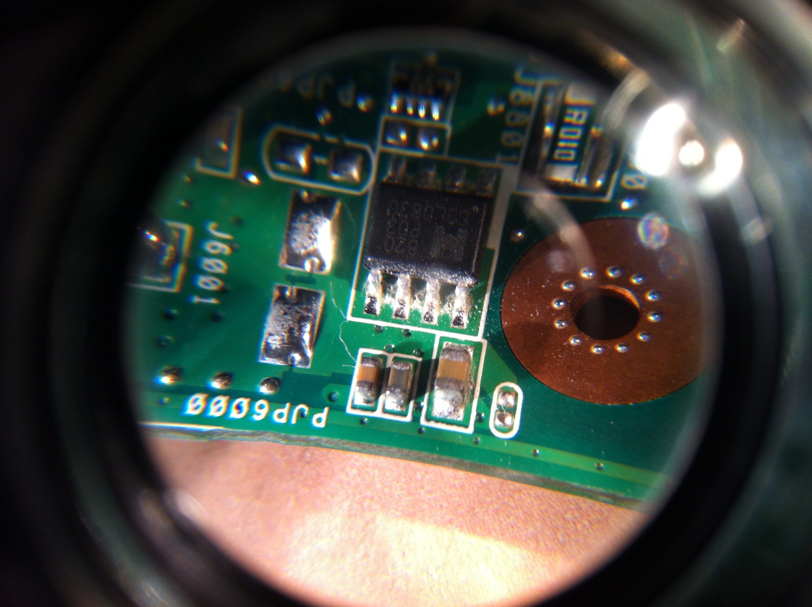

                I removed the mosfet with two soldering irons because that's what I have.
                now with it on the bench I repeated the measurements
                red probe on source black on drain OL, reversed 60kohm
                red on source black on gate OL, reversed OL
                red on gate black on drain OL, reversed OL
                • mon2
                  • Dec 2019
                  • 14694
                  Yes, looks ok.
                    Yes, looks ok.

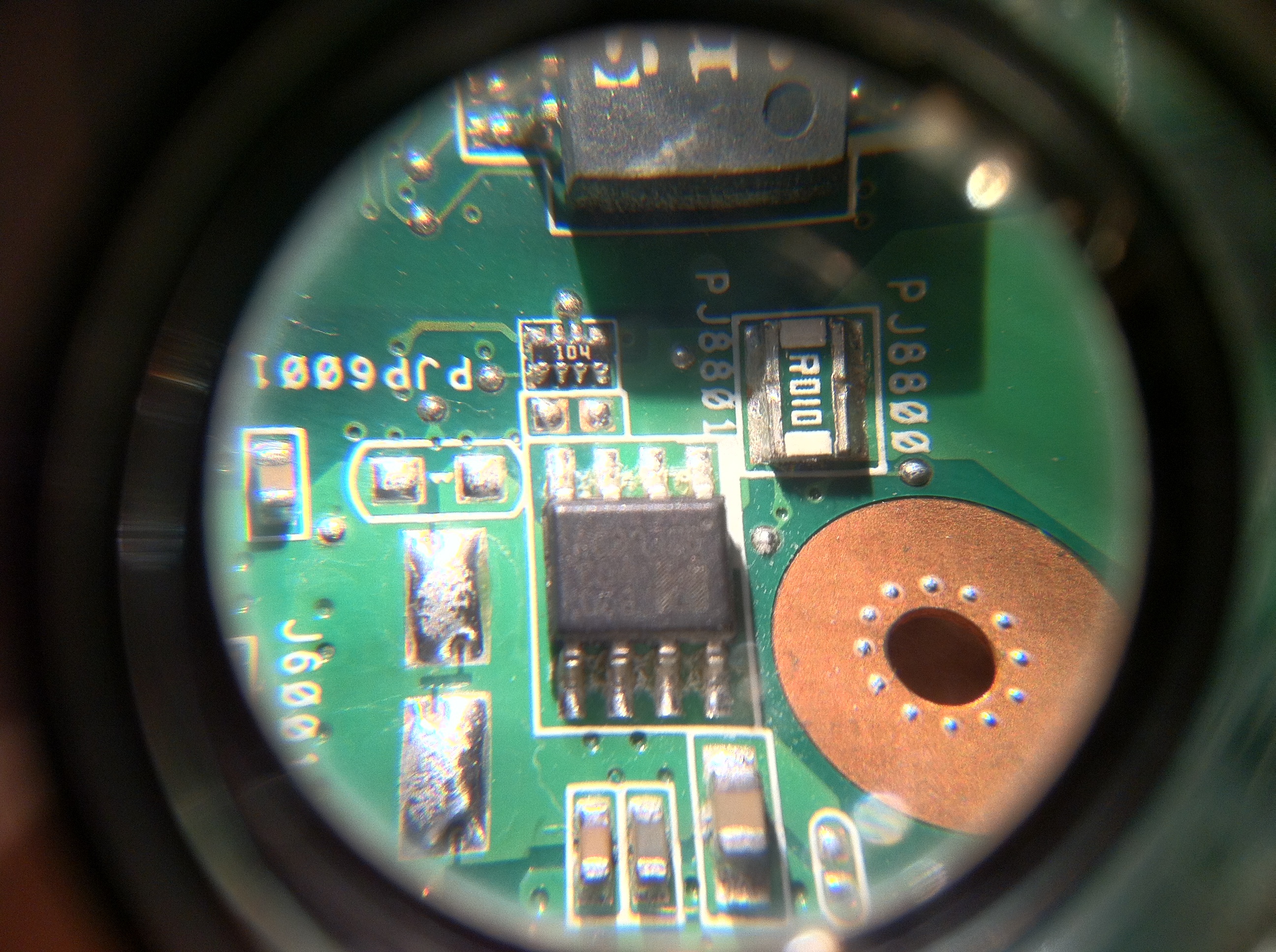

                    Okay I returned the mosfet, was a challenge.
                    Click image for larger version  Name:	DCIN mosfet returned.jpg Views:	0 Size:	353.6 KB ID:	3667723
                    I probably should've plugged the battery in before returning it just in case to check if the problem existed without the mosfet but I already returned it.
                    BTW with the battery plugged in without charger the mosfet source is at 11.85V, gate 11.62V, drain 0V

                      Anothere example of the problem, only battery plugged into motherboard and charging light is on:
Name:	problem example.jpg
                      • flat-earther
                        • Dec 2022
                        • 127
                        • palestine
                        After removing and returning the mosfet there is change in behavior.
                        Now sometimes when I plug the battery in without charger the charging light doesn't come on, and sometimes it does.
                        And when I unplug the charger sometimes the light goes off as if the problem went away and other times not.
                        and sometimes when the charging light is on without charger connected and then I plug in the charger, the charging light blinks off and immediately comes on again, and sometimes it just stays on without blinking.
                        And few times with only battery connected the charging light randomly turned off and on.

                          Replace this mosfet. To me, it is flaky. If you are not comfortable with the process, suggest to work with a local cell phone tech with hot air tools and flux. That is the secret.

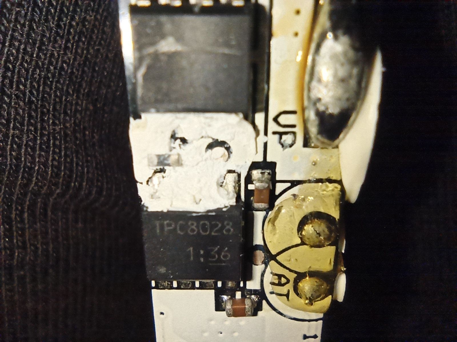

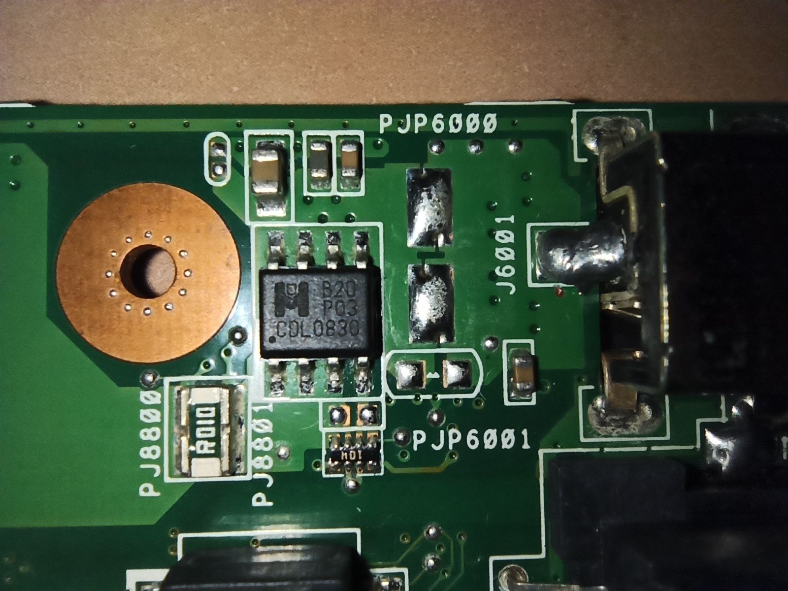

                            Okay then I think I need to buy it from aliexpress. do I need exactly same brand and model mosfet or what do you suggest?
                            BTW I have a PCB from my old laptop battery which has two mosfets the same size, would those be compatible?
Name:	old mosfet1.jpg
                            I used a lot of flux and added 63/37 solder, although it was challenging I think I can manage.
                            • m1ch43lzm
                              • Mar 2019
                              • 982
                              • Peru
                              On MOSFETs you have to match at least:
                              - Type (N or P channel)
                              - Package
                              - Max Drain-Source voltage
                              - Power rating (same or higher)
                              - Current rating Id (similar or higher)
                              - Vgs(th), gate threshold voltage (similar)
                              - Rds(on), drain-source on resistance (same or lower)
                              - Maybe some other parameters
                              The MOSFET you have is EMB20P03G (marking B20 P03), it's P channel, -30V, -10A, 20mOhm Rds(on)
                              A suitable replacement could be AO4435
                              Probably you can find a suitable replacement on another laptop motherboard, check the datasheet and compare it to yours
                              The one from your battery is TPC8028, it's N channel so it won't work here, can't read the other one
                                - Package
                                Thanks for the info. I already found B20P03 and ordered it. It looks unbranded. https://www.aliexpress.com/item/1005009041221345.html
                                I don't have other motherboard.
                                The other mosfet from the battery was the same.

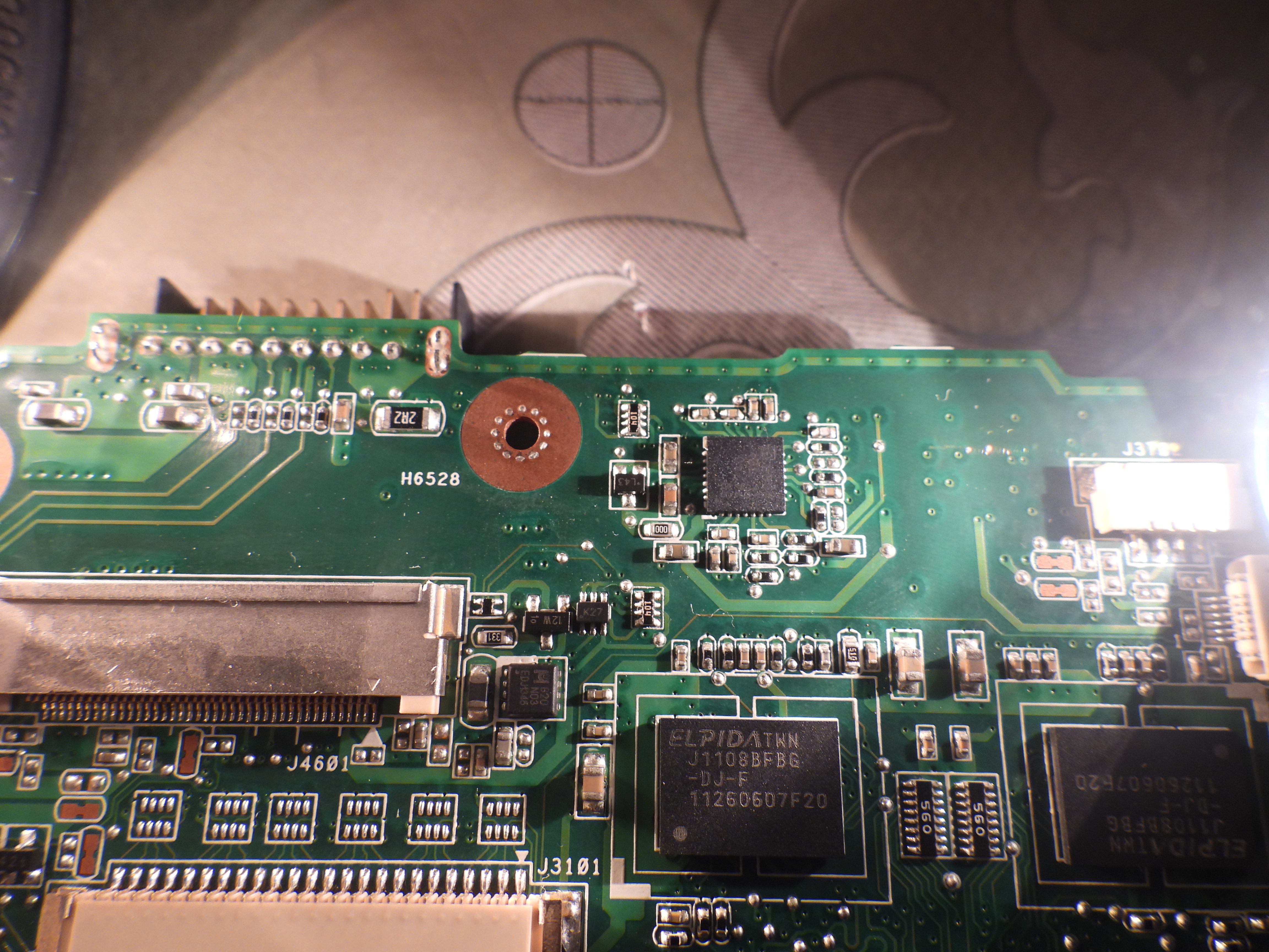

                                    The battery charging chip is far from the DCIN mosfet where I soldered.
                                    Tell me if you want me to check anything specific with the multimeter next time I disassemble the laptop.

                                      I have received the new DCIN mosfet B20P03, but the problem of the charge light staying on with charger unplugged has not come back at all, so for now I'm not changing the mosfet.
                                      One related problem that I mentioned initially does still exist though, occasionally the charging light on my laptop starts flashing green and red alternately.
                                      Replugging the battery makes it stop, until it randomly starts again.

                                        So the battery just would not charge.
                                        Then I unplugged and replugged the battery after which it started charging normally with the charging light on.
                                        Could this new problem be the battery and not motherboard?
                                        I have two batteries and this particular battery I was using is a high capacity one which has extra cells.
                                        I will now change to my regular capacity battery and see how the behavior is with it.
                                        BTW both of these batteries are aftermarket, but I'm very confident that at least the original problem that started this thread is motherboard related as it happened with both batteries.
