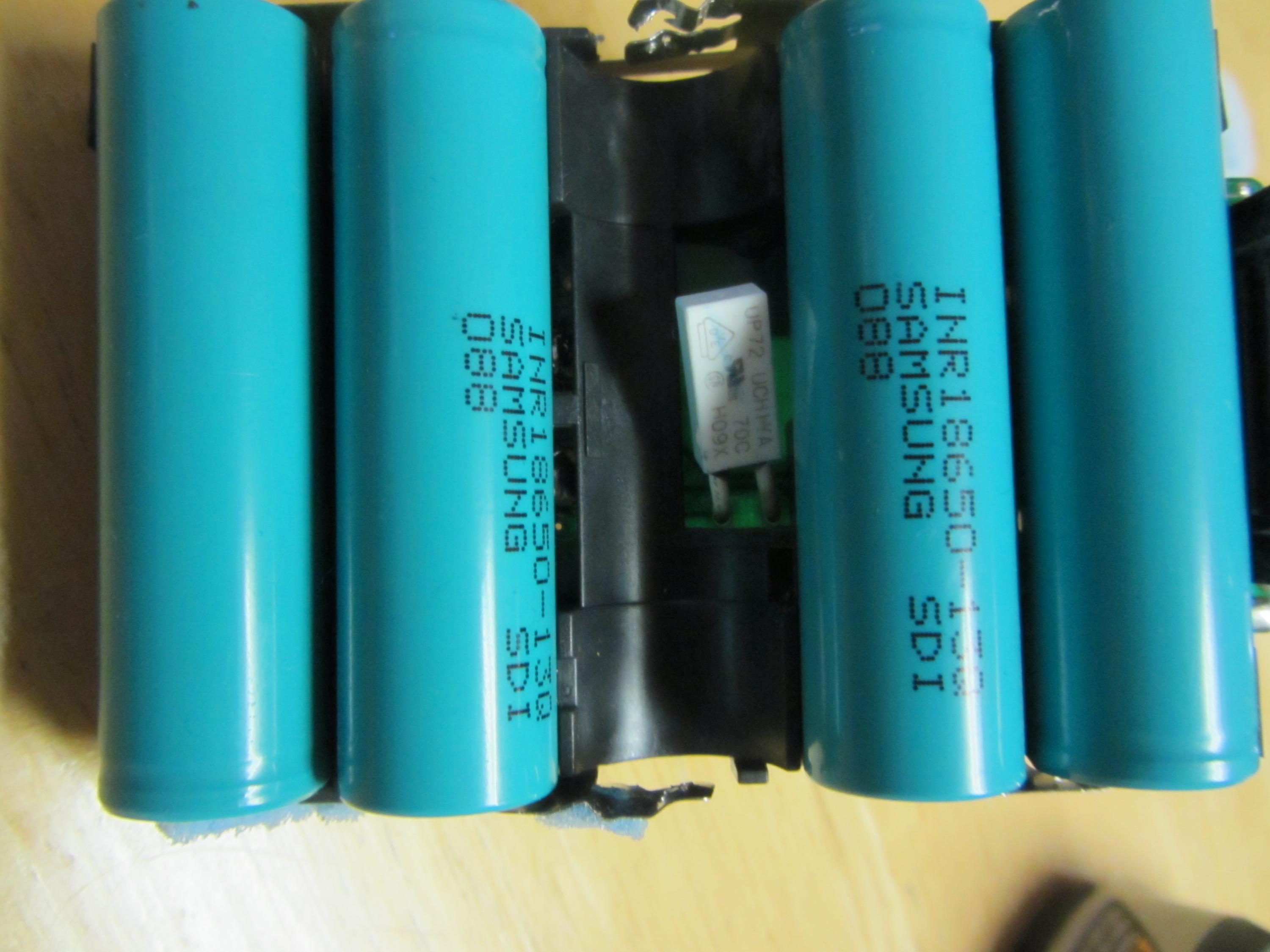

                      Got my battery pack working with the BMS issue I am thinking it is a bad thermostat that is cutting the voltage down to 12v for instance when you really heat up your drill with tons of drilling and it overheats and shuts down until it cools off like 2 seconds later I think what it does is cuts the voltage down to 12v on the drill to make it inoperable something similar to a thermistor just packaged a bit different than what I am used to ... The only worry is not having this piece in play could be dangerous so I am going to mark that battery so I know not to jam on it too much.

                        #31
                        Re: 18650 lithium cell need help understanding risks
                        The little white brick underneath the middle battery is a thermostat...
                        I did a little testing with my drill put some real torque on it and the exterior plastic casing after holding the chuck on drill got mighty hot 125 degrees F so I'm thinking it may just be best to replace the thermostat rather than jumper the battery bank... To the battery output I can see there is an inherent danger not letting the pack run as it is supposed to through the board.
                        @BudM I am curious if you have ever got that picture taken?

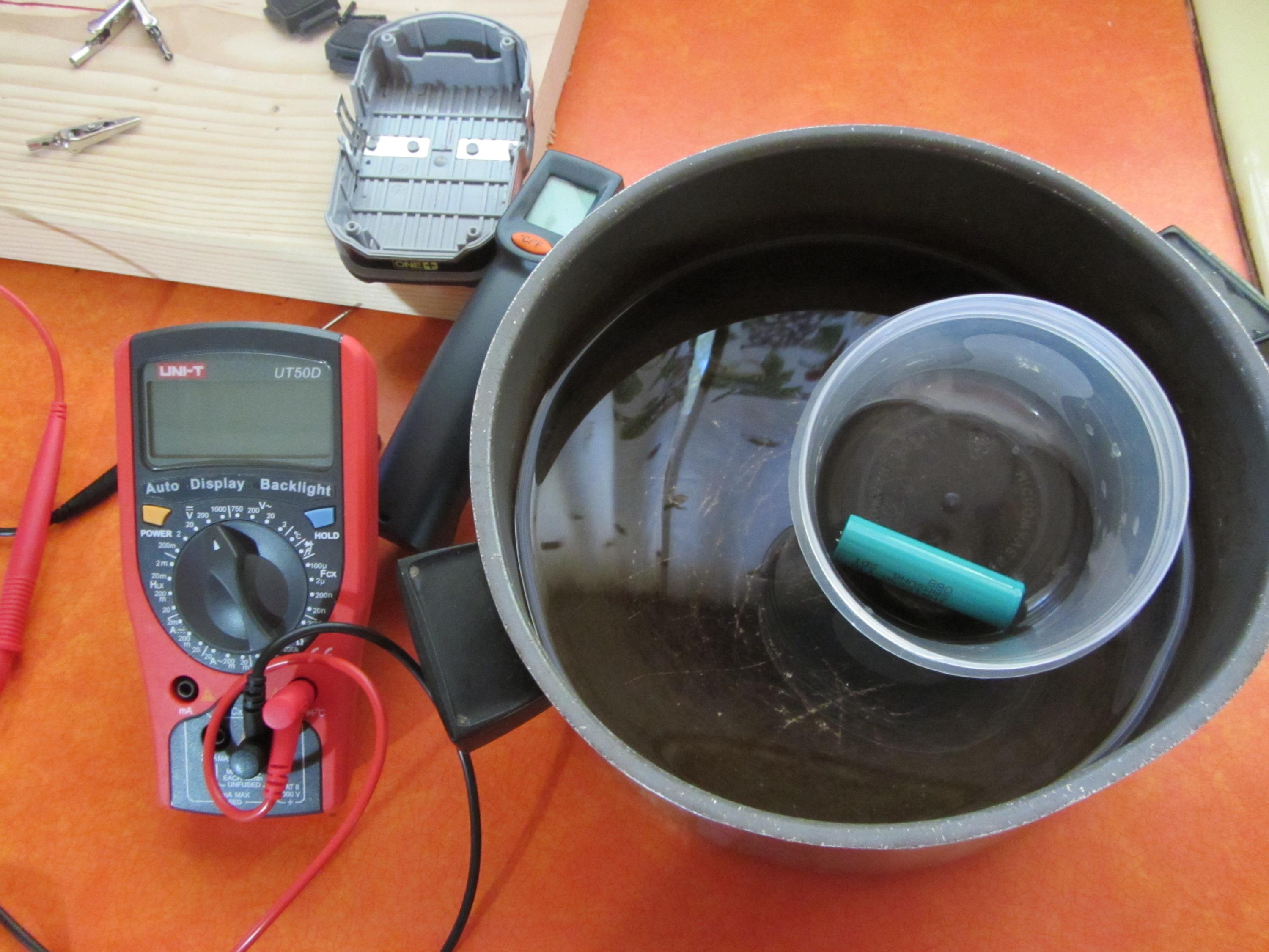

                          Originally posted by infringer
                          yeah may be oddly I was able to recharge some cells that were showing 0v 4 out of 5 of them actually one of them would not go above 1.3v and started getting warm I monitored the thing with a meter and a IR thermometer the whole time it was charging just to be safe so hours of looking at batteries is not my idea of fun lol but my rig was primitive a meter and a 5v 500ma charger hacked up with some gator clips screwed to a hunk of 2x12 the voltage held at 3.6v and it is about 9hours that has passed so I assume the cells are still good and they just fell asleep well 4 out of 5 of them. We will see I got a 18650 usb charger on order from xtar to safely top them off using the word safely loosely cause I will have to pay attention to it and make sure it doesn't overcharge the cell I will likely charge inside of an old computer case just to somewhat contain anything that may happen from topping them off but the cells look as good as new or I would not have even attempted it.
                          Finally I will say that the cell will not take a charge if it shows 5 v and does not change when your leads touch the battery's anode and cathode.
                          Do not try this I take no responsibility for anyone trying this I did this in a well contained and safe area with a fire extinguisher near by that is suited for this type of fire. Do not try it at home!

                            yes of course after they wake up I check the voltage immediately anything above 1.5v I charged.... I read somewhere 1.5v was the magic number ... (I could be wrong here but so far so good no issues...)
                            Usually dendrites will show as the battery will discharge after a few hours but I wait a couple of days to be sure... as long as the cell is within .2v or 4.0v to 4.2v after 2-3 days of sitting in a small bowl inside a larger stainless steel bowl of water for safety. This way if it gets hot enough to melt the plastic bowl it will fall into the larger stainless steel bowl filled with water to instantly bring a cooling effect to the cell... I have read this as well and so far the information has been accurate.
                            Interesting facts that I found about temps though are:
                            Should the pressure rise further, a safety membrane bursts open at 3,450kPa (500psi) and the cell might eventually vent with flame. The thermal runaway moves lower when the battery is fully charged; for Li-cobalt this threshold is between 130–150C°C (266–302°F), nickel-manganese-cobalt (NMC) is 170–180°C (338–356°F), and manganese is 250°C (482°F). Li-phosphate enjoys similar and better temperature stabilities than manganese.
                            Obviously though thermal run away cannot be prevented in some cases so I exercise extra safety precautions because of this ...
                            UL has made it so that lithium cells in production have to pass a "nail puncture test" this test is exactly what it say they have to be safe when being punctured by a nail...
                            I was wrong in stating the battery was 0v once woken up it was at 1.8v please accept this correction but yes this battery would not rise in voltage so it is indeed bad as the voltage rise should be rather quick in the beginning within the first minute you should see a rise in voltage if you do not pull it off and recycle the cell. And as a safety I use an ir thermometer at all times or if I run out of battery I pull out the temperature meter and tape a lead on to the batteries surface.
                            Trust me safety is a grave concern for me in learning about these cells... Soldering the cells is done in intervals constantly monitoring the temperature of the cells being careful to not cause any sparks or arcs that could potentially set the batteries hydrogen off gas if there is any ablaze this is nothing for a typical person without a lot of the proper tools I will admit in my first attempts I did cause an arc on one of my packs and I jumped about 5ft back in my chair and about crapped my pants since then I am extra cautious I electrical tape leads that could be shorted. There is no such thing as too much safety when dealing with these cells this I think we all can agree on.

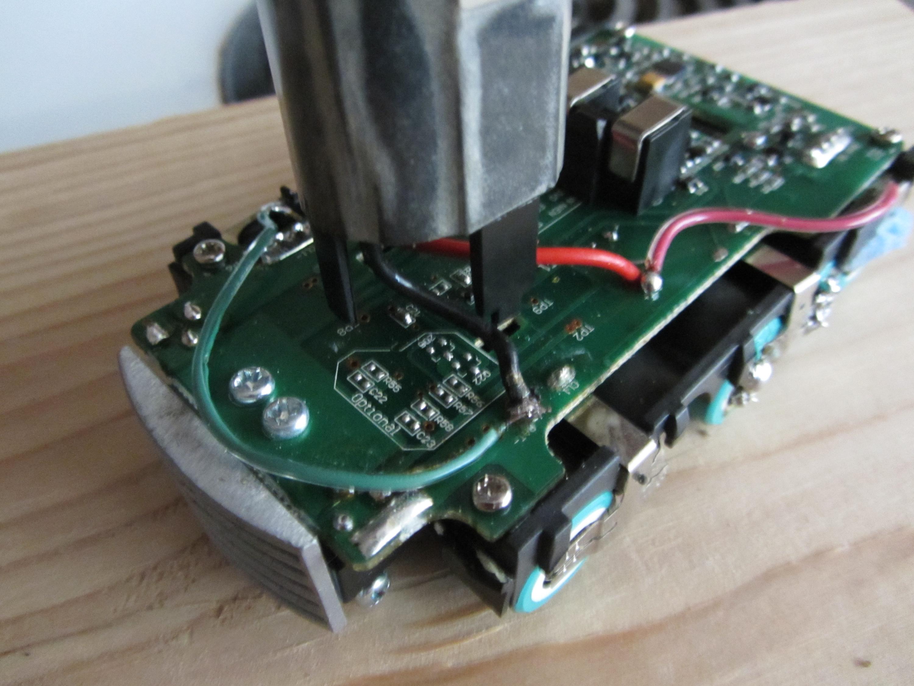

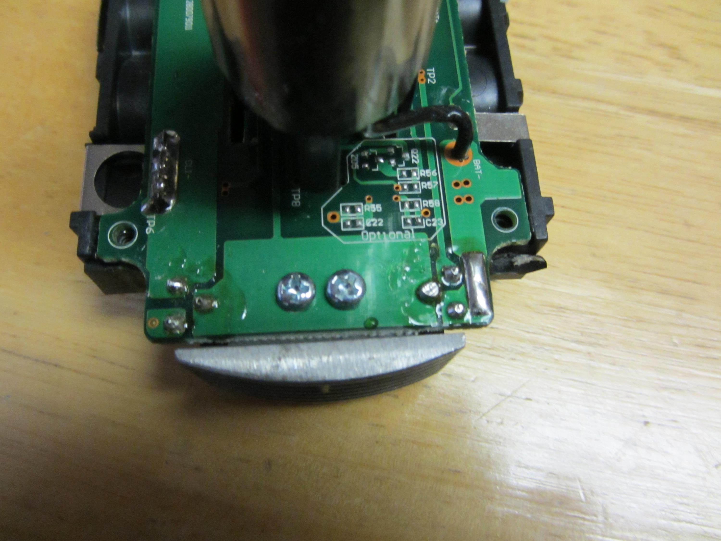

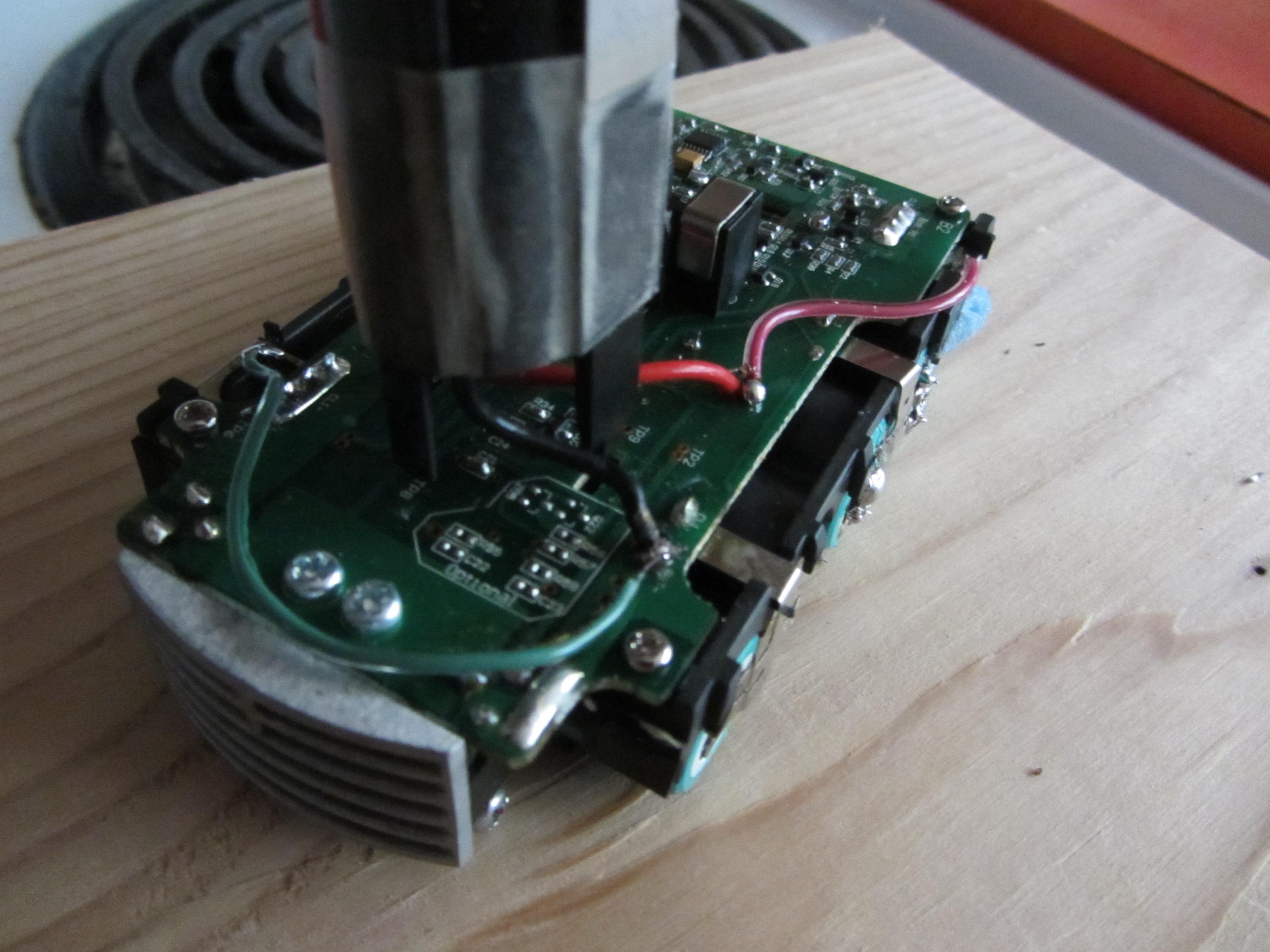

                              #34
                              As long as the cells are within .2v not 2v could a moderator please correct the statement above to reflect this on my previous post thanks!
                              Here are some pics of the safety precautions used...
                              Also I attached some pictures of the modification to get the BMS board working if you have the proper voltages at the battery bank while I do not recommend it as a finished product it is a good way to test if something has went wrong on your board likely I suspect that in many cases it will be your thermostat which looks like a little black bead or ir sensor on lithium+ hanging on the side of your battery under a pad and for lithium standard batteries it is a white box looking thing underneath the middle battery P103 variation...
                              One thing to note some newer P103 batteries have the same cells used in lithium plus batteries which are LG based... So essentially it is a lithium+ without the fuel gauge. I like the look of the lithium+ batteries better as far as operation goes and durability I will say from my tests the p103 non lithium+ battery seems to be more durable than the P107 lithium+ battery and for the record it appears that all double pack ryobi batteries are the worst when it comes to durability an educated guess would be the heat that is causing them to fail more batteries more heat and confined space lowers the life span. I would rather walk a block and change my batteries a couple of times a day than have a battery that will last only 2/3 of the life span.
                                  I repair these battery pack as well and the modification that you doing should ONLY be done as a TEST
                                  The big problem with these boards is that the mofet on the heat sinks go partly bad if you load the tool a little to much the board has to reset
                                  When you replace the mosfets on the board the board work the right way again I have three battery pack right now I have to repair all with the same problem
                                  PLEASE NOTE THAT WHEN CHANGING THE MOSFETS on these board you MUST remove the batteries from the board and take your time when do doing this not to short the battery cells
                                    and when push the power button again it might run a little bit and shut down again keep do this a few time
                                    When the board work right if you over load the battery pack with a real heavy load it shut down until you release the power switch on the tool when you push the switch it should restart again right away unless your battery pack is real warm then it will not restart right away
                                    The Digikey part # for the mosfet is IRF1404PBF-ND....> IRF1404 or IRF1404Z I have look at both data sheet for both part # I do not any thing that different some battery packs use one or the part #

                                      Well what is happening is the output of the batteries is perfect but the output to the posts on the stem of the battery are only 12v I have two batteries like this... Explain this to me so what you are saying is that the fets are what are causing this issue I suppose it is very possible they are causing a lack of power if there is something wrong with them it is a common part the only reason I assumed the thermostat is because a trace from the thermostat looked a little bubbled up so I tried to jumper direct from the thermostat and make my own line with a wire.... Didn't work so I assumed there was an issue I suppose I could have just heated it up checked the data sheets and seen the resistance under different temps I just wanted to get stuff going this weekend in case I did not have the time during the week or next weekend...
                                      I'll order a couple of fets as there is two per pack and give them a shot I really wish there were an easier way to accomplish this without removing the cells as that is the dangerous part of it ... I wonder if there is something I could do without cutting a trace or removing the cells to accomplish this.... I know fets and voltage regulators are very sensitive to static and such but I do wonder if I could use a more sturdy replacement part if this is the case I'll have to research this a bit more before I click the buy button.
                                        I really wish there were an easier way to accomplish this without removing the cells as that is the dangerous part of it ... I wonder if there is something I could do without cutting a trace or removing the cells to accomplish this.... .
                                        There is if you have a de-soldering station you have to heat the tabs on the board until ALL of the solder has melted and suck all solder up then VERY carefully pry the board a little to make sure that the tab is loose then go to the next one and do the same thing......>>>>>>
                                        BE VERY CARE FULL DOING THIS NOT TO SHORT THE TRACE ON THE BOARD when I was doing one these battery packs this happen to me on the first one I did
                                        This will NOT WORK if you try use a soldering wick to do this job
                                          You DO know what happens when Lithium comes into contact with water, right?
