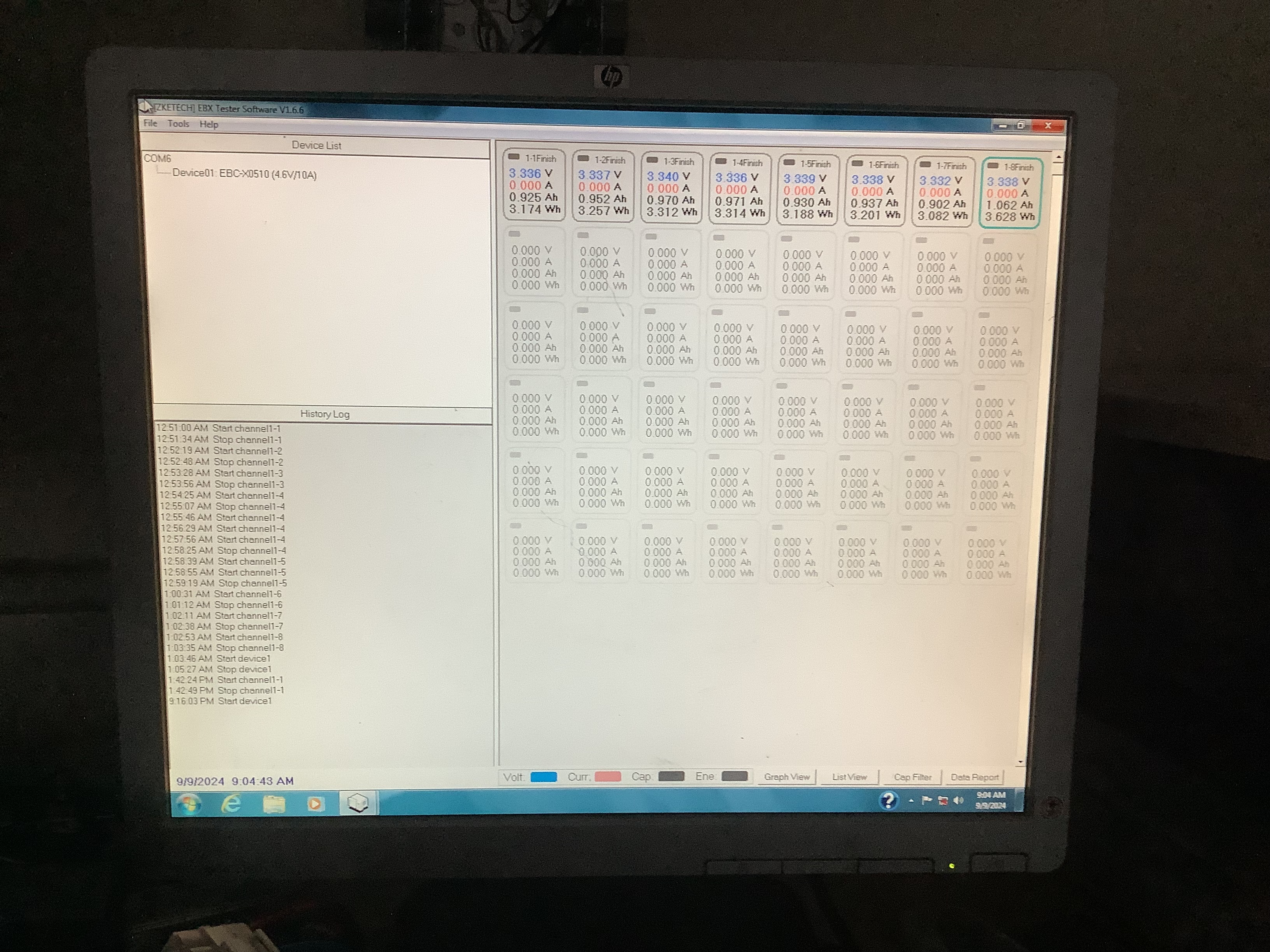

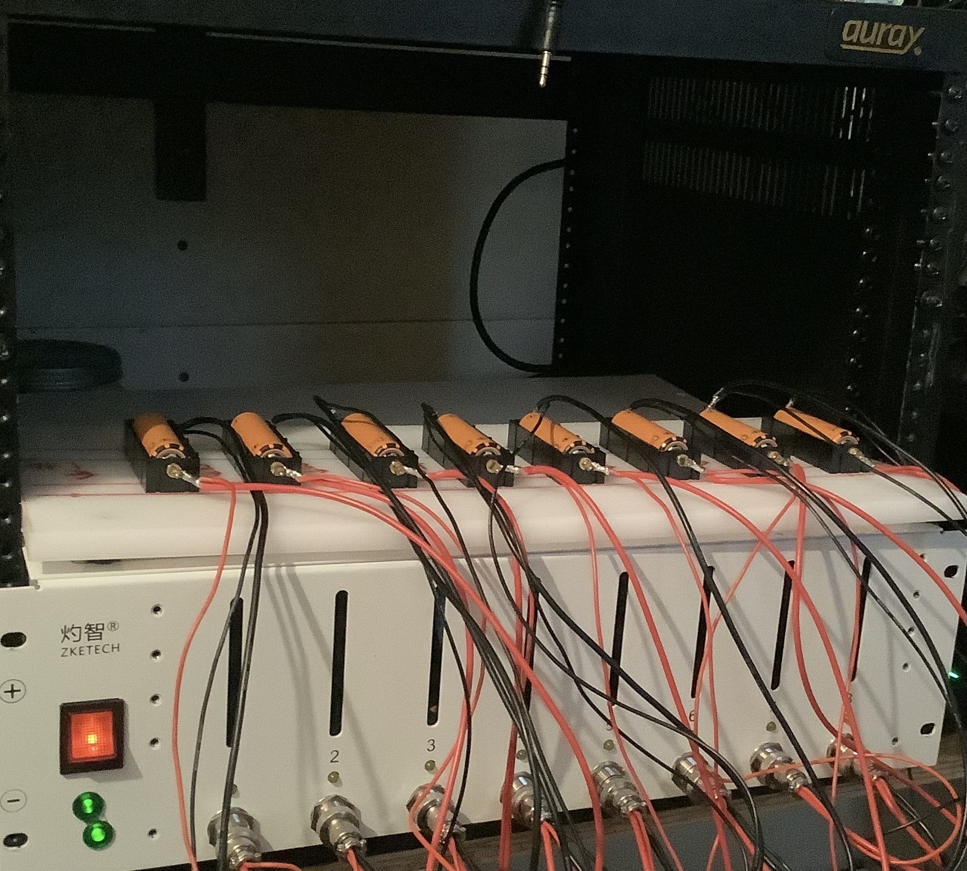

            Well the 8 channel battery machine is back together and hooked up to a computer in the shed working it in a rack system it is the desk model you have the option to put wheels on and when I first got it I installed the wheel but now that it is on the bench I do not want the wheels on it so I removed them in the office I had it under the desk
            I now I have make the wires to the battery cell jig more permanent and more secure connections than the way I have been doing it because sometimes it gives bad results

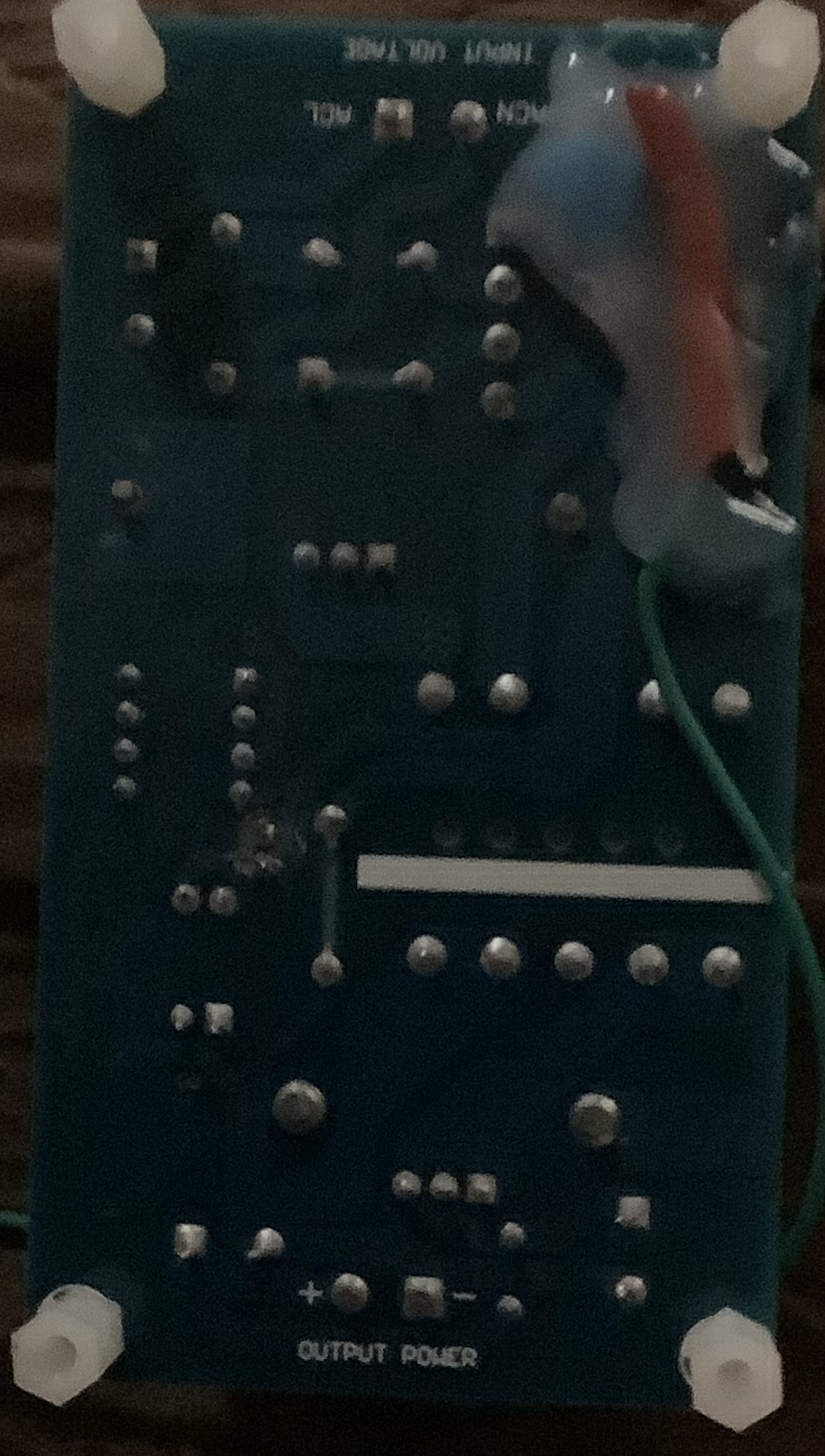

              Well things did not go well for one of the 6 volt @ 60 amp switching power supply because I was not paying attention to a detail that I should have it has a common negative power rail that needs to be connected to each of switching power supplies and input power supply wires are red black and green on the input power supply and on the output side of each switching power supply there are red and black wires well instead of the common output side of of the two 6 volt @ 60 amps it got hooked on line side of the 12 volt @ 3 amp switching power supply instead of output side of the power supply the main fuse for battery tester blew not the switching power supply fuse go figure that would be the case
              I going to fix this issue with the main fuse blowing instead of switching power supply fuse blowing because I going to move the fuses to the outside of the enclosure so that they can easily be replaced instead of having to take apart the switching power supplies apart to do this and I going to move the power indicator led light bulb to above each fuse for each switching power supply unit
              I must have had the biggest brain fart in a very very long ——>
              I was having an issue with one of the 6 volt @ 60 amp switching power supplies it was a lot warmer than the other 6 volt @ 60 amp switching power supply and the cooling fan was not coming on like the one were the cooling was coming on and off with a one amp load this is the one that had the major malfunction ( this switching power supply board got gutted for repair parts bin )
              The switching transistors blew apart the capacitor blew apart near the switching transistors the traces basically blew off the board where the switching transistors
              But here is the weird thing was I had the entire device running for hours without a load the battery testing machine until yesterday when I finally finished the individual wires for each battery cell holder so I would have a better connections

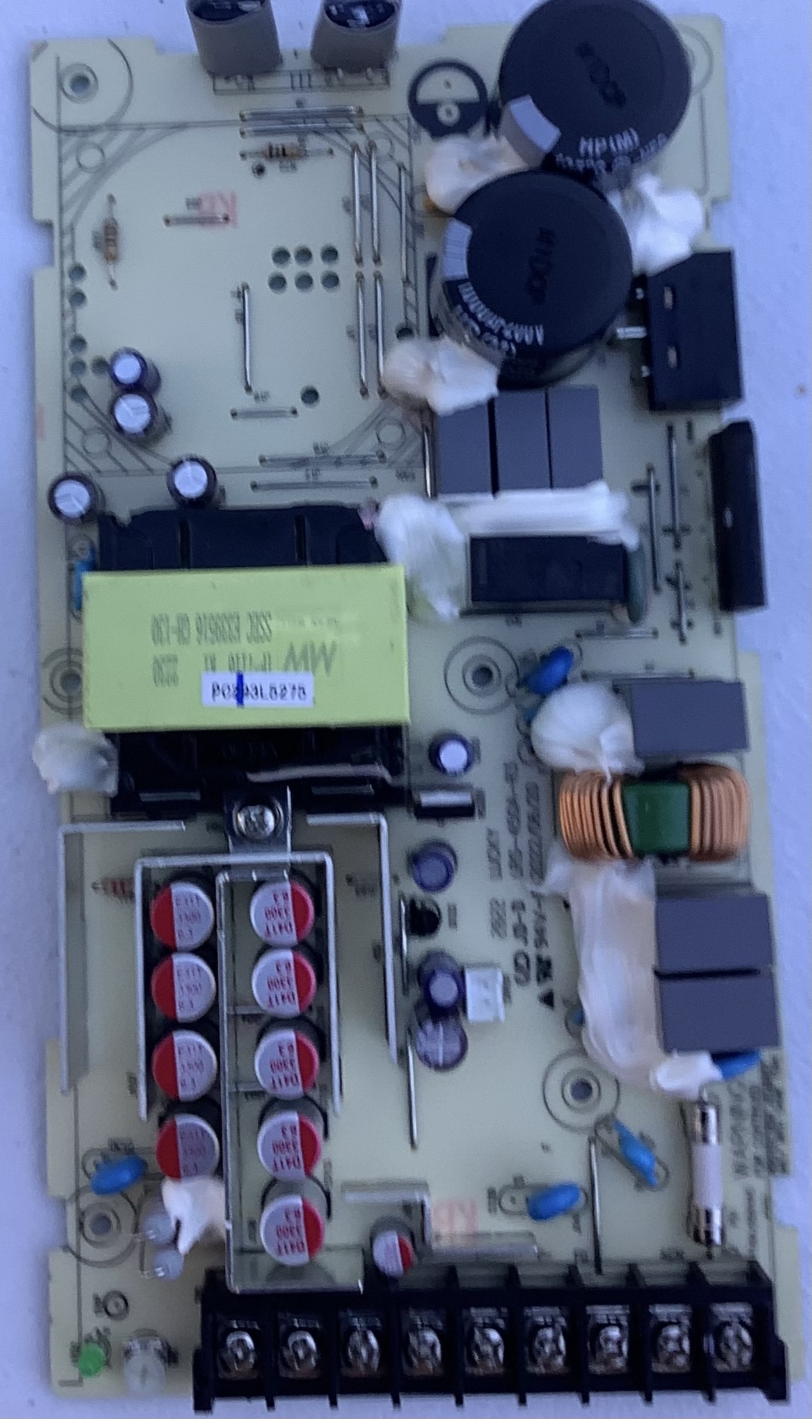

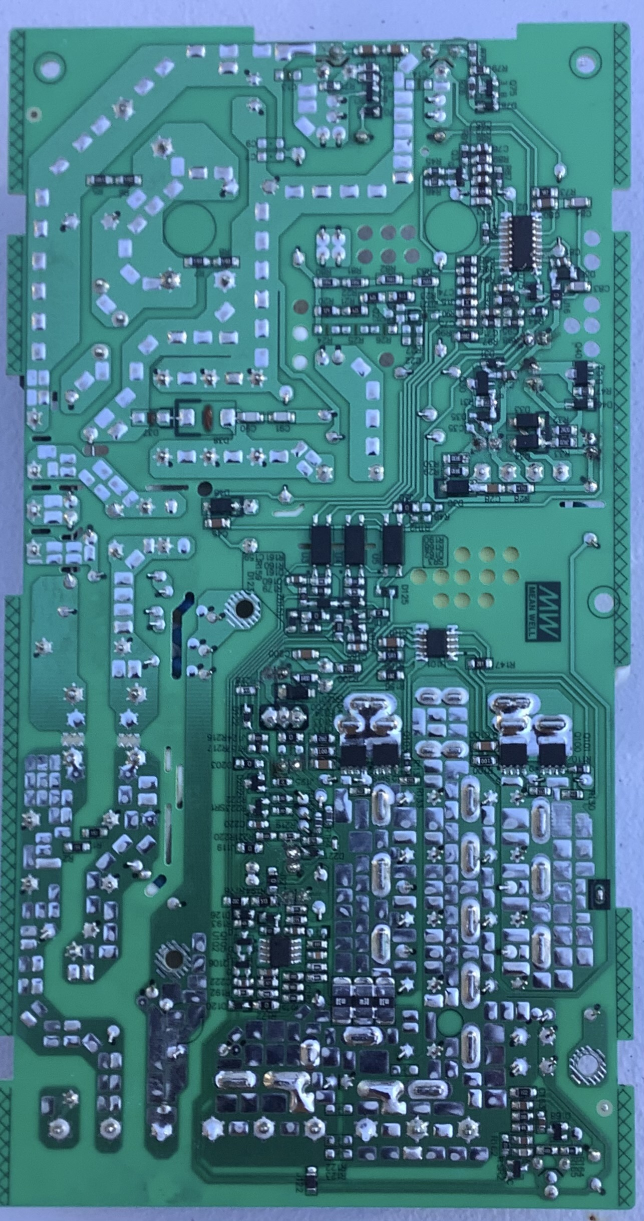

                        Here is a couple of pictures of the Mean-well 5 volt @ 100 amp switching power supply board front and back of it
                        Of course I had to recap part of it

                          I decided to load test the Mean-well 5 volt @ 100 amp switching power supply on the battery testing machine so I can look at how steady the voltage is over time
                          I can see a variable voltage of 0.01 volts and only because the line voltage dips a little bit every so often this is something that I will ignore because I know what this is and is meaningless in what I am really after I should have thought about doing this on the other switching power supplies before I put them into service
                          I just set the voltage for 4.75 volts @ 5 amp load and let it run over night
                          I have a dc load tester that has two channels but one channel is not stable in current or voltage and I can not rely on it for how accurate it is and I can not plot it over time anyway
                          I do not know if it because it was in storage for at least 4 or 5 years now and I remember after using it for a little while today why I really have not used it very much is it is a little difficult to dial in the exact current it is very touchy for the one that is stable now both of them are stable if you have a load 10 amps or more but under that one of them is not stable at all the current varies at least 250 milliamperes span from set point plus and negative of the set point so the total span is 500 milliamperes
                          I can use it for just testing the output of a switching power supply because it will do 30 amps per channel I did use it on the Mean- well 5 volt @ 100 amp switching power supply and turn the load on and off several times and did not see any issues with so far but I decided to run the test that I mentioned above in the beginning of this post
                          Maybe when I have nothing better to do I will investigate why this unit is having issues on channel 2 and see if I can repair it so it is more accurate than what it is now
                          One note the switching power supply transformer is big in size and it has metal rails instead of copper traces on the circuit board I have not seen this in switching power supply before and one thing I noticed when I had load the power supply to over 60 amps for a little while it only became slightly warm to the touch and the fan did not turn on in the video I watched about this switching power supply this seems to be normal operation I could not run it for very long at 60 amps because I did not have the right gauge wire hooked up even though the wire were very short in length and they started getting very warm to the touch and I did not want to melt the insulation on the wire when I was using 30 amp load was fine doing that but not 60 amp load was pushing it

                            Well I looked at the graph this morning and everything looks good so if I have time later I might start putting things back together and see if everything works correctly or not

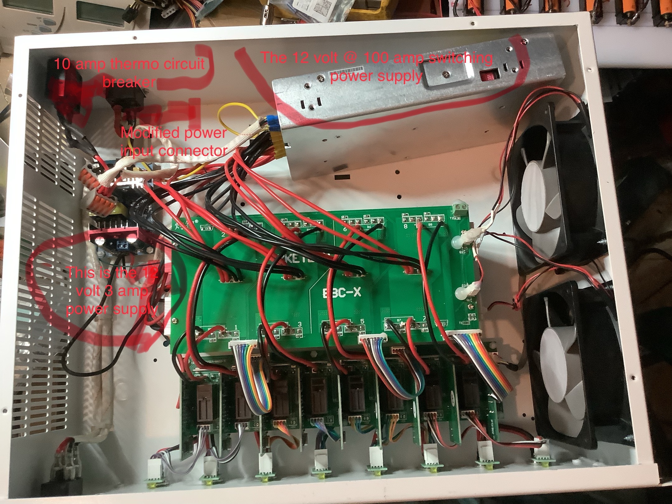

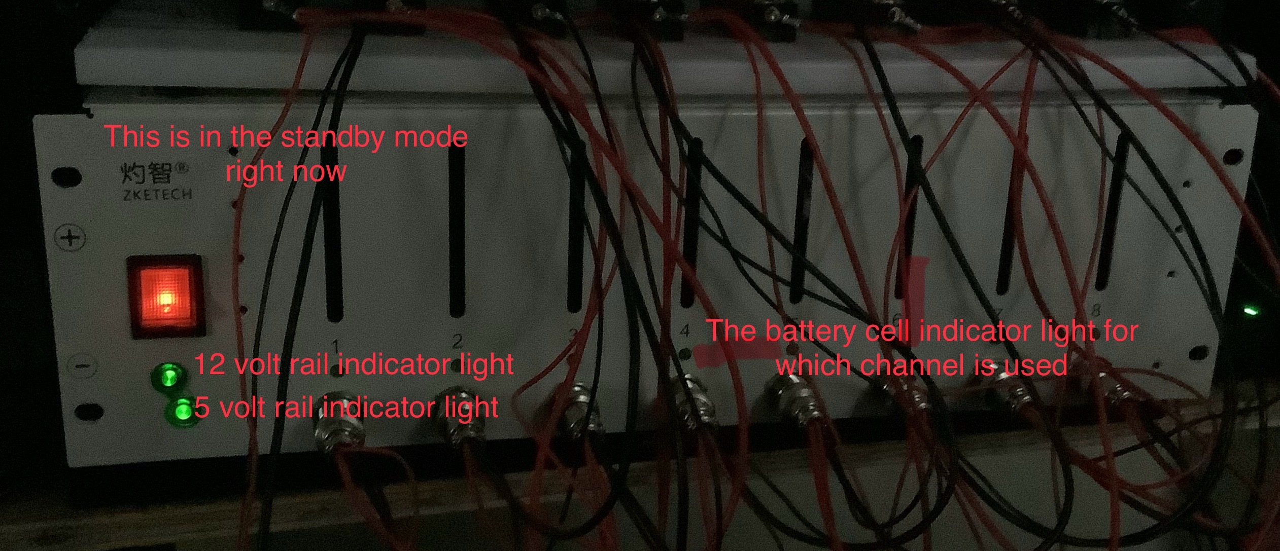

                                    Well I have both switching power supplies installed and I have the two power indicators lights installed and I have it charging 8 battery cells and the graph is looking great now the first time around ( instead of having to move battery cells around to get a good connection)
                                    This has been a lot of work and it has been a challenge doing this project
                                    I still have to wire dress the inside of enclosure but it is very quiet now with the temperature controlled cooling fans and it is moving air across the enclosure you can feel it pulling air and you can feel air flowing out the enclosure

                                        Here are some pictures of the modifications that were done on this battery testing machine and the battery cell jig and it hooked up and the test results from the charging test on eight battery cells
                                        The picture of the inside of the battery testing machine is with the 12 volt @ 3 amp switching power supply but it is not the Mean-well switching power that was installed I just did not take a picture of it now the way it is but before I put the cover on and install it back the computer rack cart I will take a picture of it the way it is now
                                        I have two battery cell jigs one for 18650 and 21700 battery cell holder both versions are set up the same way I just do not have a set of wires for this one yet I to order one that has the ZEKtech battery cell holder that is really meant for bigger size battery cells that I also have an will also start using as well but this setup is not cheap but the connector wires are very good quality and I do not mind paying for this
