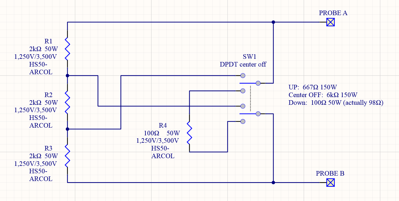

    I'm making a new capacitor discharge tool. Asking for suggestions for sizing the discharge resistor.
    Mr. Carlson's Lab High Voltage Capacitor Discharge Tool 1 is using 4 of 1kΩ 50W aluminum (mount to heatsink) resistors in series for 4kΩ 200W, so it's big, which is fine.
    His Patreon but I don't have a paid subscription for the project details but it looks straightforward. The plastic box with aluminum plate can't get rid of any amount of that heat though.

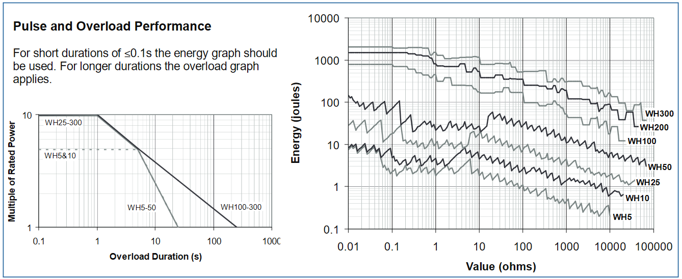

    Wirewound resistors can be overloaded by a factor of 5 for 5sec. and a factor of 10 for brief times. I've never tried say 20x.
    I did some math and simulations:
    -Microwave oven say 2uF cap at 2kV is a huge spike, 4kΩ resistor peak power 1,000W done after 40msec though.
    -But then SS audio amps 20,000uF cap at 85V is slowww even with 1kΩ resistor is almost 2 minutes I'll fall asleep.
    -SMPS say 680uF cap at 340V, 500Ω resistor peak power 231W done after 2 sec.
    So I am thinking of using a switch to select all in series or all in parallel for the say 3-4 power resistors. That would allow to choose say 4kΩ or 1kΩ.
    Or use lower resistance like 2kΩ for the HV caps but that is 2kW peak 1A and 10x overload for a 200W bank, for a microwave oven cap or RF transmitter. If that doesn't cause drama.
    Just looking at ideas for now.

            I'm tired of the hassle of looking for something to do it, a resistor, clips etc. and it usually goes unsafe in a rush. Mostly it's tube amps at 550VDC or SMPS at 340VDC, and the odd oven, although I had a 0.02uF at 20kV and it killed a multimeter. It's when you run into a charged cap unexpectedly that things go bad.
            To discharge a microwave oven cap, I wear safety glasses and gloves and use a screwdriver if I can get at the terminals (they're usually recessed and with insulated crimps) then I'll use a jumper wire with pokers. Realistically, microwave oven caps, start/run caps have a 10MEGΩ internal discharge resistor so waiting a minute can also work- assuming that the resistor has not failed. It's very high voltage to say 3kV/1.3uF but low energy around 6 Joules.
            I think I need three resistance ranges:
            2-4kΩ for microwaves or HV gear around 2-3kV.
            For tube amps, SMPS around 500VDC, around 500Ω-1kΩ.
            For solid-state amps around 30-85VDC, around 100Ω.
            In the end i.e. 3kΩ 150W, 1kΩ 150W and maybe 100Ω 50W.

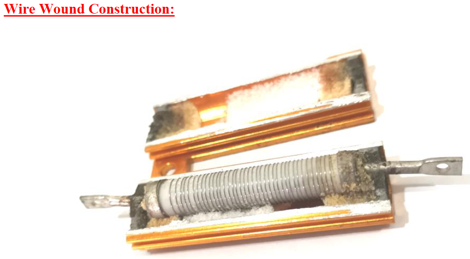

            I looked at a dozen different 25W and 50W wirewound resistors.
            For aluminum-housed, first limiting factor is the dielectric insulation from resistor to housing. You don't want an arc from leads to housing. Mr. Carlson insists on a plastic box for that reason.
            Dielectric rating (element to housing) is around 3,000VAC/DC for 50W and most 25W types with resin filling.
            Max. element voltage around 1,250V so 3 of 50W in series gives 3,750V max. but 25W types are only good for 550V max.
            Still number crunching, but I'm going to use switches for lower value resistors for lower voltages.

              Re: Making a capacitor discharge tool
              I'm settling on these resistor values and a DPDT center-off switch.
              Three of 2kΩ 50W and one of 100Ω 50W.
              Gives 6kΩ 150W or 667Ω 150W or 100Ω 50W impulse power and discharge currents are under an amp.
              Next is the LED or buzzer circuit indicator.

                            I'm working backwards from power resistor specs. Under 1A peak discharge current I thought is reasonable. 2,500V for HV worst case.
                            Aluminum-housed 50W in the most auspicious RX24 series made by villagers in Elbonia are looking good for price- until I found the pic of the sand and airgap lol. Know of any better quality Ali vendors? Their price isn't much lower than NA disti's.
                            RX24 50W some have a dielectric voltage rating of 2,000VRMS for 1 minute, this is with either lead to case.
                            Arcol Ohmite HS50 is 2,500VRMS 1 minute 3,500VACpk, element 1,250V max.
                            Stackpole KAL50, TT WH50 are rated 3,000V.
                            Mr. Carlson was concerned about an arc from a resistor to the housing/metal box, so he mounted them to a metal plate and then on standoffs in a plastic box. I'm just using a die-cast box touching nothing lol.
