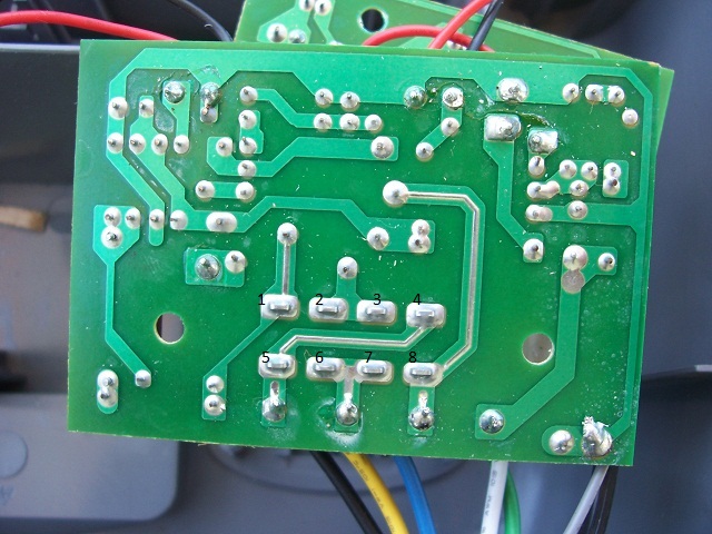

    That cap is for the DC power supply for running the electronics on the board.
    So from the picture: This must be reverse-able motor.
    The Yellow and the Green wires are for the motor's brushes?
    The Blue and White wires are for the Stator motor winding?
    The slide switch on the board, is that for forward/reverse motor function if you have paper jammed?
    That is correct it is reversible? The slide switch is Auto - off - reverse. When set to auto the sensor starts the unit

      lol, I am reminded how much of a headache I get trying to trace circuits from random pics. Can you trace the circuit back a bit and with power off, measure resistance with the slide switch flipped one way, then the other? Looking at the switch contacts as two columns in the picture of the back of the PCB, the first two rows of contacts in each column should read very near zero resistance between each other when the switch is flipped that direction, and vice versa for when the switch is flipped the other direction.

          Forgive me put on the attached picture which contacts should be near zero resistance?
            Re: Init Paper Shredder sensor circuit
            Does the motor run the same speed in both direction? If it does, then that will eliminate the contact resistance problem.
            When the slide switch is in the left position (base on the picture with numbers)
            1 and 2 should be 0 ohm.
            5 and 6 should be 0 Ohm
            when move it all the way to the right position
            3 and 4 should be 0 Ohm
            7 and 8 should be 0 Ohm

              The motor do run the same speed in both directions. The resistance is 0 ohms on these contacts with the switch in the designated position. Just to confirm; To supply 120 vac to the 120 volt motor, the yellow and the green is L1 and L2 with the Blue and White being the two field poles. How would I connect it to bypass the board?

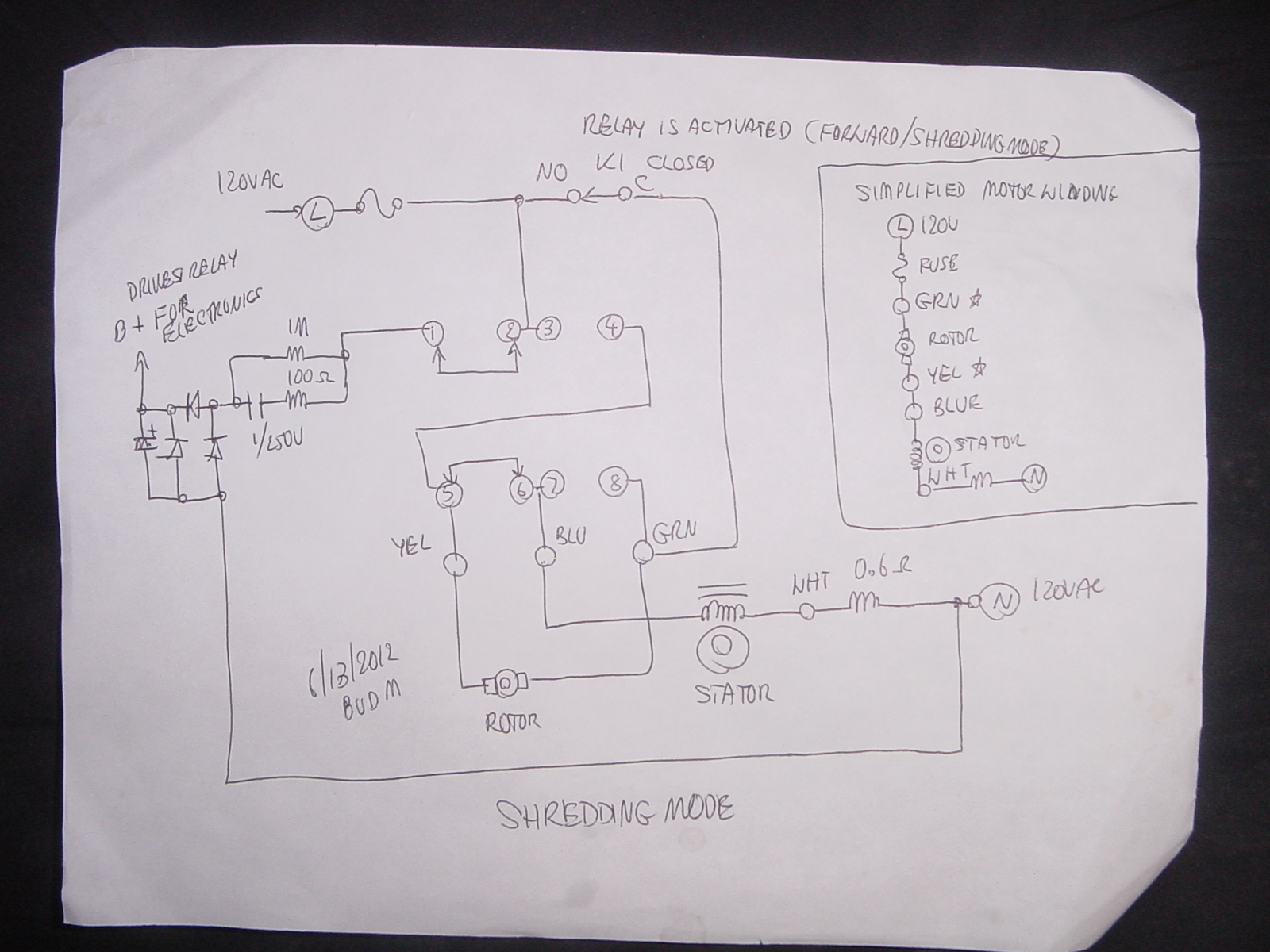

                      Can you remove the motor from the assembly so you can run it without the load, and since it uses the gear reduction to run the shredder assembly, can you crank the assembly by hand using the same gear that the motor is attached to just to find out how hard it is to move the blades.
                      I believe the stator and the rotor windings are connected in series, and they reverse the direction by switching either the stator or rotor winding connection.
                      I still do have the time to draw up the wiring diagram yet.

                                By the way, that big white power resistor 0.6 Ohm is in series with the motor, can you check and see if it read less than 1 Ohm?
                                  #36

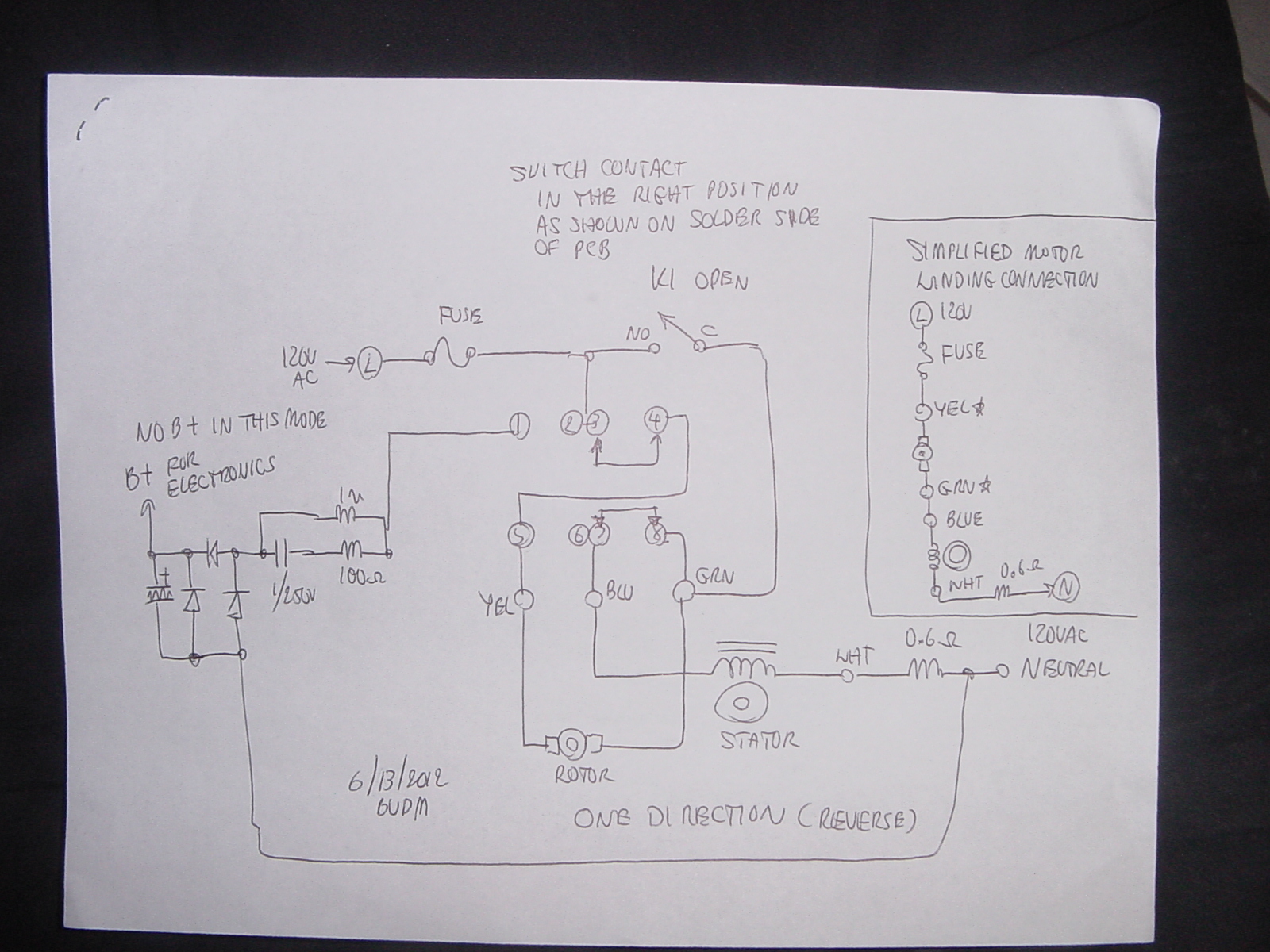

                                  OK, I figured out how it works, see simplified diagram attached.
                                  The Rotor winding is connected in series with Stator winding, depend on how you connect them together, you can make it run forward or backward by reversing the Rotor winding connection, very simple, as long as the two windings are in series, the motor will run.
                                      Thanks for the drawing budm great job. Problem solved. The problem was with the motor as someone indicated (cheap motor). I removed the motor completely and dissembled it to find that the wire connection to one of the brushes was broken. and one of the bearings was worn badly. I can replace the brush but the bearings are actually bushings and finding a replacements could prove impossible? Cheaper to buy new.
