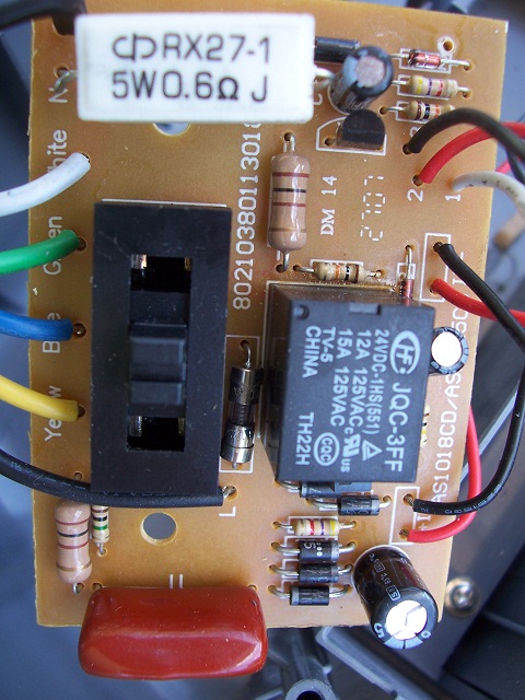

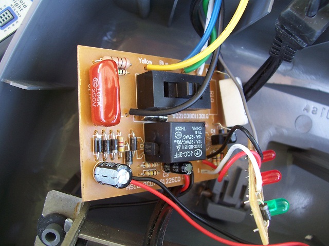

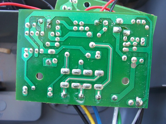

          Here are the pictures I promised hope they are ok. I know that the sensor is not gone and the unit do not run continually any more. I cleaned the sensor and that took care of that problem, however it is still not working properly. It seems to be running very slow? I checked the main board and found that the 105k 250volt capacitor was loose on the board,I re-soldered it hoping that was the problem but not to be. Is it possible that this capacitor could be the problem? Can it be tested on the board?

            I know nothing about shredders electronics but my guess would be the cap is ok. It looks melted in one pic but thats just the pic - right?
            Other members may have more knowledge. If it were mine I would
            turn my attention to the gears, the motor and the cutters - they do tend to get clogged up with paper and paper dust. Cutters I think it recommends cleaning and spraying on a very regular basis even daily depending on usage.
            The gear cogs are often greased and that with the paper dust makes a very effective brake.

                That orange cap and the 100 Ohms resistor are part of the current source power supply circuits feeding the bridge rectifier Diodes so it does not need power transformer for the electronics. The relay is for the AC motor that drives the shredder, yes try cleaning and lubrication, probably the paper dust particles clog up the bearing, just like it clogged up the sensor.
                  I think what I called a cap is actually a 105k 250 volt resistor? (The big orange one) I checked the voltage across the brushes and I am reading about 57volts? I removed the gears running the shredded to eliminate a possible clog, and the motor is still running slow almost like bad brushes, but checking the brushes they seem OK. Since I don't have a drawing I do not know what the voltages should be.

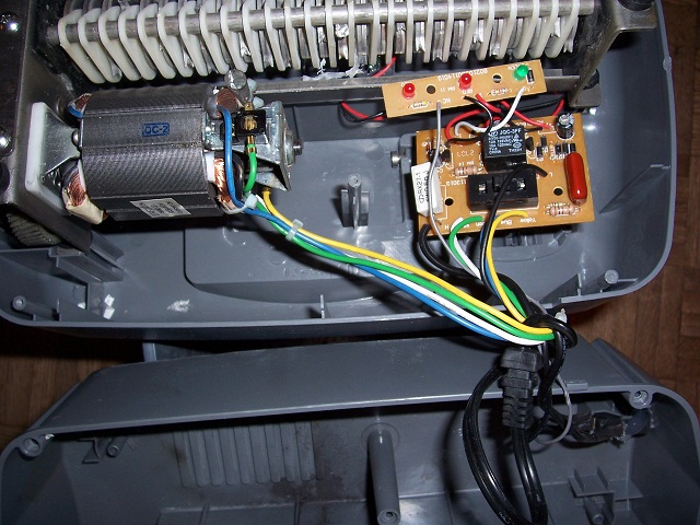

                                      Difficult to get a good picture but try this one. I was wondering where that large orange cap was loose on the board if it may have blown something else?
                                        Re: Init Paper Shredder sensor circuit
                                        That cap is for the DC power supply for running the electronics on the board.
                                        So from the picture: This must be reverse-able motor.
                                        The Yellow and the Green wires are for the motor's brushes?
                                        The Blue and White wires are for the Stator motor winding?
                                        The slide switch on the board, is that for forward/reverse motor function if you have paper jammed?
