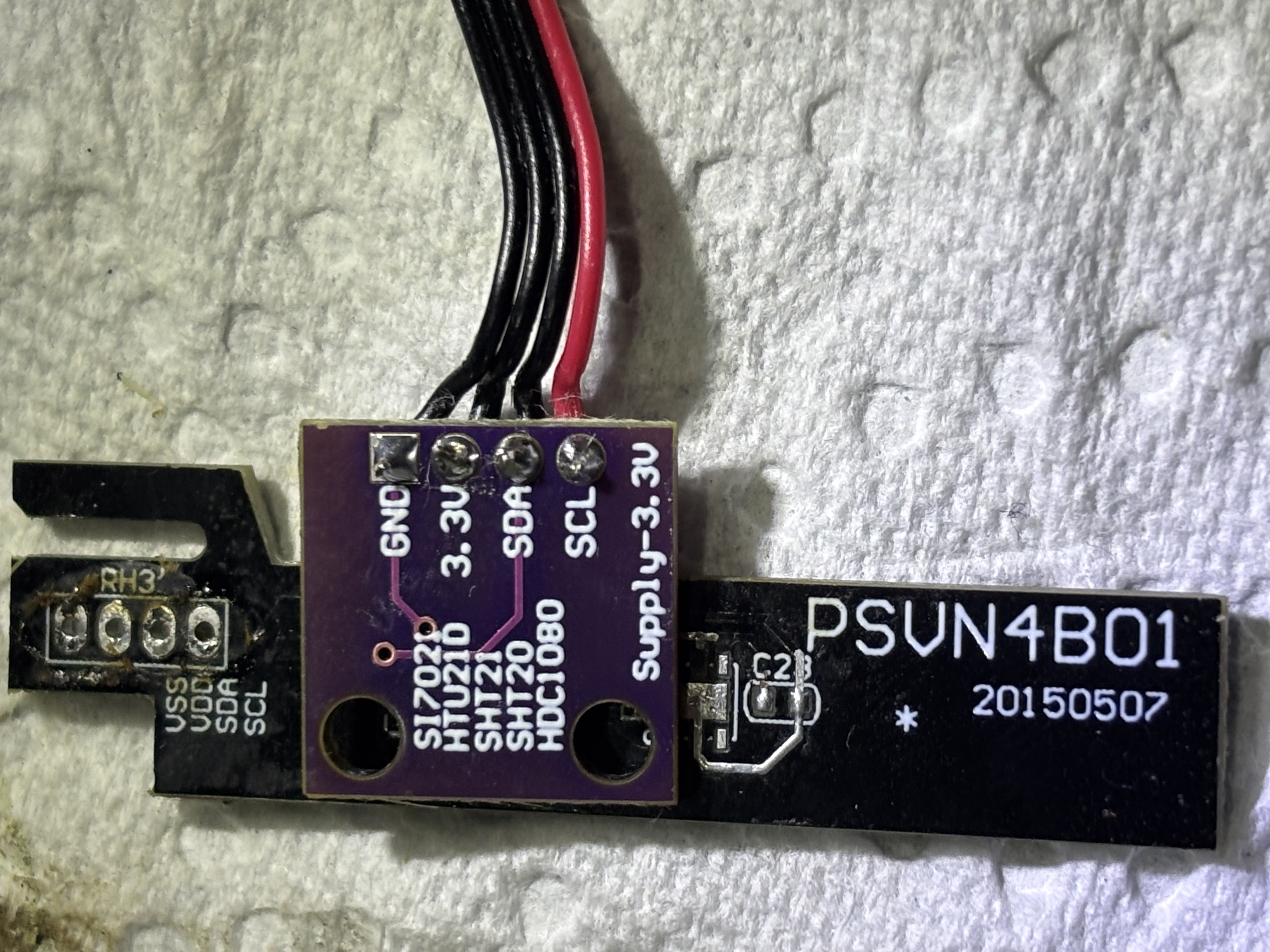

    Got a new victim:

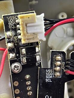

    AcuRite 5 in 1 Iris outdoor weather station not updating the temperature / humidity anymore. The original sensor is a SHT21. Also there are identical other sensor manufacturers. I chose the HTU21D to replace the original SHT21. Both have identical specs. I've had two failure modes with these sensors.
    A: outside temp stuck at -40? It's cold here at times in Canada, but not that cold!
    B: stuck at some temperature and maybe updating once in 12 hrs or so.
    Easy solution is to go to AcuRite website and purchase the sensor. Right? AcuRite SKU: 11197-VN1HSPCB. Well… they want USD$14.99 for the sensor plus USD$ 38.74 for shipping into Canada? Totalling USD$ 53.73??? Really?!?! By the time it gets here it costs me around CAD$78.00 All that for a little temperature replacement sensor? !@#$ not happening! You'd think they can put that thing in an envelope and mail it? Nope! So here is my antidote :

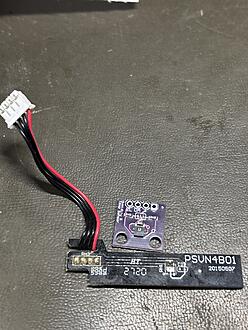

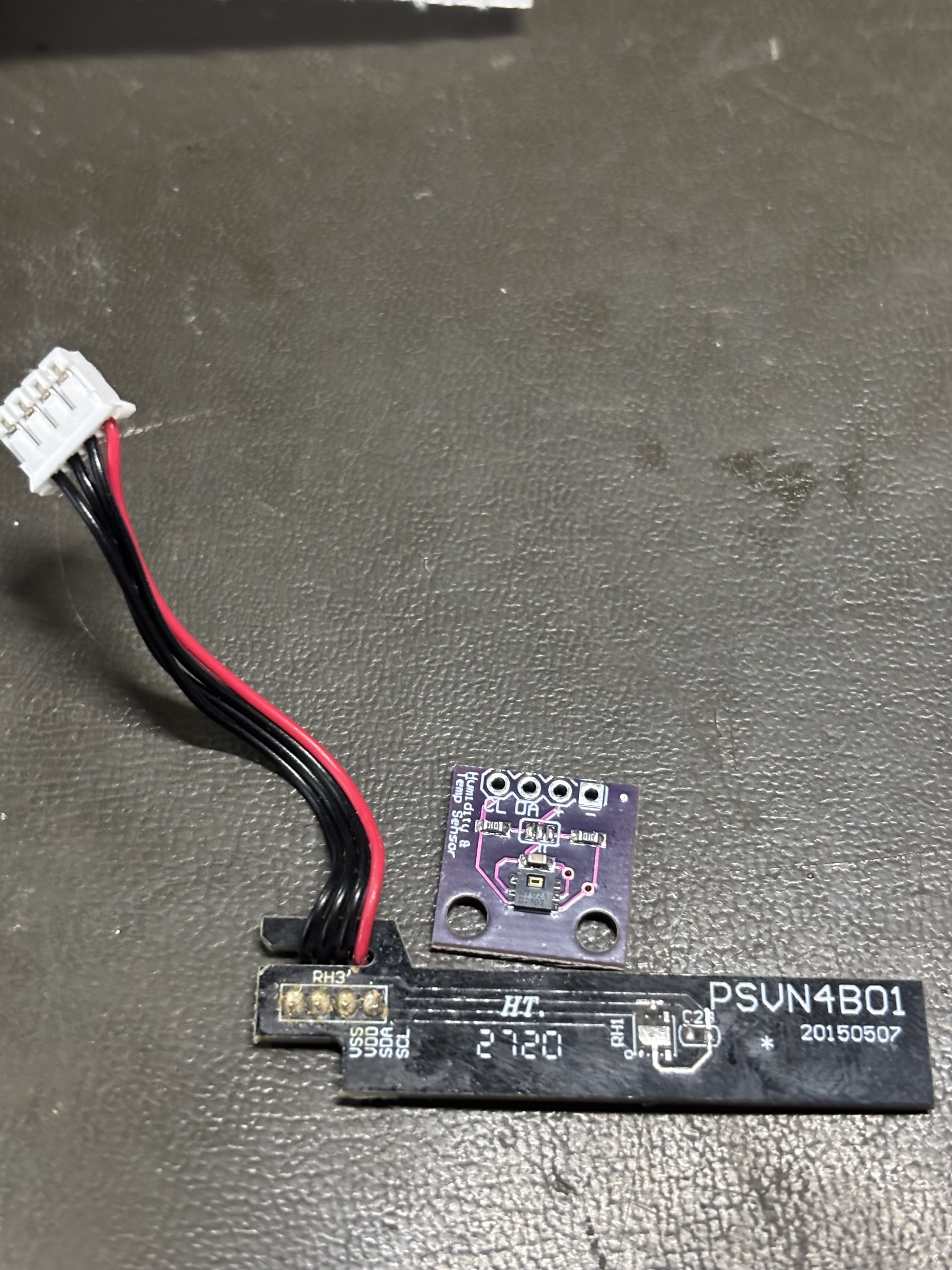

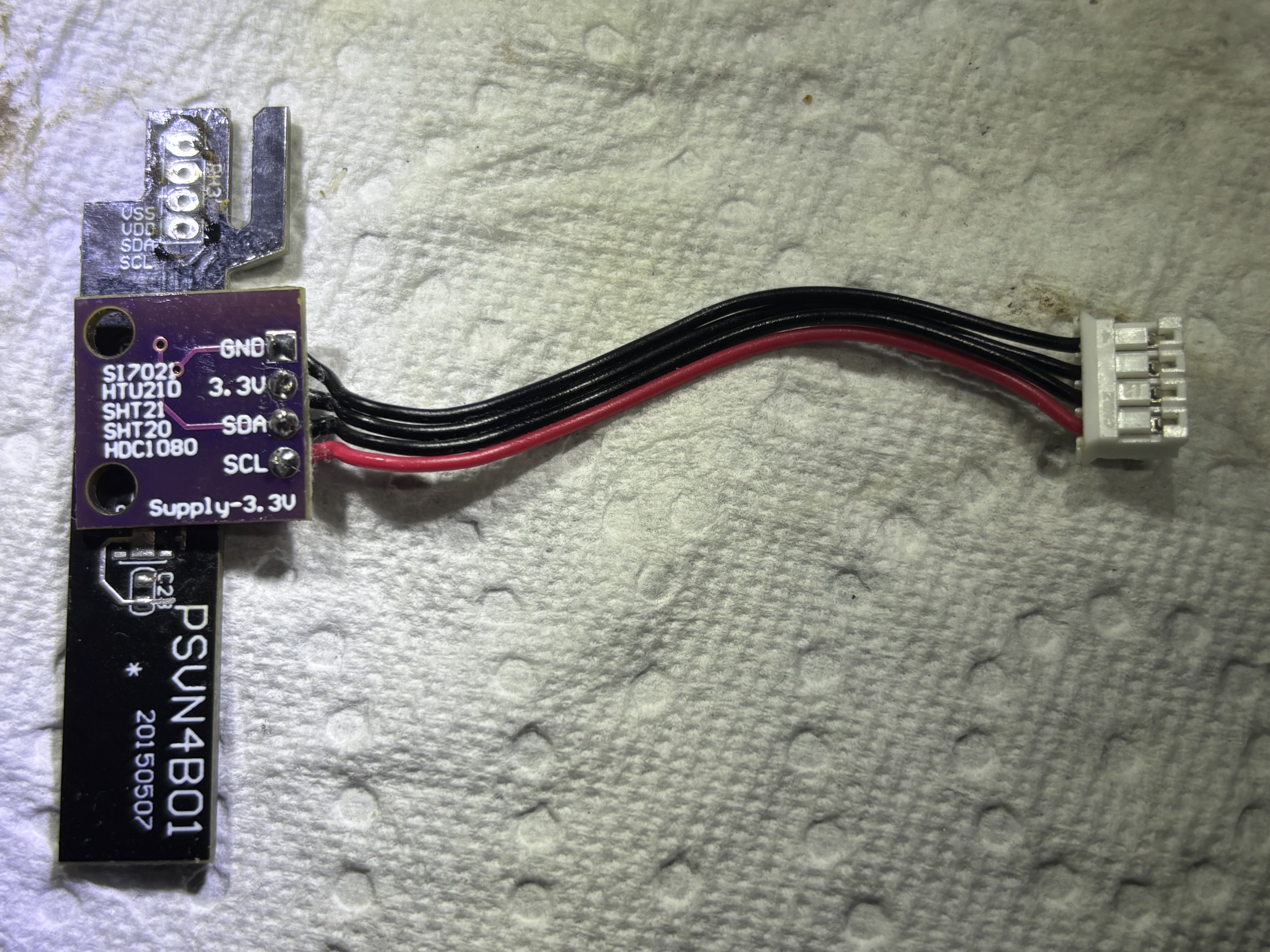

    Went to AliExpress and bought an HTU21D sensor with the board for a buck fiddy each CAD$1.50! Comes with everything you need! Best thing is no modifications on the board are needed, besides swapping the cable out!

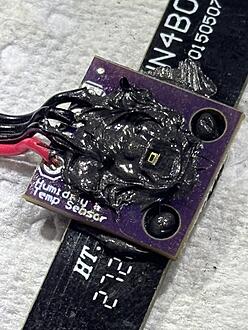

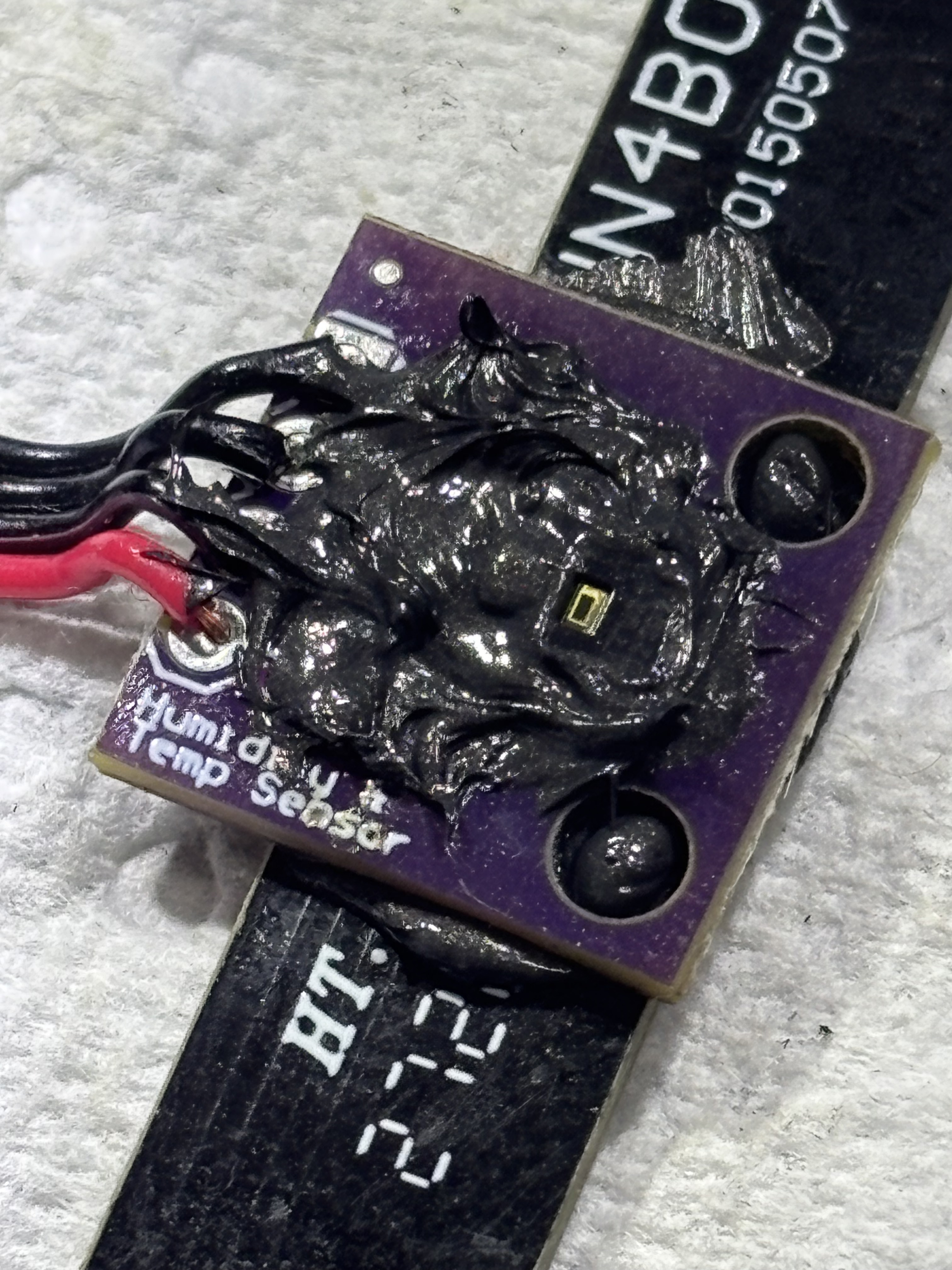

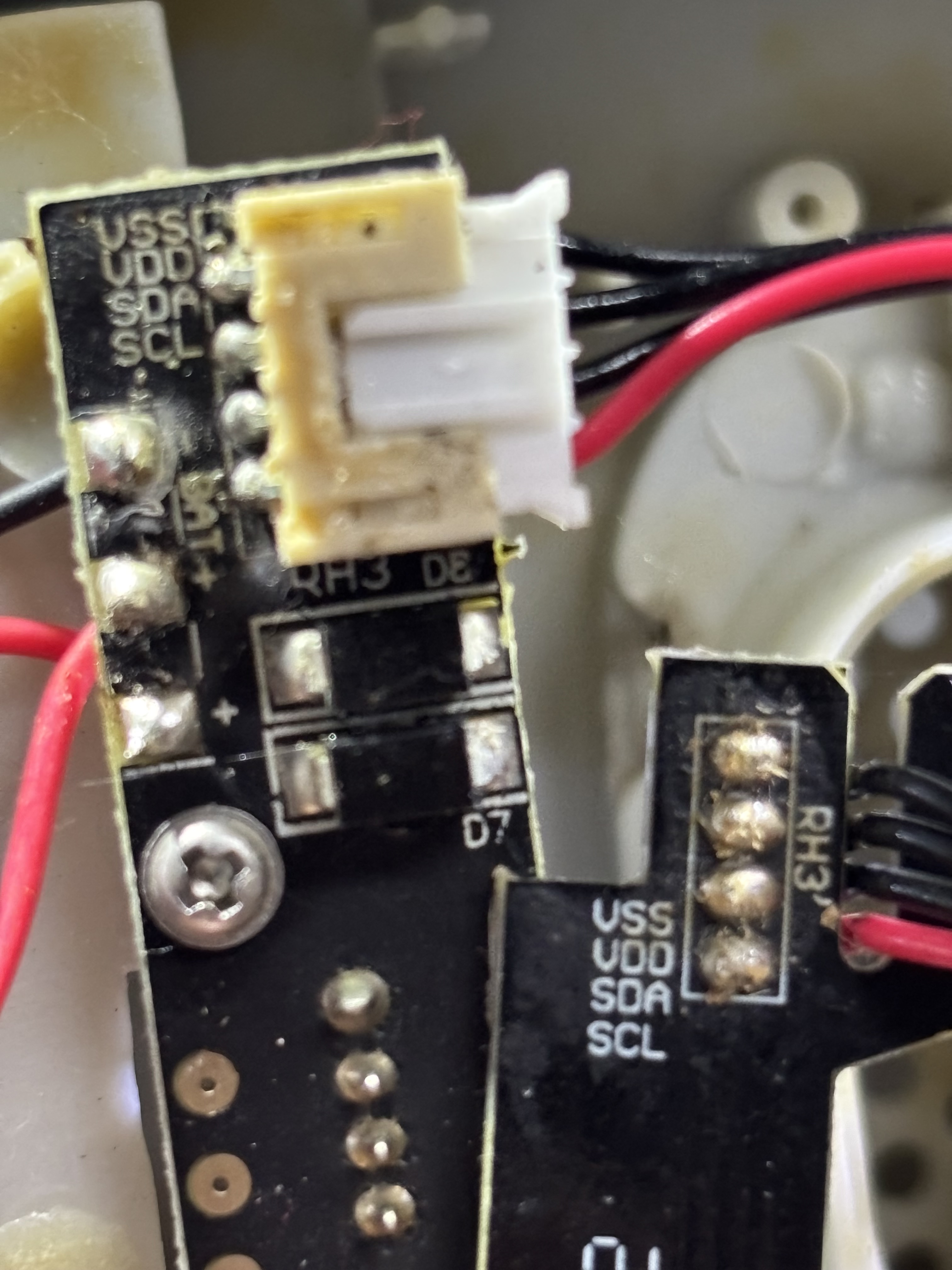

    Depopulted the old original board and glued the new board to the old board with black RTV sealant (watch were the old sensor was). Then swapped the wires with the JST connector from the old board to the new board, put more RTV sealant AROUND the new sensor and called it good enough for Canada! The pictures explain the cabling pin outs.
    Assembled everything, put the batteries in and? nothing updates on the main station?
    Got a fix for that too. Take the battery cover off and slide the channel selector switch to a different channel and then back. Voila and you get the updated values of the outdoor unit! No reset required!
    Here a few pix for you guys to follow my steps and enjoy cheap temperature / humidity sensor replacement boards!!! Cheers!

    by "chennel" i presume it has different I²C addresses?
    • CapLeaker
      Leaking Member
      • Dec 2014
      • 8342
      No. There are 3 RF channels you can select through a switch between the indoor and outdoor unit. All I did was taking the weather display unit, took the battery cover off and changed the channel selector to something else, then back again. The display outdoor side then updated and I didn't lose any history data.
      As for the i2c temperature / humidity sensor: the replacement board has two pull up resistors on the clock and data line. I didn’t “enable” these by putting a solder blob in the middle, as the 5 in1 outdoor unit has them already installed on its main board.
