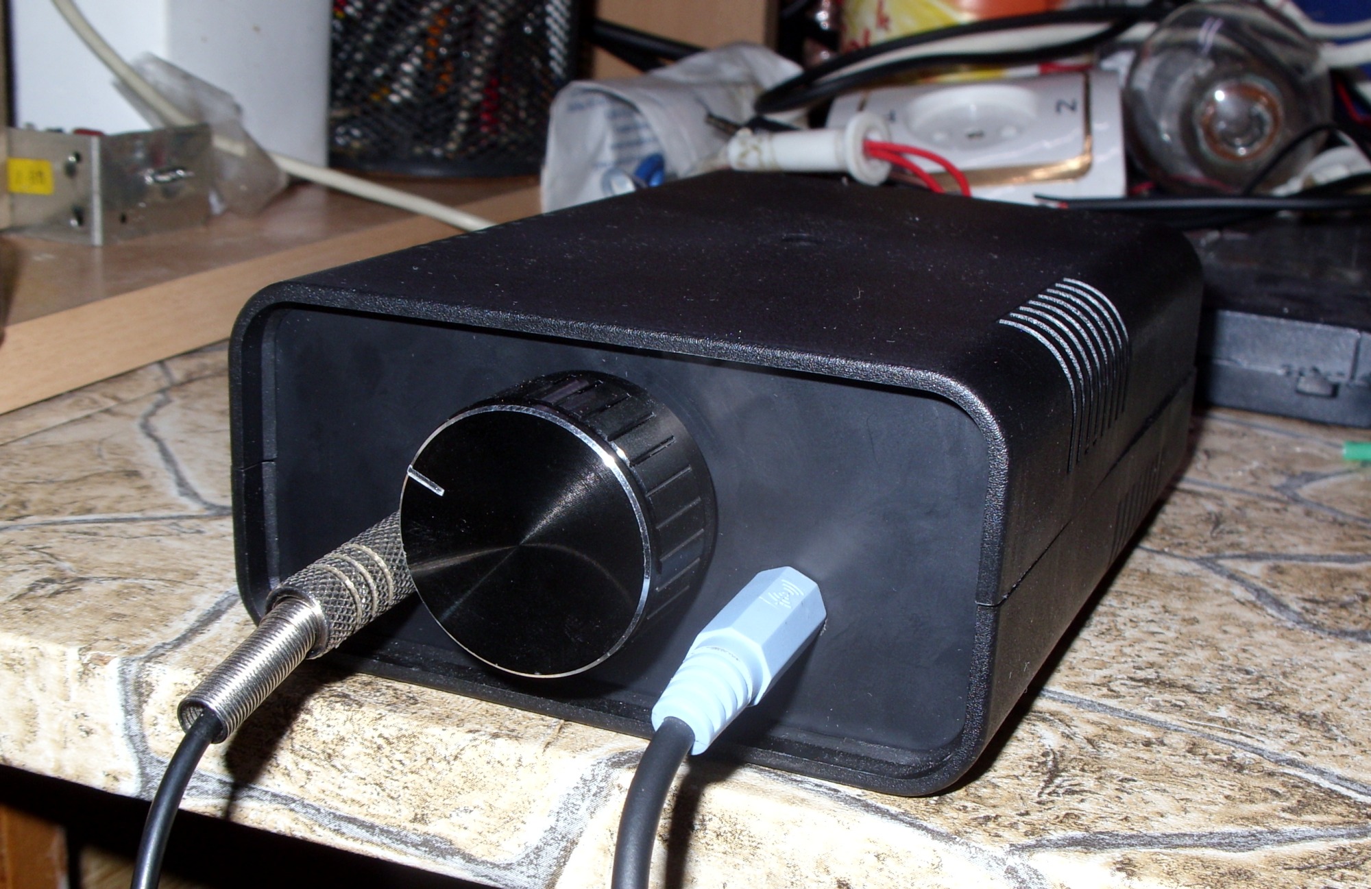

          Finally bothered to track down the hum - it was due to a little PCB routing mistake which created a small ground loop on the negative regulator GND pin. A couple jumpers fixed it. Now the amp is nothing short of a straight wire when it's not playing - there is ZERO background noise. With my walkman earbuds there is a tiny bit of hiss from the IC itself, but with headphones it's dead quiet. It sounds incredible.
          Screw all that audiophile BS - this IC-based headphone amp will serve me well for years to come.
          Anyone want the updated layout, let me know.

              Yes of course - the classic method of using 2 9v batteries in series, with the center point as ground, instead of the 7812 and 7912 regs. But they'll wear out pretty quickly. Besides, the way i did this board, it's pretty big to be pocketable, don'tcha think?
              Updated PCB layout attached, in the same ExpressPCB format. The jumper shown near the negative rail capacitors should ideally be placed on the underside, straight from one cap lead to another, use insulated wire.
              I also did a little cosmetic upgrade: it now sports a big and shiny volume knob. I'll show that off tomorrow.

                            Anyway, back to my headphone amp. Threw it on TrueRTA for a test and it seems it lives up to my claims of "being nothing short of a straight wire". It measures ruler flat from 10Hz to 50kHz! Actually, i can't see lower than 10Hz on the graph, it could be flat even lower than that. If you recall from the first pages, the parts are chosen so that the -3dB frequency is 1.6Hz - this thing will happily pump loads of subbass into your 'phones. Admittedly this test was done with 600 ohm load while headphones are usually 32 ohms, but as soon as i find my jack splitter i'll test again with the headphones themselves as load. I see little reason for the frequency response to change with load though, as this is a split supply amp so there's no output coupling capacitors that could limit bass response.
                            Distortion is also lower than distortion of the laptop soundcard input itself, which does 0.017% at best. I'll try using the DV5 for measurements as i recall its audio input was better. This was at low levels (about 1/3 volume) as to not overload the laptop's input, but with the amount of headroom this thing has, unless you have some really badass DJ headphones, the drivers in the 'phones will distort long before the amp does.
                            Please note that extended listening at high levels will damage your hearing. Do yourself a favor and turn down the treble when listening loud.

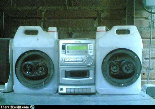

                                          I also built a "headphone amp" years ago with some LM386s. These were some that were much quieter than others typically are. Four NiMH AA cells powered it. A few years ago, I deconstructed it, for the same thing you mentioned above. It was nice having the tone controls for the 'phones, but I didn't want something so accident prone.
                                          Ahh well. 'phones are still fine, as for my ears... I'll let you know the following days.
                                          Old sound guys never die- they just become amplitude and bandwidth limited.
