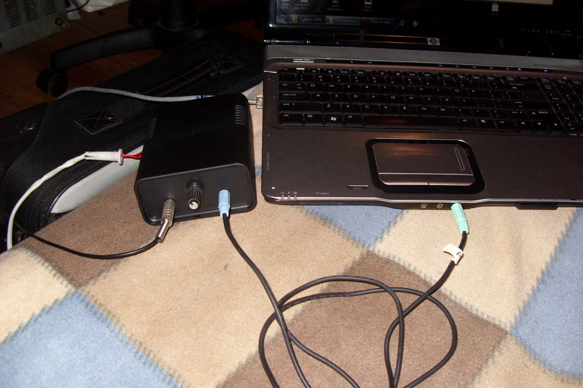

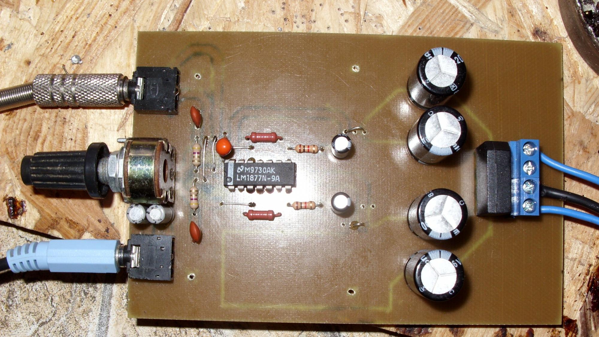

    I pulled out a LM1877N amplifier IC from an ISA-based ESS soundcard that i got in a box of freebies. After taking a look at the datasheet and noting the high maximum voltage (24 volts), and the fact that it can also be used with a split supply, i immediately thought "this will make a really nice headphone amp". The datasheet shows 16 vpp output with a 24v power supply - that's 1W @ 32 ohms, just about perfect.
    I really needed an amp because my laptop runs out of signal headroom when applying proper EQ for my headphones, so there i went. I was too lazy to cut a PCB up again, so i thought i'd do a full sized 120x80mm board. So the board didn't end up empty, i designed it with quite a bit of space for the large components like bridge rectifier and caps, so i could use larger ones if i felt like it. Since that wasn't enough by itself, i dropped a 7812 and a 7912 on there as well. This proved a good idea as i want to use a 12-0-12 AC transformer to power the thing, which rectified would be too high for the IC if left unregulated.
    I did a few changes to the schematic in the datasheet, which i'll let you know of in a bit. What i did is make the -3dB point of the highpass filters in the input and feedback sections very low, so the amp does not modify sound in any way, and lower the gain to 10 (which btw is the minimum gain guaranteed stable by the datasheet).

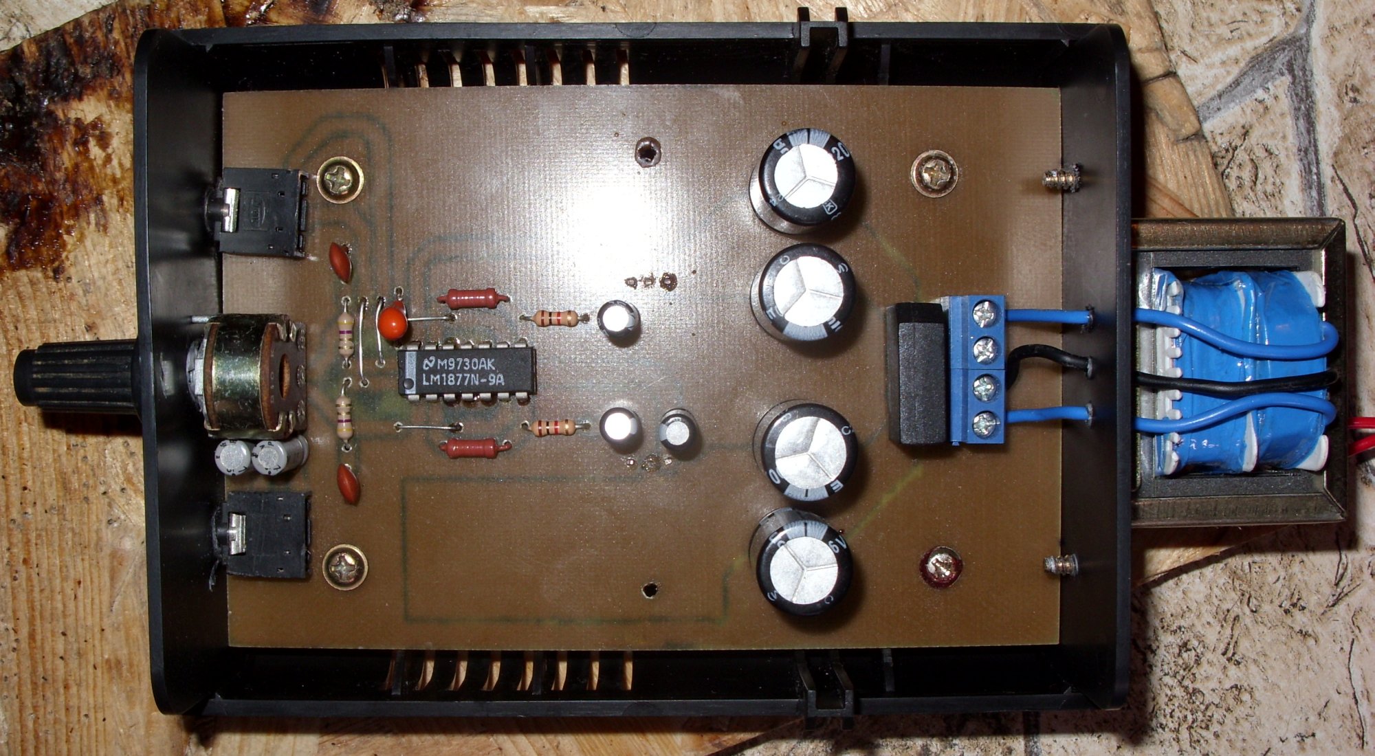

    I found a project box i'd bought a while back, complete with screw standoffs. It fit the 120x80mm board like a glove! So i adjusted the PCB layout to suit the standoffs, printed it, transferred it, and started building it.
    For testing i did not fit the regulators (i don't actually have them on hand right now) and used a 9v-0-9v transformer instead. When unloaded, this provided a little over +/-13v, so i thought the IC might blow up. Initial testing was thus with no headphones connected and no signal. Nothing weird appeared on the scope and the IC didn't smoke, so i plugged my headphones in. Just a little background hiss. Now, i still had no idea whether the thing actually worked, since it took quite a bit of work with the heat gun to get it out of the soundcard. I plugged in my SE w595 and fired up the walkman player. Hey... i got sound!
    FYI: It's always a good idea to use a battery powered signal source when you're first testing some audio gear, laptops in particular can give weird glitches.
    Initial impression? I'll have to be careful not to blow my headphones.. It's loud. I quickly started to notice distortion - but checking with my oscilloscope proved that the cellphone wasn't even able to drive it at full level and there was no clipping - the distortion was coming from the headphones because the bass was cranked up too high. The IC runs moderately hot, i'd say around 60C. This is perfectly safe.
    I'll come up with some measurements tomorrow, but so far i'm very happy with it. Once i get it fitted in the box i'm sure it'll serve me well for years to come. Here's some preliminary pics.

    You used Jamicon capacitors?
    Looks good otherwise

      Those caps will work fine.

        I actually pulled 'em from another transistor-based headphone amp i built a while back, which i later scavenged for parts... This isn't a SMPS you know. Jamicon general purpose capacitors are decent for, well, general purpose applications. The caps in the audio signal (input coupling and feedback) are Rubycons.
        Anyway, it looks like i will need those regs after all. Sustained low bass, even at reasonable levels, will cause audible mains hum. Sounds like that small transformer i used isn't up to the task.

            Looks nice, how did you make the board?
            -David VanHorn
              Toner transfer. And some help from the OHP marker because i didn't iron it very well (i'd grown used to doing very small boards), so the toner didn't stick in a few places. I'll show the solder side too once i'm done with it. PCB layout with parts values is attached, it's done in ExpressPCB like pretty much everything else i make. It's not the best PCB software but it's really trivial to use and i can do stuff quickly. Btw, the regulators are intended to be mounted on the solder side. And check out the cutoff frequency of the highpass filters in the input and feedback...

                My personal preference is KiCad, I also use toner-transfer (with a laminator).
                I thought from the colour of the etched-away parts you'd done it on a CNC mill but I guess that's just the brand\type of board you used.

                  Heh, i wish i had a CNC... The board i used for this is some sort of glass-based material, compared to the cardboard-based ones it's a royal pain to cut.
                  Anyway, in with the regs. Can you guess what happens now? Well... they drop out of regulation because the 12-0-12 transformer is too small (200mA). I also broke my last good drill bit (lasted a good few months tho), and i need some resistors for the LM339 PSU protection board i am building, so it's time to put my shoes on and head for the store.

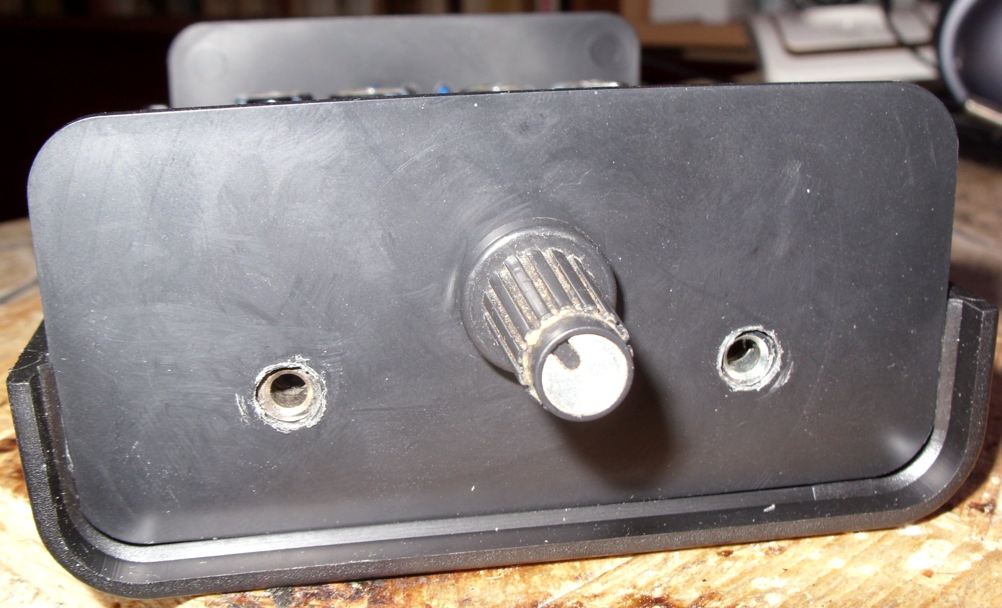

                          It'll be very nice and clean when i'll have it in the box... i need to buy some more drill bits of various sizes to accomplish that. I'll post more pics then. Btw, i bought a 12-0-12 400mA transformer which works mighty fine with it.

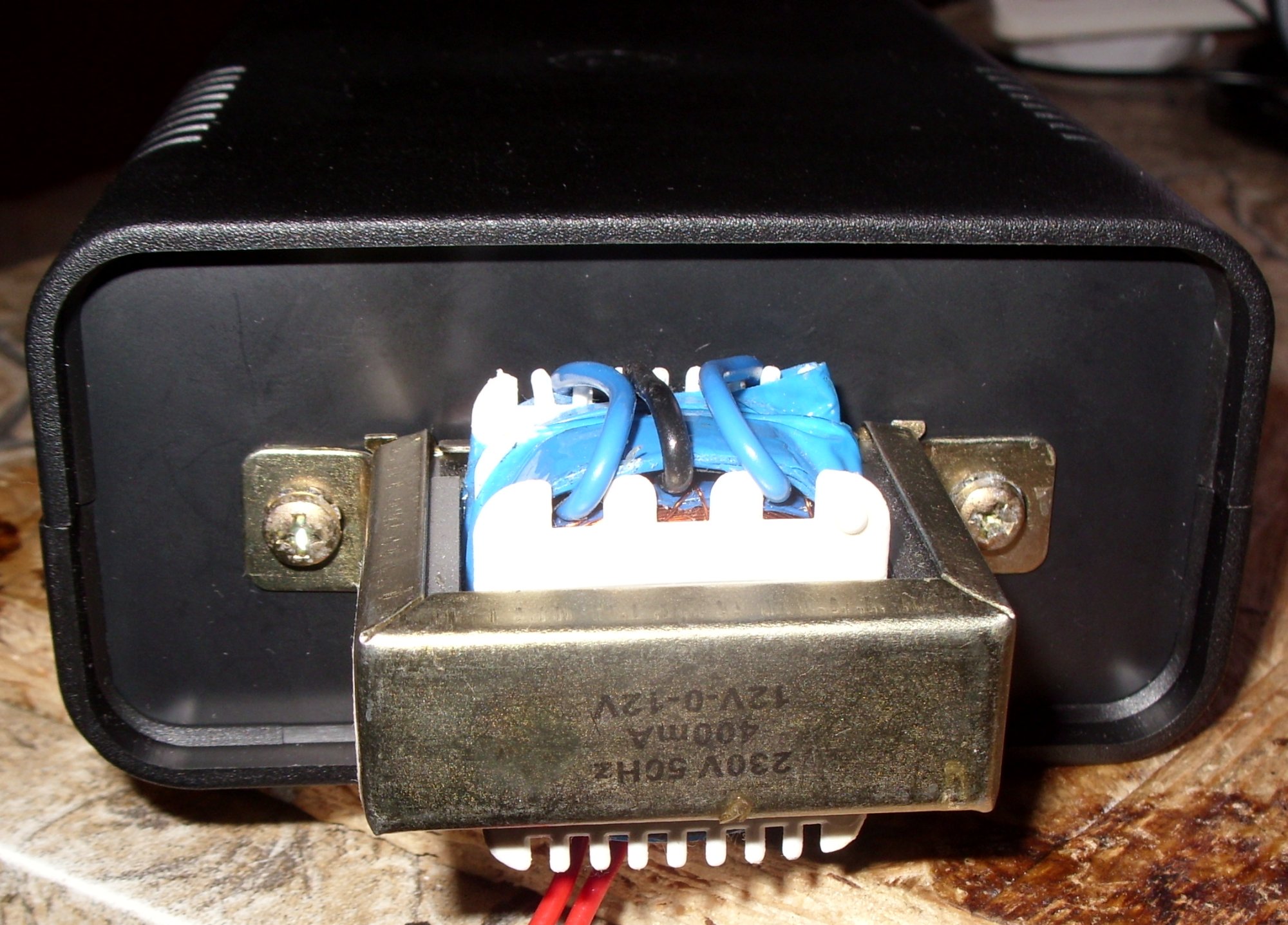

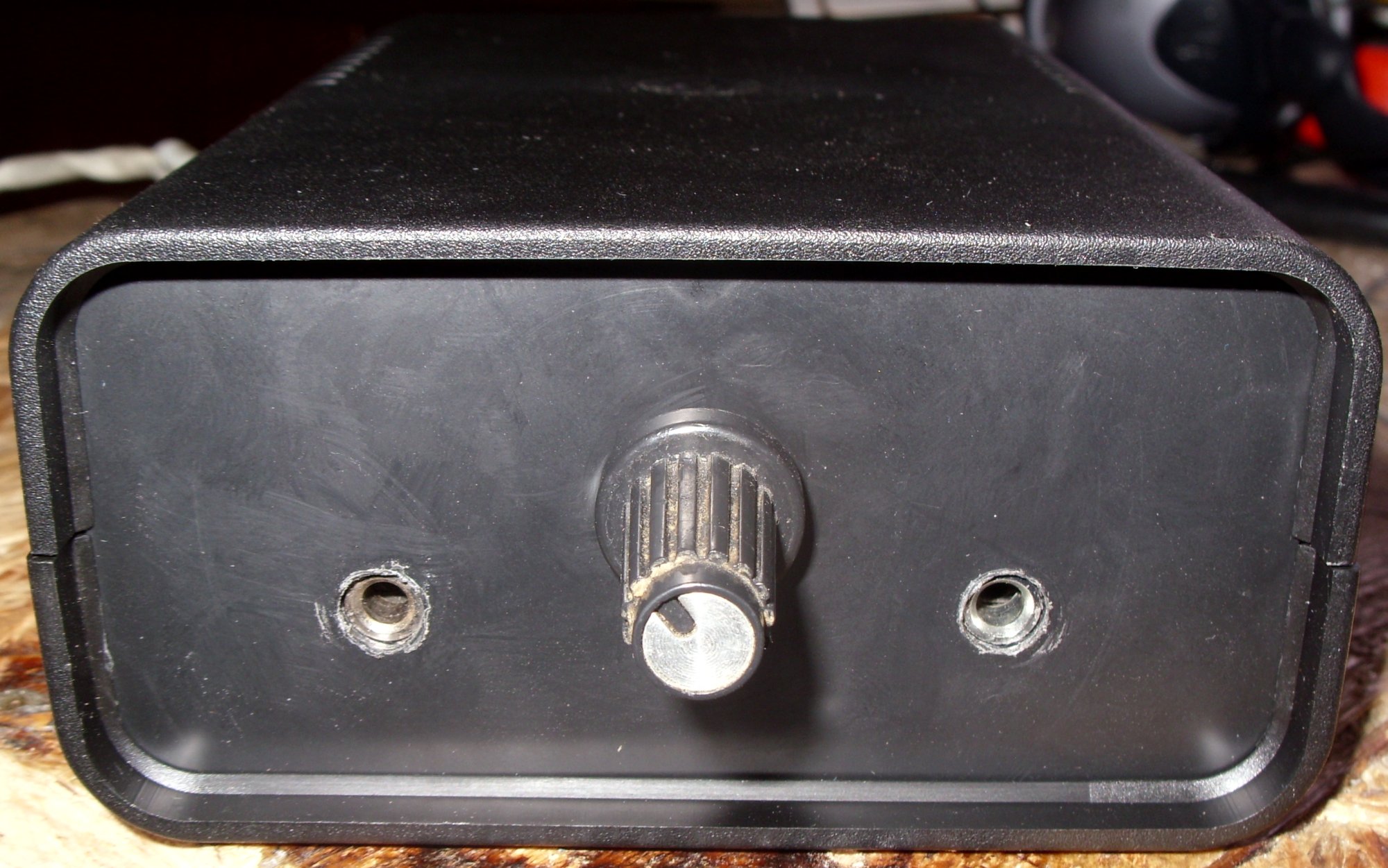

                                    In case you were wondering, here's the end result. Just stumbled upon it again today and thought what the heck, let's finish the job. And this is how it turned out. Considering everything was done only by eye, i think it looks alright.

                                      Looks good. I like the transformer out the back, kinda makes it look like a valve design. I hope you've got some kind of strain relief on the mains lead though.
                                      -David VanHorn

                                        Re: What i build when i'm not doing power supplies...
                                        First i need a proper mains lead... The current one is recovered from an old hair drier, it's white and ugly.
                                        There's also a bit of hum in the background, a tad more than i recall from last time i used it. I'll check that out sometime... it's not annoying unless whatever i'm listening to is REALLY quiet.
