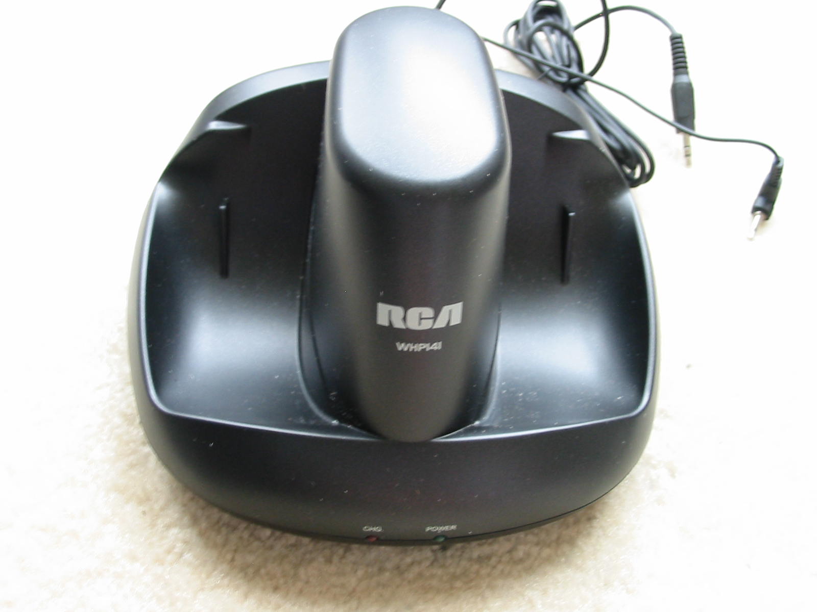

And here is the transmitter station that came with the headphones:
Again, these headphones came with the original box, all for $2 and nothing missing. The only thing I found to be missing… or lacking I should say, was the sound quality. Like any FM headphones, these were a bit noisy depending on interference, and also noisy due to the design / internal amplifier IC used for the drivers. My biggest gripe was with the bass output, though – I like heavy bass

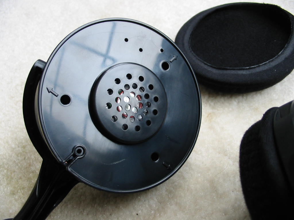

So here it goes… to take them apart, first take the ear cups off and then remove 3 screws on the ear cup plate.

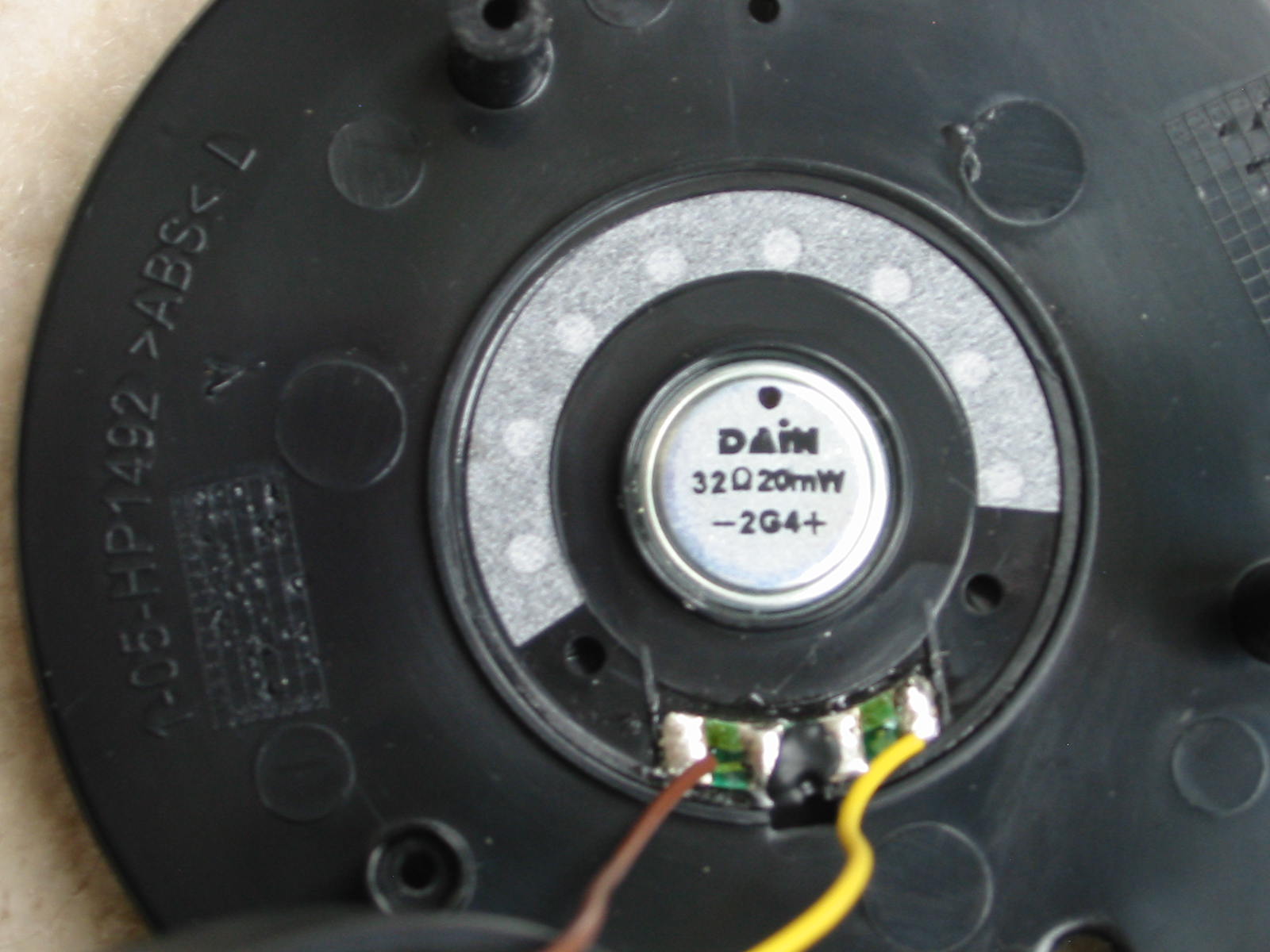

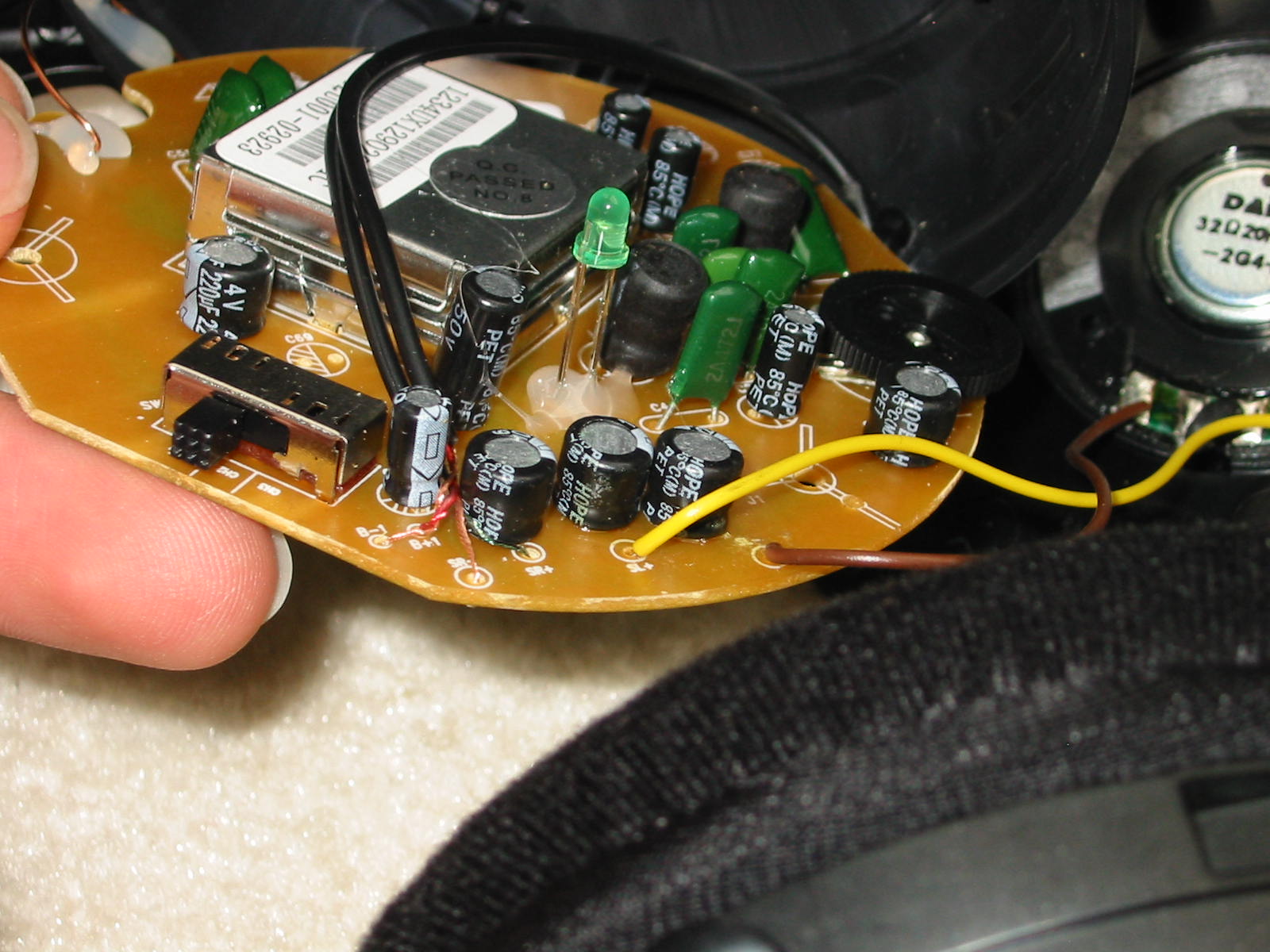

OK, done. Below is a look at the drivers. Indeed they are 40 mm size, as the box stated. Rated at 32-Ohms (pretty standard stuff) and branded “Dain”. The power rating is perhaps a little on the weak side, being only 20 mW.

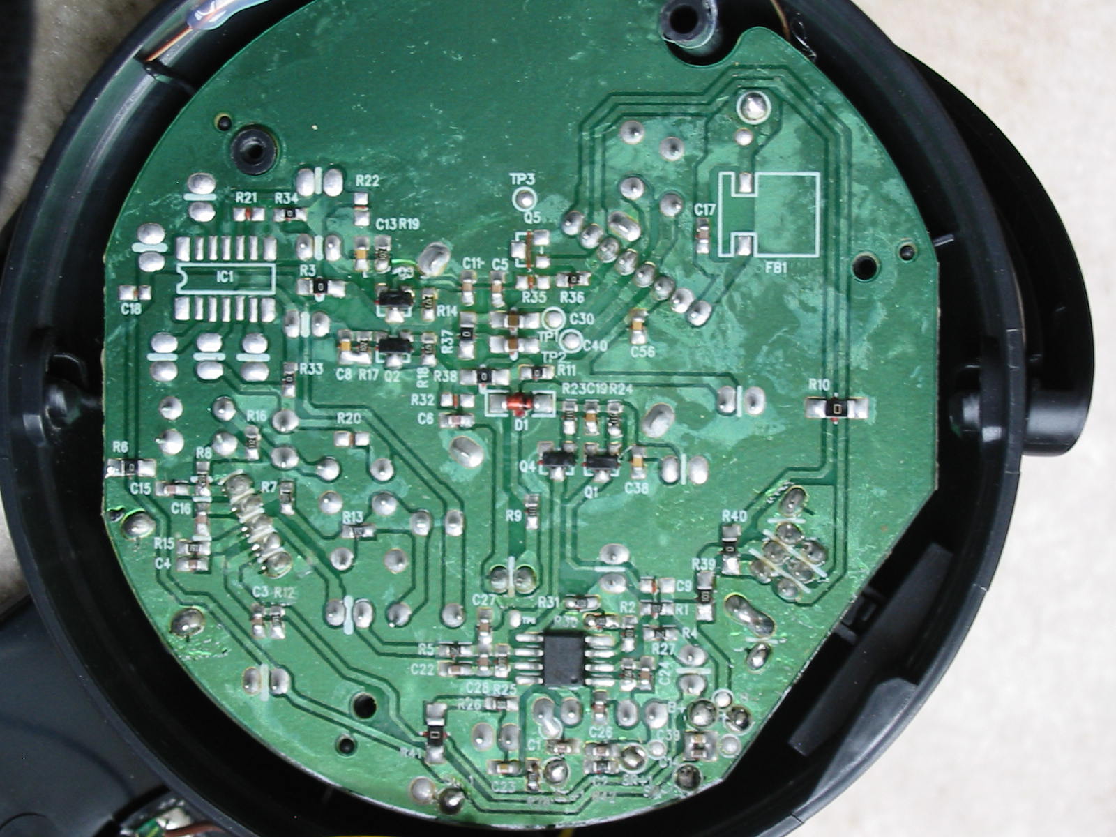

On the other side of the (now taken apart) ear cup is the PCB / electronics. Visible on the solder side is the amplifier IC (LS2308… i.e. TDA1308 -equivalent from what I found online).

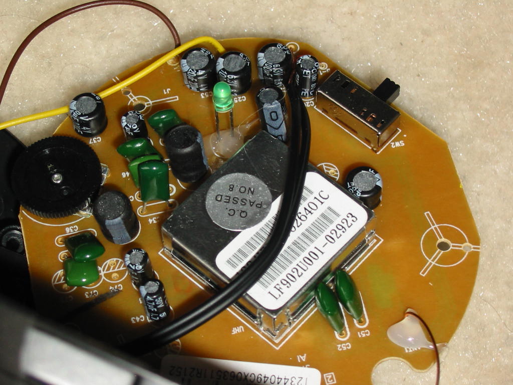

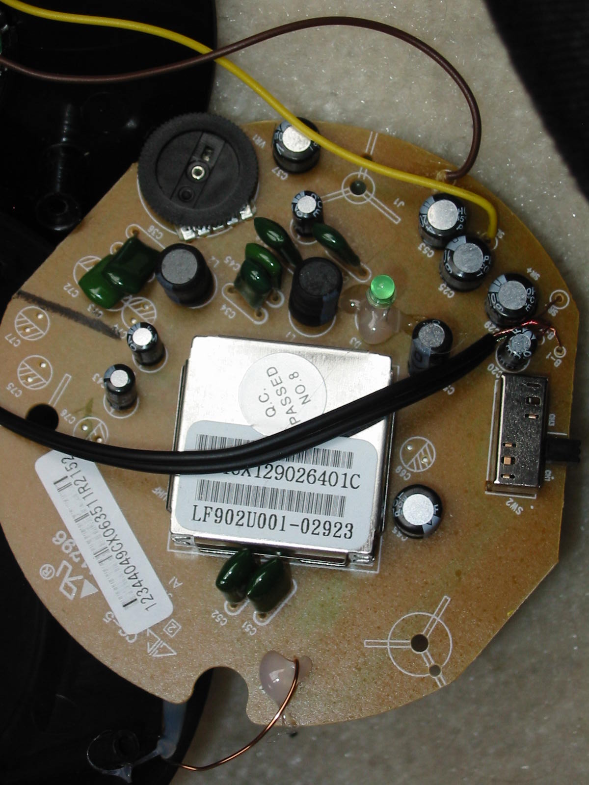

And on the component side is the receiver circuit (in that metal box) and other receiver components. Not much else to it.
As can be seen above, all of the electrolytic capacitors are from a brand called “HOPE”. So I guess that means they probably have no hope of lasting long.
On a related note, the output coupling capacitors are rated 4V, 220 uF, IIRC (or was it 6.3V, 100 uF?), thus being at least part of the reason why the bass output was so hopelessly bad.

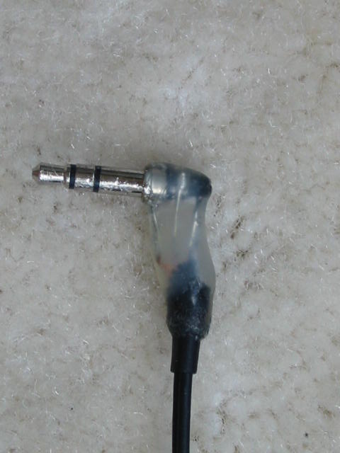

But the 3.5 mm jack was still relatively “good” (or usable, I should say), alas a little scratched up. After taking the cable home and cleaning it thoroughly, I saved it precisely for these kinds of audio projects. And ironically enough, I found it only shortly before buying these headphones. So could we say they were meant to be together?

The weak point was that 3.5 mm jack with the electrical tape – it just didn’t last very long (maybe 2-3 years with me being pretty careful with it.) So I re-soldered it and encased in hot glue, like I did with the two Dell PA-10 power adapters I showed recently. In fact, this is what made me realize I hadn’t posted these on BCN – the picture of the re-worked 3.5 mm jack, which predates the repairs of the PA-10 adapters by many years. Here it is:
