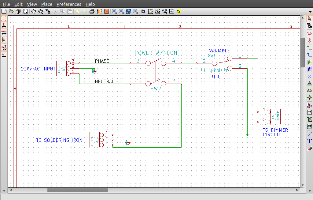

              I've drawn up a diagram for a basic idea, I think it should be OK but just wondering about the Full\Variable switch. On full mode, the output of the dimmer will be connected to line voltage.
              I don't think it will care but just want to make sure!

                Re: Soldering Iron: Cheap temperature control?
                Yes, the Full/Variable circuit should be fine. When set to Full power, the dimmer isn't connected to anything else on the input side, so the circuit for the light dimmer won't do anything.
                  Looks like it will work.
                  Also looks like a router speed control. (-;
                    Yeah, but it will be made from almost all recycled parts so a lot cheaper
