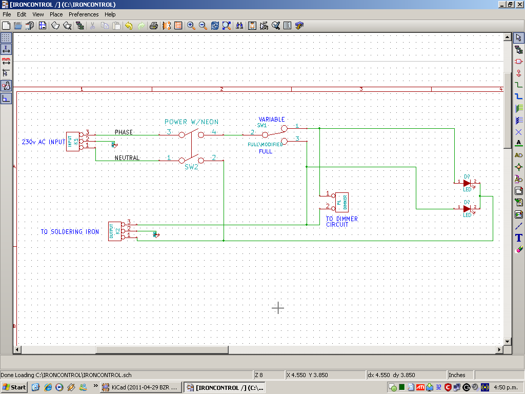

        Got the crimp terminals yesterday, decided to build the thing this afternoon.
        I also changed the schematic to add some LEDs for indicators (note in the schematic I am using only LEDs, but obviously I added dropping resistors etc in reality as well)
        The thing seems to work (tested with lightbulb so far, but not iron yet)
        Only problem is that the LEDs don't work - well they work, but they BOTH light up.
        It seems like the dimmer works in both directions (I had not counted on that). I can dim the indicator LEDs alternatively with each position of the switch
        I guess it won't hurt like that, so I think I'll leave it as-is since I can't see any easy way to fix the damn thing.
        Will report back on the actual temperature control once I test it out properly.

          Re: Soldering Iron: Cheap temperature control?
          Well, tried the thing out and if anything it seems worse, though that might not be entirely the fault of the controller
          The tip even after one use has become quite pitted and damaged even with the layer of solder (really cheap shit tip?) and I can't see anywhere to get a new one to try
          If I find a new tip I might give it a new test but for now I think this idea isn't a great idea.
