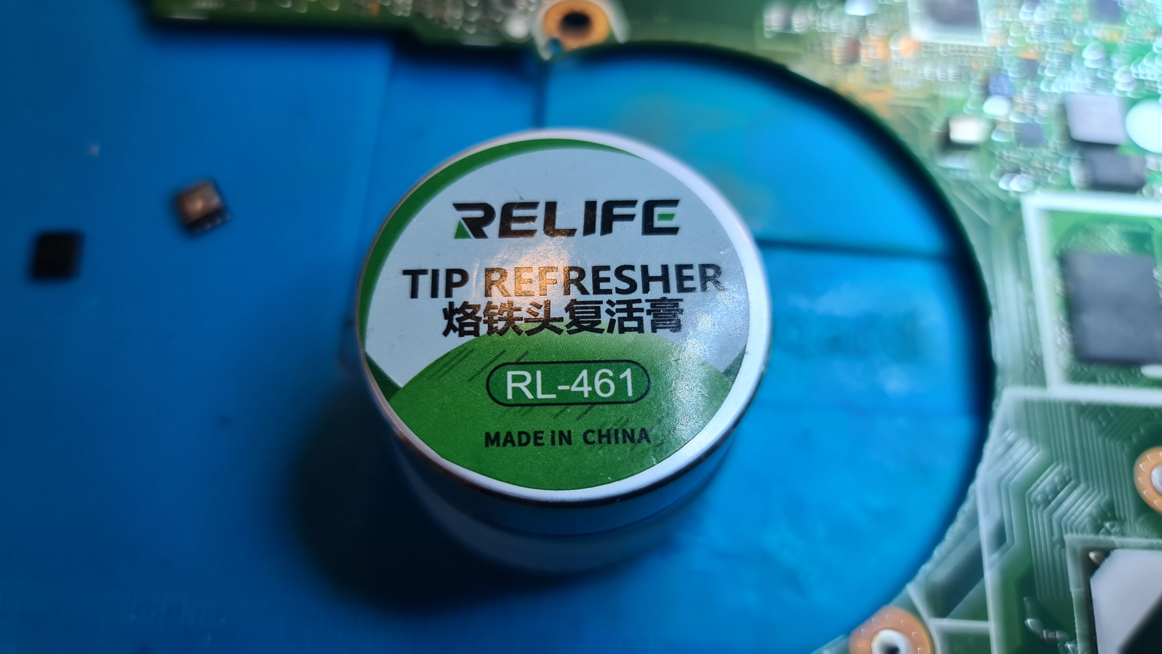

    Opinions on particular soldering iron tip maintenance product
    Has anybody tested this product? Posting this question on a Facebook tech group I'm in got a few responses like "that kind of thing corrodes the tips" and "just using normal solder paste is much better" so I'm not looking for generic responses like that, but rather, does anybody know for certain whether this exact product is good or bad for soldering iron tips?
    Click image for larger version  Name:	20240412_104916.jpg Views:	0 Size:	797.0 KB ID:	3251545
    • 31281
    dont touch that shit, it's a mix of acids and amonia crystals used to burn the surface of the tip
    it's only for unusable tips as a last-chance before binning them.
    to answer your exact question,
    i have used / tried to use the "Mechanic" branded version of the same stuff.
    it will get a lot of crap off the tip, but the effect doesnt last and neither does the tip plating!

        i dont care about tips. i use classic metal shavings. when i see the tip is not i like i just buy another. its not expencive and working with bad equipment is not worth that little money for new
        • clearchris
          • Dec 2013
          • 687
          Just always keep some solder on the tip when you turn off the iron. If you buy real (hakko, etc) tips, and have an iron with an auto shutoff (so it's not left on for days) it takes a long time to wear one down.
          But yeah, I have some "tip refresher" from a different brand, it does nothing worthwhile.
