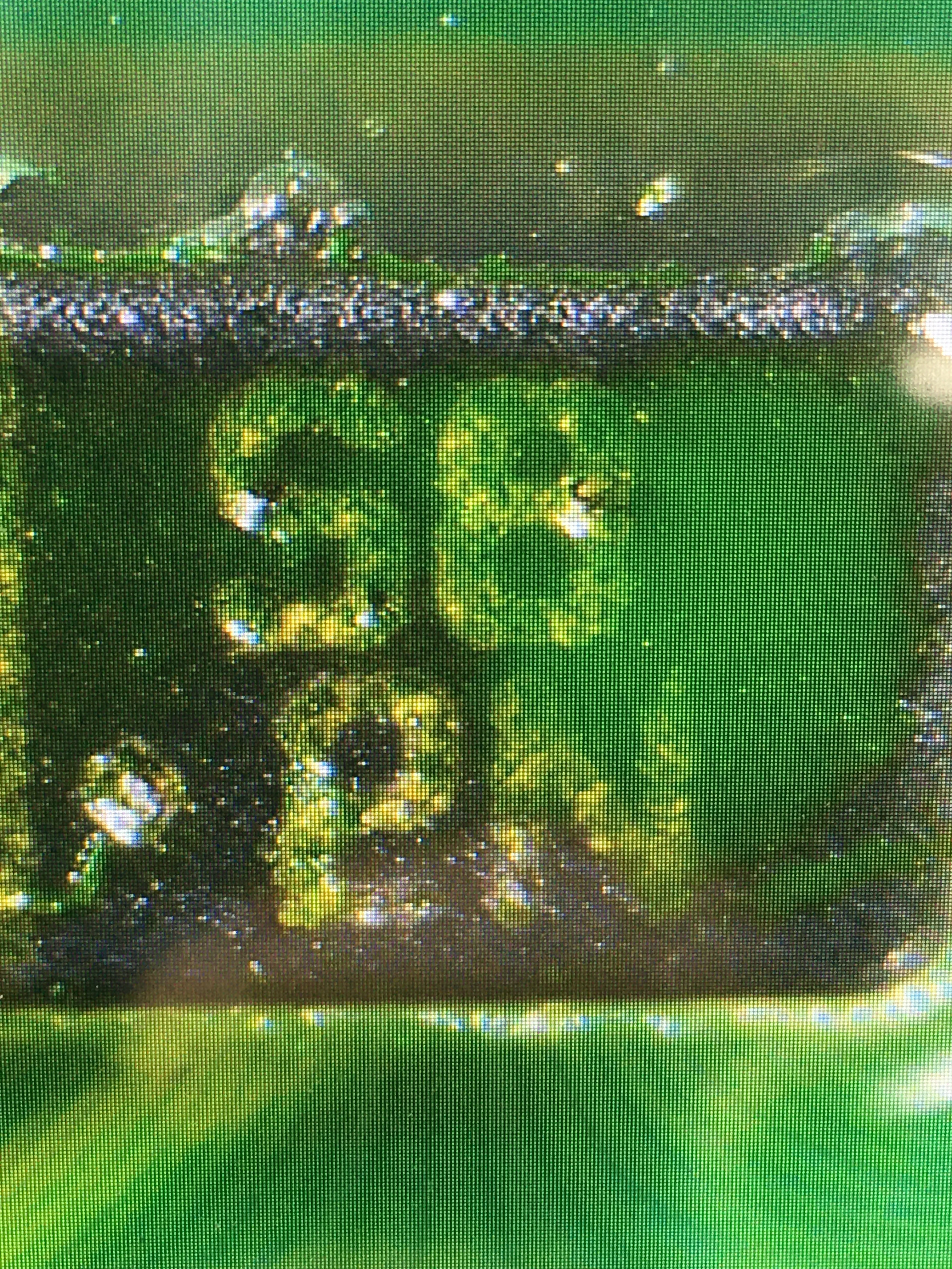

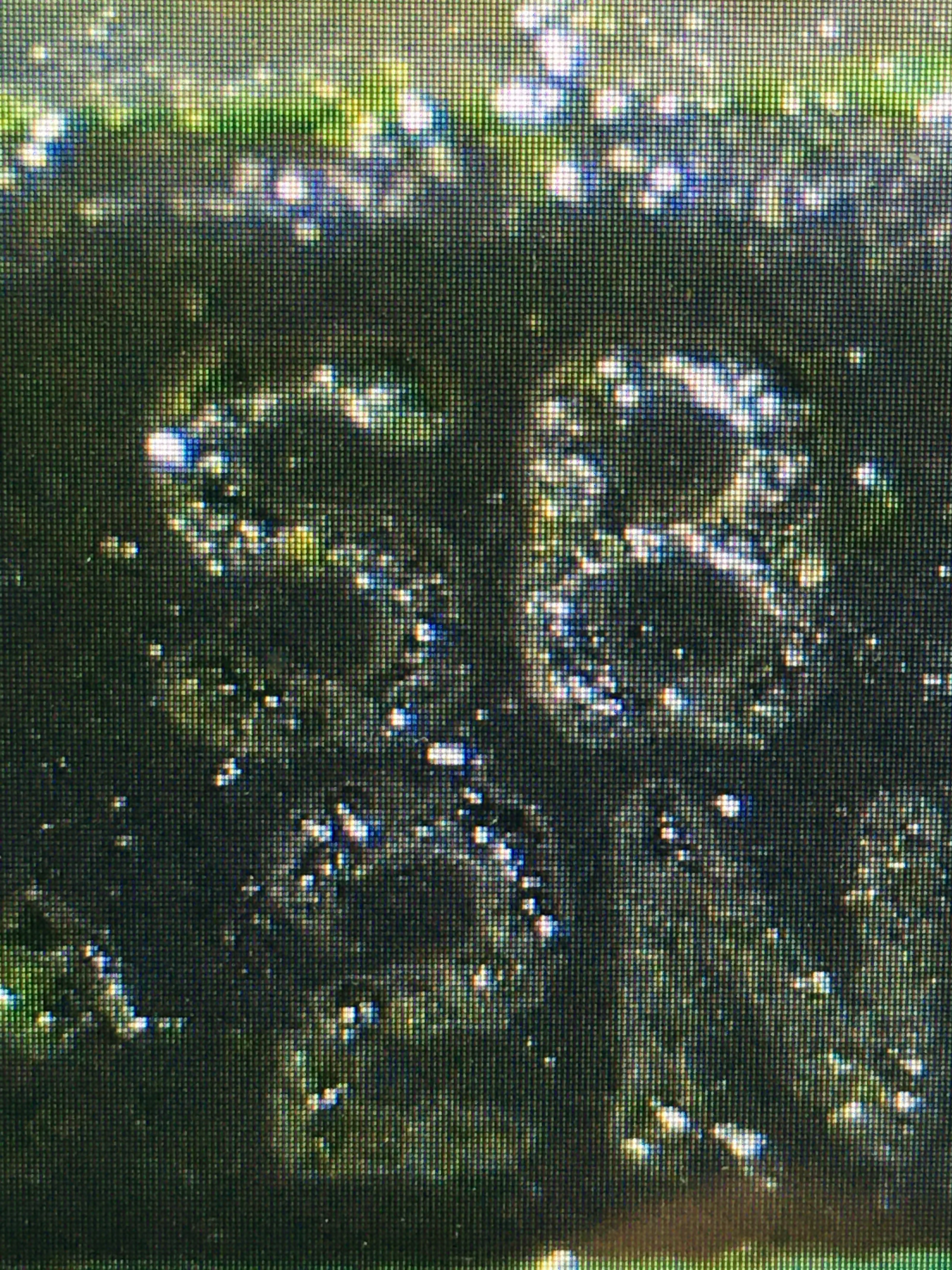

            Is this an SB or S8?
            • petehall347
              petehall347 commented
              Editing a comment
              looks like a B and google agrees with me .
          • mitsu2k
            • Aug 2013
            • 199
            #186
            But this photo looks like 8. Can you send me a link to what you googled please?
            it is SOD-323

              #187
              here but its not reading the text now
              https://lens.google.com/search?ep=cc...VsbCxbW11dXQ==

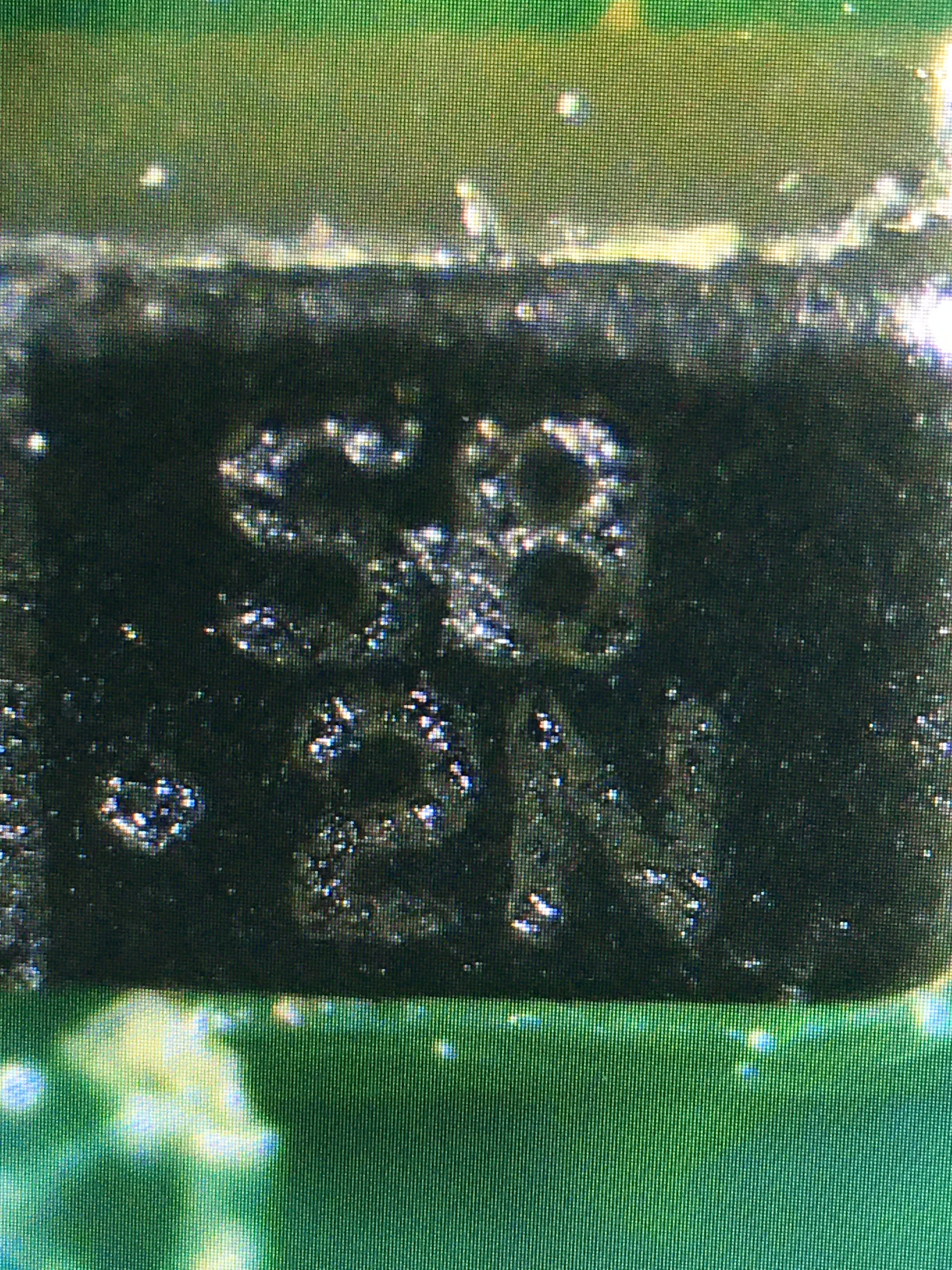

                #188
                Pete, I ordered both anyway one is 50v and the other is 30v. That's the biggest diff I can see.
                Mouser order placed. Will arrive Tuesday. Never been so nervous. Lol

                  #189
                  2n might be RLSD32A361C tvs esd protection . might not as well . cant find any pics .

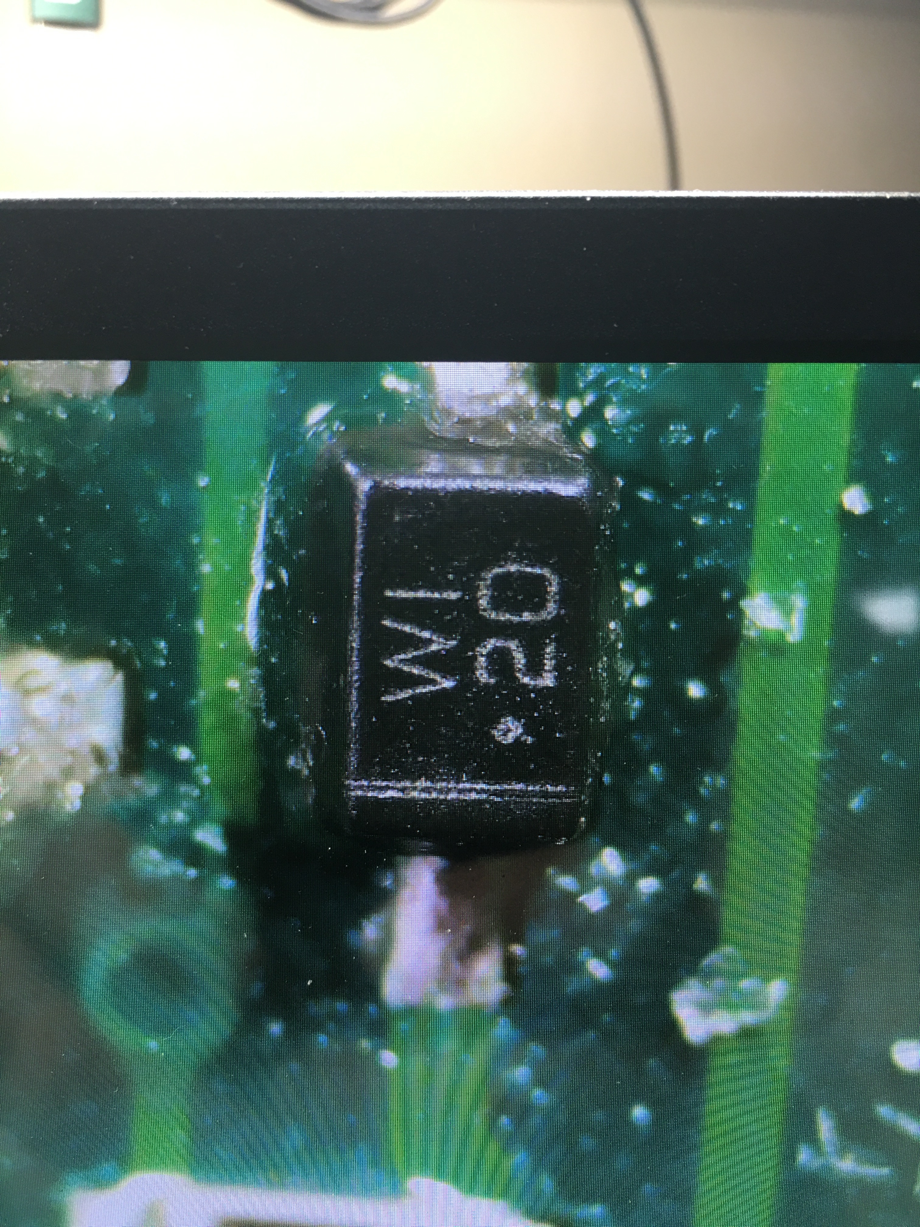

                    What is this component? Anyone know? I think it is a zener but it measures 1v. I cannot make sense whether that is a WI or W1

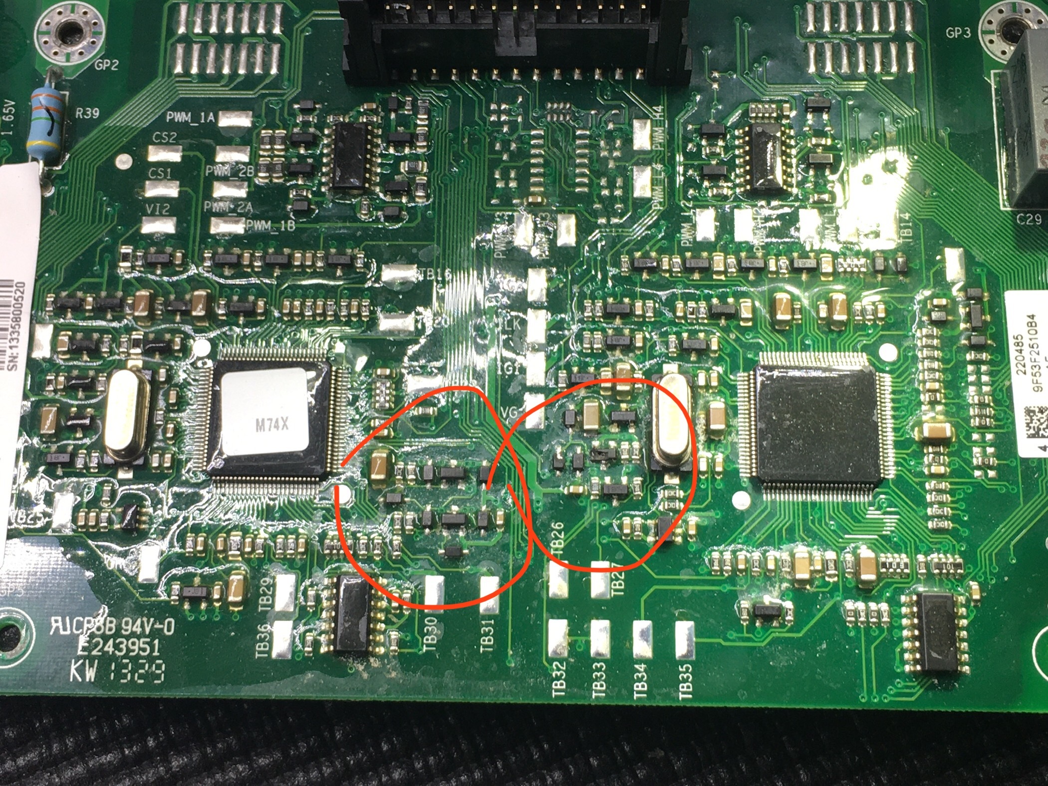

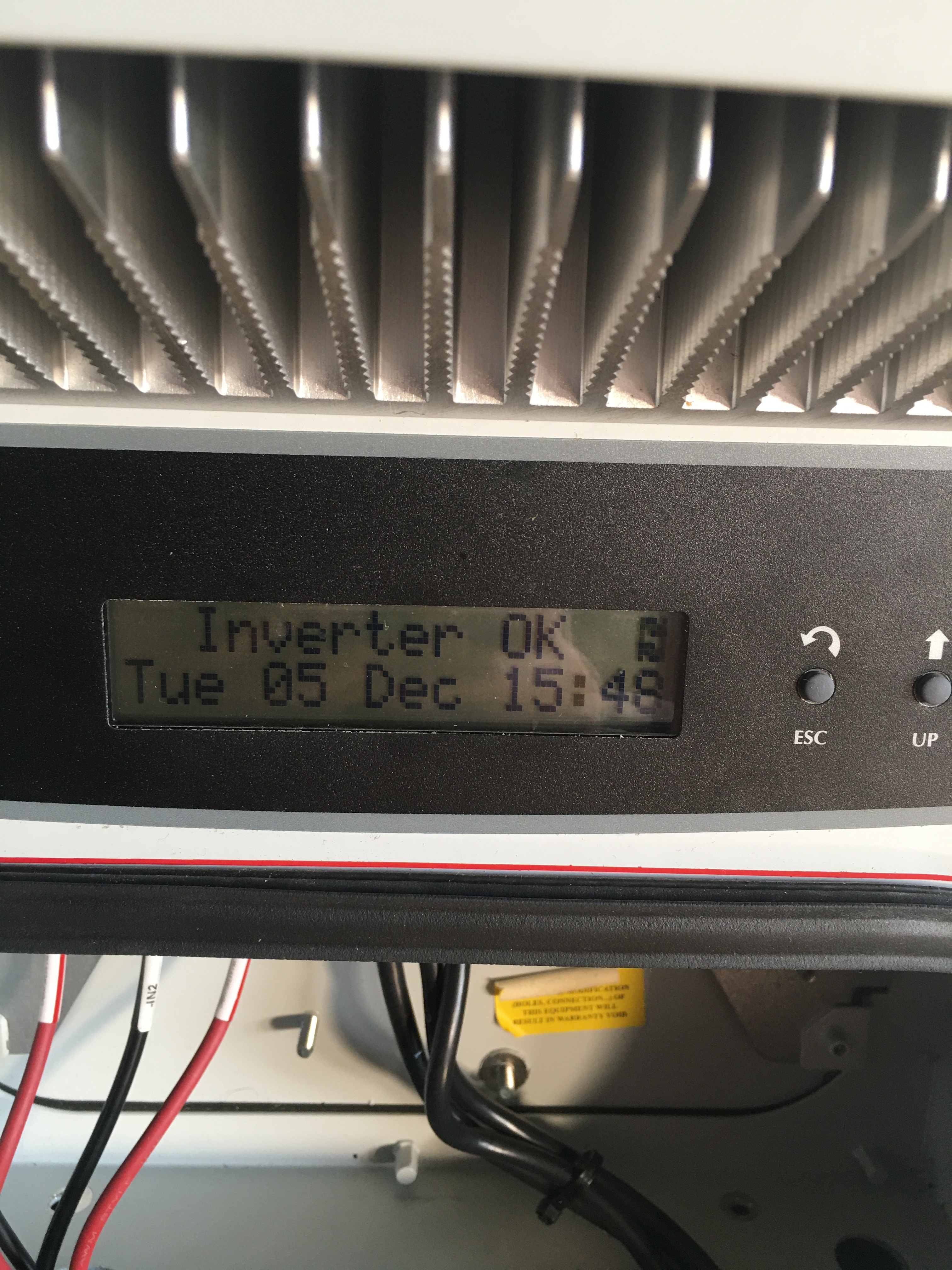

                      #191
                      SUCCESS!!! Replaced those burned components and a few more that were shorted on the logic board and this is the result. I want to give a big shout out and THANK YOU to CapLeaker, SAM_SAM_SAM and Petehall347 for all your help and dedication. You guys are absolutely amazing and I could not have done this without you. THANK YOU!!

                      #192
                      glad you got it fixed .well done .

                          #194
                          the parts were in the area i suspected earlier on .i have never seen one of these units in front of me so i could only guess the general area like around an mcu. i should have said look for the clock crystal that's there in most cases next to them .would have been good to know what caused the damage whether it being bad design or bad quality parts etc etc . .

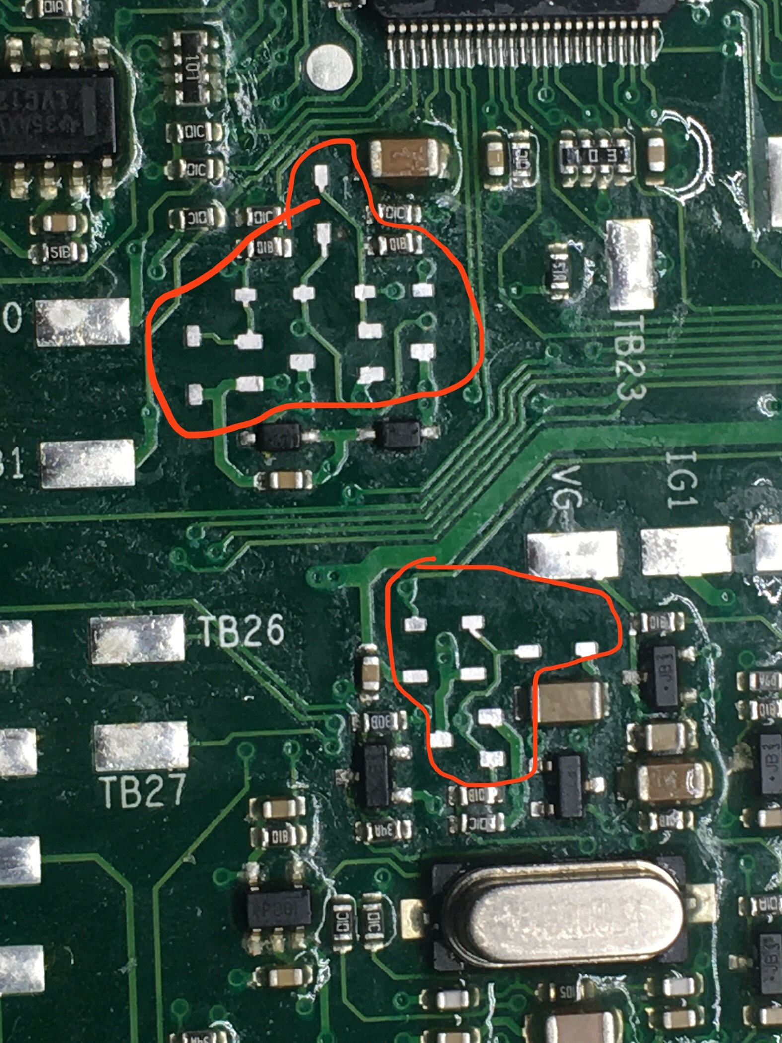

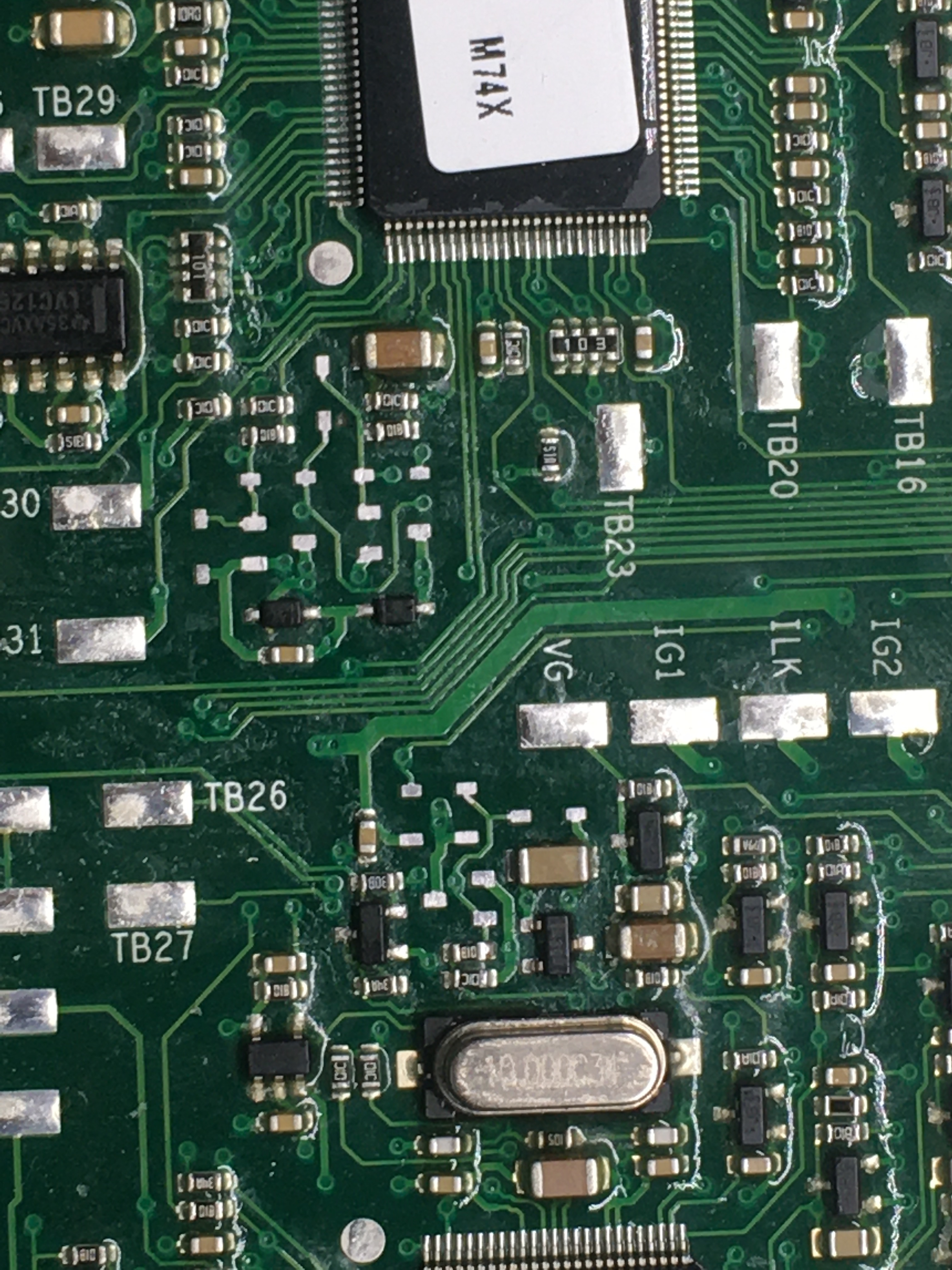

                              #196
                              They were right next to the crystals. The parts I replaced were:
                              3 mosfets (SOT-23) One was burned and the other two were shorted.
                              4 shorted diodes (One was burned) (SOD-323)
                              3 zener diodes (should have been SOD-323 but I used through hole wire leads instead)
                              I had trouble with the zener diodes trying to figure out the marking whether it was "WI" or "W1". neither of these made any sense because my research showed the WI is 12v and W1 is 2.7v but when I found some good ones on the board and tested them, they measured 3.4v and 3.7v. So I had some 3.6v through hole zeners so I just bent the leads and soldered them to the pads. Looks like it did the trick.

                                • mitsu2k
                                  • Aug 2013
                                  • 199
                                  #198
                                  Here are some photos. One is before removal of the components and the other is after I removed them and cleaned up the pads.
