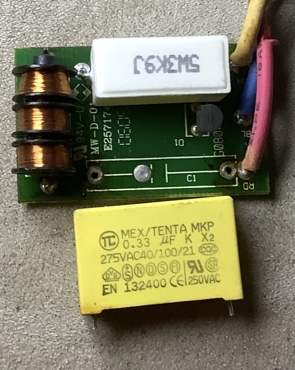

    No. It's the wrong value at 0.033uF and your pic and measurements are 0.33uF or 10x bigger. The lead spacing I see 22.5mm for the old part and PC board, or it will accomodate 15mm.
    B32922C3334M000
    495-2321-ND
    CAP FILM 0.33uF 20% 630VDC X2 305VAC LS=15mm.
    But I think replacing the cap will change nothing because the lamp starts OK and its value is still in spec.
    You have to replace the trigger Sidactor D1. Board says "G080xx" what part number is there.
    Digi-Key still has the K1200 in many different packages too.
    Thanks for pointing out my mistake I going to order the right value because I also need some other value capacitors anyway

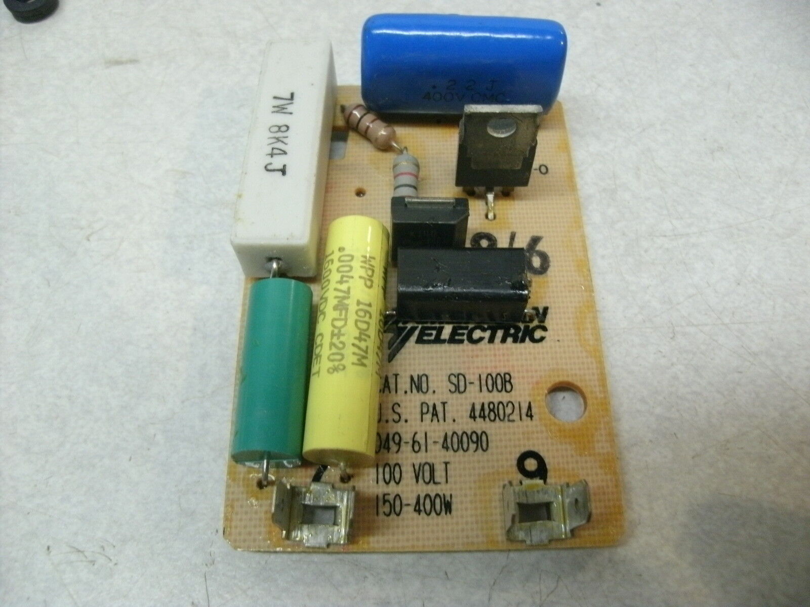

      Are you going to replace the semiconductor? I think you have to. Although that starter is not so great for quality, the HV trigger transformer should be potted.

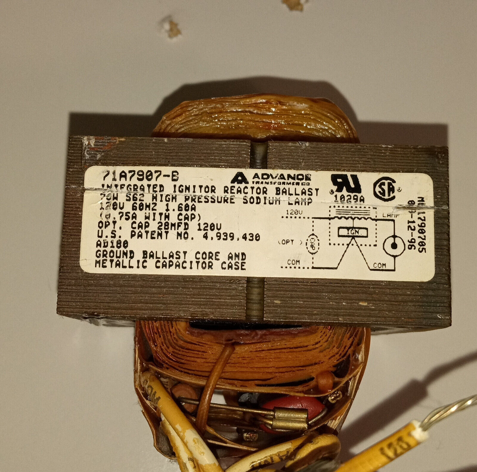

      Some ballasts even stuff those starter parts inside the main inductor. There is a big 28uF cap for some reason.
      The other board is for a bigger 150W-400W lamp and note it uses a real thyristor.

        The unit that I have dose not that type of ignitor it has this type
        Now one of the replacement parts high pressure sodium light fixture parts has the round potted ignitor which has a 35 - 120 watt light bulbs and I have a couple of new 100 watt bulbs and a 100 ballast that look fairly new I just have to find my other the E39 light socket fixture and put it back into working order again
        The replacement part that are new that I bought online from a eBay seller I put into the light fixture that I have had for many years now and they do not make this version anymore but it is a much better looking light fixture that is the reason I want to fix this light fixtures I have another one that is very similar but the light shade is cracked but I going J B welded it back together if I can find another 70 watt repair kit from another seller

          Update on this replacement parts for the lamp fixture that I had issues with so far this repair has been successful and I am pleased that it working
          I will get the replacement parts for the igniter board tomorrow by FedEx so I will see if replacing the capacitor will resolve the issue because I had replaced the diode already and it still was doing it just not as often

            I installed the new capacitor and now it does not cycle on and off when the air conditioner comes on so the capacitor must have been a little week that when the voltage dropped a little bit it would cycle on and off I also think that the diode was also an issue as well
            Because when I put the original high pressure sodium bulb in it was still cycling on and off every couple of minutes so the bulb was not very good either ( but it was not doing it with the original capacitor but was doing it when the air conditioner would cycle on ) because when I put the new bulb in with the repairs done to the board now the light fixture is back to normal
            One note this is shorter than the original one but the igniter board has two holes on one side to accommodate the two different size capacitors

              I had an idea that there might be issue with the transformer because of varnish on the outside of the transformer compared to the new transformer and sometimes you could hear something going on with the windings when first turning on the power you do not have that noise either
              The weird thing about the original capacitor and the original light bulb is that the light only cycles when the air conditioner would turn on however when replacing the capacitor and putting original light bulb it would get real bright and then cycle back to being dim for a few seconds then get real bright and again the new light bulb is not as bright but it does not cycle on and off
