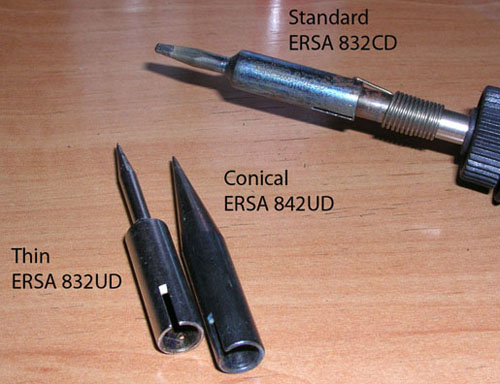

            That was written about my old "Scope" soldering iron which has a 3mm wide pencil shaped copper tip. This iron is now history as far as Mobos are concerned.
            Regarding my new Hakko: Beside the standard tip, I got a chisel shaped tip which was 1.6mm wide at the end. However, this proved to be a little too big and clumsy, so I went back to the standard conical tip and filed a tiny flat on it. Hakko make a standard tip like this which I originally was considering but the salesman steered me towards the chisel tip.
            The conical tip proved to be handy for poking down PCB holes to clear them when de-soldering.

              conical tip on my iron is not hot enough for motherboards. (salesman recommendation also....bastard salesmen )

                What kind of tip do you use?

                  standard chisel tip. the other two didnt get hot enough. you can see also that the standard tip is the shortest, this is important for heat transfer. i actually want something not so wide but i am gonna upgrade the whole station anyway.
