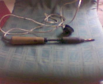

              Originally posted by willawake
              what is the watts of your iron? i understand that 220V is the mains voltage of your iron.
              I think it's 50watts
              and yes, 220V is main voltage
              its type is зтп-1

                  Re: Soldering How-To
                  its type is зтп-1
                  50w is ok, there is concern about using solder iron gun type which are like 200w+ too hot. I cant see much in your photo but the mains cable looks poor. it is necessary for the iron to be grounded for ESD reasons. does the plug have grounding point or pin? unplug the iron and check with multimeter from the grounding point of plug to tip of iron. should read about 1 ohm.
                  if you work with the iron unplugged then it will cool down while you are working. not recommended to work like that. not recommended to use non grounded iron either.
                          it has only two wires and stays hot quite long time (made in good old CCCP ) so i think i should heat it up, unplugg, desold a cap, plug it in and let it to heat up again .. it takes time but right now i don't want to waste money on newer solder that i only use once a year
                          thank you, willawake, for your answers
                            #33
                            it is going to take time that way. if it has two wires then yes dont use it on the board plugged in.
