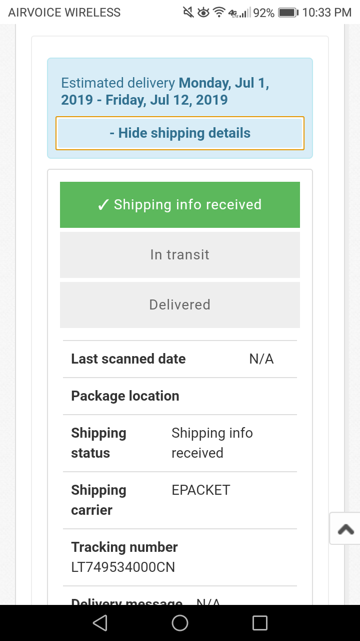

      Re: Soldering station thoughts and guidelines
      Well, you might think it's too good to be true, but I see it's been shipped and is in transit....see pic
        That indicated it's not been shipped. The tracking number isn't recognised.
        They have filled their store out in the last couple of days and having a quick look at numbers sold, have pulled in 3-4 grand already.
          I have had this same email today with a different tracking number though like i say im not bothered if it does not arrive as will get the cash back either way.
            pretty sure Epacket is just small stuff like jiffybags.
            for big boxes they would probably use china-post or EMS.

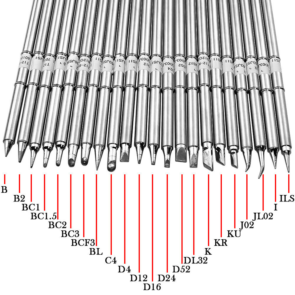

                Originally posted by Dannyx
                BTW - I started soldering with a fat bevel tip at work just to see how it works and I love it: great thermal mass, perfect for wicking....awesome Ok, that camel toe of a tip is not going to work on microscopic SMDs, but it can touch up larger SMDs just as well.
                Which tip is that?

                  #128
                  Originally posted by redwire
                  Which tip is that?
                  I think it's a C4, which is perfectly adequate for THT and even SMDs which are on the large side. I didn't get it especially for this - it came in a pack of several tips I ordered a while back just for the JL02 one and my JL02 had finally succumbed to the abuse I had given it, so I decided to try something fatter so it would last longer It's also not a T12 - it's a Hakko, sleeve-type tip, but essentially the same thing.

                    #129
                    there are no bevel tips in that image.
                    http://www.hakko.com/english/tip_sel...eries_t12.html

                      #130
                      I call that C4 in the picture of the T12 assortment a "bevel" tip and the ones you linked to "screwdriver" tips....which Hakko calls "bevel" tips, so I don't know which is which

                        #131
                        C tips are just cross-cut, they have no recesses to hold solder.
                        the beveled tip is BCM3, i think i have one in my collection.
