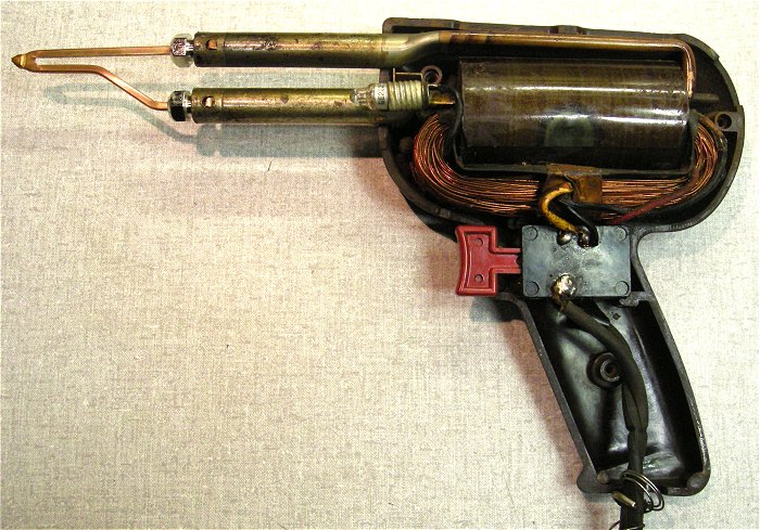

                    Re: Soldering station thoughts and guidelines
                    Originally posted by eccerr0r
                    What's wrong with using a soldering gun?
                    I use mine all the time - it's there on my workbench always plugged in and ready to go. It heats up in seconds and the heat is concentrated on the very tip, the business end, instead of it being radiated by an element like in SMD stations.
                    I heard that in some situations it has the potential to kill stuff, since the tip is electrified, which makes me a bit nervous to use it on stuff more delicate stuff like ICs.
                    Wattevah...

                        #91
                        Originally posted by stj
                        it's not the voltage, it's induction because the "tip" is an electromagnet.
                        So when you let go of the trigger, the back EMF of the "coil" is the killer ?
                        Wattevah...

                          #92
                          Yes. The soldering gun is not grounded and the arc when you switch-off the trigger makes several kV at the tip. I think a cap across the switches helps. This is the old Weller 8200's.
                          In the repair shop, we got bored and used to have to competitions.
                          We would all use soldering guns for a day. It could be fun desoldering IC's but would show who the best tech was.
                          But I found the tip would make a spike when you click off and destroy an IC.
                          You can connect neon lamp to the tip and ground the other side and see it flash.

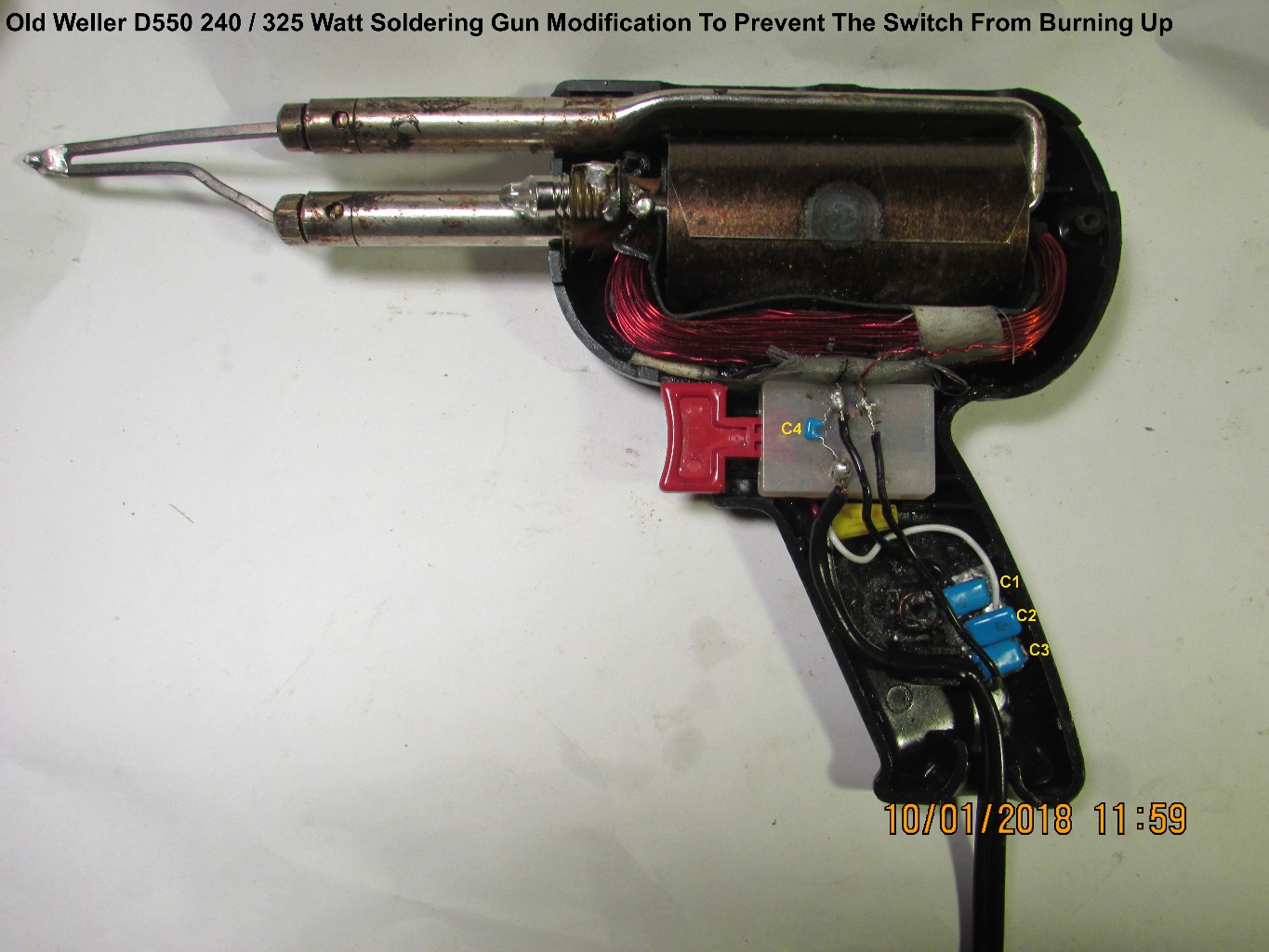

                            #93
                            Would one of those yellow X caps across the switch be a good idea ?
                            What I do is hold down the trigger to get the tip nice and hot then release it away from the part and use the remaining heat to do the actual solder job. Of course it doesn't always work and it gets tougher and tougher the bigger the joint is...
                            Wattevah...

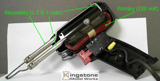

                              It's the solenoid-style transformer they use in soldering guns, it has a lot of leakage inductance. I think capacitors would certainly help. You can hear the arc on the switch.
                              But there is still 50/60Hz mains leakage currents to the tip, due to the transformer's winding capacitance and no ground. It still is risky.
                              I don't use soldering guns on delicate IC's after I killed a few. If I really need that heat, I add a ground clip and then do the work.

                                #95
                                This one has an E-I transformer - clearly has laminates.
                                A cap across the switch certainly can't hurt and might as well throw it in there.
                                As for grounding: I assume you ground the secondary (one of the fat output bars going to the tip), since the primary is straight on 230v so that would be a short....
                                Wattevah...

                                  #96
                                  I've only seen the solenoid-style transformers, they date back to the 1940's in USA. It's a spool of sheet iron for the core.
                                  What do they have in Europe?
                                  Here a guy adds capacitors to stop the switches from arcing and burning, but he did it wrong putting them sorta across the primary, and one looks low voltage.
