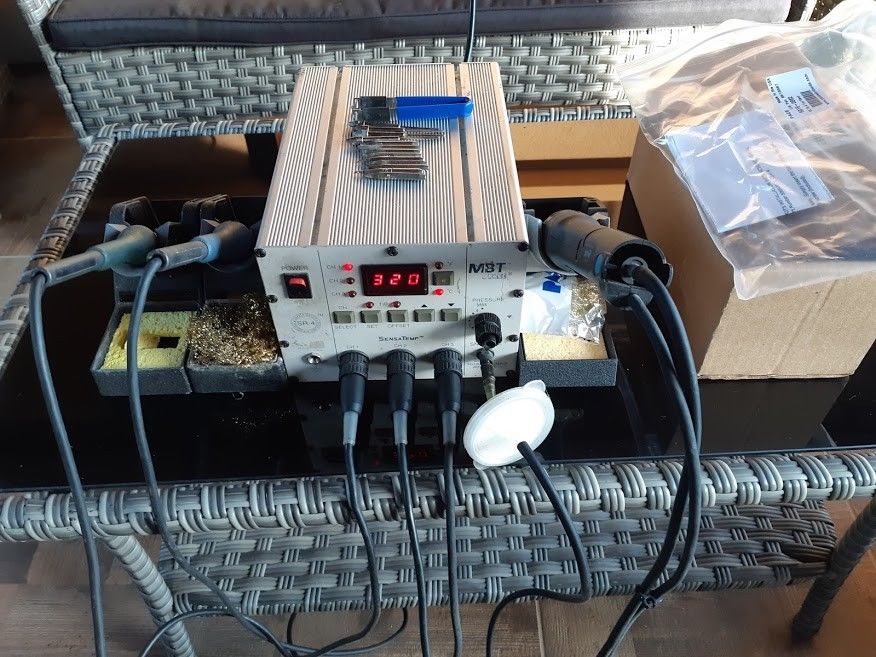

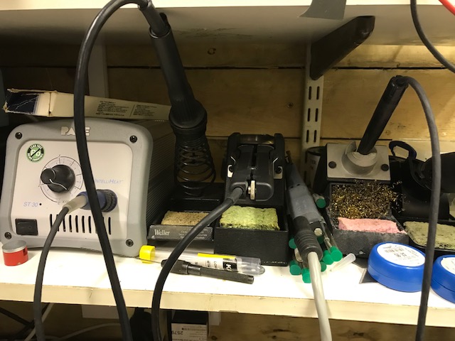

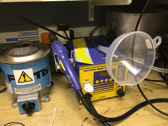

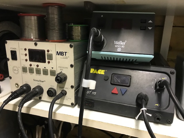

                              Here are some images of the majority of the soldering equipment I have in regular use, the solder fume extractor filter in case your interested is a older style Purex I would not like to add up the cost of all this were you to obtain the modern Pace equivalents and the Plato solder bath when I priced that up it was rather shocking.

                                I came across that MBT one here as well (or a slightly different model, but MBT still) but couldn't tell what tips it uses so I had no idea if they're still obtainable new or if other variants are supported.
                                I also found a Pace but it didn't come with any accessories, which is pointless...

                                  Sensor-temp and Inteli-heat generally take the same tips, well that's a little oversimplification, but generally they do with certain exceptions relating to things like the thermojet systems, thermo tweezers and solder extractors which have their own tips. TD100 and TD130 are current cartridge based solutions, but the tips are readily available for inteliheat and sensor temp systems as are the hand-pieces and replacement heaters etc. They tend to be more expensive though and I have yet to find any cheaper clones, The MBT 250 is compatible with 8 sensor temp hand-pieces and used with an adaptor will so I am told work with Inteli-heat I will one day get around to testing this. The ST115 is compatible with both systems and the ST 30 is only compatible with Inteli-heat.
                                  Up there you will also see a pace thermo stripper which I would not be without, the Weller wps is a 80 watt system which uses some really nice smaller LT series tips for which there are a number of very cheap clone tip sets for. This I use mainly for micro soldering and other SMD stuff although I obtained the TD100 to essentially replace this but I ended up with both systems.
                                  You can find complete Pace sets come up from time to time, but mostly your going to have to get all your accessories separately unless you get lucky and they do hold value.
