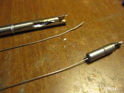

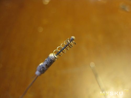

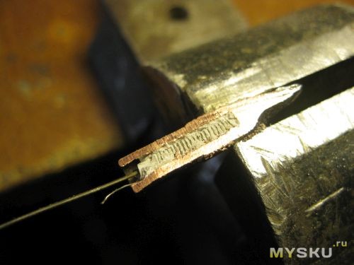

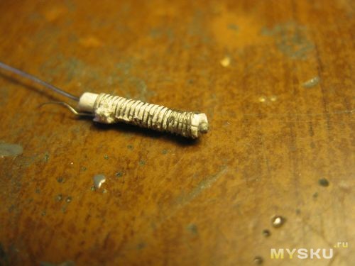

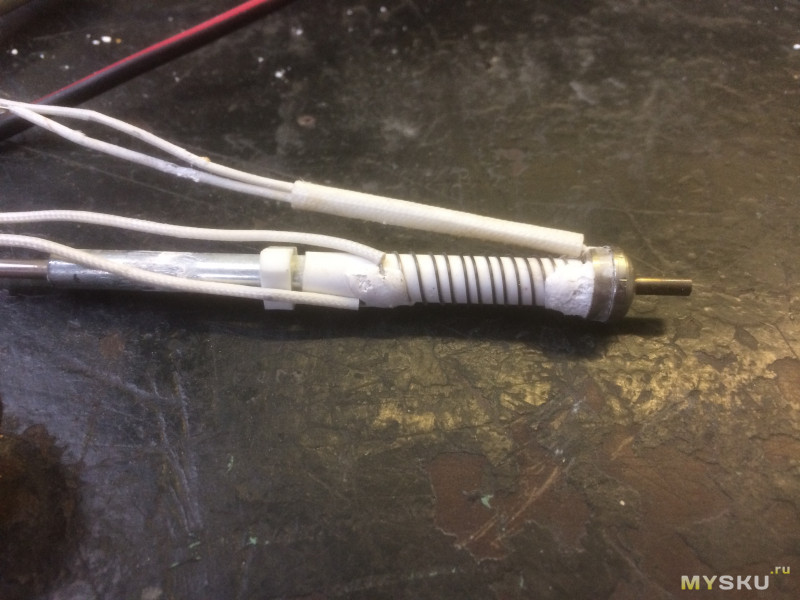

              Re: Soldering station thoughts and guidelines
              It was Hakko's idea, T12 came from the patent, now expired: US 6087631
              It's just a spot weld with a different metal.
              You can put several amps through a thermocouple and it doesn't care.
              Last pic is JBC cheap knock off I think- it uses two wires for the thermocouple plus two for the heater.
                I wonder if a Weller handle works in the same way. That is, two separate wires instead of a combined probe-heater like the T12. The Gordak probably uses this "split" system as well....would have to take it apart to map the pins and whatnot...
