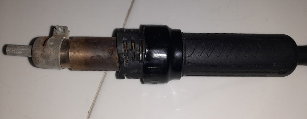

    Hi Everyone,
    I bought a Yihua 992DA+ hot air gun and soldering iron unit from a used market.
    1. Soldering iron works great
    2. There is a burnt mark on the hot air gun handle.
    I am a bit concern by the look of the melted plastic. I opened the hot air gun handle and took some readings with a multimeter.
    Heating element ~ 75ohm. (Similar reading taken from a spare heating element that came with the unit.)
    Thermocouple ~ 1.5ohm. (Similar reading from the spare heating element.)
    Reed switch tested ok with a magnet.
    From the above test, I can conclude that the hot air gun handle is OK. So, the fault maybe in the control box.
    1. A multimeter test on optocouplers seem OK. What if they are intermittent? Should I just go and replace the two part?
    2. The two TRIAC look OK. Should I replace them too?
    3. What are the possible faults with thermocouple and reed switch signals not being processed?
    Thanks in advance.

      stj, I have missed out one important info i.e. seller told me that the heating element is weak so need to replace it. At the hot air gun is unusable.

          stj, I did ask him about air flow and he said the air flow is OK. Only thing is the temperature cannot go beyond a certain degree. This is what he mean by weak. Thanks.
            • 31315
            sounds like a control circuit issue
            you can test this by putting the air to maximum and forcing the element on 100%- keep a finger on the power switch though.
            another possibility is a break in the cable - it does get moved a lot.
