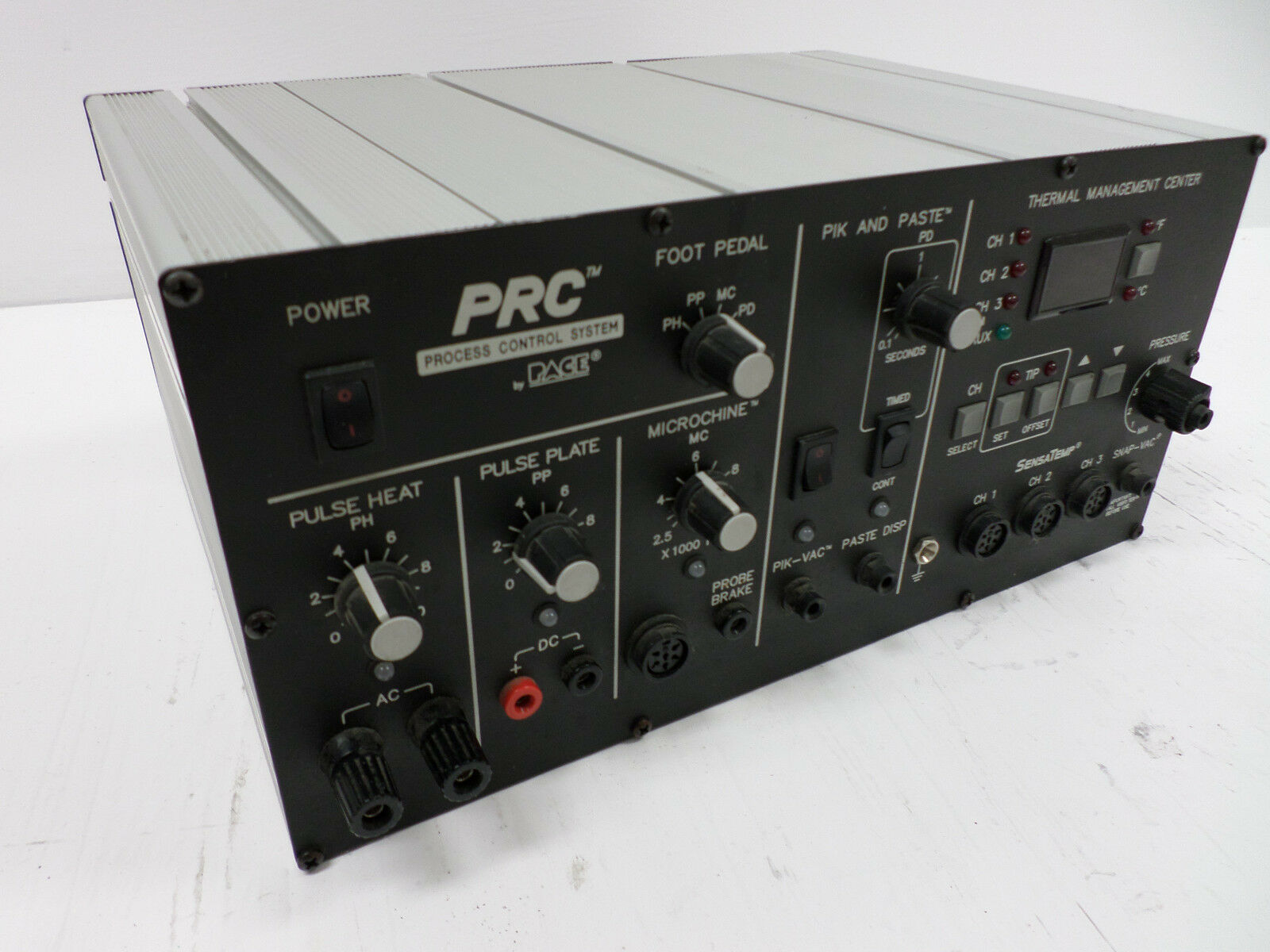

                                  All of my solder workstations for professional use are Pace with a single Weller WSD81 and hand-piece, I use a Pace Thermojet hot air tool for small smd items and for now a Hakko FR-802 SMD Rework Station for larger thermal mass stuff.

                                    #77
                                    Re: Soldering station thoughts and guidelines
                                    Wondering if I could find really fine T12 tips like the Hakko Micro Pencil.
                                    Don't know if I mentioned this before but we found a Pace "combo" station in a junk pile at work. It runs on 110v, so that's most likely why it got shoved to the side. Thankfully we managed to find a large enough step-down transformer and amazingly it still works - it takes a standard IEC-13 lead, so it's not hard at all to accidentally plug this into 230v and pop it, which is why I was expecting it to be broken, but it's actually in decent shape too - couple of scuffs and dirt and clogged nozzles, but we managed to get it going again. Don't know too many details about it like the model and other stuff because my old geezer co-worker I talk about all the time basically decided to keep it all to himself, as if he bought it or something >_>. I know it's got a couple of accessories like a very fine-tipped (angled !) hot air blower, a solder sucker, a regular iron and also a tweezers-type iron, so this COULD be a very handy tool, but it just sits on a shelf somewhere collecting dust....really waiting for this guy to quit SOMEDAY ! Seriously
                                    Wattevah...
