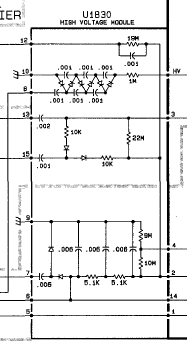

      Ahh... I found schematics and placement information that's closer than found in the service guide; it looks like a later version of the board was in the device. Still no idea why it seems shorted when plugged in (light bulb in place of the fuse burns brightly) but without the PSU the light is out.
      When disconnecting the anode and cathode/filament (by the base socket), the light bulb still burns brightly.
      One oddity was that I hooked up my sencore to the "flyback" output (before the multiplier). At first I was getting a Q factor of around 9... Then after a bit of futzing with it, the meter got a Q factor of 29. I hope I don't have a fried flyback that has an intermittent short. I was testing in-circuit...
      Woah
      http://www.ebay.com/itm/TEKTRONIX-GB...-/272182368706 - What was Tektronix thinking? Look at the bodge job at the lower left of the board...
      Sigh... hope that I can fix mine somehow...
      Your HV supply is bad. The incased HV tripler/doubler are notorious for burning out the diodes or the caps in them. A shorted or over current heater winding could cause the flyback coils to have shorted turns or open windings. Flash overs in the crt are a known killer of these.

        if it is the trippler and not the initial transformer, i would try to decap it.
        or if internal schems exist - clone it.

                if you fit a resistor (like in the ebay foto!!) make sure it is rated for the correct voltage.
                as for epoxy - big fucking deal - i have taken epoxy potted stuff appart as part of my reverse engineering for the MAME project loads of times.
                heat or paint stripper like Nitromors will usually break it up or soften it.
                can you link / post the schems.

                          I just went by the model that was in post #19 and the hv board he posted looked very similar
                          Oh well, never mind.
                            • 31198
                            #53
                            Re: bent neck CRT pins...
                            so this?
                            it looks not just easy to clone,
                            but i suspect you could test much of it from the outside with a component tester!

                              Yeah, that's the multiplier. Next I want to desolder the flyback from the multiplier so I can separate the resistance. Indeed it's a fairly simple blackbox.
                              So far other than the resistance of the flyback secondary, I did see that 10K ohms between 2 and 14 though the other pins are somewhat clouded by the outside circuitry. So far that was the only set of pins other than the filament feedthroughs that have less than ~ 8Mohms that I've probed so far...

                                i would be probing that brick in relation to the diodes as much as anything else.

                                  As far as air in the CRT goes, it should have a getter spot turned white.
                                  I've had CRT's with no or low high voltage but the HOT working hard and running hot. Disconnecting the 2nd anode I could draw a big arc, the high voltage would come right up.
                                  Found the problem was a leaky/shorted HV rectifier. AC going to the CRT loads down the HV, it's the CRT 2nd anode capacitance.
                                  I don't suggest OP try the arc test if he doesn't have experience, but it's an old trick we used in the shop to troubleshoot HV problems.
