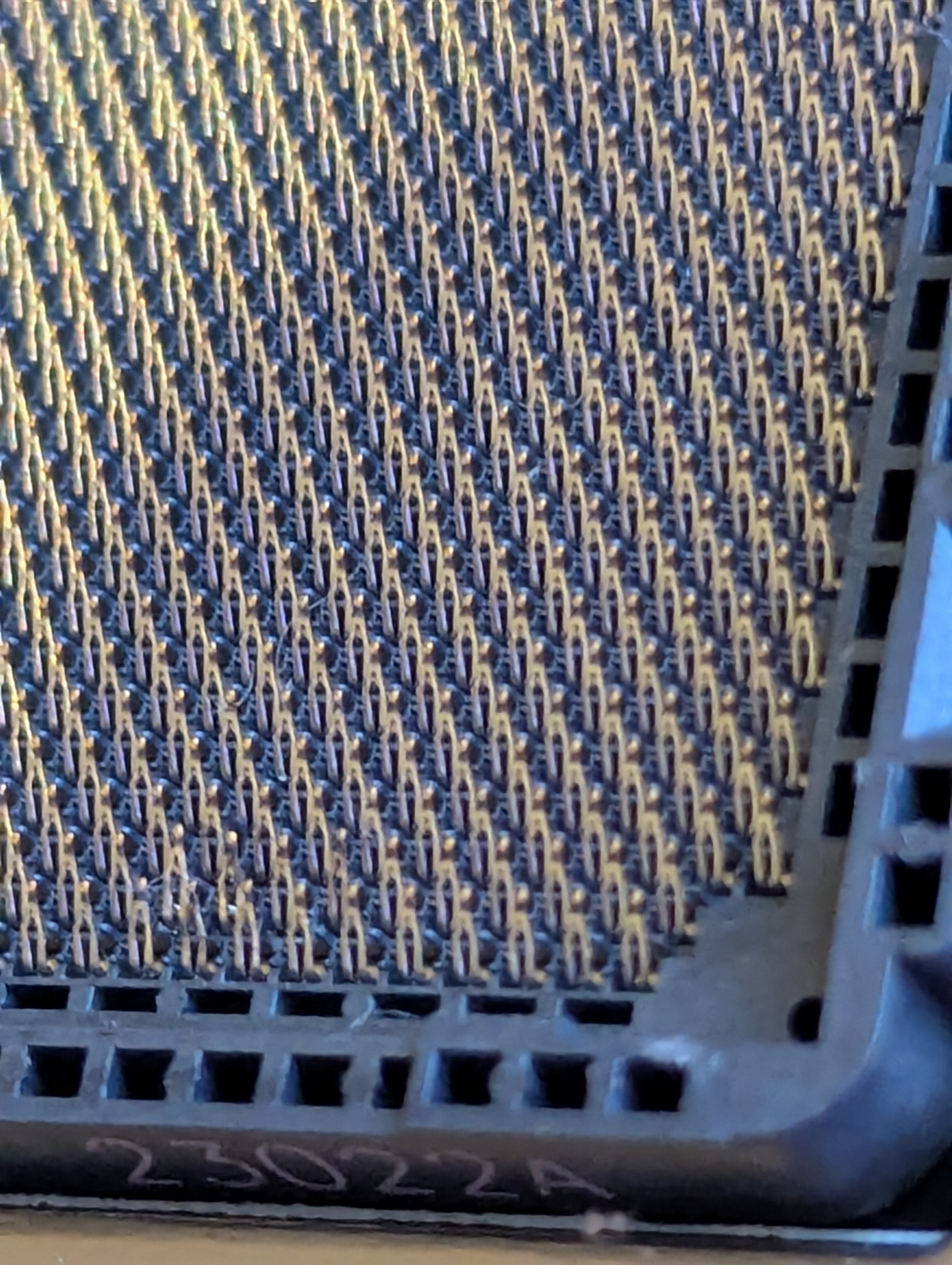

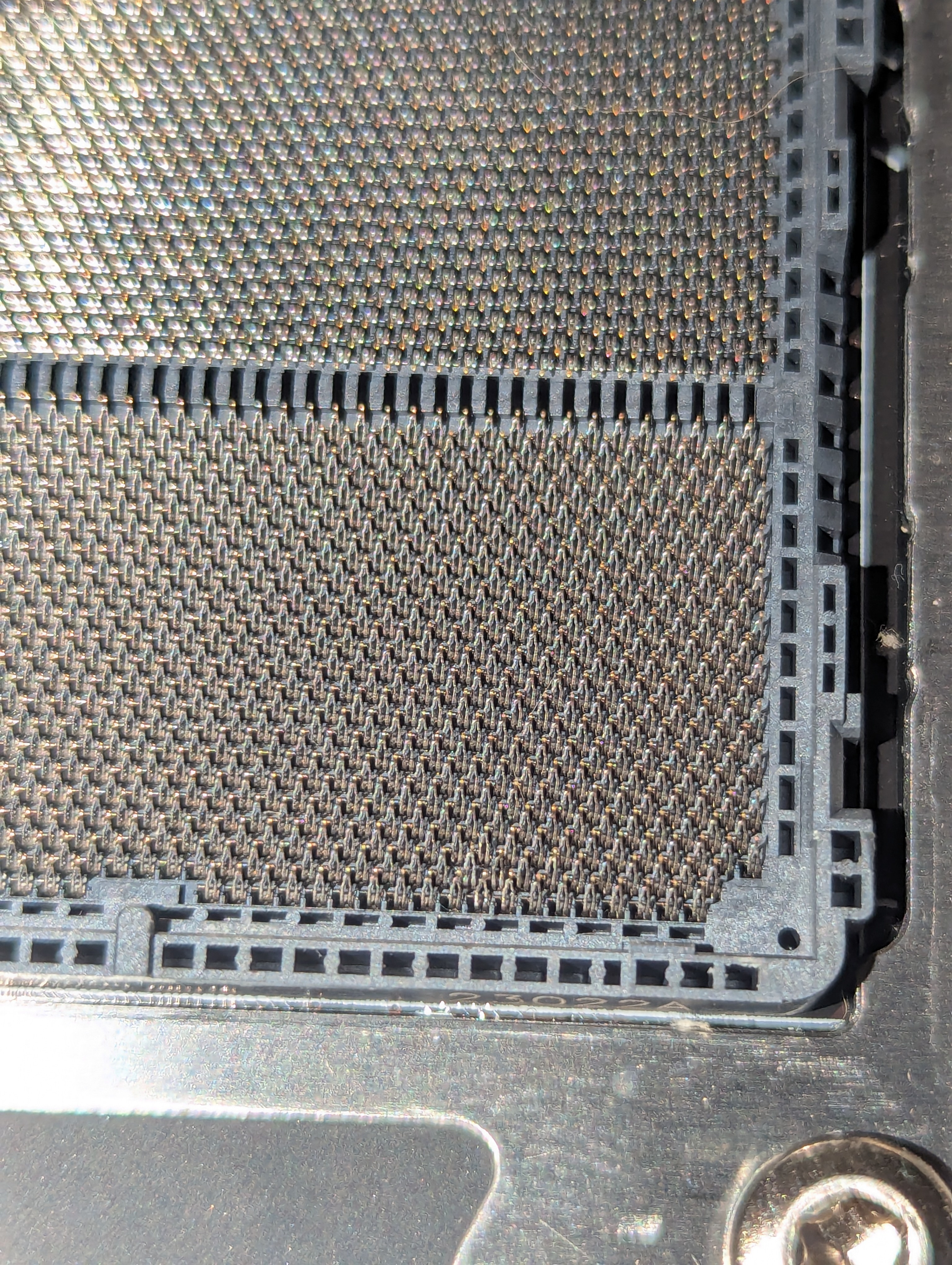

    This is an X670-P, seller stated bent pins and no power on, the socket has 2 bent pins, the pins are slightly bent upwards (VSS and a Channel A pin), so it's an easy fix, don't even need to replace the socket, tested all power rails on the CPU and found no shorts, the bent pins are also not in short, power rails of both southbrides 0.95v and 1.8v also show no shorts.

        Photo show the cpu socket, afected pins are BD32, BC31 both go to A1 and A2 ram slots, and BD31 GND
        Spare CPU and SIO should arrive within 2 weeks. Still, before turning it on, I will make sure to check, and double-check if there are no dead shorts on all the adjacent pins
