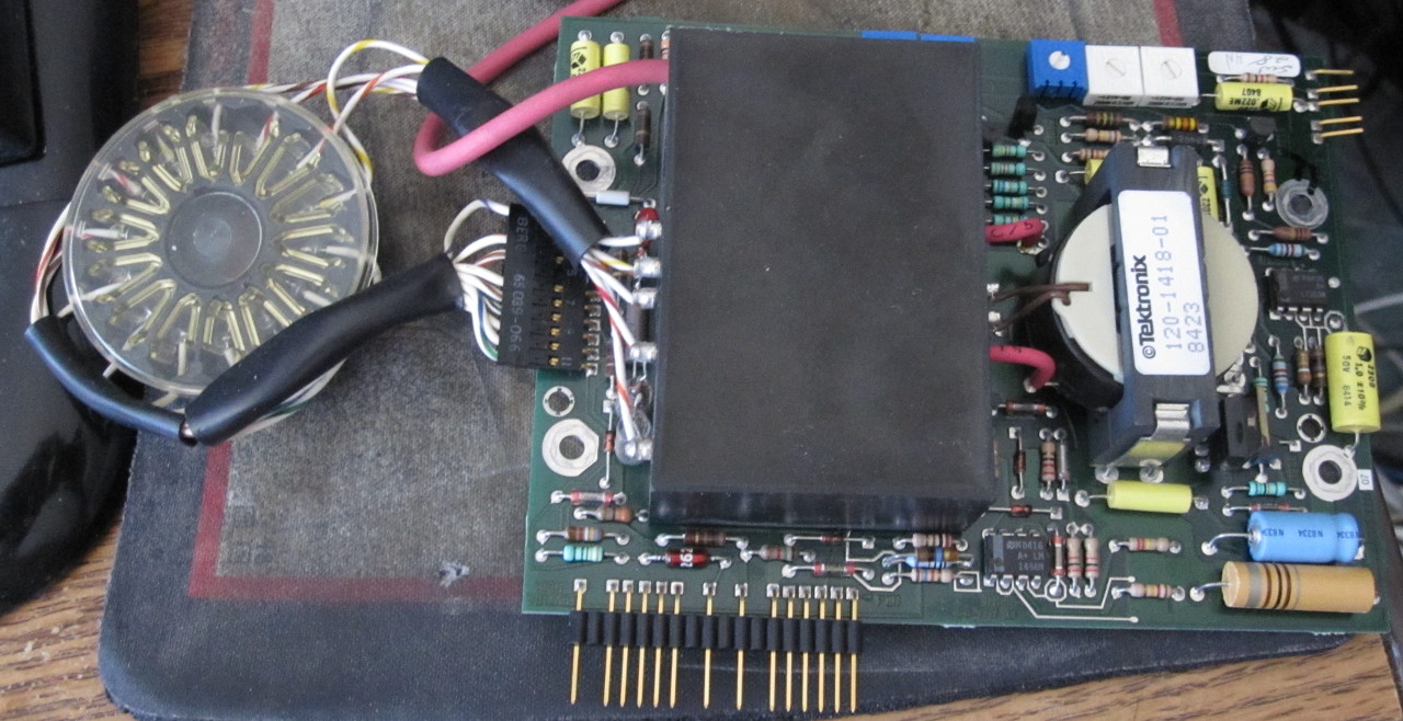

            Re: bent neck CRT pins...
            HV circuit pr0n
            It looks OK still...
            Need to look for schematics that match this board... the ones I found were close but not identical. The resistors in the lower left look a bit toasty but can't tell what they were from the schematics I found.
              The HV PSU supposedly should work at 15V 750mA (at least the original fuse was 750mA). Initially I tried a 500mA slow blow fuse (did not have a 750mA 5x20mm fuse, so I used clips and extension to a 1.25" fuse), the slow blow fuse got red hot and burned. The 40 ohm resistor instead of the fuse pretty much had all 15V across it.,.
              A quick ohming out the tube base pins didn't imply any shorts other than the currently intact heater.
              I tried powering the PSU from a bench psu and it does not seem shorted... The mystery continues. Then again I did not power the regulation circuitry which may be shutting the HV off and thus not appear to short; may have to fake that by plugging in feedback voltage or by using multiple supplies.
              Is it typical for TVs to actually regulate HV output? Looking at the schematic, there is indeed negative feedback voltage regulation. Based on the number of precision resistors on this board, this has to be very delicate stuff... A power supply (unlike PC power supplies, etc...)

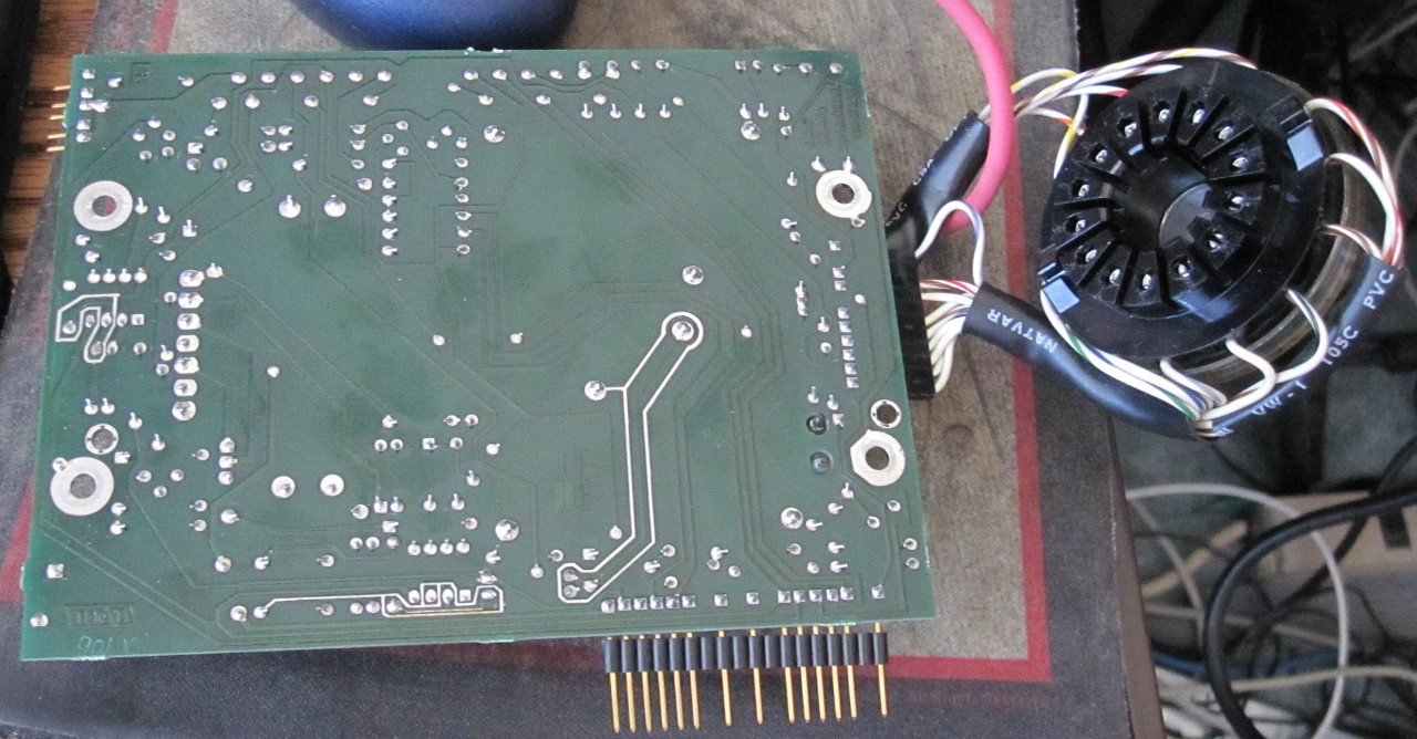

                                    #37
                                    Ahh... I found schematics and placement information that's closer than found in the service guide; it looks like a later version of the board was in the device. Still no idea why it seems shorted when plugged in (light bulb in place of the fuse burns brightly) but without the PSU the light is out.
                                    When disconnecting the anode and cathode/filament (by the base socket), the light bulb still burns brightly.
                                    One oddity was that I hooked up my sencore to the "flyback" output (before the multiplier). At first I was getting a Q factor of around 9... Then after a bit of futzing with it, the meter got a Q factor of 29. I hope I don't have a fried flyback that has an intermittent short. I was testing in-circuit...
                                    Woah
                                    http://www.ebay.com/itm/TEKTRONIX-GB...-/272182368706 - What was Tektronix thinking? Look at the bodge job at the lower left of the board...
                                    Sigh... hope that I can fix mine somehow...

                                        #39
                                        The PSU is not oscillating at least with the 12W bulb as the DC "dim bulb tester." I used another scope to determine this However I wonder if I should up the wattage of that bulb...
                                        It uses a single TO220 PNP transistor as the oscillator, and uses same circuit topology as a Joule Thief, except power is taken from the secondary. This transistor is just to the lower/right of the 'flyback,' plastic body facing left. Negative feedback is done by changing the voltage on the feedback winding (on a Joule Thief, the feedback winding is connected to V+; on this circuit, an op amp output through a resistor.)
                                        The transistor does not appear shorted but apparently having trouble oscillating. I should check the feedback voltage, and assuming it works like a Joule Thief, ... hmm...
