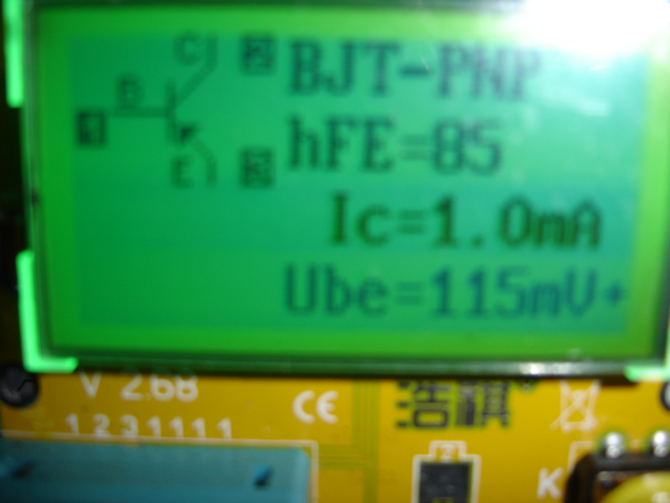

            Re: ESR meter upgrades
            Thank you all for your time and help.would not have got this far without it.
            Update,
            I decided to bite the bullet after multiple writing and erasing the chip think I tried every avrdude file I could, I fitted a new atmega 328p au smd chip and eureka it took the first firmware download,and this is the result. so may have a playround upgrading now it is working, what does the 16mhz upgrade achieve?
            John

              Congrats, nice solder work, used a hot air station I take it?

                • TEDDIBEAR
                  • Oct 2014
                  • 45
                  • england
                  #828
                  Yes you are spot on (hot air soldering) have been in the trade over 50 years so soldering is not a problem. Its programing I have problems with, but with help from all of you on this Forum I got a result, many thanks.
                  John

                    Great work TEDDIBEAR!
                    Glad you got it working
