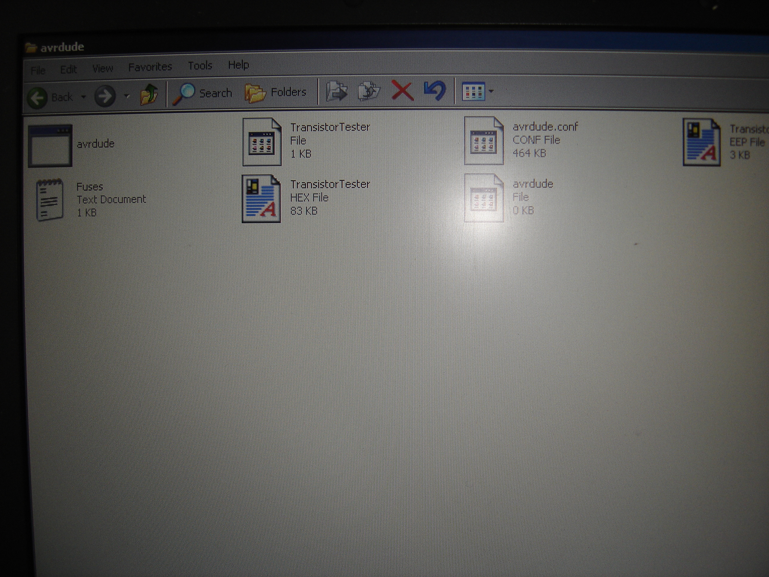

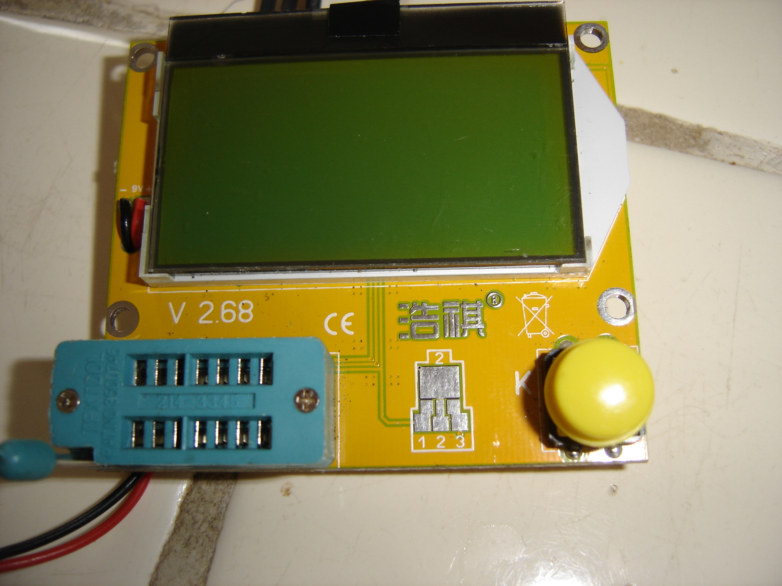

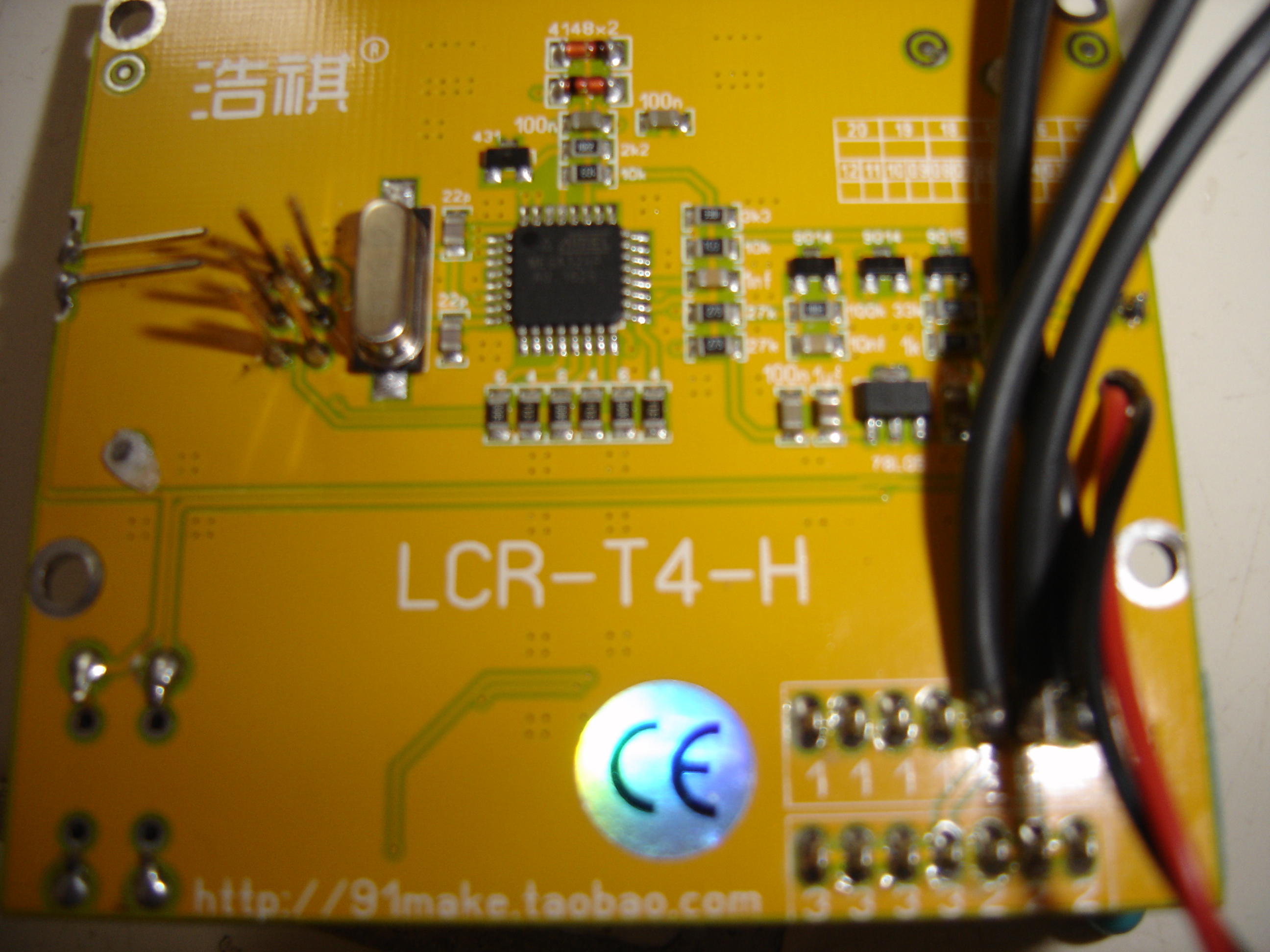

ESR meter upgrades
This is a sticky topic.
  • jondoe
    • Nov 2016
    • 547
    #801
    Re: ESR meter upgrades
    Have you placed the downloaded files into the same location as avrdude? That seems to be the issue you were having, avrdude couldn’t find the files, so the flash didn’t even start.
    • vinceroger69
      • Mar 2012
      • 6714
      • uk
      #802
      Re: ESR meter upgrades
      Originally posted by TEDDIBEAR
      Thanks to all for your help,and to Stj for finding the error, unfortunately being very new to using usbasp I am having trouble after downloading program transfering it to avrdude files, what files would I need to add to this (
      avrdude -c USBasp -P usb -p m328p -U flash:w:TransistorTester.hex \-U eeprom:w:TransistorTester.eep \-U lfuse:w:0xf7:m \-U hfuse:w:0xd9:m \-U efuse:w:0xfc:m) to get the flash for mcu to except, sorry if I sound a bit thick
      but I have been told this can not be done, only through arduino, by local computer engineer, but I think you guys know a lot more than he does.
      John
      Maybe check this video from about 11.30 onwards not sure if it will help you though
      https://www.youtube.com/watch?v=J_LY...dex=76&list=WL
        Great Sage é½Šå¤©å¤§č–
        • 31137
        #803
        Re: ESR meter upgrades
        the files must be in the same folder the command-line window is in.
        if the window is in root (/)
        you can move around with the "cd" command.
        like "cd Downloads"
          Great Sage é½Šå¤©å¤§č–
          • 31137
          #804
          Re: ESR meter upgrades
          Originally posted by TEDDIBEAR
          but I have been told this can not be done, only through arduino, by local computer engineer,
          tell him to stop calling himself an engineer - he's a fucking clown.
          USBasp is a dedicated AVR chip programmer - arduino is a learning toy.
            Great Sage é½Šå¤©å¤§č–
            • 31137
            #805
            Re: ESR meter upgrades
            o.k.
            flashing for beginners.
            make a folder on the drive called "flashing"
            extract the files into it.
            open the command-line up
            type "cd /flashing" hitting enter afterwards obviously.
            type "dir"
            you should see the extracted files.
            if you do then you can do the job - if not then post what happened.
            • Per Hansson
              • Jul 2005
              • 5895
              • Sweden
              #806
              Re: ESR meter upgrades
              Well, as he is running Windows it might be better to use paths that work in Windows?
              So if you open up the command prompt it will show you what directory it is in.
              Normally that would be the users home directory so for example C:\Users\Per
              If you have the files in "downloads" just change into that directory:
              cd Downloads
              And then run the avrdude command.
                Great Sage é½Šå¤©å¤§č–
                • 31137
                #807
                Re: ESR meter upgrades
                the problem is every windows is a bit different.
                (and progressivly worse with stuff more scattered - but that's a recovery issue)
                • TEDDIBEAR
                  • Oct 2014
                  • 45
                  • england
                  #808
                  Re: ESR meter upgrades
                  Thanks all for your help ref my possibly bricked LCR-T4 v2.68, thanks STJ for helping me to understand the basics and getting me up and running, ( analog brain in a digital world) lol.
                  I have managed to get AVRDUDE up and running have tried every Hex and eep file I can find including ones from this thread all to no avail, I still finish with a blank illuminated screen at the end, one thing I have noticed is this (avrdude: safemode:efuse changed was FC now 4. would you like this fuse to be changed back?) (y/n) if you press y it locks the program, if you press n it changes to 4, does this matter or have I Bricked the chip?
                  Code:
                  C:\avrdude>avrdude -c USBasp -P usb -p m328p -U flash:w:TransistorTester.hex \
                   eeprom:w:TransistorTester.eep \-U lfuse:w:0xf7:m \-U hfuse:w:0xd9:m \-U efuse
                  :0xfc:m
                  avrdude: warning: cannot set sck period. please check for usbasp firmware upda
                  avrdude: AVR device initialized and ready to accept instructions
                  Reading | ################################################## | 100% 0.09s
                  avrdude: Device signature = 0x1e950f
                  avrdude: NOTE: "flash" memory has been specified, an erase cycle will be perfo
                  ed
                       To disable this feature, specify the -D option.
                  avrdude: erasing chip
                  avrdude: warning: cannot set sck period. please check for usbasp firmware upda
                  avrdude: reading input file "TransistorTester.hex"
                  avrdude: input file TransistorTester.hex auto detected as Intel Hex
                  avrdude: writing flash (30078 bytes):
                  Writing | ################################################## | 100% 29.06s
                  avrdude: 30078 bytes of flash written
                  avrdude: verifying flash memory against TransistorTester.hex:
                  avrdude: load data flash data from input file TransistorTester.hex:
                  avrdude: input file TransistorTester.hex auto detected as Intel Hex
                  avrdude: input file TransistorTester.hex contains 30078 bytes
                  avrdude: reading on-chip flash data:
                  Reading | ################################################## | 100% 19.55s
                  avrdude: verifying ...
                  avrdude: 30078 bytes of flash verified
                  avrdude: safemode: Fuses OK (E:04, H:D9, L:F7)
                  avrdude done. Thank you.
                  C:\avrdude>
                  avrdude version 6.1, URL: <http://savannah.nongnu.org/projects/avrdude/>
                  C:\avrdude>avrdude -c USBasp -p m328p -U efuse:w:0xfc:m
                  avrdude: warning: cannot set sck period. please check for usbasp firmware update
                  avrdude: AVR device initialized and ready to accept instructions
                  Reading | ################################################## | 100% 0.02s
                  avrdude: Device signature = 0x1e950f
                  avrdude: reading input file "0xfc"
                  avrdude: writing efuse (1 bytes):
                  Writing |                          | 0% 0.00s ***faile
                  d;
                  Writing | ################################################## | 100% 0.11s
                  avrdude: 1 bytes of efuse written
                  avrdude: verifying efuse memory against 0xfc:
                  avrdude: load data efuse data from input file 0xfc:
                  avrdude: input file 0xfc contains 1 bytes
                  avrdude: reading on-chip efuse data:
                  Reading | ################################################## | 100% 0.00s
                  avrdude: verifying ...
                  avrdude: verification error, first mismatch at byte 0x0000
                       0x04 != 0xfc
                  avrdude: verification error; content mismatch
                  avrdude: safemode: efuse changed! Was fc, and is now 4
                  Would you like this fuse to be changed back? [y/n] y
                  Last edited by Per Hansson; 11-18-2017, 03:09 AM. Reason: Added CODE tags
                    Great Sage é½Šå¤©å¤§č–
                    • 31137
                    #809
                    Re: ESR meter upgrades
                    that 04/fc thing can be ignored.
                    some chips do that - it's fine.
                    • vinceroger69
                      • Mar 2012
                      • 6714
                      • uk
                      #810
                      Re: ESR meter upgrades
                      So the tester is still not working? still showing the blank illuminated screen at the end of programming?
                      • TEDDIBEAR
                        • Oct 2014
                        • 45
                        • england
                        #811
                        Re: ESR meter upgrades
                        So the tester is still not working? still showing the blank illuminated screen at the end of programming?
                        Must have tried every hex file out there they all loaded but still the same result.on switch on black full screen grid then illumination with blank screen.
                        perhaps I need the specific V2.68 firmware for this LCR-T4 which originally came with a couple of strange names on boot up, unfortunately all I can remember is it was something like Hoxin & ****.
                        John
                        • vinceroger69
                          • Mar 2012
                          • 6714
                          • uk
                          #812
                          Re: ESR meter upgrades
                          did you try tom66 firmware he posted in this thread about halfway down the page
                          https://www.eevblog.com/forum/testge...r-project/939/
                          Last edited by Per Hansson; 11-18-2017, 03:12 AM. Reason: Added URL tags
                          • jondoe
                            • Nov 2016
                            • 547
                            #813
                            Re: ESR meter upgrades
                            I went around in circles like this for a while with mine, I'm sure you'll get there. Going out on a limb here could it be the firmware isn't compatible with that LCD or that particular hardware? I note from the trunk there are three variants of the st7565
                            st7565/
                            st7565_kit/
                            wei_st7565/
                            https://www.mikrocontroller.net/svnb...oftware/trunk/
                            Click on the Rev. number for the file you want and save link.
                            • jondoe
                              • Nov 2016
                              • 547
                              #814
                              Re: ESR meter upgrades
                              I also found this thread, someone else in a similar situation as yourself.
                              https://www.eevblog.com/forum/testge...k-block-issue/
                              bonus Russian flashing his device, with links to files under the video
                              https://www.youtube.com/watch?v=bDHIITj1BZ4
                              Last edited by jondoe; 11-16-2017, 02:29 PM. Reason: extra link
                              • TEDDIBEAR
                                • Oct 2014
                                • 45
                                • england
                                #815
                                Re: ESR meter upgrades
                                Hi jondoe & vinceroger, yes have tried all of those, I think it could be a graphics fault with the chip as when a battery is attached and the button pressed it switches on with a illuminated full black matrix, which disappears after 2 seconds , the display then stays illuminated for one and a half minutes then switches off,
                                so it looks like something is happening behind the scenes, my next thought is replace the chip. any suggestions?
                                • jondoe
                                  • Nov 2016
                                  • 547
                                  #816
                                  Re: ESR meter upgrades
                                  Id start by trying to confirm the LCD controller/type. For the price of a replacement Atmel chip you might as well buy a different model and build it yourself!
                                    Great Sage é½Šå¤©å¤§č–
                                    • 31137
                                    #817
                                    Re: ESR meter upgrades
                                    replace the chip?
                                    how does that help find the right software??
                                    • TEDDIBEAR
                                      • Oct 2014
                                      • 45
                                      • england
                                      #818
                                      Re: ESR meter upgrades
                                      Originally posted by stj
                                      replace the chip?
                                      how does that help find the right software??
                                      It does'nt, I was only going down this road as trying all the software available with no success could the chip be faulty? as it does not seem to have any display only the full grid pattern for two seconds at switch on, could it be I am missing a file?
                                      I know I can buy a replacement cheaply, but when I get my teeth into a project I like to think I can achieve something ( with a little help of course).
                                      john
                                      • vinceroger69
                                        • Mar 2012
                                        • 6714
                                        • uk
                                        #819
                                        Re: ESR meter upgrades
                                        Originally posted by TEDDIBEAR
                                        It does'nt, I was only going down this road as trying all the software available with no success could the chip be faulty? as it does not seem to have any display only the full grid pattern for two seconds at switch on, could it be I am missing a file?
                                        I know I can buy a replacement cheaply, but when I get my teeth into a project I like to think I can achieve something ( with a little help of course).
                                        john
                                        maybe worth you also posting in the eev blog forum as few of use are members on there too hopefully someone on there has seen this problem before.
                                        • jondoe
                                          • Nov 2016
                                          • 547
                                          #820
                                          Re: ESR meter upgrades
                                          Originally posted by TEDDIBEAR
                                          It does'nt, I was only going down this road as trying all the software available with no success could the chip be faulty? as it does not seem to have any display only the full grid pattern for two seconds at switch on, could it be I am missing a file?
                                          I know I can buy a replacement cheaply, but when I get my teeth into a project I like to think I can achieve something ( with a little help of course).
                                          john
                                          You might go to the length of replacing the MCU and not be any better off as you can't confirm that is the failure. I'd suggest trying to flash each of the three variants for that LCD screen I posted earlier on (if you haven't already), if none of those three work out-of-the-box, consider compiling your own for each version.
                                          It might be worth, if you can see it, looking for the chip details for the LCD controller, it might be something completely different!
                                          • chth96
                                            Is it possible to test small ceramic disc capacitor with analogue meter?
                                            by chth96
                                            I read EBOOK of Testing Electronic Component and found that
                                            "In order to test the small blue resin coated ceramic disk capacitor which has 104 50v specification,it is possible to test this small ceramic capacitor by making use of analogue meter.
                                            Set to times 10Kohm that has 12v output from the probe to check disorder of ceramic capacitor.
                                            It is not uncommon that testing result of digital capacitance meter is okay,But It show shorted reading when you check it with analogue meter."
                                            Is it really possible to test small ceramic disc capacitor with analogue...
                                            03-09-2024, 10:03 PM
                                            Modification of a Fluke multi meter that uses three AA batteries to use a 14500 lithium ion battery
                                            by sam_sam_sam
                                            I have had with regular AA batteries that leak this meter is expensive new I already replaced the battery battery clips once and the same thing happened again and I am tried of so it is getting modified to accommodate lithium ion batteries that are the same size excluding the positive terminal and removing the battery clips I will have enough room for the BMS protection board
                                            I going to put 3 lithium ion battery in parallel with the BMS protection board and a way to charge the battery externally and heat shrink the battery pack and use a JST connector so I easily remove the battery...
                                            12-31-2023, 06:04 AM
                                          • jorpec
                                            Changing the scale of an analog meter
                                            by jorpec
                                            Hi
                                            I want to change the scale of an analog meter, to monitor the charge of an li-ion single cell, so the needle at the end would point 4.2 volts and the 0 on the meter would point 2.5 volts or so, i tried to add diodes or a zener in series with the meter but the changes of the ambient temperature also changes the voltage value on the meter
                                            I wonder how i can accomplish this so the meter would be precise at any temperature ?
                                            Thnaks
                                            01-23-2023, 10:37 AM
                                            How an incandescent light and a ESR meter ** friend**have a machine blowing fuses
                                            by sam_sam_sam
                                            About a month ago we had a transformer jumper wire that burned in two different places between two transformers caused over $200 thousand dollars worth of damage to VFD drives at least 10 of them and a memory card and quite a few power supply as well
                                            Now we have most of the equipment that got damaged back up and running except a feeder that has issues and we are waiting for some parts for
                                            Now we also have another piece of equipment that was blowing fuses on the 110 volt controller switch circuit with the ā€œEā€ stops and one switching power (24 volt) supply and a transformer...
                                            12-14-2023, 07:45 PM
                                          • irepair559
                                            ps4 1215 model Changed port and encoder still no video?
                                            by irepair559
                                            hi guys so i have this ps4 fat 1215 i believe ( the one with the ps4 pro/slim newer encoder ic ) so i replaced hdmi and 2 blown filters and still no pic so i replaced encoder and still no pic. i made sure port is solid even checked with a breakout hdmi and tested ground and data lines.. Filters are all good , though 2 of the newer ones are larger then the original ones i dont know if that matters ?
                                            Made sure under the scope encoder pins all look solid went over with fine tip and solder again. Idk but this thing is stressing me out..
                                            ps4 seems to boot fine blue light then solid...
                                            01-01-2023, 12:41 AM
