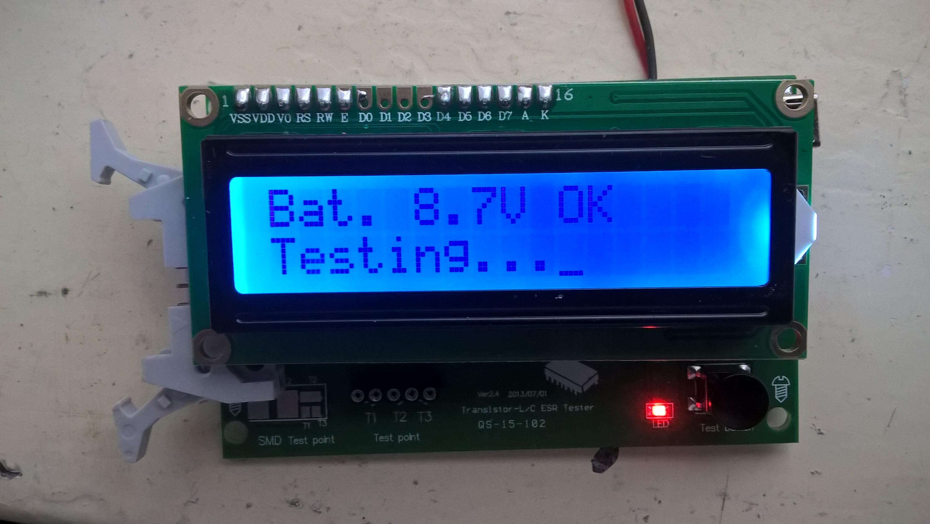

      Re: ESR meter upgrades
      using that method seems to work tried both of your files the strip grid does nothing really just lights the screen with some odd blocks now the first file seems to work says battery ok then testing then timeout! then goes off
      so not strip-grid.
      o.. i'll build a better file later.
      dies it give the battery voltage on the display?
      if it does, hook a voltmeter to the battery wires, and give me both voltages - read at the same moment.

        battery voltage on display reads 8.7v tested with mm 8.7v so thats ok i have enclosed a picure of what the screen shows when its just aboout too turn off .

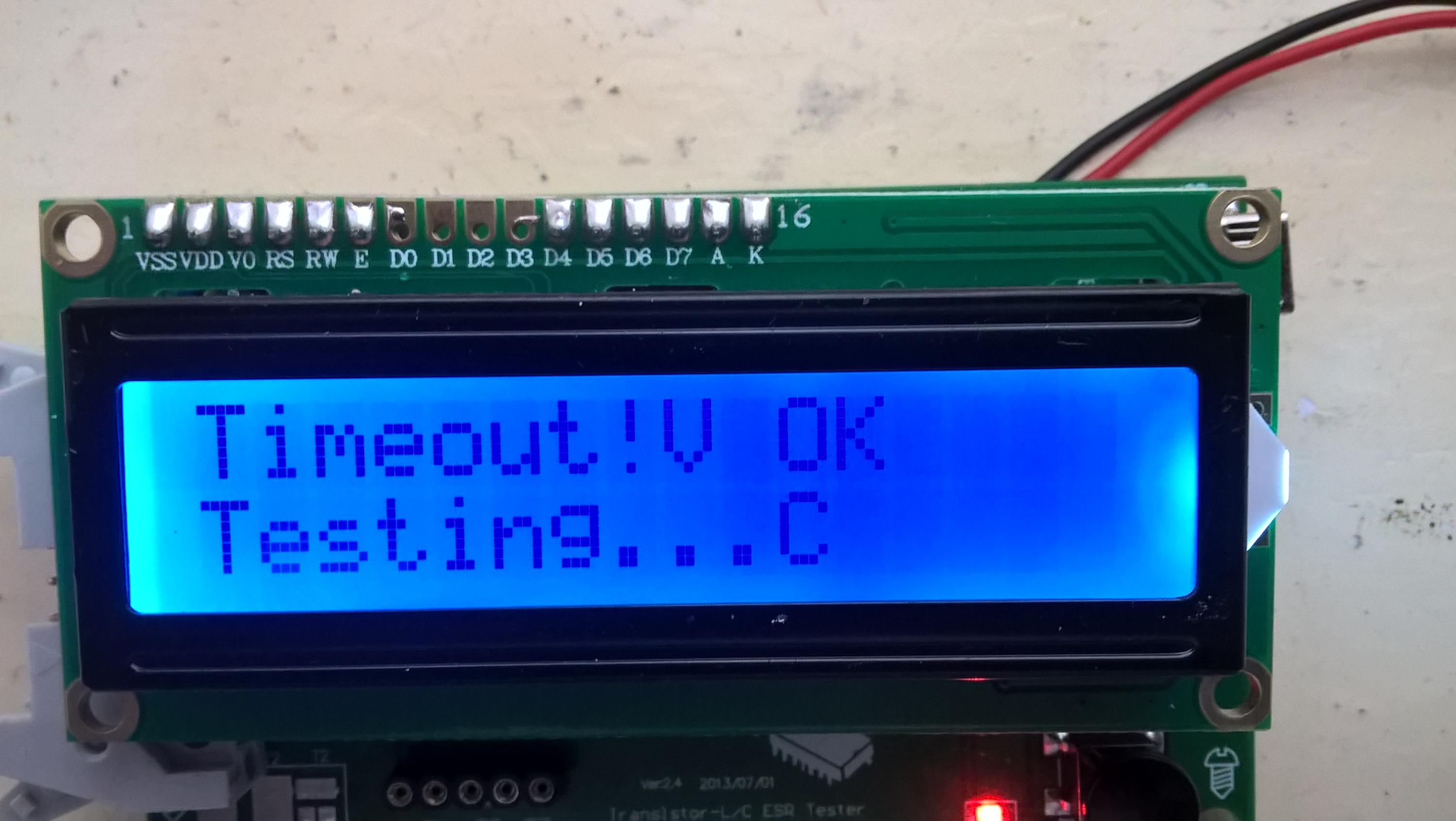

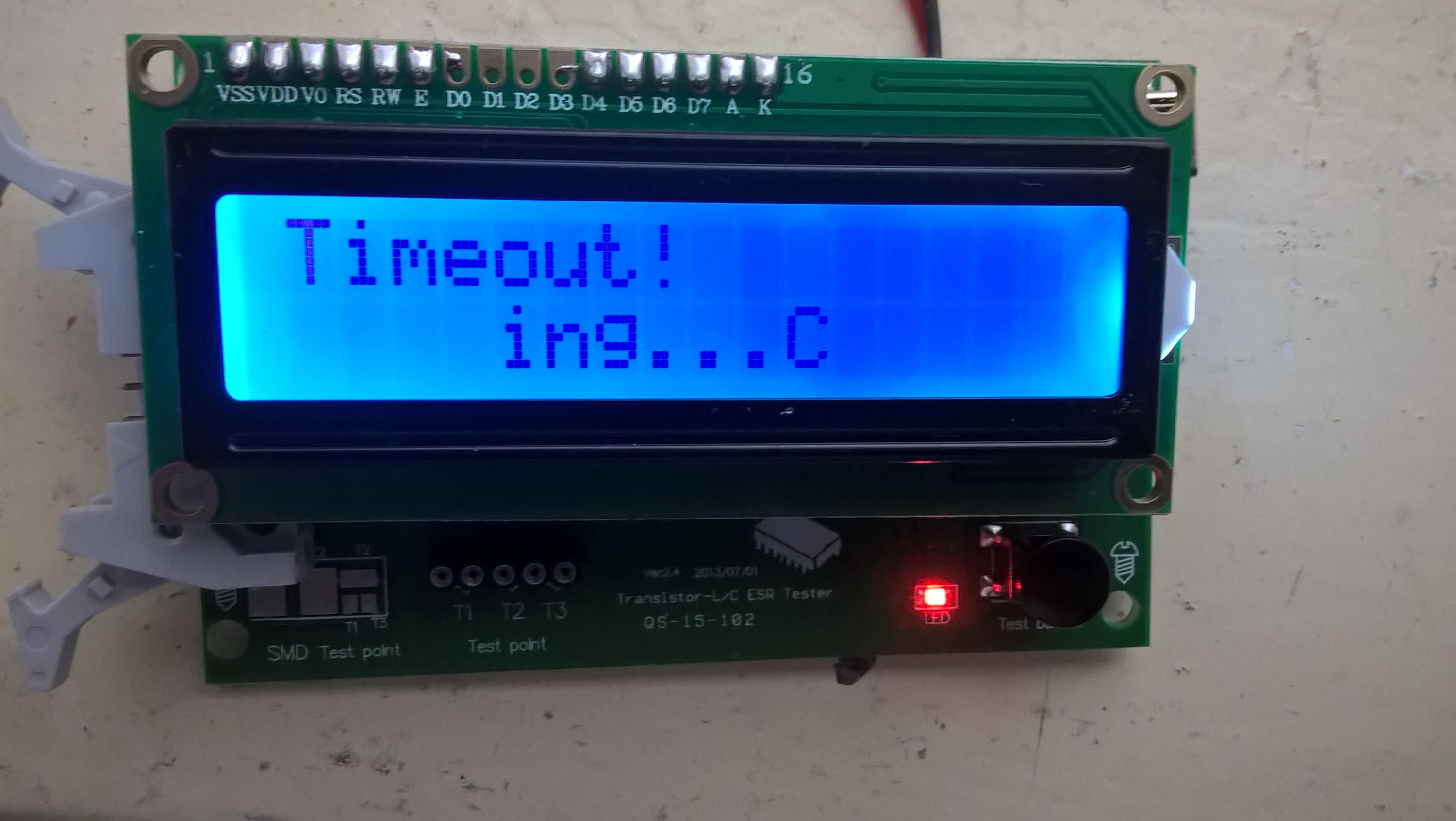

          strange, i wonder if it thinks the display has more lines - never seen a timeout text before.
            i think it does think that so may have 2 issues the timeout one where tester goes off and display issue heres two more pictures ive managed to take
              no, i found out that "timeout" is a watchdog warning.
              it means the cpu crashed or went off doing something it shouldnt.
              try this.
                Thanks stj that file works great ive just calibrated it and will test some parts asap but for now it seems to work ok thanks again stj for your help with my tester ive learnt a lot ie using avrdude etc and gained more experience in smd soldering as that surface mount atmega ic was so small and having too add the capacitors and crystal took some patience.
