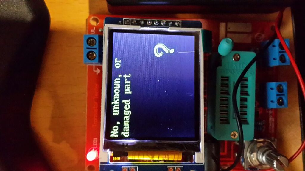

    Update After that I inserted the reprogrammed chip into the tester and still it stays on for about 3 to 4 seconds then it turns off
    Thanks again

              Got some errors
              Now back to square one the LCD lights up as long as I got the button pressed. Else it stays off

                    OMG!!!!!!!!
                    I had almost gave up!
                    I owe you big time!!!
                    Thanks Thanks Thanks!!!
                    Now I nee to go through the calibration process
                    As I said to Vince I do know a lot about photography so if by any chance you happen to have any question regarding that you got yourself a slave hehehe
                    Thanks again!!!! Really I do not have words for you that kept up with me.

                                          #580
                                          Re: ESR meter upgrades
                                          Dear Vince and sjt
                                          Again thank you so much for your time and effort
                                          I'm sorry it took me this much to put the tester into operation. At the beginning I had not one but 2 USBasp's but since I was having an issue with the timing I read that I should upgrade the firmware which I did with both of them and now I do not know why they are not recognized anymore That is why I had to switch to arduino as ISP. I think I messed those both up. again it has to do with the fuses again although I burned them as indicated in this page
                                          http://blog.lincomatic.com/?p=1480
                                          Now When I try to read it's configuration I got this problem so they are useless to me now
                                          Code:
                                          C:\Program Files (x86)\Arduino\hardware\tools\avr\bin>avrdude -C ../etc/avrdude.
                                          conf -c avrisp -P COM3 -b 19200 -p m8 -v
                                          avrdude: Version 6.0.1, compiled on Apr 15 2015 at 19:59:58
                                               Copyright (c) 2000-2005 Brian Dean, http://www.bdmicro.com/
                                               Copyright (c) 2007-2009 Joerg Wunsch
                                               System wide configuration file is "../etc/avrdude.conf"
                                               Using Port          : COM3
                                               Using Programmer       : avrisp
                                               Overriding Baud Rate     : 19200
                                               AVR Part           : ATmega8
                                               Chip Erase delay       : 10000 us
                                               PAGEL             : PD7
                                               BS2              : PC2
                                               RESET disposition       : dedicated
                                               RETRY pulse          : SCK
                                               serial program mode      : yes
                                               parallel program mode     : yes
                                               Timeout            : 200
                                               StabDelay           : 100
                                               CmdexeDelay          : 25
                                               SyncLoops           : 32
                                               ByteDelay           : 0
                                               PollIndex           : 3
                                               PollValue           : 0x53
                                               Memory Detail         :
                                                           Block Poll        Page
                                             Polled
                                                Memory Type Mode Delay Size Indx Paged Size  Size #Pages MinW Max
                                          W  ReadBack
                                                eeprom     4  20  128  0 no    512  4   0 9000 90
                                          00 0xff 0xff
                                                flash     33  10  64  0 yes   8192  64  128 4500 45
                                          00 0xff 0x00
                                                lfuse     0   0   0  0 no     1  0   0 2000 20
                                          00 0x00 0x00
                                                hfuse     0   0   0  0 no     1  0   0 2000 20
                                          00 0x00 0x00
                                                lock      0   0   0  0 no     1  0   0 2000 20
                                          00 0x00 0x00
                                                calibration  0   0   0  0 no     4  0   0   0
                                           0 0x00 0x00
                                                signature   0   0   0  0 no     3  0   0   0
                                           0 0x00 0x00
                                               Programmer Type : STK500
                                               Description   : Atmel AVR ISP
                                               Hardware Version: 2
                                               Firmware Version: 1.18
                                               Topcard     : Unknown
                                               Vtarget     : 0.0 V
                                               Varef      : 0.0 V
                                               Oscillator   : Off
                                               SCK period   : 0.1 us
                                          avrdude: AVR device initialized and ready to accept instructions
                                          Reading | ################################################## | 100% 0.03s
                                          avrdude: Device signature = 0x00ff00
                                          avrdude: Expected signature for ATmega8 is 1E 93 07
                                               Double check chip, or use -F to override this check.
                                          avrdude done. Thank you.
                                          Second it was the first time I has to use AVRdude, and yes I realize I do have a LOT to learn. And again I appreciate your time and effort and somehow read the manual so now I know the many mistakes I did.
                                          Since I did a lot of them I might be able to do the video to help others.
                                          Besides in the first place I shouldn't be doing all that if the chip would have come programmed as it should be.
                                          Anyway let me know if you are interested although I know about photography I do not know nothing on video editing.
                                          Thanks again
                                          Belen
