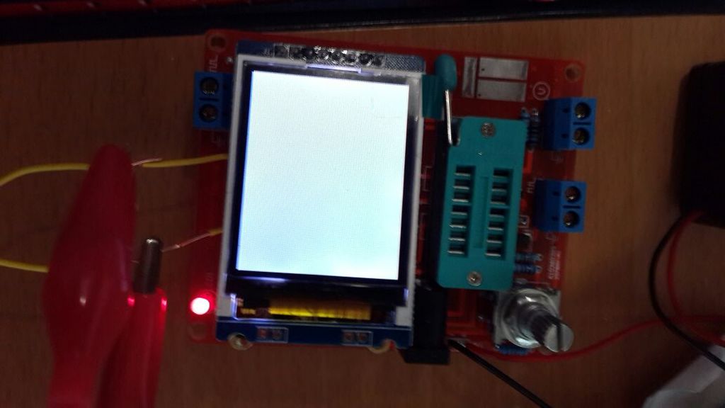

                  Dear guys
                  I got somehow a success
                  I was able to upload the firmware and now the display stays lit ans the led too but still nothing shows on the display just blank
                  This was my result o the programming
                  Code:
                  C:\AVR>avrdude -c USBasp -P usb -p m328p -U flash:w:Code.HEX \-U eeprom:w:Data.H
                  EX \-U lfuse:w:0xf7:m \-U hfuse:w:0xd9:m \-U efuse:w:0xfc:m
                  avrdude: AVR device initialized and ready to accept instructions
                  Reading | ################################################## | 100% 0.01s
                  avrdude: Device signature = 0x1e950f
                  avrdude: NOTE: "flash" memory has been specified, an erase cycle will be perform
                  ed
                       To disable this feature, specify the -D option.
                  avrdude: erasing chip
                  avrdude: reading input file "Code.HEX"
                  avrdude: input file Code.HEX auto detected as Intel Hex
                  avrdude: writing flash (29702 bytes):
                  Writing | ################################################## | 100% 18.81s
                  avrdude: 29702 bytes of flash written
                  avrdude: verifying flash memory against Code.HEX:
                  avrdude: load data flash data from input file Code.HEX:
                  avrdude: input file Code.HEX contains 29702 bytes
                  avrdude: reading on-chip flash data:
                  Reading | ################################################## | 100% 11.40s
                  avrdude: verifying ...
                  avrdude: 29702 bytes of flash verified
                  avrdude: safemode: Fuses OK (E:01, H:DF, L:F7)
                  avrdude done. Thank you.
                  and this is how it is now
                  I'm sorry for the clips on the side but those were the cables I soldered to be able to attach and detach the crystal I did not knew I could use a 16 mhz one until today and I had already took that one out.
                  Meanwhile I receive an answer I'm going to solder the crystal back onto the tester.
                  Thank you all again
                  Belen

                    • 31254
                    #529
                    Re: ESR meter upgrades
                    go do it again - the fuses didnt get programmed.
                    copy & paste from this:

                                  With arduino as ISP programmer both the chip that came with the tester and a new black chip I get this
                                  Code:
                                  C:\Program Files (x86)\Arduino\hardware\tools\avr\bin>avrdude -C ../etc/avrdude.
                                  conf -c avrisp -P COM3 -b 19200 -p m8 -U flash:w:TransistorTester.hex \-U eeprom
                                  :w:TransistorTester.eep \-U lfuse:w:0xf7:m \-U hfuse:w:0xd9:m \-U efuse:w:0xfc:m
                                  Reading | ################################################## | 100% 0.04s
                                  avrdude: Device signature = 0x000000 (retrying)
                                  Reading | ################################################## | 100% 0.03s
                                  avrdude: Yikes! Invalid device signature.
                                       Double check connections and try again, or use -F to override
                                       this check.

                                    I'm getting a bit frustrated in here...
                                    this check.
                                    sorry but i have not used avrdude etc yet for my ic i used a tl866 programmer the only other way that may work is adding the header and soldering wires direct to the ic socket etc, stj has some pictures regarding this as im also going to try programming this way myself in the future using avrdude etc but im reading up on the programming side of things at the minute.
                                    just a thought with your crystal are you using 22pf capacitors as well? when your programming the ic

                                      this is exactly the type of bullshit that happens when people try to program chips off-board instead of in-circuit.
                                      btw:
                                      C:\AVR>avrdude -c USBasp -P usb -p m328p -U efuse:w:0xfc:m
                                      avrdude: reading input file "0xfc"
                                      avrdude: writing efuse (1 bytes):
                                      Writing | | 0% 0.00s ***faile
                                      d;
                                      Writing | ################################################## | 100% 0.04s
                                      avrdude: 1 bytes of efuse written
                                      avrdude: verifying efuse memory against 0xfc:
                                      avrdude: load data efuse data from input file 0xfc:
                                      avrdude: input file 0xfc contains 1 bytes
                                      avrdude: reading on-chip efuse data:
                                      Reading | ################################################## | 100% 0.00s
                                      avrdude: verification error, first mismatch at byte 0x0000
                                      0x04 != 0xfc
                                      avrdude: verification error; content mismatch
                                      avrdude: safemode: efuse changed! Was fc, and is now 4
                                      Would you like this fuse to be changed back? [y/n] y
                                      is a newer chip, 04 instead of FC is fine.
                                      so with that chip, do:
                                      avrdude -c USBasp -P usb -p m328p -U efuse:w:0x04:m

                                        I rebooted the computer and connected the arduino to another USB port and now I'm getting this using Arduino ISP as programmer.
                                        Code:
                                        conf -c avrisp -P COM3 -b 19200 -B8 -p m8 -U flash:w:TransistorTester.hex \-U ee
                                        prom:w:TransistorTester.eep \-U lfuse:w:0xf7:m \-U hfuse:w:0xd9:m \-U efuse:w:0x
                                        fc:m
                                        avrdude: Expected signature for ATmega8 is 1E 93 07
                                             Double check chip, or use -F to override this check.

                                          Dear sjt I really appreciate all your help and I'm sorry if I seem stupid or dumb in here.
                                          I'm trying to learn in here and I got no clue of AVR programming besides arduino. I'm learning and reading as much as I can to be able to fix this issue.
                                          To be able to program the chip in circuit I believe I would either have to solder some wires to the chip or have an ICSP header on the circuit right? which I do not have in this circuit.
                                          Thanks again for all your help
