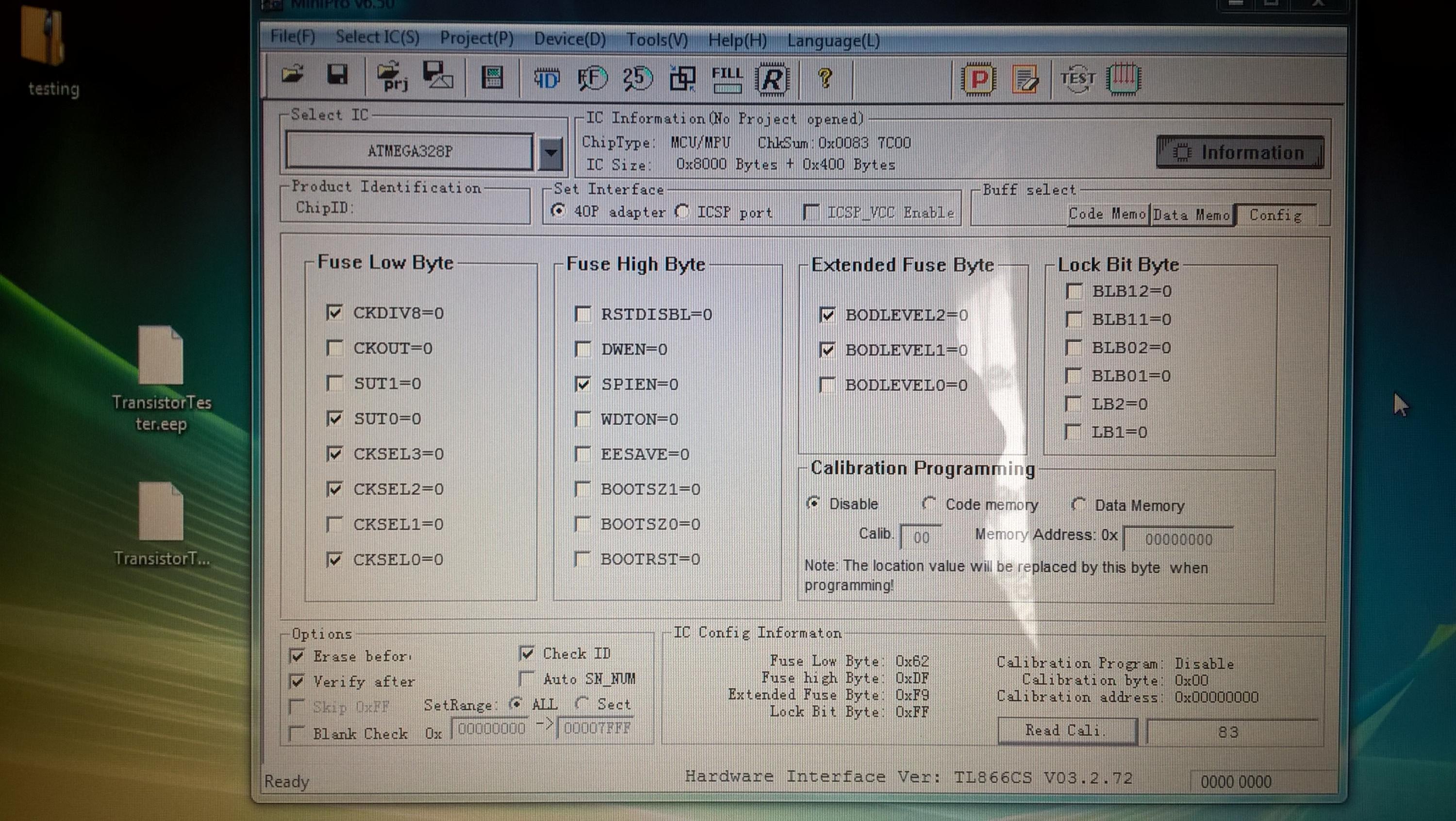

              #326
              Re: ESR meter upgrades
              dave from eeblog has a good you tubevideo on this programmer minipro tl866cs
              https://www.youtube.com/watch?v=FLG03f_ua5g
              i will take a picture of the screen now about the fuses etc

                • 31095
                #327
                what a pain.
                o.k.
                play with those tick boxes to get the low-fuse to F7
                and the high-fuse to D9
                and the extended fuse to FC

                  #328
                  fuses was easy too set up as per your guide still scrolling display with one of your zip files and just a blank display with the other zip file
                  just a thought stj when adding your files i can add them as code memo or data memo which one is correct?
                    • 31095
                    #329
                    hex is code, eep is data - you need both because the fonts are in the eep file!

                      #330
                      ok will try again lol as was putting both in code
                        • 31095
                        #331
                        that explains it, you had the display but no fonts!

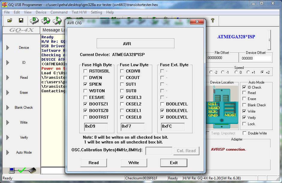

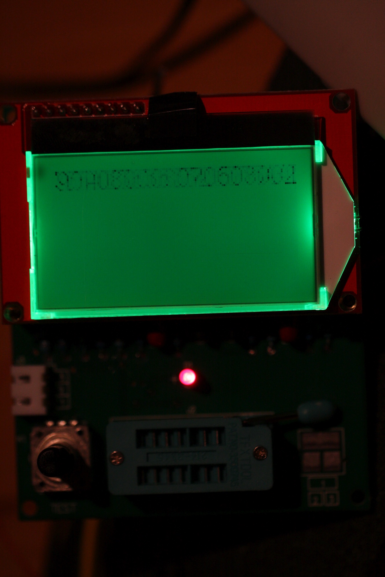

                                        #339
                                        Finally mine arrived too!
                                        I've got the same as vinceroger69, with the firmware from this post I get scrolling characters on the screen when I power on.
                                        With the other firmware from this post it is blank.
                                        The chip did contain a few bytes of code when I got it but for sure it was not a complete program.
                                        The programmer acted like it was empty; like vinceroger69 explained in this post. (I attached what was there in the rar file).
                                        With the scrolling text I can't do anything, if I press the encoder nothing happens, I need to remove the battery to power off.
                                        The LCD is marked LCM_12864_V1.30 2015.09.01
                                        I attached pictures showing the scrolling text and of the LCD backside.
                                        I used a Willem GQ-4X USB Programmer to program the chip and set the fuses.
                                        (I had to do a "Erase" first which I did not at first realize, took many attempts until I found out that was the problem because the program never got written properly, I did the programming in circuit.)
                                          • 31095
                                          #340
                                          o.k. i'l go look at the code.
                                          i think the pinout is o.k. or the display wouldnt be on.
                                          so probably a different chip in it.
                                          try this
