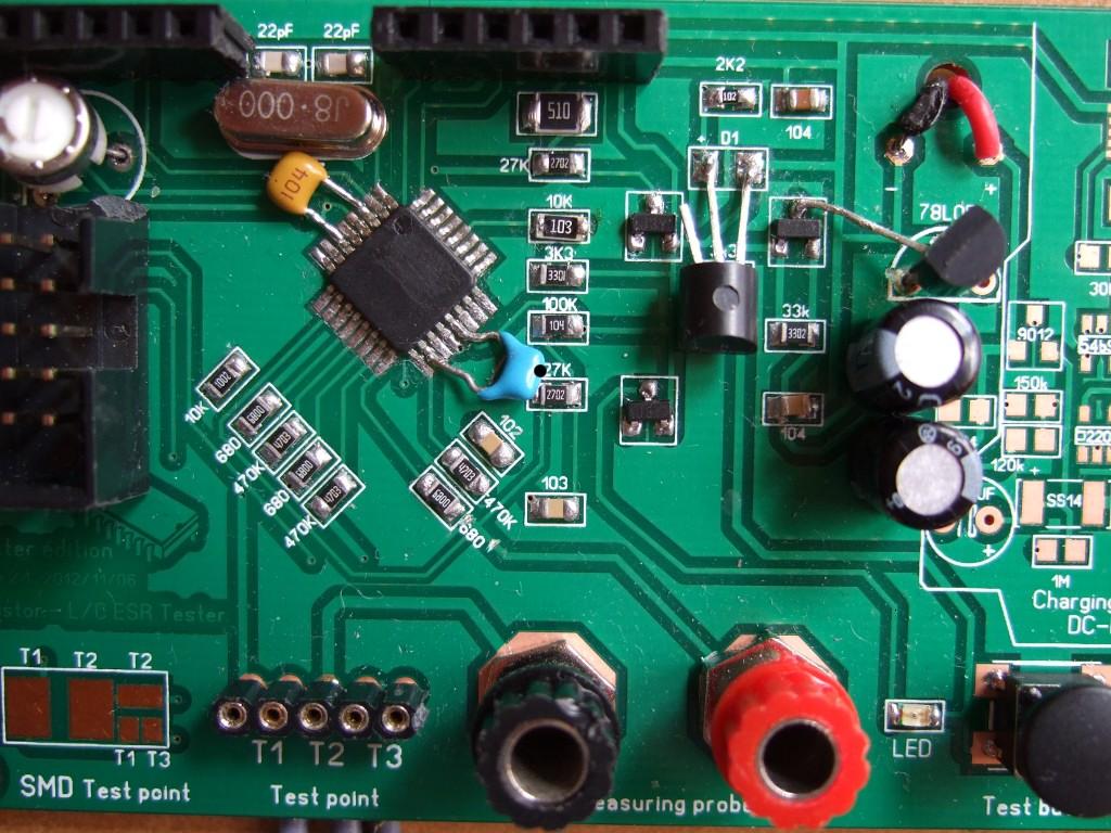

    Re: ESR meter upgrades
    that's it, the 2.5v reference.
    the pullup *if it's fitted* needs to be replaced by a 2k2 resistor.
      no resistor fitted at all in R16 spot
        part numbers mean nothing on that board - that r16 is related to a battery charger.
        use your meter to resistance-check between pin27 and 5v (pins 4 or 6)
        if it's over 100k then we assume there is no resistor.
        check with probes both ways.
          0.14 both ways on 200k this is the picture ive been looking at on eeblog same meter hes removed the D1 and fitted the lm 4040 there? this is where im lost where too place it please remember stj im learning as im going my board has version 1.05k on it as just ran a self check
            actually, your right - it is that diode.
            so do what he did - just do it neater
            now i want to know why he fitted a couple of caps on the cpu.
            i have to go check the pdf.
              thanks stj i was getting confused too it looks like he has left one leg of the lm4040 un connected to anything? tom66 mentions in the thread about those caps too not sure what they do though? its a long thread on eeblog this one catching up but hey im learning so alls good.
                lm4040 pin1 is not used.
                just cut it off.
                those caps he added are .1uf across the power for extra smoothing.
                he also changed the 78L05 regulator for something better.
                    just remember the pin numbers on the pdf may be for the 28pin dil package.
                    here is a schem of a GM328a showing how your kits probably are - or atleast close to.
                          you swap it with the ??431
                          BUT the pins are not in the same place,
                          you need to cut one pin off the LM4040 and then put it in offset to one side.
