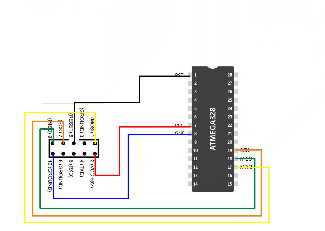

              stj a question rather than add a header to the pcb for upgrading the files to the tester could i use one of these? as ive been offered one for free if i go and collect it and it may make the upgrades easier for me as ive never done programing before

                    Re: ESR meter upgrades
                    well tbh the 10pin header is a lot simpler than constantly removing the display and pulling the chip.
                    it makes no difference to *how* it's programmed - it just saves stripping the unit to get at the programming signals.
                    you should fit the header and grab the 866 for other things.
                          Hi thanks for the info stj another question for now have you got a diagram to where to solder the wires for the 10 pin header wires too as hopefully parts will have been delivered today.
                                  ive got 5 crystals so alls good the caps ive just ordered is there a guide which pins etc to connect the crystal and caps to my tester in picture one thanks again
                                    these probably help

                                      #278
                                      Originally posted by stj
                                      these probably help

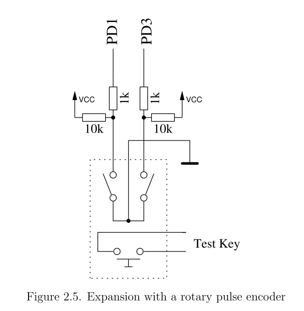

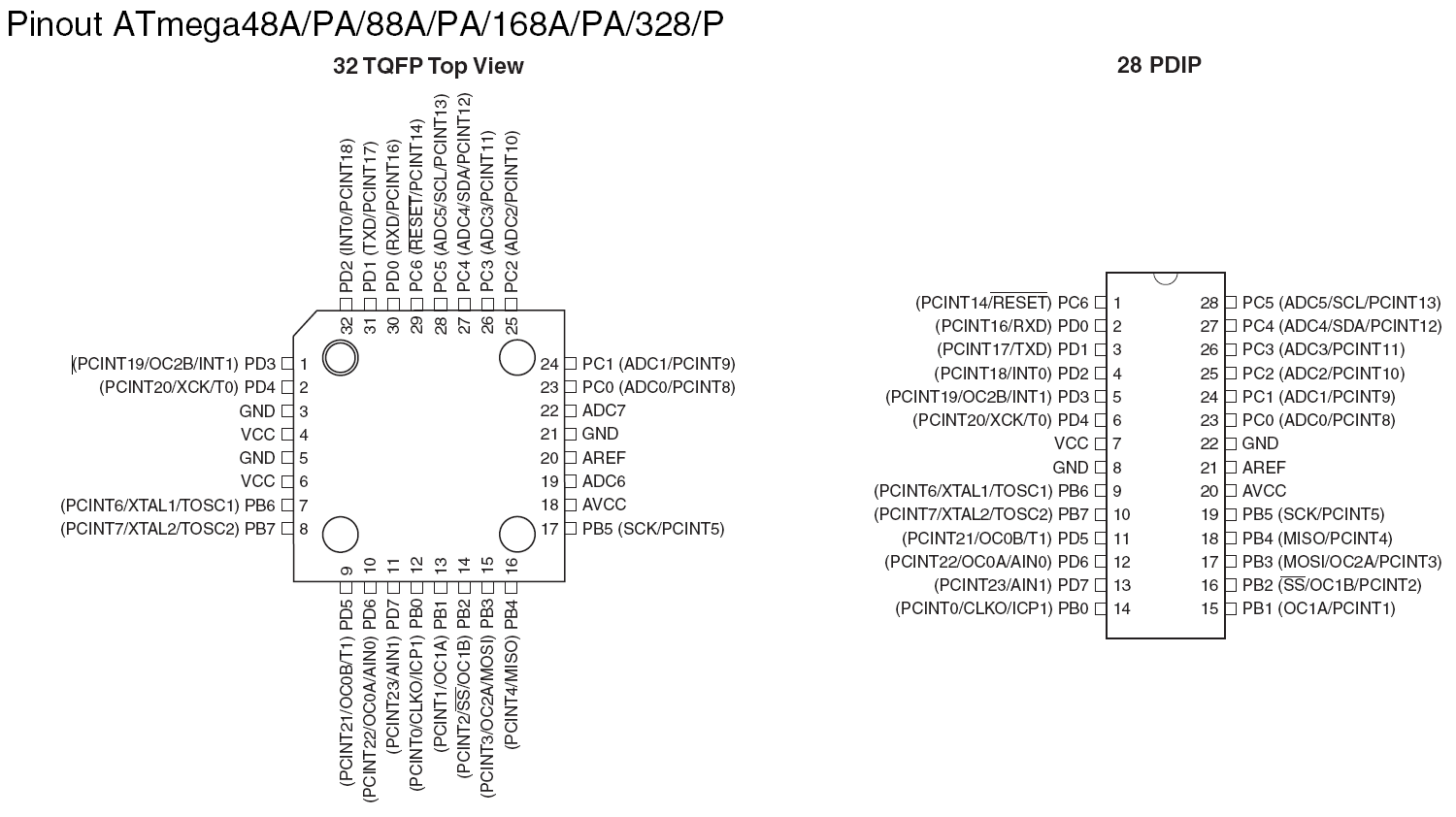

                                      Thanks it sort of helps (im still la newbi remember with electronics ) so crystal legs to pb6 and pb7 with a 22p capacior on each leg to ground?
                                        no, dont know how you came up with that.
                                        crystal to xtal1,xtal2 (pb6, pb7)
                                        keep the wires short.
                                        personally i would use a pair of smd caps and just solder them between the pins on the actual crystal can.
                                        pd1,pd3 are the rotary encoder mod!
