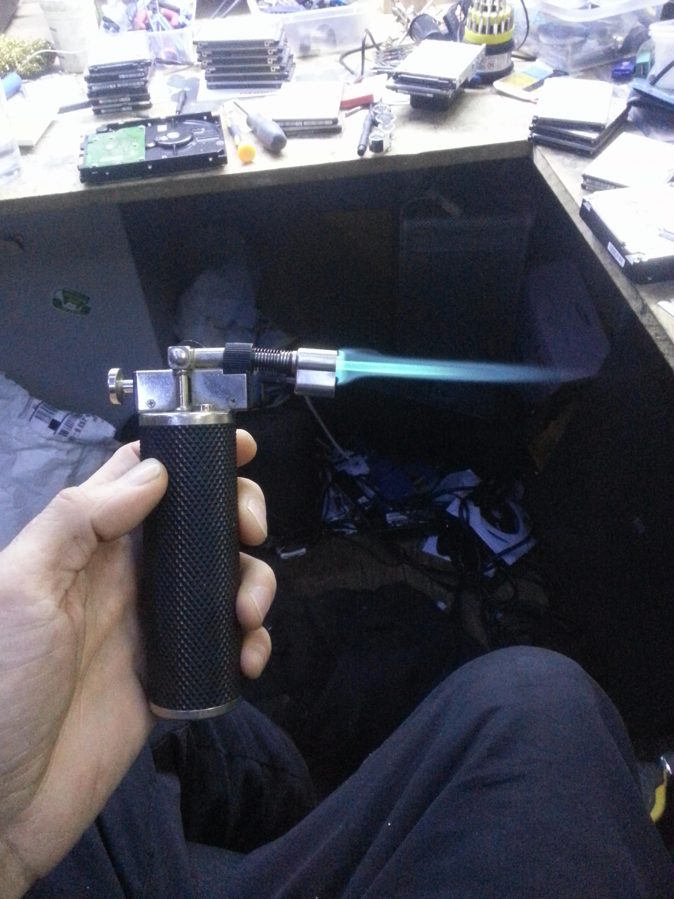

                              Re: Butane pen torches?
                              I use one from time to time as well. But only those which are actually cigar lighters even though here they sell them as soldering torch lol. They never handle such usage if you use them regularly for even two years. I RMA'd couple of them than just broke the vent on the bottom and added more pressure. I think the flamers get obstructed over time, carbon maybe.
                              I tried those chinese aluminium, long pen-like torches. Blue sticker (which colors everything it touches). Their bloody filling vent is made so stupid than when you pressure butane bottle into them, you just press the whole frelling vent inside. The result is all the gas vents and it's screwed. Because the went is just pressed in a tube. I managed to solder one, it works since. Just a stupid beginner design flaw…
