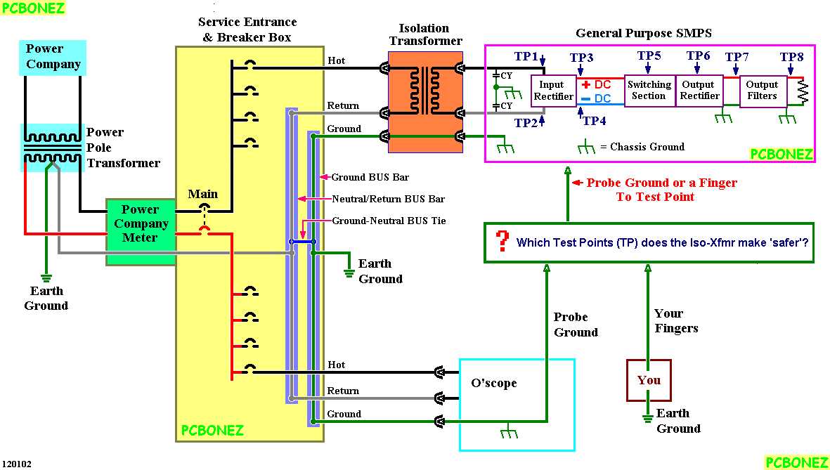

                    Thanks for making me think but I'm still not buying the story.
                    - If I have a GCE somewhere in my thinking then point it out.
                    Here goes...
                    Wire either side of the Iso-Xfmr secondary to ground and tell me what happens.
                    You seem to be trying to tell me it magically isn't going to pass AC current to ground.
                    I'm thinkin' it will.
                    Your whole theory is based on two misconceptions.
                    #1 - One side of a rectifier isn't -always- 'at ground'.
                    #2 - A negative voltage -IS- a 'HOT'. - If it will shock you, it's a HOT.
                    Looks to me like:
                    "Wire the negative side of the primary filter caps to earth ground"
                    is going be the exactly same in a modern SMPS regardless of an Iso-Xfmr.
                    There is a chassis/earth ground between CY1 and CY2 before the rectifier so adding a transformer is not going to change anything at all.
                    All the Iso-Xfmr seems to be doing is forcing the neutral before the rectifier to be below ground potential. If anything that's MORE dangerous.
                    Either way [Iso-Xfmr or not] the DC negative side of that rectifier is below earth ground potential. [A negative voltage to ground is STILL a 'HOT'.]
                    - The CY caps arrangement sets the ground reference and ensures that.
                    Either way [Iso-Xfmr or not] connecting ground to either side of the rectifier it will cause a short because BOTH sides of the rectifier are HOT relative to earth ground.
                    [BOTH sides of the rectifier are HOT. - WHY would anyone connect a ground straight to a HOT?]
                    Avoiding the problem you think is there is easy.
                    Always connect the scope ground leads to earth ground.
                    If you need to check a + HOT to a - HOT [or any two HOTs + or - ] then use two leads and use 'add'. [Invert as necessary.]
                    It's not that hard.
                    Since it's DC in this case using the right tool [a DMM] would be even better.
                    That's how I was taught and probably why I couldn't see where you thought there was a problem.
                    I never connect a scope ground to a HOT [negative or positive] in the first place so the problem is a non-issue.

                      #90
                      Re: Oscilloscope
                      Originally posted by godin View Post
                      Do you mean an isolation transformer that floats the ground too and just leaves a floating AC with no ground connection to the neutral?
                      Yes.

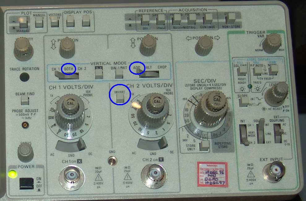

                            With your 2 Channel scope you should never need one.
                            If you ever have to measure a HOT to a HOT use two probes both with grounds to earth ground.
                            Both + ADD with no Invert on CH2 will display the total.
                            Both + ADD with Invert on CH2 will display the difference.

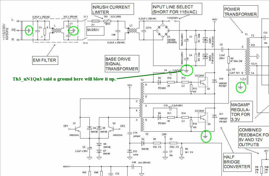

                              Depends on which waveform you are looking at.
                              The PWM probably references to earth ground.
                              The OP of the switchers could probably be measured on the secondary side just as well - and do the math for the xfmr.
                              Beyond that you'll have to look at what you're working on in greater detail because they aren't all as 'ungrounded' as people seem to think they -all- are.
                              They can all be different. [See Pic].
                              The one in the Pic shows an earth ground right where Th3_uN1Qu3 says connecting a ground would blow it up.
                              That doesn't mean he's wrong for all PSUs though. - Or even most..
                              There's just too many different designs to generalize something like that one way or the other.
                              Worst case is you measure both sides to ground and do the math.

                                Me too, confused as hell. I can't see the problem with the smps but bow to greater knowledge.
                                How come if it is earth and not possible to clip to is it not a shock hazard on the casing? Thinking specifically of a PC power supply.
                                If you connect your scope clip to ground and not anything above ground what can be the problem. I am missing something!
                                If a filter cap is passing AC to ground then ground must be ground.... mustn't it?
                                If you float with an isolation transformer and float the earth then I can understand that there would be a voltage present that was not being returned and would use the scope probe earth as a route but not a short.
                                In PCBONEZ schematic, if the earth were removed from the emi filter between the 2 caps by floating/removing the earth connection as suggested, then the casing and ground of the equipment would become live as the caps become a voltage divider and if you connected a clip to the casing it would be above ground. The whole problem is caused by removing the earth connection.
                                Hope to have my confusion fixed by the knowledgeable

                                  PCBONEZ I don't know how that psu even works if those grounds are in fact tied together half of the cycle is shorted.
                                  I don't understand how this psu works.
                                  unless L1 is the key.
                                    It's DC at that point.
                                    I don't get that one either.
